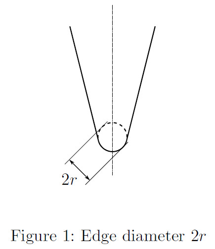

  2. The radius or width of the edge
This image comes from [2]
Definition one relies on cutting while definition two is essentially a geometrical definition. In other words, in one case it is defined by how difficult it is to actually make a cut, while the other is concerned with defining what a sharp edge shape is. However, either case is more complicated than it might first appear.

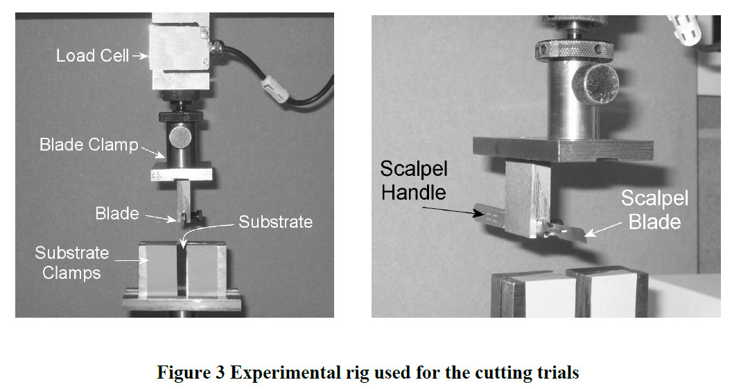

In a study performed with scalpels and razors on soft rubber substrate, the displacement and force applied to cut through the material was measured [3][4]. The setup was the following, where the blade was pressed into the rubber [3]:

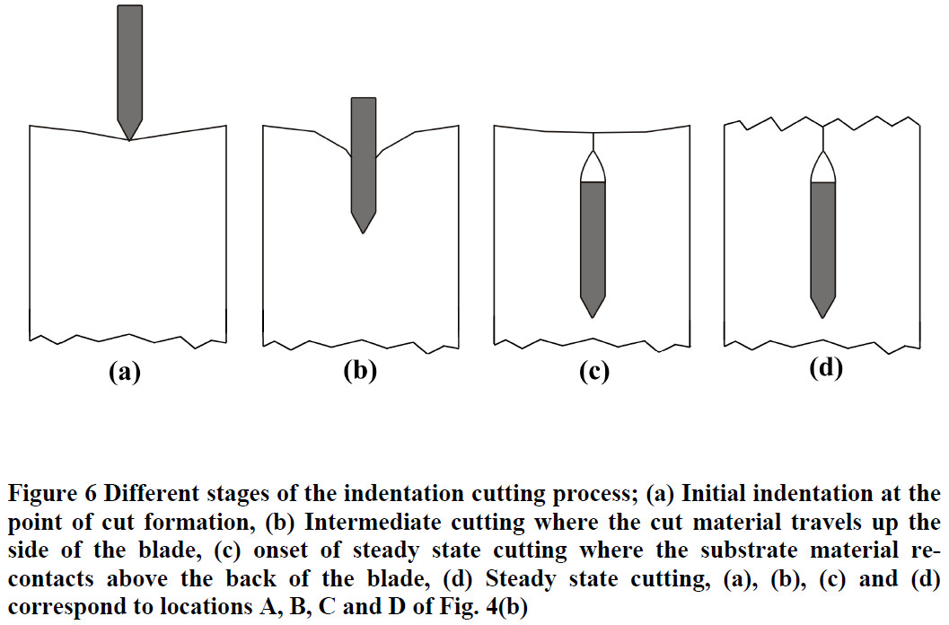

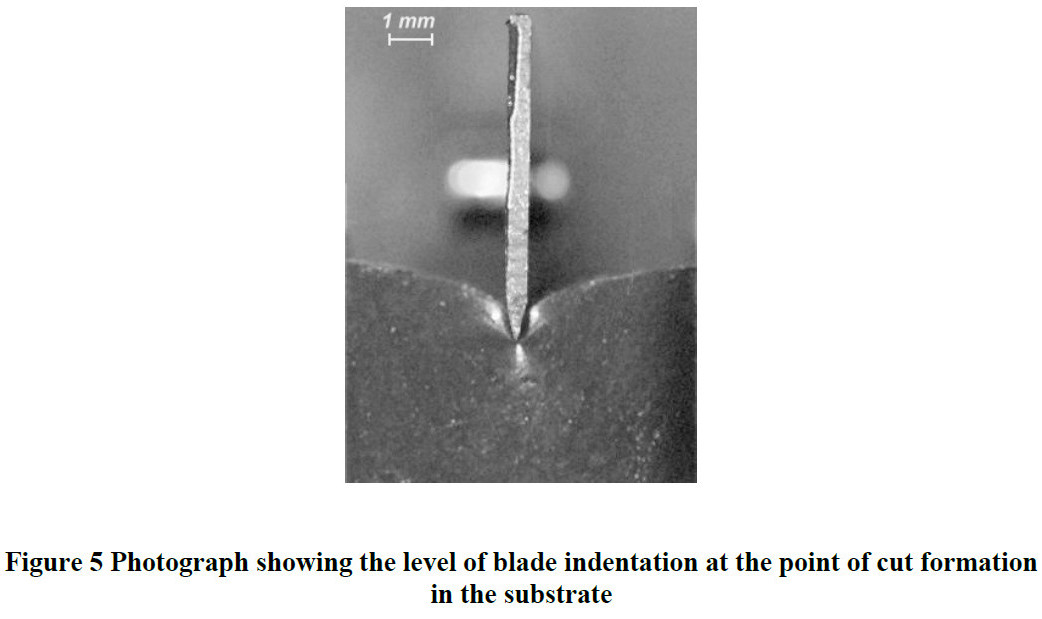

The rubber is soft and pliable and therefore it deforms to some extent before the blade begins cutting into the rubber [3]:
There are different stages to the cutting of the rubber, from the initiation of the cut (a), then the rubber traveling around the knife edge and up the sides (b), the knife then entering the rubber completely (c), and then steady state cutting (d) [3]:

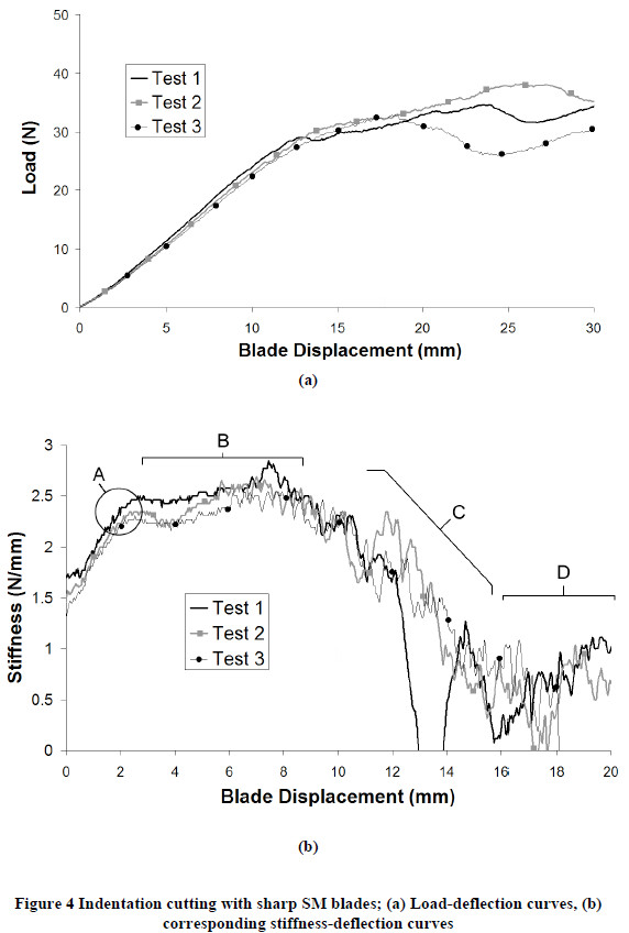

Measuring the cutting you then get the following graph showing the change in force and displacement during cutting into the rubber [3]:
The top shows the force vs displacement while the bottom shows the stiffness vs displacement. The bottom graph provides an alternative view that can make the changes in behavior more apparent. There is a somewhat subtle change at 2 mm in the top graph, for example, where the graph changes to a new slope which is the point where the cut initiates in the rubber. That change is much more visible in the bottom graph. The region labeled B shows where the rubber is passing over the knife, C is the onset of steady state cutting and D is steady state cutting.

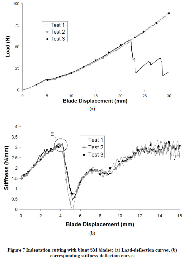

When the experiment was repeated with a blunt blade the effect of sharpness on the test is easily evident [3]:
The blunt blade required twice the displacement to initiate the cut (4 vs 2 mm), and over 2.5x increase in force from 3.8 N to 9.7 N. For the blunt knife there is a decrease in stiffness following the initiation of the cut. The overall force required to displace the blade 30 mm into the rubber was also much higher, about 88 N for blunt and 30 N for the sharp blade.
So when measuring sharpness what should be measured? The peak force that is reached during steady state? The force required for cut initiation? The displacement required for cut initiation? Those things must be decided to propose a sharpness test.

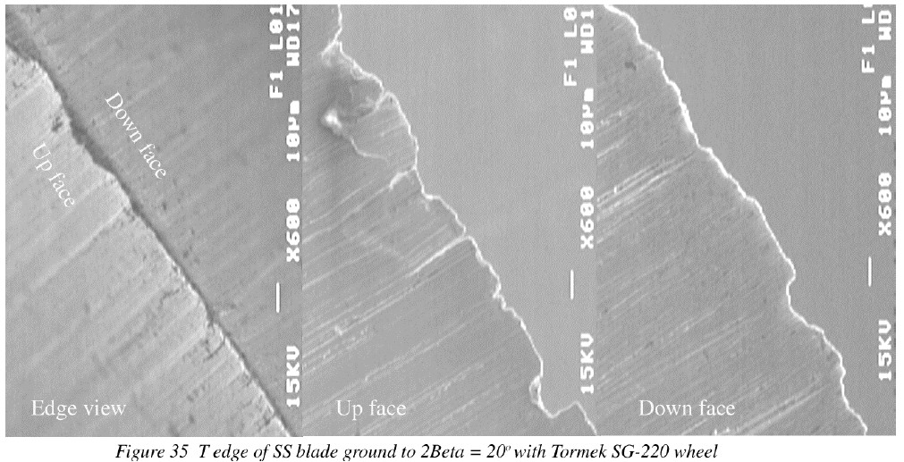

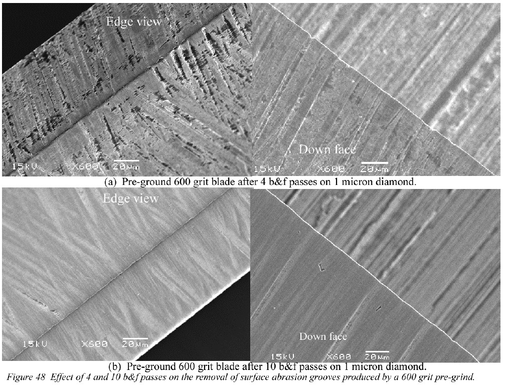

3. Edge finish and friction. In some cases it is possible to have a poorer finish but still a small edge radius, or a high finish with a large edge radius. How does that impact the edge sharpness?
The top edge has a rough finish while the bottom edge has a fine finish [6]

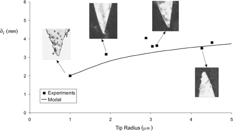

Experiments comparing the radius of the edge and the force required to initiate a cut show a very strong correlation [7]:
From those graphs it is clear that the edge radius is the most important factor for cut initiation, with perhaps a small secondary effect of edge angle. A finite element model simulation of edge sharpness found an effect of edge angle [4], but that hasn’t been confirmed experimentally as far as I am aware. While the above graph shows sharpness vs edge radius with relatively dull knives, the correlation works with sharper edges as well [4]:

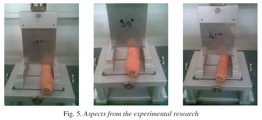

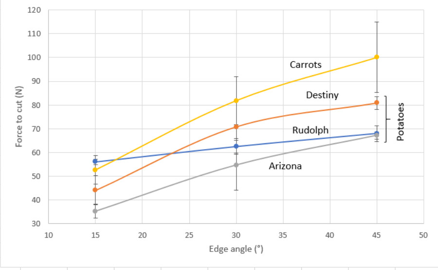

This reduction in cutting ability with more obtuse edges has been repeated on carrots and potatoes with single bevel knives as well [9][10]:

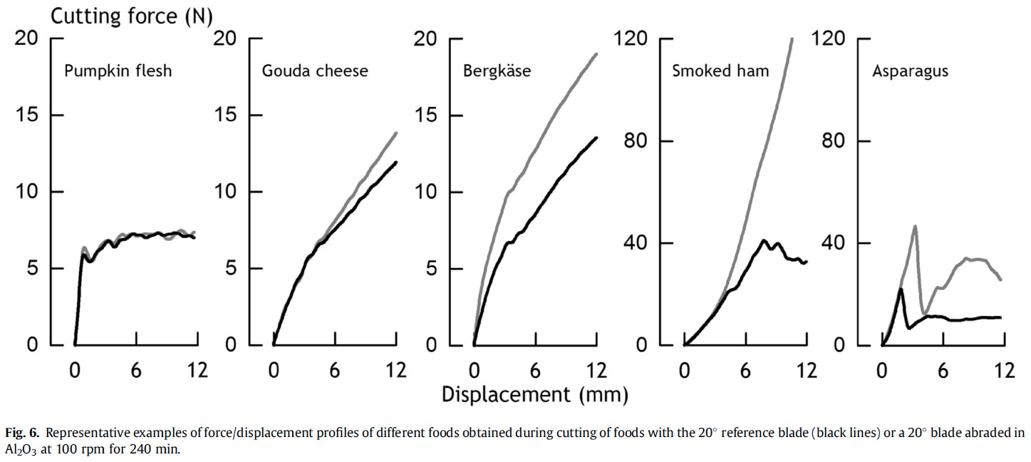

Effect of Sharpness on Cutting Ability with Different Materials
Sharpness does not have the same effect with cutting all materials. Some are more difficult to initiate a cut and some are more difficult to cut through either due to friction or from the energy required to propagate the cut through the material. The graphs below show the cutting force vs displacement for a sharp edge (black) along with a dull edge (grey) with different foods [7]:
On one extreme is the pumpkin flesh where there is almost no difference in behavior between the sharp and dull edge. The pumpkin fractured easily and therefore the displacement to begin a cut was small. On the other end of the spectrum is asparagus and ham where because they are soft materials which easily deform, sharpness is a significant factor for allowing it to be cut. With the two cheeses, the semi-hard gouda is less affected by sharpness than the softer Bergkäse for similar reasons. The friction that resists cutting is much higher with cheese and ham than asparagus which is why the force to cut continues to increase to a greater extent with those foods.

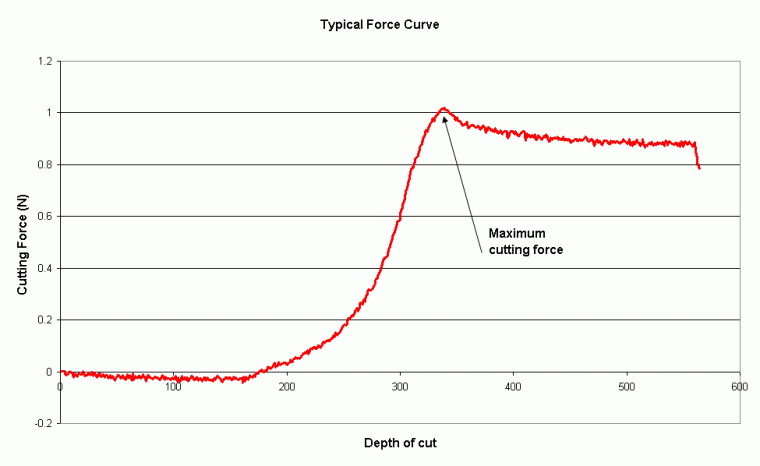

Available Sharpness Measurement Systems
CATRA is perhaps best known for their edge retention tester, but they also produce a sharpness tester. The sharpness tester uses a rubber test media and the blade is pressed slowly into the rubber until a small drop in load is measured indicating that the cut has been initiated [11]:
A type of test that has been used for nearly 100 years is the cutting of taut thread/string where the force required to cut through the thread is measured [12]. Because the thread is thin and the cut propagates easily then the test measures the force required for initiation of the cut. Edge On Up [13] makes a simple scale-based testing system that is made for a standardized test media called BESS. Their sharpness test is also reported to correlate strongly with edge width [14].

  1. Nice work. Would you share the SEM operating parameters (voltage, working distances, tilt angle)? I’ve been tempted to examine a single razor just for fun.
    1. All of the SEM images in this article are from the referenced Verhoeven article on sharpening, which I believe is freely available online. All parameters available or not available will be there.
      Edit: I forgot that the CATRA study images were at the top of the article. Those were done by a 3rd party metallography company. I will check to see what information they included, if I remember.
    2. I checked back in the documents from the 3rd party company and they didn’t provide any more information than what is found in the image, ie 20kV and SEI detector.

  3. For the stiffness/displacement graphs (e.g., 4b), can you tell me how the stiffness values were obtained? Were they derived or measured?
    Oh (and this shouldn’t be an afterthought), this is a really great article. I’m very interested in blade geometry and how it affects cutting performance, and this has been a source I keep returning to. Very nicely done!
    1. The stiffness is derived from the load-displacement curve. It is a plot of the slope of the load-displacement curve at any given point. Or for a more technical answer from the cited journal article, “These curves were generated by calculating the tangent modulus as a moving average of the values from twenty-seven adjacent pairs of data points in the load-deflection curve.”
