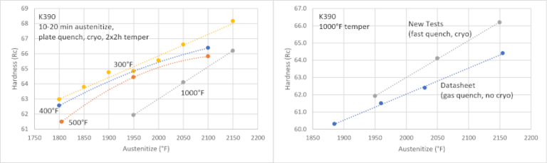

You can help support more knife steel research like this by going to Patreon.com/KnifeSteelNerds K390 Steel and Heat Treating Background I already have a video and article about the history and properties of K390, which you can see here. K390 is a powder metallurgy non-stainless steel with high wear resistance due to very high vanadium, … Continue reading How to Heat Treat K390
