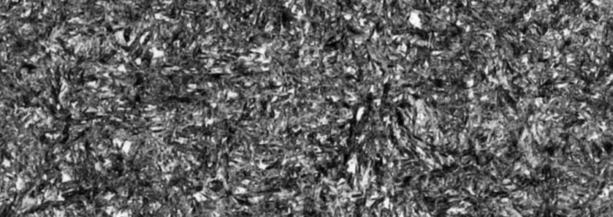

The “featured” micrograph of O1 was taken from here: https://hocktools.wordpress.com/2010/06/19/o1-v-a2-one-more-time/
