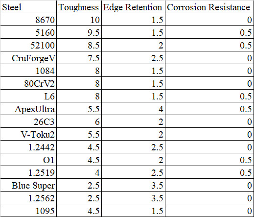

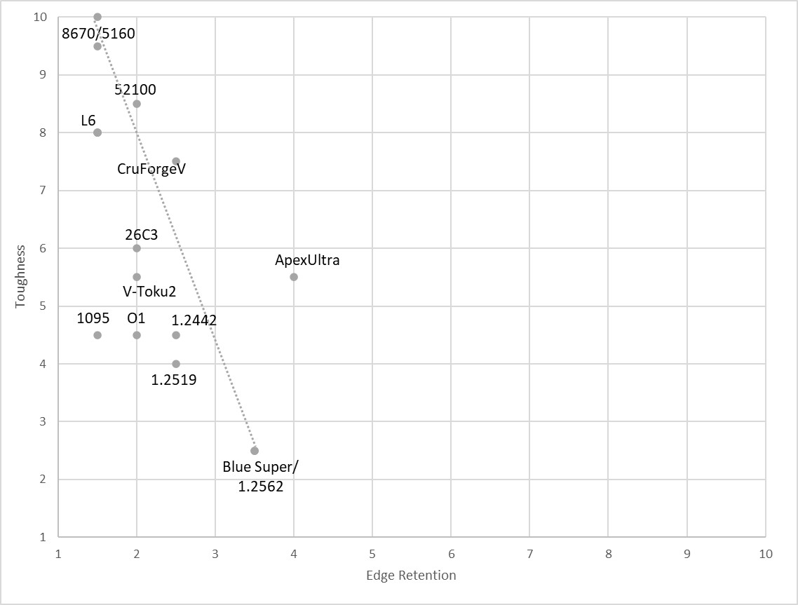

Carbon Steels and Low Alloy Tool Steels
These steels are typically used by forging bladesmiths, traditional folders, and some production fixed blades. Carbon steels are those that have primarily carbon added to them with some Mn or Si as well. Low Alloy tool steels have small alloy additions to increase “hardenability” so they harden more easily in oil rather than water. Water is a severe quenchant that can often lead to warping or cracking. Some of these steels also have vanadium (CruForgeV) or tungsten (Blue Super, V-Toku2, 1.2519) for increased wear resistance. In general, higher carbon steels have higher edge retention but lower toughness. The maximum edge retention available in this group is not particularly high because most of the wear resistance comes from iron carbide, also called cementite, which is the softest of the different carbide types. On the positive side, they are very easy to forge and grind.
8670 and 5160 are good choices for large knives that need very high toughness. 52100 and CruForgeV are good for general purpose knives. Blue Super and 1.2562 have higher edge retention but relatively low toughness. ApexUltra is a steel that we are working on that had excellent properties in small batch production (50 lbs). I’m looking forward to seeing if it does as well in full production.
Carbon and Low Alloy Tool Steel Ratings

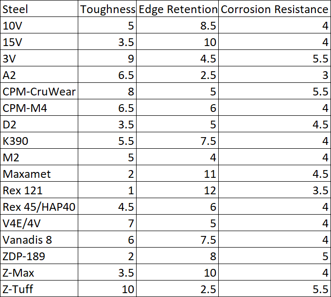

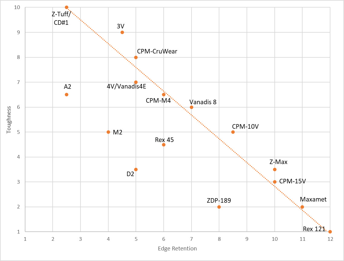

High Alloy Tool Steels and High Speed Steels
High alloy tool steels are designed to be air hardening, so they can be cooled even slower than the oil hardening steels found above. This is good for ease in heat treating in large batches and for even cooling that greatly reduces warping and size changes. High Speed steels are a subset that have significant additions of Mo and/or W that makes them resist softening when they are used for machining operations. The big difference in properties vs the low alloy steels, however, are the harder carbides that are found in these steels. Vanadium carbides are among the hardest that form in steel, and chromium carbides are in between iron carbide and vanadium carbide. Steels with very high vanadium content like Vanadis 8, CPM-10V, K390, CPM-15V, etc. have extremely high edge retention. Maxamet and Rex 121 are so extreme in terms of wear resistance and edge retention that I rated them higher than 10 because otherwise it throws off the ratings for everything else. Powder metallurgy steels with low vanadium content like CPM-1V and Z-Tuff/CD#1 have extremely high toughness. The best steels with balanced properties include 4V/Vanadis4E, CPM-CruWear, and CPM-M4. My favorites of the high edge retention group are Vanadis 8 and CPM-10V.
High Alloy Tool Steel and High Speed Steel Ratings

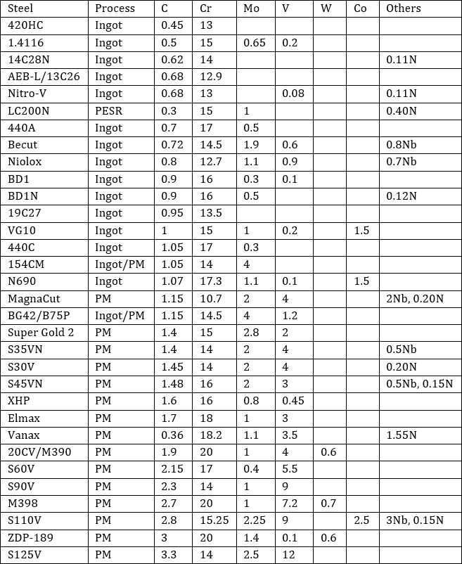

Composition of Steels
I have the average composition of the steels rated above (plus some extras) so you can see what the different names refer to. There is an acceptable range for every element so this doesn’t mean that 1084 will always have exactly 0.84% carbon. Not every element is shown in the charts. For example, the Si space is blank for several of the carbon steels because they have a relatively wide acceptable range, not because the element isn’t added. And Mn and Si isn’t shown at all for the high alloy steels, even though those elements are added to all of them. This is to keep the focus on the elements that are making the biggest difference.
I actually don’t recommend that enthusiasts spend all that much time analyzing the exact composition of different steels and trying to guess their properties. Even metallurgists can have a difficult time estimating properties just based on the elements. There are so many interactions between them that predictions are difficult without modeling software. In general, higher carbon and higher vanadium steels have higher wear resistance and edge retention but lower toughness. And steels with at least 10% chromium are probably stainless, except for several important exceptions like D2 and ZDP-189.

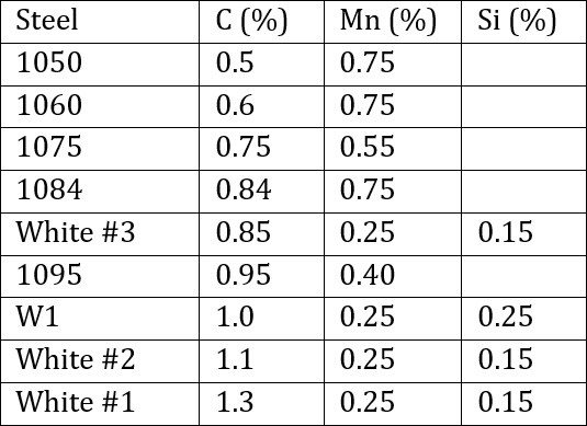

Carbon Steel Compositions

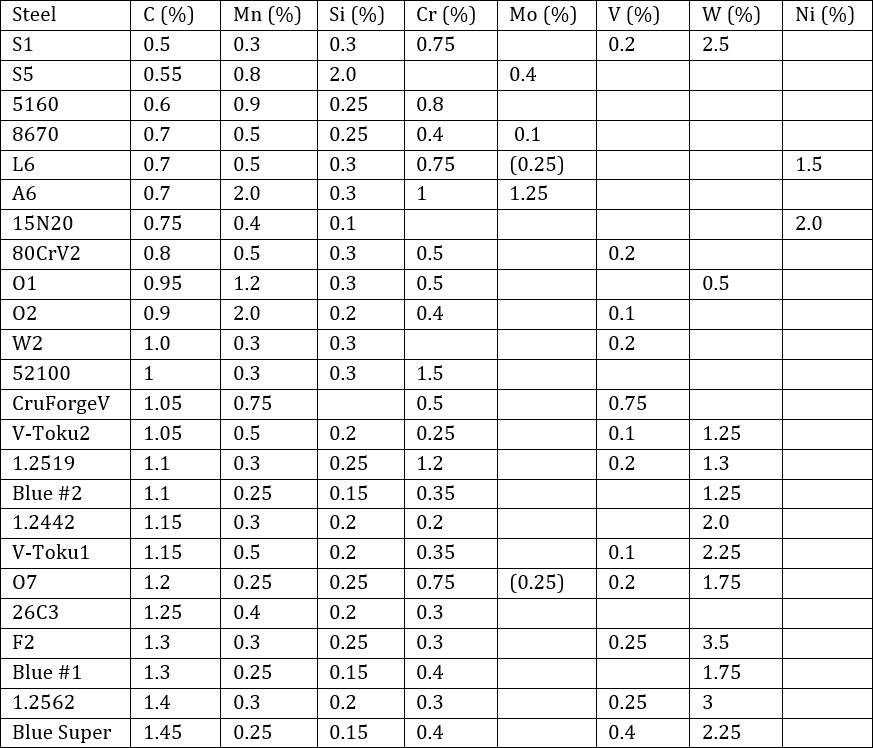

Low Alloy Steel Compositions

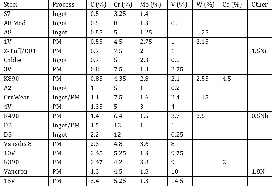

Composition of High Alloy Tool Steels

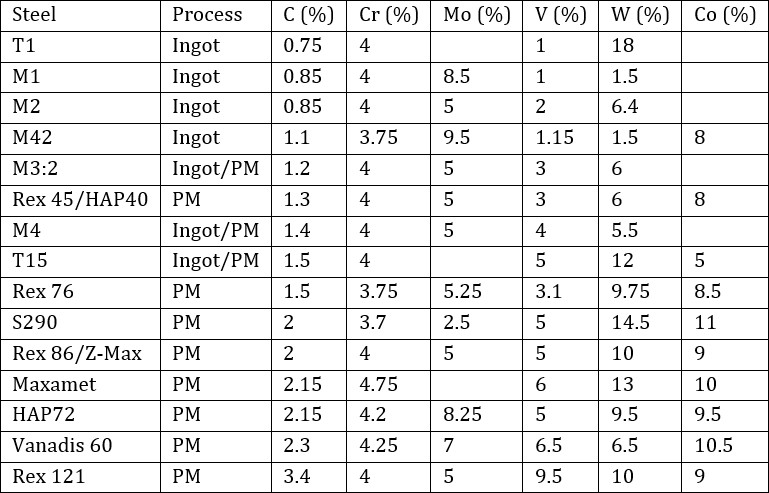

Composition of High Speed Steels
Stainless Steel Compositions

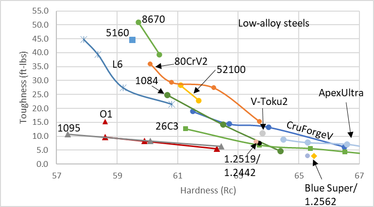

With toughness it is a bit harder to link to only one article as I don’t really have a summary of all of the toughness testing that we have done. Mostly it has been presented piecemeal with all of the studies that we have done on optimizing heat treatments of different steels like CPM-CruWear, AEB-L, 52100, etc. We use a subsize, unnotched charpy test with 2.5 x 10 x 55 mm dimensions. Each test is done with 3 or more specimens to get a good average. Below shows charts summarizing tests of different steels for the major categories discussed so far, low alloy steels, high alloy non-stainless steels, and stainless steels. In general, the more carbide the steel has and the larger the carbides the lower is the toughness. The hardness of the carbides does not matter much unlike with edge retention. There are a few other complicating factors such as carbon in solution and plate martensite, especially in low alloy steels such as described in this article.

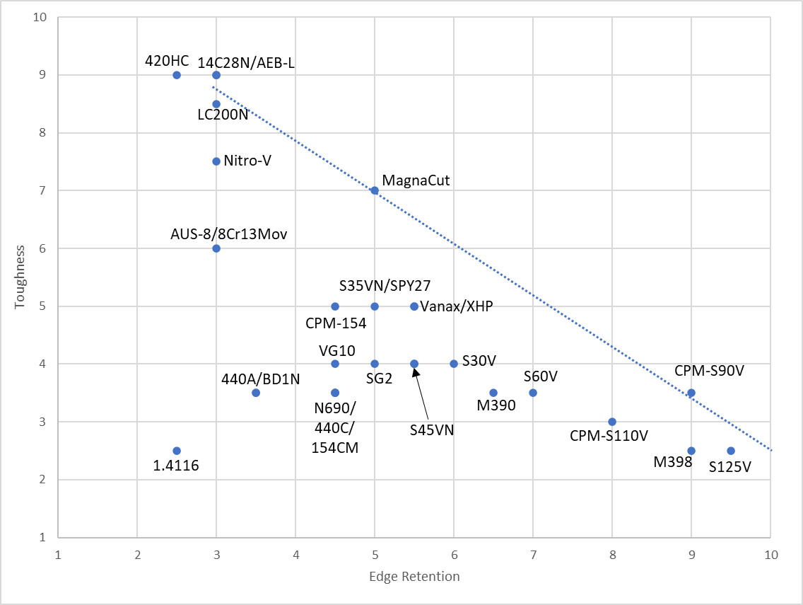

Toughness vs Edge Retention
In some previous articles I have shown the balance between my toughness and edge retention measurements such as in the following chart, where the high alloy non-stainless are in orange and the blue are stainless:
However, one issue with these charts are that difference in toughness is that a linear scale for toughness is a bit misleading for visualizing practical toughness differences. If you look at the chart you may notice that at high toughness levels if you increase edge retention by only a relatively small amount you get very big drops in toughness. For example, increasing edge retention from Z-Tuff to 3V (100 mm in the CATRA test) led to a drop in over 10 ft-lbs, a similar drop is seen by going from 3V to CPM-CruWear. But then if you look at an increase of 100 mm in the CATRA test from Maxamet to Rex 121 the toughness only drops 1-2 ft-lbs. However, the relative difference in toughness between these different examples are similar. When we plot toughness vs edge retention on a log scale instead we get a straight line that is a better visualization of toughness differences. This is the basis on which I do the ratings rather than a linear scale.

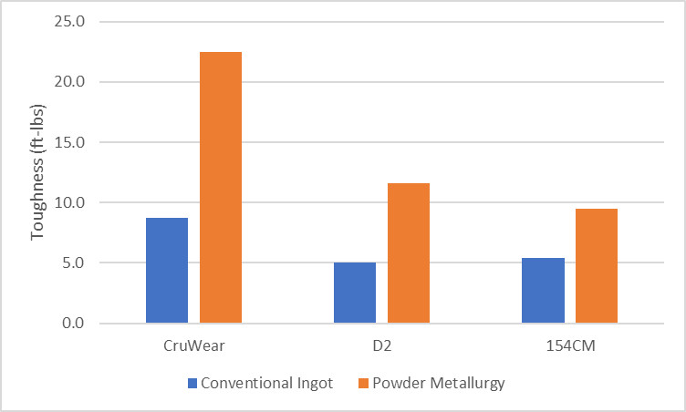

Conventional Ingot vs Powder Metallurgy Carbide Structure
Powder metallurgy is a technology designed to maintain a small carbide size. Read more about how it works here. It is most useful for steels with large amounts of carbide but also helps to be able to add certain carbide types. Vanadium carbides are very large with conventional production of steels but are very small with powder metallurgy. With conventional steels this limited vanadium additions to about 4-5%, and this was greatly expanded when powder metallurgy was developed. The biggest change that is seen with powder metallurgy in measured properties is in regards to toughness. Below shows a comparison of carbide structure between D2 and CPM-D2, and then toughness measurements between the conventional and PM versions of CruWear, D2, and 154CM.
D2 – conventionally produced ingot steel
CPM-D2 – powder metallurgy D2
With steels that have a small amount of carbide the size of the carbides can be kept small through processing (see the AEB-L micrograph earlier in the article). Most low alloy tool steels and carbon steels also have fine carbide structures without powder metallurgy processing. Therefore powder metallurgy is not necessary for certain steels, or could even be slightly detrimental. As wear resistance is increased the differences between conventional and powder metallurgy steels become greater.

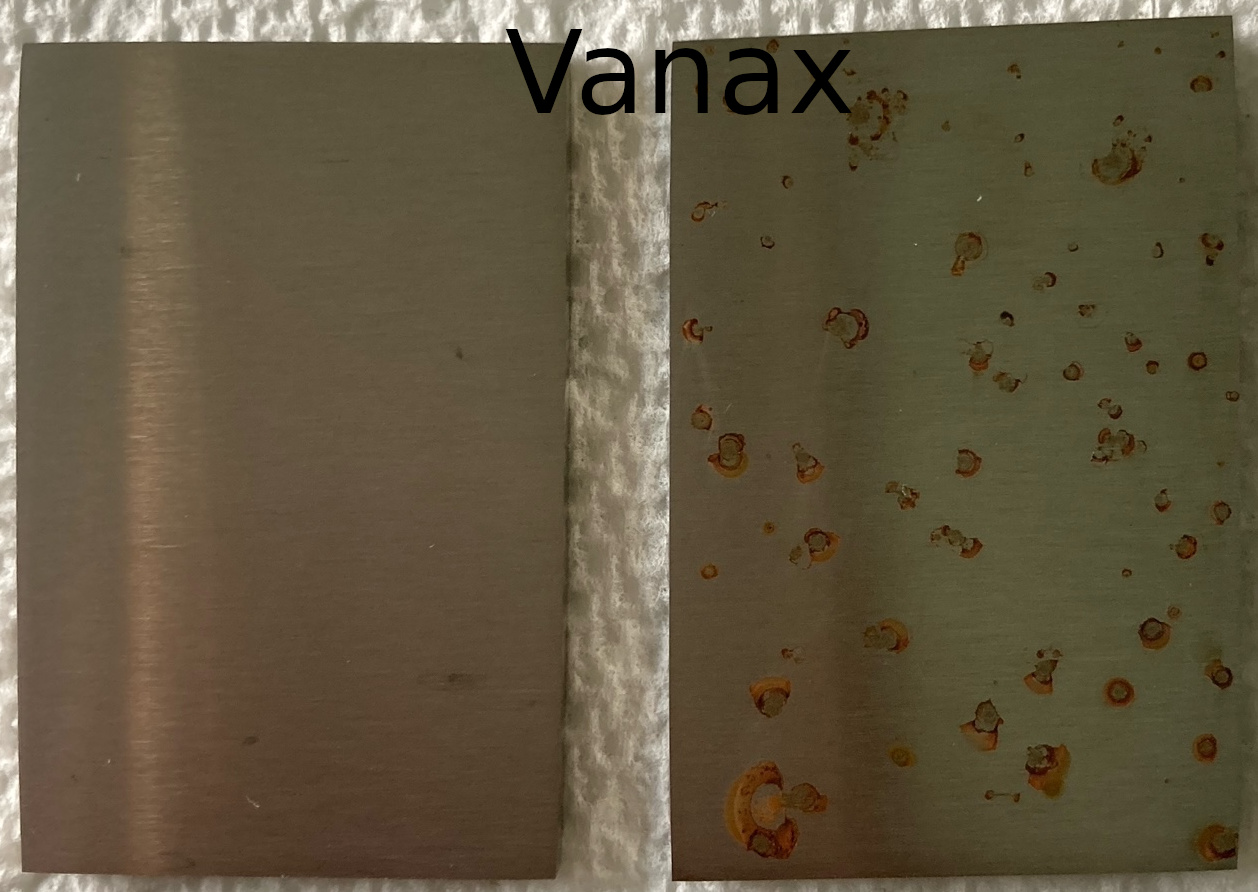

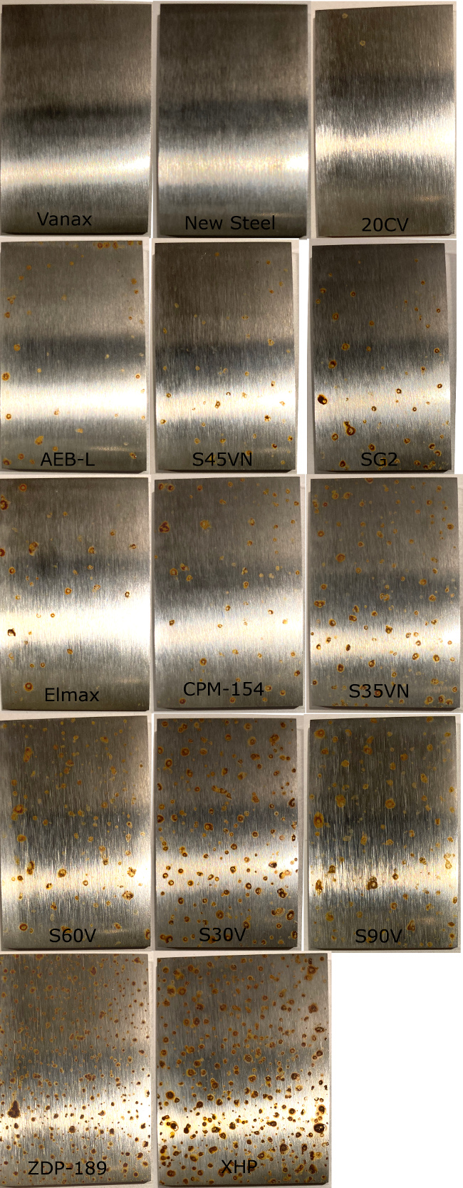

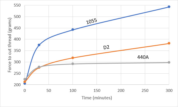

I test corrosion resistance of steels by heat treating 1 x 1.5 inch coupons, finishing to about 400 grit, and then spraying with water. A mirror finish is the best at resisting corrosion and a rough finish means rust and corrosion is more likely. Distilled water can separate steels that are stainless vs those that are not. This showed that XHP and ZDP-189 have significantly lower corrosion resistance than other stainless steels. 1% saltwater will separate between other stainless steels. And only Vanax and LC200N have been free from corrosion with a 3.5% saltwater solution, though MagnaCut was close. Read about my tests in this article. Below shows the results of MagnaCut testing vs other steels where it is labeled as “New Steel.”
Corrosion is not just about cosmetics and rusting, however, but can also affect edge performance. I did a test with knives in 440A (stainless), D2 (high alloy steel with some corrosion resistance), and 1095 (no corrosion resistance). I dipped each in lemon juice and left in open air and tested after 30, 100, and 300 minutes, dipping in lemon juice again each time. There was significant sharpness loss with 1095, almost none with 440A, and D2 was in between.

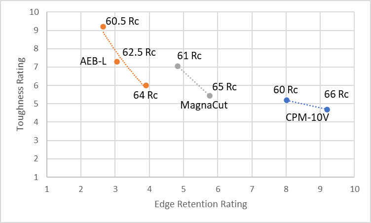

Hardness vs Rating
For the steels that I rated I give them a single rating rather than a range based on different heat treatments that can be performed. In general, steels “look” worse as you go up in hardness because the toughness is reduced by more than the edge retention is increased. So for most steels they are given a rating at around 59-62 Rc, apart from a few steels that are never used at that hardness. I have a few examples below for steels that I have ranges of hardness tested for both toughness and edge retention. You can see that 64 Rc AEB-L has both lower toughness and edge retention than 61 Rc MagnaCut, so I feel that in general you get a better sense of where the steels fit with a single point. Plus the charts get messier, and I don’t always have data for a wide range of hardness values.
While higher hardness does lead to improved edge retention the bigger reason to have higher hardness is for resisting edge deformation. This is especially important for chopping knives and for knives with thin edges for enhanced cutting ability and edge retention. For example, below is a video comparing a 1095 ESEE knife at 55-57 Rc and a MagnaCut knife at 62.5 Rc, both with the same edge angle. Both knives were chopped through a nail. The ESEE had significant edge damage while the MagnaCut knife did not. This was not necessarily because of superior toughness but because of the superior strength of the MagnaCut from higher hardness. The very good toughness of MagnaCut meant that it didn’t chip despite this relatively high hardness and the difficulty of the test.

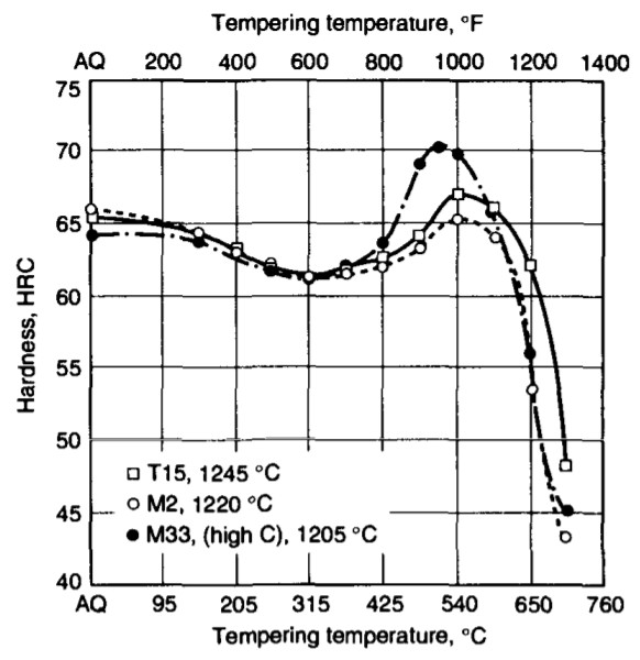

Austenitizing is the process where the steel is heated to high temperature prior to quenching (rapid cooling) to harden the steel. If the steel is overheated in austenitizing, very large reductions in toughness are possible. See the chart below showing 52100 steel that was overaustenitized (unintentionally) by a knifemaker that sent me specimens for toughness testing. Using controlled furnace heat treating resulted in toughness around 23-28 ft-lbs at 61-62 Rc, while the knifemaker heat treated specimens were 7 ft-lbs or below.
Another common heat treating choice that is not even categorized as a “mistake” is tempering in the high temperature regime (~1000F) rather than the low temperature regime (~400F). After the steel is quenched it is reheated to a lower temperature to increase toughness and decrease hardness. Steel softens as tempering temperature increases, but certain steels see an increase in hardness in a certain higher temperature range such as shown below for high speed steels that are designed for this type of tempering:
This high temperature tempering can be done for several reasons, such as better resistance to overheating during grinding, or because a coating will be applied to the knife that requires a high temperature. However, in our testing there is a reduction in toughness by using the high temperature range rather than the low temperature range, such as was found with CPM-CruWear (Z-Wear) or CPM-10V. The 10V specimens tempered at 1000F were 4-5 ft-lbs while the specimens tempered at 4-500F were 7-8 ft-lbs.
Perhaps a bigger issue with the upper temper is for stainless steels, as there is a significant reduction in corrosion resistance by tempering at 1000F instead of 400F. The bump in hardness comes from precipitation of fine carbides in the steel, which include chromium carbides. The steel loses some of the chromium in solution for corrosion resistance to form these fine carbides for hardness. This can turn the ultra corrosion resistant LC200N or Vanax into a “normal” stainless steel that will rust with only 1% saltwater. Below shows Vanax tempered at 400F on the left and 1000F on the right after 1% saltwater for 24 hours:

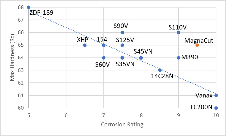

Corrosion Resistance vs Hardness
Typically an increase in corrosion resistance means a reduction in potential hardness for a given steel. This was described in this article on Vanax heat treating. Non-stainless steels can be heat treated to 66 Rc or even higher depending on the particular steel. Stainless steels usually top out around 64 Rc and may require careful heat treating to get there. The ultra high corrosion resistance steels Vanax or LC200N max out around 60-61 Rc instead. A cryo treatment and close temperature control is necessary to achieve those hardness levels. The majority of knives target 63 Rc or below so this limitation of stainless steels does not always come into play but can be an important factor for certain knives targeting high performance and thin edges. Below shows approximate maximum hardness vs stainless rating for several stainless knife steels. This is about comparing steels to each other rather than a limitation of an individual steel. In other words, heat treating a steel to its maximum hardness does not necessarily mean reduced corrosion resistance.

Thanks! Question. The stainless steel rating. Is this at the same hardness?
Vg10 and cpms45vn same toughness at same hardness ?
Approximately the same hardness, yes. Around 61 Rc usually.
Thank you for the accurate data.
I always thought VG10 to be way more chippy/less tough compared cpms45vn. In reality hardly difference.
Quite an eyeopener!
I noticed that too! I appreciate my old VG-10 Delica and Endura even more now! Haha

1.4116 got a 2.5 for toughness and edge retention where as 420HC got a 9 for toughness and a 2.5 for edge retention. What makes 1.4116 such a bad performer in regards to toughness on par with ultra high carbide steel like S125V? and why would anyone want to use it when 420HC looks so much better for a simple stainless steel option.
The 1.4116 I tested has large carbides in it which is presumably the reason for low measured toughness: https://knifesteelnerds.com/2019/05/26/new-micrographs-of-42-knife-steels/
It’s possible that there are steel manufacturers with better processing which would lead to an even carbide distribution but I can’t say that without seeing it for myself.
thanks that’s interesting. does 1.4116 deserve the title of title of ultimate trash steel? Looks like there is no reason to us it over 420HC. Also I notice 1095 looks like another underperformer as there doesn’t look to be any reason to use it over 5160 which I can’t imagine is any more expensive than 1095. Would be great if some manufactures changed their steels based on this information.
and yet millons of knives are being made out of 1.4116 (aisi 420mov?) worldwide, even the chinese have an equivalent (8cr13mov). at least it has some vanadium over the 420hc.
most knives are being made out of these and other “mediocre” steels like 14c28n, 420j2, 425m. its like with cars, most of them are not a corvette or a porsche. you can easily buy a $500 knive made out of 14c28n, which has nothing in it besides cr and a trace of ni.
im led to believe tha the melting procedure is more important with these steels than the exact composition.
Funny calling 14C28N “mediocre” as it is an outstanding steel, regarding its toughness-per-edge-retention, very good corrosion resistance.
It is rather mediocre in edge retention alone, and cheap thanks to its classic, non-PM process.
I would love to see a retest of this steel in the future, it’s hard to believe a low carbon steel can be so brittle like that, despite being similar to 8CrMoV. Also thank you for your contribution to this knife study space, Roman.

I see tables that compare Toughness,Edge Retention,Corrosion Resistance.
There are also hardness/toughness and hardness/TCC charts….but no tables backing this charts.
I’m a layman trying to understand what makes the best steel for my use. It would be really useful to have the raw data that backs the charts that you produce. In particular, I really care about the toughness / hardness part.

Is that regression line (or other trend line?) in the correct place for the stainless-toughness-edge-retention graphic? How could it be? The line is only in the neighborhood of 5 of the datapoints. I’d think that line would be significantly to the left, more in the data swarm. What is pulling that line high and to the right?
It’s not a regression line, it is just a line through the best steels.
Ah, now it makes sense. Thanks Larrin!
Hi Larrin – Your estimate of 420HC’s corrosion resistance is different here than in your October, 2019 post on corrosion resistance testing: https://knifesteelnerds.com/2019/10/14/corrosion-resistance-testing/
There you said 7.6 for 420HC. Here it’s 8. Did you change the estimate based on more testing? (I think the 420HC estimate in that post was based on simulation or computer modeling, since you didn’t spray testing any of the 400 series.)
You also reported 8.6 for 440A in that post, compared to 8.5 in this post. That’s a tiny difference, but in combination with the 420HC disparity, it conceals a full point difference between 420HC and 440A: 7.6 vs. 8.6. That’s a pretty large difference in two budget steels that are often compared to each other. Is 440A really that much better than 420HC, or have you found a narrower gap?
I measured corrosion resistance of a slightly lower carbon 420 here: https://knifesteelnerds.com/2020/03/02/cpm-spy27-experiments-toughness-corrosion-resistance-and-more/
It had better than expected corrosion resistance due to the lack of chromium carbides, a behavior also seen in MagnaCut. 440A has more chromium in solution along with a small addition of Mo, but has significant amounts of carbide so the two are an interesting comparison. As to a difference between 8.6 and 8.5, all of the ratings here are rounded to the nearest 0.5 because better than that probably shows false precision.
I can’t seem to match steel to the SS data points on the toughness/tcc graph. It shows 3 stainless steels from 750-800tcc but the edge retention graph only has 1 SS in that range, S90v.
The values are normalized to 61 Rc.
Ah ok that wasn’t mentioned. Why does Maxamet and Rex 121 stay the same tcc but Zmax drops and 15v goes from below 900 to over?
You’re right I had to check my spreadsheet. The edge retention numbers are normalized to the hardness of the closest toughness test. Sorry about the misinformation.

Hey man, just wondering, I think the S35VN is off? You have it listed as 4% vanadium which confused me because I believe it’s 3% according the other sources.
I didn’t see 1075 on the charts??
I recommend looking at the similar 1084.
1075 is up front in carbon steel composition

For the toughness v edge retention graphs, are they relative to each other between steel types (carbon & low alloy v. high alloy v. stainless). E.g., does 14C28N have similar toughness as 3V (both 9), and does S60V have similar edge retention as Vanadis 8 (both 7)? Or, should these properties only be compared within the same steel type graph?
This is excellent information, Larrin – thank you so much for sharing!
The are directly comparable

So I have been thinking about this for a while but couldn’t find much. If you have 2 steels only differing in carbon content, like 1045 and 1095, when they are at the same hardness, will there be a measurable difference in edge retention?
It kind of looks like the only factor for the plain carbon steels is hardness not actual carbon content. I often have seen this discussed, 1045 is tougher but does not keep an edge as well, but what if they are at the same hardness?
Looking at 1084vs1095 there is a toughness difference, but on the CARTA-graph all the carbon steels look to be on a neat line correlating with hardness.
Also is there maybe a list with numbers for the CARTA results? Personally I find the graph a bit too loaded now and also like nice, crisp numbers.
Problem with CATRA and carbon steels is that sand like used in the test media is harder than iron carbides, which isn’t a whole lot harder than the fully hardened steel out of the quench. So the steel hardness matters a lot more in those steels. Go for less carbon hardened harder if you want a usably tough but decent fine edge holding knife. Toughness doesn’t mean much when the knife is so soft the apex mushrooms instead of chips no matter what.
What I found: There is a theorethical difference, more carbon, more carbides, better wear resistance, but you’ll likely not feel much if anything. Also different sources say different things about coorrosion resistance, some say higher carbon have a slightly better corrosion resistance, others say it’s worse. What is for sure is that harder equals less corrosion resistance, that’s the only point I can 100% say is true.
There is one pretty noticeable difference between 1045 and 1065, the 1045 takes a set a lot easier than the 1065 at the same hardness, same seems true for 1065 vs 1075 with 1075 being much more resistant to bending at similar HRC levels.

Where does popular Japanese carbon steels like White #1 & #2 or Blue #2 fall?
There are roughly corresponding steels that are rated such as 26C3 or V-Toku2.

I’m not sure if this has been asked before but how would you rate White 2 and Blue 2 steel on the toughness and edge retention?
I haven’t tested them but you can get somewhat of an idea by looking at roughly comparable grades like 1095 or V-Toku2.
Hi Larrin could you expand on your ratings a little more?
S30V you rate 4 in toughness
S90V… 3.5 in toughness.
The toughness table shows S30V at approx 5.5-6ft-lbs at a hair over 60Rc
S90V is about 6ft’lbs at ~60.7RC
(close but seemingly slightly tougher/harder)
Based on this I’m not understanding how the toughness ratings are derived? I would have thought S90V would at least be equal to S30V
I think it boils down to the hardenability of the steel. The steel hardened to the highest ability and then tempered to a higher temper gets tougher as the hardness declines. S90V was probably at 67 to begin with and at that hardness is not very tough, but if reduced by 7 HRC causes the toughness to increase, where the S30V started at some what lower at 63 HRC, dropping it down to 60 does not have the same effect at dropping down 7 points in the S90V. If you don’t need a harder blade for edge retention, it’s better to go with the cheaper steel if toughness is what you need. Now, I’m no expert, not even close, but that’s the way I understand it.
I’m not sure I’m following your explanation?
Yes the measured toughness is at a different hardness, but corrected to the same hardness then S90V should be at least as tough as S30V?
Regarding the price of steel, that doesn’t factor into these tables.

Question for the doctor: On your graph you listed s110v as having an edge retention score of 8 and s90v at a 9. Does this mean s110v has lower wear resistance than s90v?
That was the result of the CATRA test. Doesn’t make much sense but the result is the result. See the CATRA graph.

The only downside of AEB-L is the low edge retention. In your graph on toughness and edge retention you compared AEB-L to magnacut. AEBL could never measure up to magnacut in terms of balanced toughness, hardness, and edge retention; but in comparison to other steels that are close in their edge retention rating to AEBL like 440A and 14C28N, how close are they in edge retention and toughness to AEBL hardened to 63 RC?
Neither the toughness and hardness graph or the edge retention and toughness graph include 440A which is a very common knife steel often claimed to be very highly rated, but with its low toughness how well does it measure up to 62-63 RC AEB-L?
