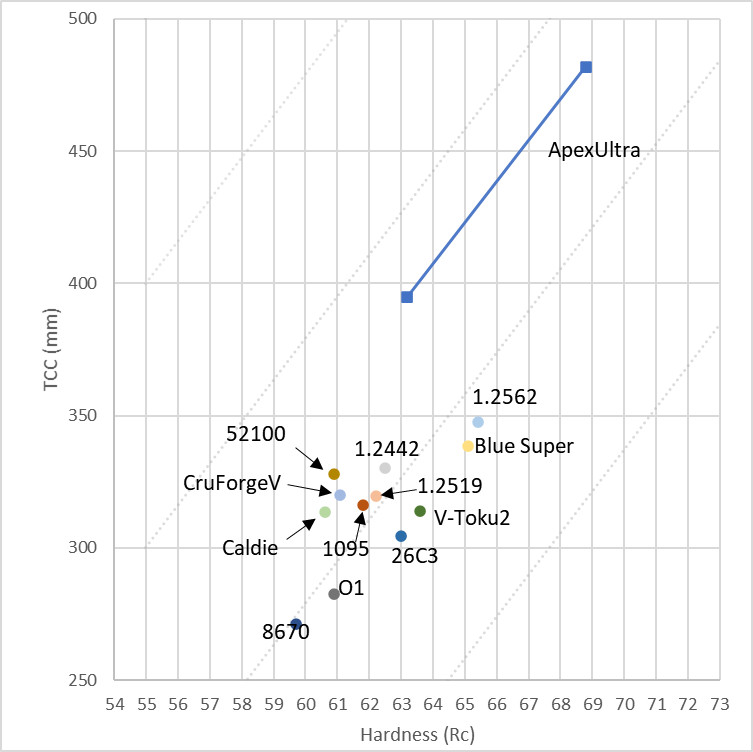

One of the major benefits of ApexUltra vs other low alloy steels for forging bladesmiths is the increased wear resistance and the improved edge retention that that provides. The chromium addition increases the hardness of the cementite (iron carbide) and the tungsten and vanadium form hard carbides, all of which increases wear resistance. This can be seen in the CATRA edge retention tests below on ApexUltra. There is significantly higher wear resistance than other low alloy knife steels, even when compared with 1.2562 and Blue Super, which also have high tungsten additions. The CATRA test and the previous finding that higher chromium led to improved edge retention with 52100 is described in this article.
The sizeable chromium addition to ApexUltra also helps to prevent excess carbon in solution and “plate martensite” which drops toughness. This is the primary reason why ApexUltra has much higher toughness than previous top wear resistance forging steels 1.2562 and Blue Super. You can read more about the effect of chromium on toughness of forging knife steels in this article and in this article on austempering. ApexUltra is particularly good at maintaining its toughness at high hardness which makes it good for thin knives with superior cutting ability. I also have information about how to heat treat to lower hardness levels in the heat treating data below.

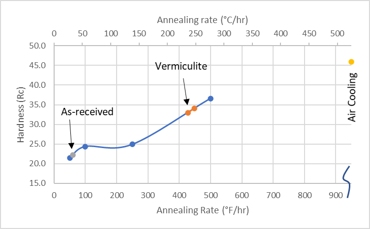

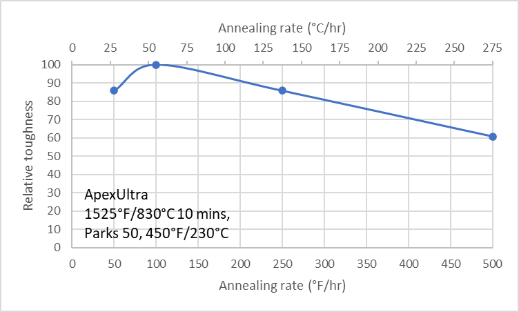

Annealing
I tested the result of different annealing rates on ApexUltra to find the optimal cooling rates. The steel is heated to 1450°F/790°C for 15-30 minutes followed by slow cooling to 1100°F/590°C. After that it can be air cooled as the transformation is complete. It is the slow cooling rate between 1450 and 1100°F that I varied for testing. Below shows the effect of cooling rate on the final annealed hardness. I also have a data point for air cooling, vermiculite cooling, and the “as-received” hardness from the factory.
Air cooling resulted in mid-40’s Rc which is high for drilling and bandsaw cutting. Using a 450°F/hr (250°C/hr) cool or placing in Vermiculite resulted in 30’s Rc which is more reasonable for drilling. This condition is also good for a forge heat treatment which I will show later. I placed other heated bars of steel (which steel doesn’t matter) in the vermiculite next to the ApexUltra bar to slow the cooling rate in the vermiculite which can help ensure the cooling isn’t too fast in the vermiculite. Using 250°F/hr (150°C/hr) or slower results in 25 Rc or below.

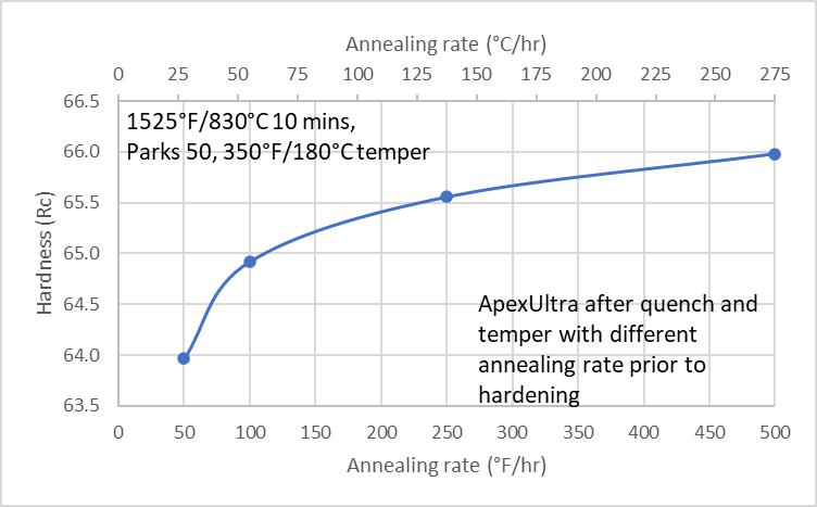

I also heat treated coupons and tested them for hardness and toughness from the different conditions. A slower cooling rate results in a lower hardness after quenching and tempering because of the coarser starting microstructure. I wrote more about this in the Thermal Cycling article.
Due to the sample orientation I used for these experiments I could only do “transverse” toughness tests which can’t be compared with my other standard toughness tests. So to avoid confusion I am showing only the “relative” toughness instead. The 100°F/hr (50°C/hr) anneal led to the best balance of toughness and hardness.
So I recommend the 100°F/hr anneal for furnace heat treating in general situations, though a vermiculite anneal or 450°F/hr (250°C/hr) anneal can be used for forge heat treating or for maximum hardness after heat treating. For a forge anneal you heat to non-magnetic and then place in vermiculite. Placing other heated bars alongside the knife in the vermiculite can ensure the cooling is slow enough to avoid issues with bandsaw cutting or drilling.

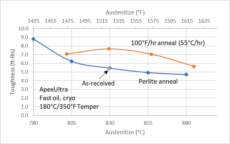

Austenitizing

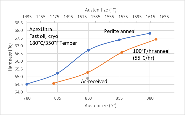

In the plots below I will be showing hardness and toughness data from three different conditions:
  1. Annealed by placing the steel in perlite from non-magnetic. These samples were heat treated by Tobias Hangler. Perlite is an insulating media similar to vermiculite. It should not be confused with the steel phase pearlite, though in this case the perlite anneal does result in a primarily pearlite microstructure so maybe the confusion isn’t too bad.
  2. Annealed at 100°F/hr (55°C/hr) from 1450°F/790°C. These coupons were heat treated by Devin Thomas.
  3. Heat treated from the “as-received” condition from the factory. These were heat treated by me.

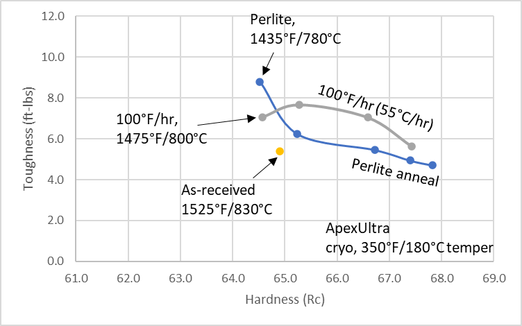

The perlite anneal resulted in higher hardness for a given austenitizing temperature due to the finer starting microstructure. The as-received condition was also slightly lower in hardness after the quench and temper than the 100°F/hr (55°C/hr) starting structure. The 780°C/1435°F used from the perlite anneal is right around the point where the steel becomes non-magnetic which is why the vermiculite/perlite anneal is what I recommend for forge heat treating as you can quench from non-magnetic and still achieve a full martensite microstructure.
Two different behaviors are observed for austenitizing vs toughness depending on the starting microstructure. Using a perlite/vermiculite anneal you see increased toughness as the austenitizing temperature goes down. This is because the carbon in solution is lower and plate martensite is reduced, as explained in this article about austempering. The fine starting microstructure means that high carbon in solution occurs at lower temperatures which is why the behavior is somewhat different than the 100°F/hr (55°C/hr) anneal. Another thing to note is there is no major dropoff in toughness even with 1625°F/880°C austenitizing, which shows that the tungsten and vanadium carbides are effectively “pinning” the grain boundaries and keeping the grain size small even at that relatively high temperature. The fracture grain was also silky smooth, of course.
The 100°F/hr (55°C/hr) results in spheroidized carbides where excess carbon in solution requires higher austenitizing temperatures. In fact, austenitizing at 1475°F/800°C resulted in slightly lower toughness than 1525°F/830°C despite also having lower hardness. This same behavior has been seen in some other steels like 5160 and 52100. The as-received steel had similar toughness to the perlite anneal though at lower hardness. You can see the hardness-toughness balance instead below where it is clearer which starting microstructures resulted in the best properties:
You can see that once normalized for hardness, the 100°F/hr (55°C/hr) anneal resulted in the highest toughness, then the perlite/vermiculite anneal, then the as-received condition. So we were successful in improving the properties vs the as-received condition though the 100°F/hr (55°C/hr) anneal had the best properties. Two outliers are pointed out which was the 1475°F/800°C austenitize from the 100°F/hr anneal which had extra carbide that decreased toughness, and the perlite anneal 1435°F/780°C which had increased toughness from having lower carbon in solution. So a lower austenitize can be beneficial when heat treating from a vermiculite/perlite anneal though you must ensure the steel is fully transforming to austenite (nonmagnetic) or the blade will not fully harden. When heat treating from the 100°F/hr (55°C/hr) anneal condition it is better to austenitize higher than 1475°F/830°C, such as 830°C/1525°F, for the better balance of hardness and toughness.

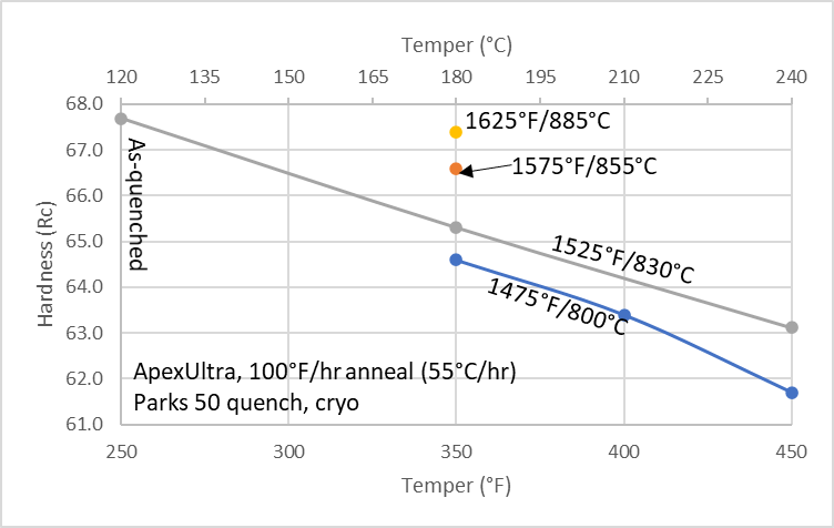

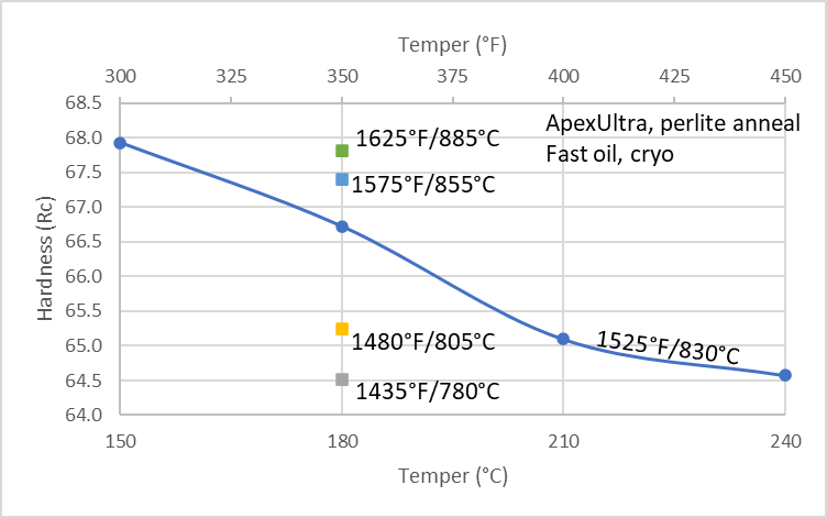

Tempering
Below I have tempering curves for both the 100°F/hr (55°C/hr) and perlite anneal conditions. The hardness drops with increasing tempering temperature as expected, and the tempered hardness of the perlite anneal is higher than the 100°F/hr (55°C/hr) as we have discussed already.
In terms of toughness we also have pretty standard behavior where toughness is increased with higher tempering temperatures. For some steels we see a drop in toughness with a 450°F/230°C temper though with others it doesn’t occur until 500°F/250°C. This is a phenomena called “tempered martensite embrittlement” and should be avoided since you get a reduction in both hardness and toughness. We tempered as high as 240°C/465°F without a drop in toughness so we can confidently recommend tempering as high as that. There also wasn’t a drastic drop in toughness even when tempering as low as 300°F so tempering that low is also acceptable. Some steels like 5160 drop in toughness significantly when tempering that low which is why we tested it. So the range of 300-450°F works well, depending on final desired hardness.

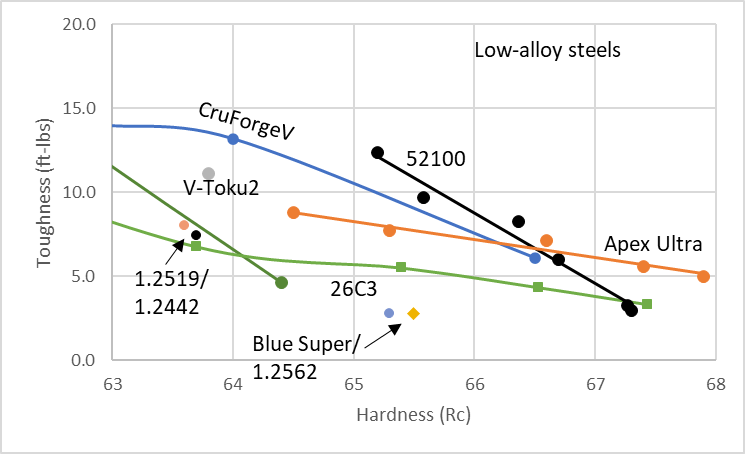

  2. in what properties is the steel superior to 52100? looking at the hardness/toughness tradeoff its only better at over 67 hrc. actualy a bit disapointing in view of the higher cleanliness. is it maybe the price/edge retention relationship? (no idea what the steel costs.)
    i realize the graphs are only a rough indication (because of statistical issues) but still.
    1. ApexUltra is designed to have higher wear resistance than previous low alloy forging steels. It is basically 52100 with extra tungsten and vanadium carbides. I don’t understand why your expectation would be for ApexUltra to be tougher than 52100. It is surprising that ApexUltra is tougher at any hardness.
