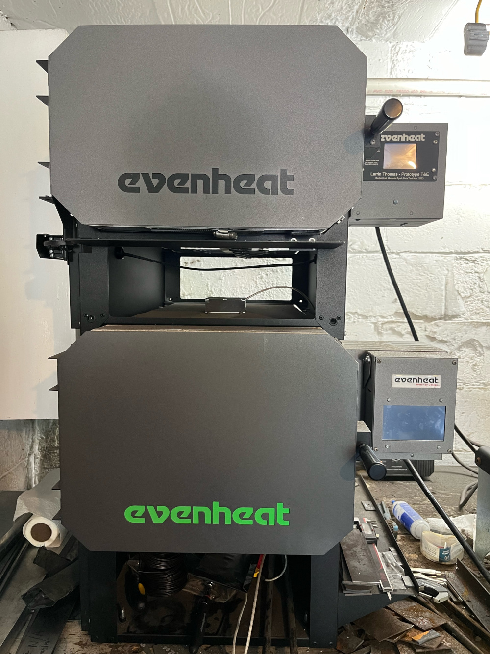

Furnaces for Heat Treating
The basic piece of equipment for heat treating is a furnace. A forge can also be used but it isn’t my favorite method. I have recommendations on how to properly heat treat with a forge here. There are several manufacturers of furnaces and some knifemakers will make their own. I use EvenHeat furnaces, I have a KO 22.5, an LT 22.5, and a Salt Bath 709. The KO model is the high temperature model that can reach 2350°F. I previously had the LB model which has a somewhat larger chamber (width and height) with the tradeoff that it reaches 2200°F. The LT model is designed for tempering up to 1200°F. A regular furnace can also be used for tempering but they aren’t “tuned” and calibrated for low temperature, and you have to wait for the furnace to cool down before tempering. You can also use a conventional oven for tempering though the temperature will be more variable.
One of the big decisions for a heat treating furnace is 120 or 240V. The higher voltage EvenHeat models are roughly twice as fast and also have larger chambers. This makes heat up time twice as long with the low voltage and it takes longer to “rebound” after opening the door and inserting steel. It is better to use 240V if possible, and if you don’t have the capability for doing that you should contact an electrician. Another important decision is the depth, or length, of the furnace. It is usually a good idea to get one a bit longer than you think you would need. If you ever wanted to make a longer blade such as a bowie or kitchen knife you will need a relatively long furnace. Also the temperature is usually somewhat different at the ends of the furnace, especially right next to the door. So having some space between the blade and the front/back is a good idea.

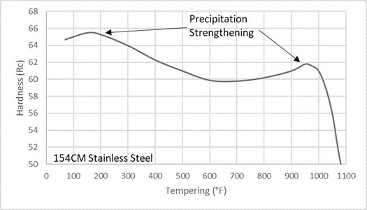

After quenching, the steel is very high in hardness, but is also brittle. During tempering the steel is reheated to a lower temperature to increase toughness and reduce brittleness. The hardness of the steel is also lowered somewhat (see the MagnaCut chart from earlier or the chart below).
Tempering Chart for 154CM
Typically steel is tempered at least twice, and each temper is usually 1-2 hours long. Tempering at a higher temperature usually decreases hardness though there is an exception called “secondary hardening” in high alloy steels when tempered between about 750 and 1100°F (400-600°C). You can read about the mechanisms behind tempering in this article. Tempering can be done in a conventional oven or in a heat treating furnace after it cools down. I have some tips on using a heat treating furnace for tempering in this article. EvenHeat also makes a furnace designed for tempering.
More complete tempering chart for 154CM that shows “secondary hardening” above 750°F (400°C)

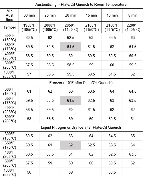

There is an optional “cold treatment” step during heat treating that can increase hardness. Some datasheets recommend this in between tempering steps but I prefer it directly after quenching. In effect it is an extension of the quench down to a lower temperature. A delay between the quench and the cold treatment can lead to less effect of the cold treatment. The MagnaCut chart from before has hardness values from quenching to room temperature, performing a cold treatment in a household freezer, or a cryogenic treatment in liquid nitrogen. No real hold is necessary at the low temperature, the steel just needs to reach the temperature. Typically 30-60 minutes is enough. I have an article on cryo treatments of AEB-L where I discuss a lot more about how cryo works.
“As quenched” hardness of AEB-L with no cold treatment, a freezer, or liquid nitrogen from different austenitizing temperatures.
You may have noticed that hardness can drop if the austenitizing temperature was too high; Using 1900°F (1035°C) austenitizing temperature with AEB-L only resulted in around 0.5 Rc increase in hardness by using liquid nitrogen. From 1975°F (1080°C) the hardness went up from 60.5 Rc to 64 Rc.

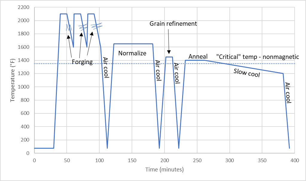

Extra Steps After Forging – Normalizing and Annealing
When steel is forged it is no longer in the annealed condition. It may not be soft enough for cutting, drilling, etc. And it is not in the best condition for performing the austenitize, quench, and temper. The basic process that needs to be followed is a normalize and anneal. Normalization involves heating to a relatively high temperature (usually somewhat higher than an austenitizing temperature like 1650°F), and then air cooled. This gives the steel a uniform microstructure and grain size. Annealing is done from a temperature typically a bit lower than austenitizing (like 1400°F) and then slow cooled. Annealing makes the steel soft and sets it up for the final heat treating steps. You will also notice below an optional step labeled “grain refinement” that I generally recommend skipping as I have not found an improvement with my testing. This step is relatively common with knifemakers but not in industry and is not recommended in datasheets.
I have an article that describes this process and provides recommended temperatures for normalizing and annealing different steel. For those few brave knifemakers I also have an article on how to anneal stainless steel and high alloy steel after forging it.

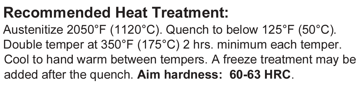

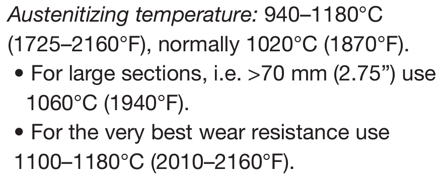

Datasheets will often given ranges for possible austenitizing and tempering temperatures. The first thing you should look for is a “recommended” heat treatment. You can modify from there of course but this gives a good starting point. Here are a couple examples:
From the MagnaCut Datasheet
From the Vanadis 4 Extra Datasheet
If the datasheet only gives a range for austenitizing I would start with something in the middle of the range. MagnaCut datasheet says 1950-2200°F and halfway in between that would be 2075°F (1135°C), close to the 2050 recommendation. Vanadis 4 Extra says 940-1180°C which would be 1060°C (1940°F), the same as their recommendation for “large sections.”

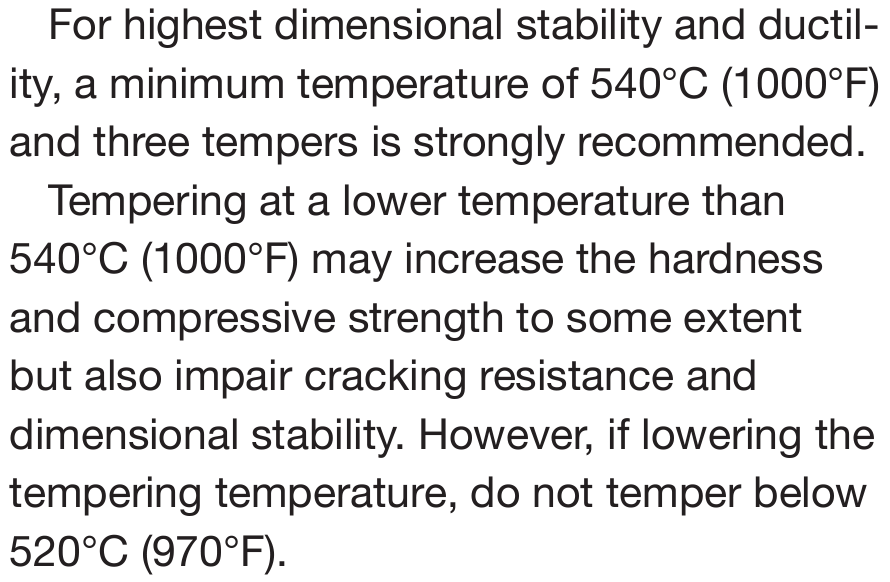

For tempering a good starting point is usually 400°F (200°C) or 1000°F (540°C). 400°F is good for most steels, though some high alloy and high speed steels will recommend the 1000°F temper. Often these steels can also be tempered at 400°F but the austenitizing temperature would also need to be adjusted based on that change and that would take some work to figure out.
Another thing you can do is check the back of my book Knife Engineering. I give recommended temperatures for most steels in there.
For many datasheets there are many temperature combinations that could work and it is mostly about selecting a target hardness. 58-63 Rc is a good range to target for many knives; use the higher end for thin slicing knives (and careful customers) and lower for knives that need higher toughness. 60 Rc is a good round number if you want a starting point and aren’t sure.

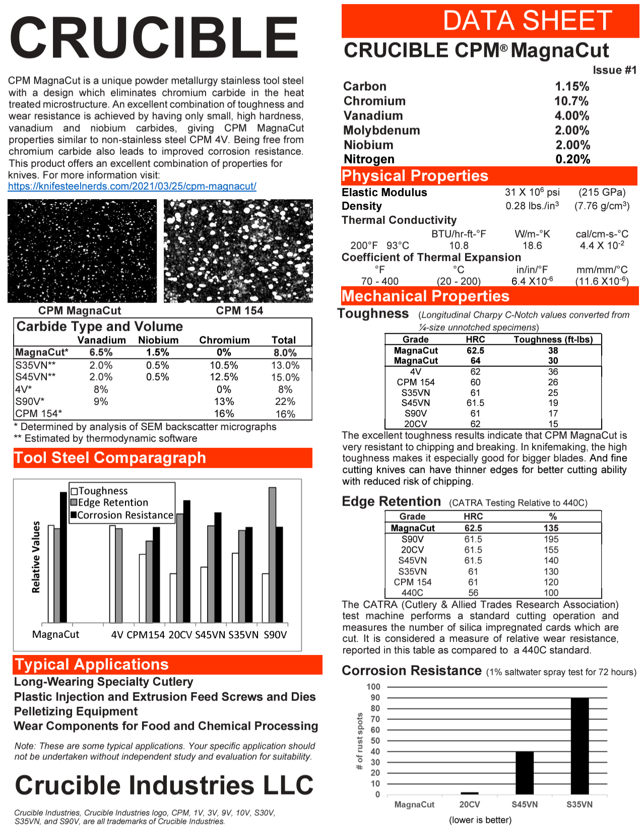

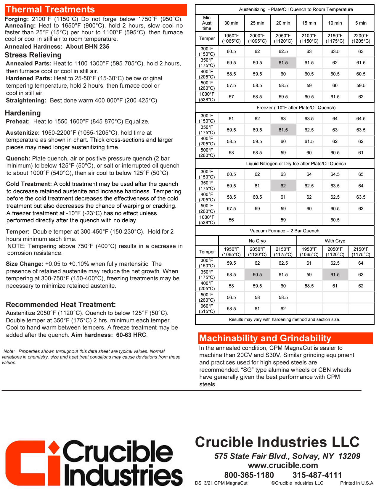

Every datasheet is a bit different but I will break down the various parts of datasheets with the MagnaCut datasheet:
Page one of this datasheet (and often multiple pages of other datasheets) is mostly information about the steel. That top left paragraph describes the steel and its general properties. Next it shows micrographs where you can see that MagnaCut has a much finer microstructure than CPM-154. Below that is a table with information about the carbide types in MagnaCut vs other steels. Then a “Tool Steel Comparagraph” shows bar charts of properties of MagnaCut vs various comparison steels. “Typical Applications” serves to tell potential buyers in different product categories when they might want to look at MagnaCut. At the top right you find the composition. Below that is some physical properties which most knifemakers don’t need. Then some test results showing how MagnaCut stacks up in toughness, edge retention, and corrosion resistance.
On the second page we find the actual temperature recommendations that we have been discussing. First is the forging and annealing temperatures, which of course you don’t need unless you actually forge the steel.
Stress Relieving
Below that is a category of treatments called “Stress Relieving” which we have not discussed thus far. These treatments are optional but can be useful in certain scenarios. During grinding and machining various stresses are built up in steel that can lead to increased movement and warping during heat treating. Performing a stress relief can help with this, where it says, “Annealed Parts: Heat to 1100-1300°F…” Stresses can still be built up during grinding of heat treated steel which required a temperature just under tempering. This is because we don’t want to overtemper the steel, of course.
Size Change
This datasheet also lists the estimate size change after heat treating the steel. The heat treated structure is slightly larger than the annealed structure of ferrite. So typically we expect a small increase in the size of the part after the heat treatment is complete. Using a higher austenitizing temperature will reduce the size increase somewhat, and could even lead to shrinkage. Using cryo would lead to a larger size. This is from retained austenite (higher austenitizing temperature) or from converting more retained austenite to martensite (cryo). You can read about what all of that means in my cryo articles.
