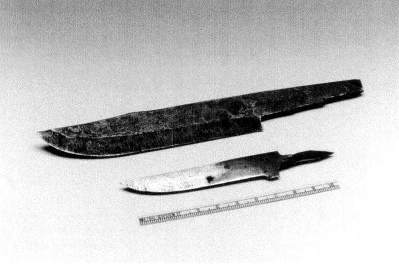

Because of this interesting background to Richtig and his impressive knives, researchers at Lawrence Livermore National Laboratory in California investigated Richtig’s knives, which resulted in a paper published in 2000 in Materials Characterization [2]. They were intrigued by the unknown heat treatment he used, where they quoted Glen Lambert who visited Richtig in the 1960’s. Lambert wrote an article on Richtig that appeared in Knives annual 1984. When Lambert asked how he heat treated his knives, Richtig replied “A man is entitled to some secrets and that’s mine,” and “[He] told me that he had found no one worth of being told or taught his knifemaking, and until he did, nobody was going to get his ‘secret.’ During his declining years, no one came forward, and when he passed away in the early 1970s, so did the tempering process.”
The researchers looked at two knives, one 180 mm (7-1/16″) long and the other 100 mm (3-15/16″).
They measured the composition with spectroscopy and found the steel to be 1090 or 1095, with 0.86-0.93% carbon with small amounts of Cr, Mn, and Si. So the steel used was nothing out of the ordinary in Richtig’s knives. They also measured hardness for the knives with the large knife ranging between 36-46 Rc with an average of about 39 Rc and the small knife 40-56 Rc with an average of 50 Rc.

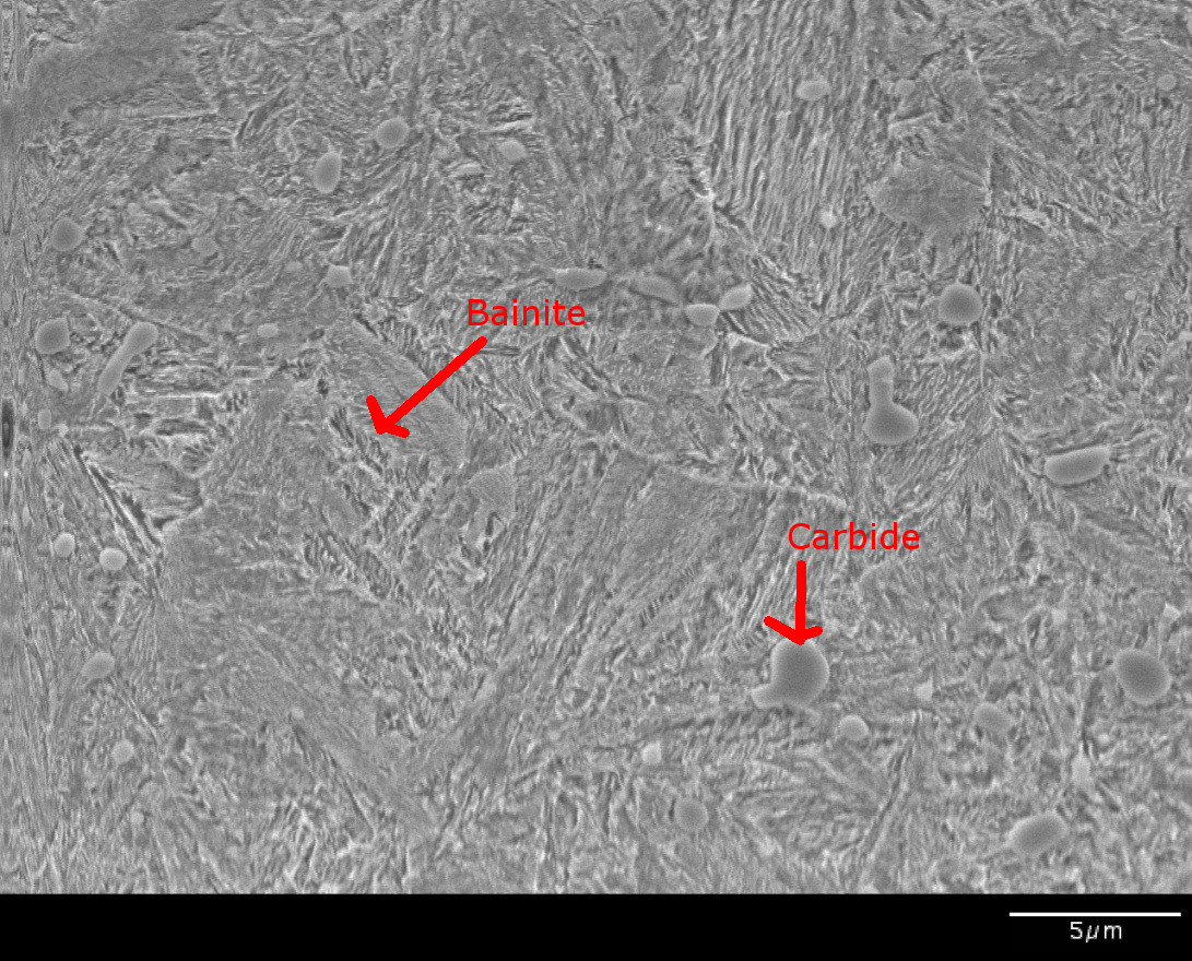

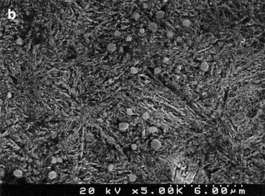

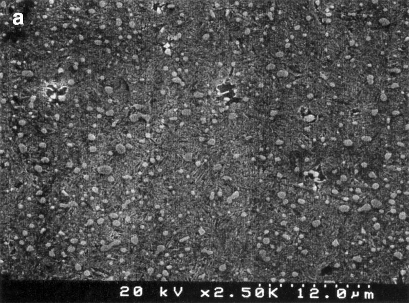

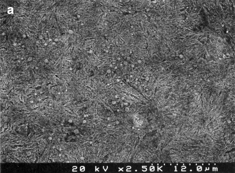

The researchers also looked at the microstructure of the knives which they interpreted as showing “a uniform distribution of spherical, proeutectoid carbide particles in a matrix of ferrite and fine cementite (white particles within the matrix).” It is difficult to differentiate between bainite and martensite, so in comparisons with 52100 in both microstructures they hedged their bets, “the microstructure of the Richtig steels matches most closely the microstructure of the 52100 steel Q&T at 500°C or austempered at 400°C.” I previously wrote an article about the differences between bainite and martensite, which you should read to follow the rest of this article.
Large knife low magnification [2]
Large knife high magnification [2]
Small knife low magnification [2]
Small knife high magnification [2]

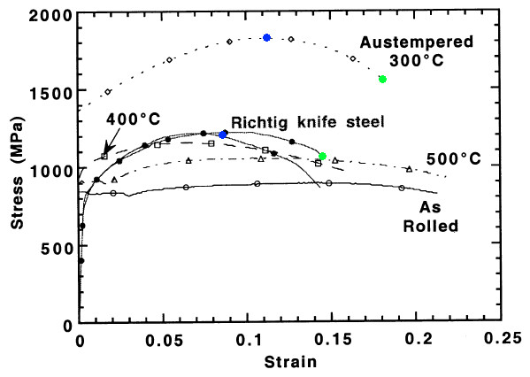

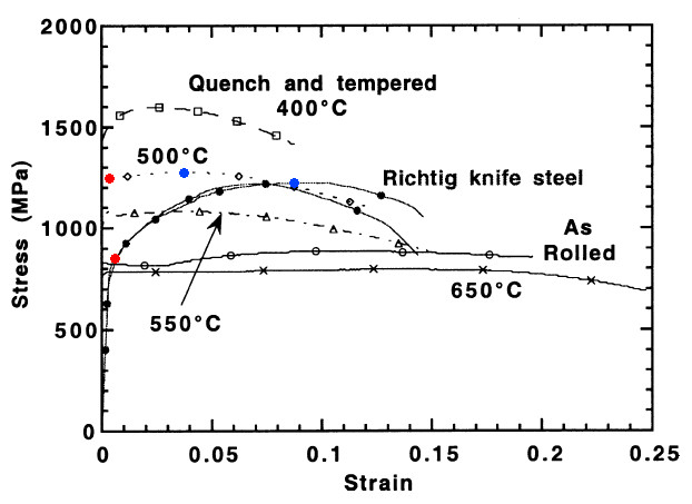

In an attempt to determine if Richtig’s knives were made up of bainite or martensite, they performed tensile tests on the large knife steel (which was 39 Rc on average). They used very small tensile specimens because they had to take the tensiles out of a knife rather than a large bar of steel. Tensile testing involves pulling a piece of steel until it breaks. This results in a “stress-strain” curve which represents the properties of the steel. Strain is a measure of how far the steel was pulled, and stress is a measure of the load applied to the specimen. This results in a few important properties such as the “yield strength” which is the stress at which the steel has begun to permanently deform (as opposed to returning to its original shape), the total elongation (how far the steel was stretched prior to breaking), and the ultimate tensile strength (the stress required to break the piece). I introduced tensile testing in this article on flexing steel, and how it relates to toughness in this article.

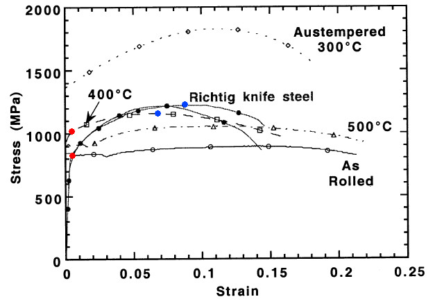

They also compared the measured tensile properties of the Richtig knife with various heat treatments of 52100 to determine which was closest to Richtig’s knife. They first compared with “quench and tempered” 52100. Quenched and tempered steel is the most common method of heat treating knives where the steel is heated to high temperature (austenitizing) and then quenched such as in oil or water, and then tempered at a lower temperature such as 200°C (400°F). Comparing with quenched and tempered 52100, they found that a 500°C temper of 52100 led to similar ultimate tensile strength (I’ve marked in blue), but the yield strength (marked with red) was much lower with the Richtig knife. So they concluded that the Richtig knife was not quenched and tempered.
They next compared with “austempered” 52100. Austempering is to form bainite, where instead of quenching to room temperature in oil, it is quenched to an intermediate temperature such as 250°C (500°F) and held there to form bainite. Tempering afterward is optional as austempering is sort of like quenching and tempering in one step. They found that the yield stress was significantly lower in the austempered 52100 (as opposed to Q&T) so they concluded that Richtig likely austempered his blades, which would help explain the low yield stress. So they proposed that Richtig heat treated his knives by austempering at approximately 400°C for the large knife and 300°C for the small knife, the different austempering temperatures explaining the difference in hardness between the blades.

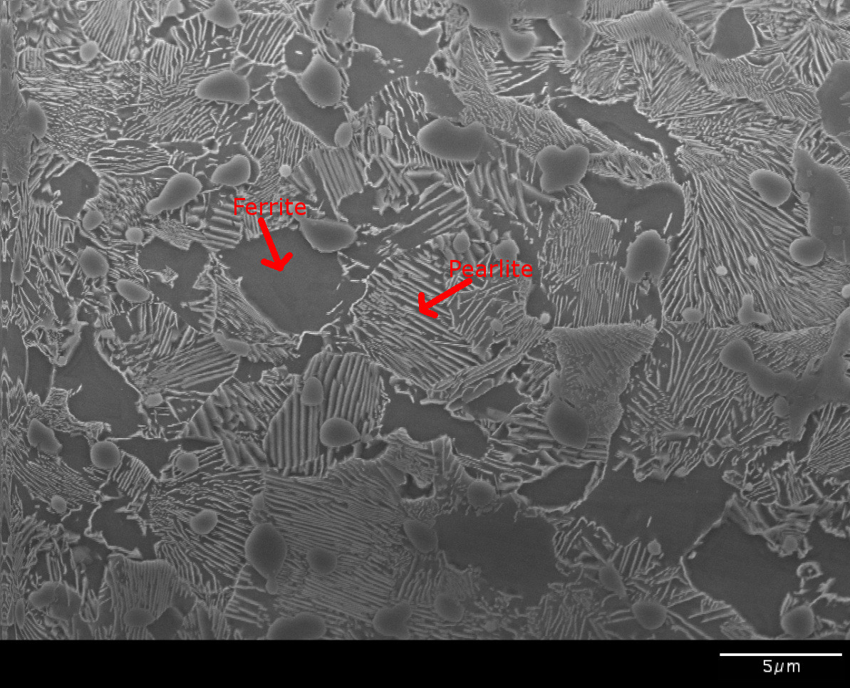

The researchers looked at the microstructure of the steel they heat treated and found that using sufficiently high austenitizing temperature along with austempering would lead to a bainitic microstructure free of pearlite and ferrite. I have pointed out the bainitic microstructure which has a lath-like appearance which has very tiny carbides making it look “fuzzy.” I’ve also pointed out the larger “proeutectoid” carbides which are those not dissolved during austenitizing.
Image from [3]

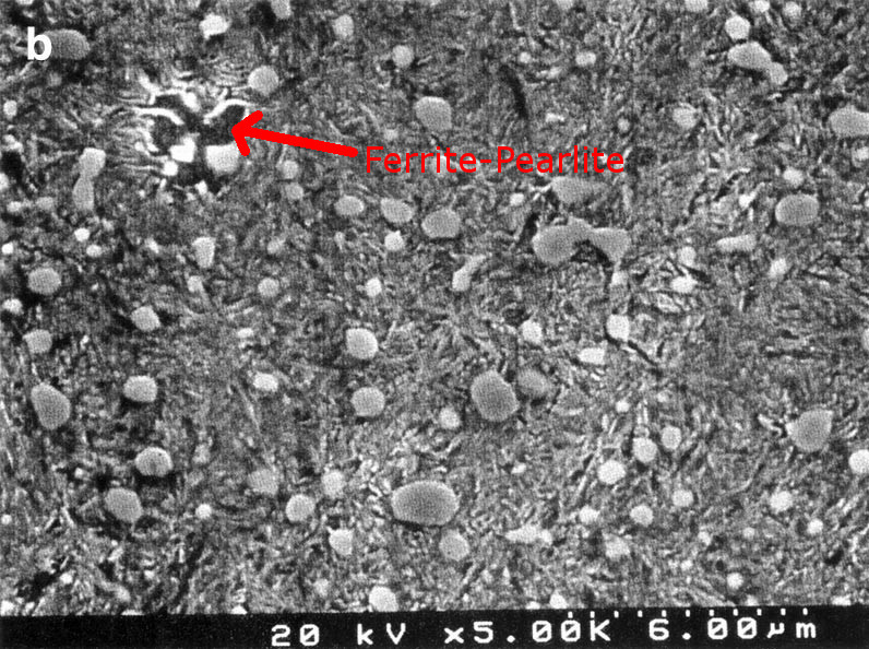

However, with the low austenitizing temperature, such as 760°C, the steel was not fully austenitized, leading to ferrite and pearlite in the microstructure:

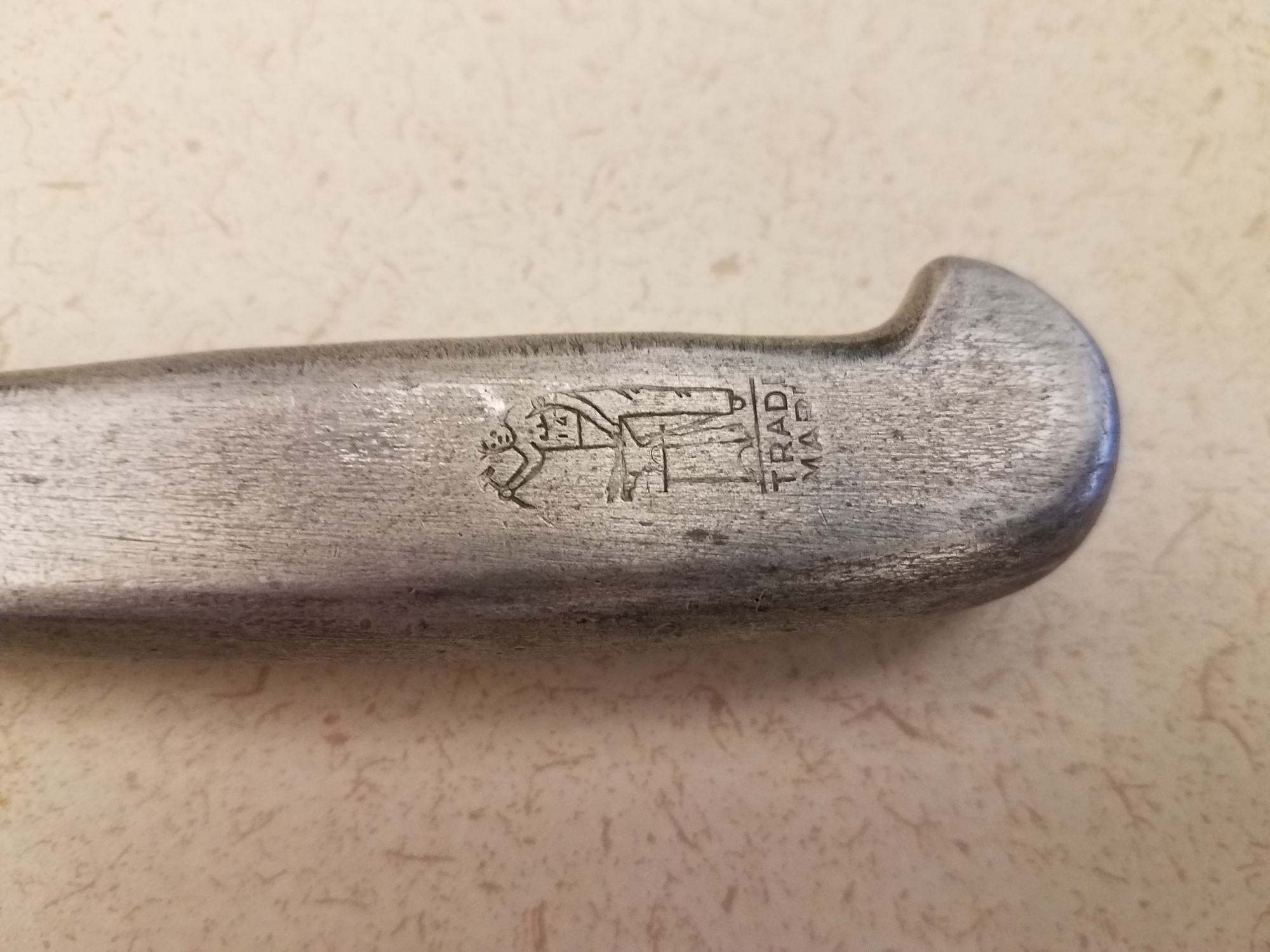

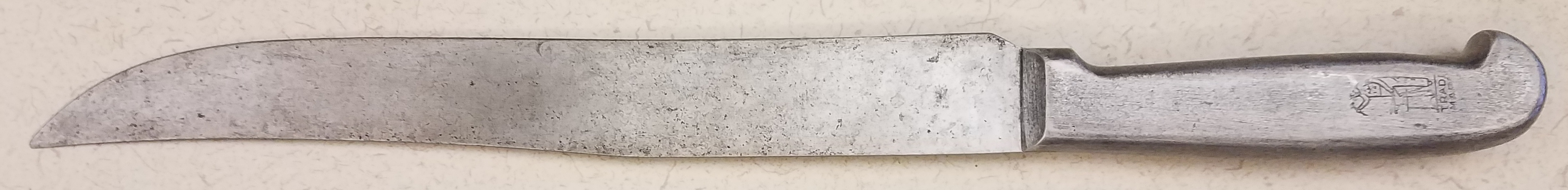

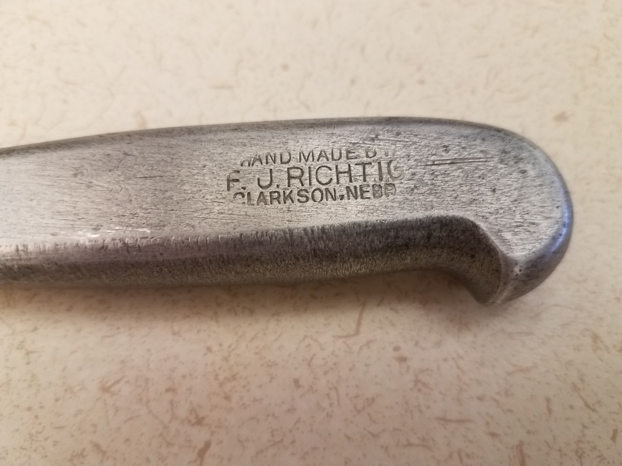

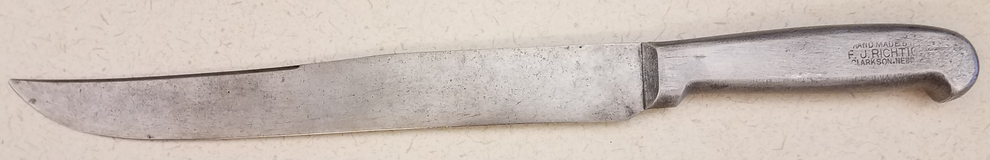

My Richtig Knife
I was able to find an inexpensive Richtig knife on eBay recently. It may have been so cheap because a small piece of the tip was broken off, which doesn’t affect why I am buying it: to study it. It is a butcher knife, which appears to have been one of his common models. It is about 0.055″ at the spine and 0.012-0.014″ at the edge. The grind is very consistent, and the handle relatively simple and comfortable. It has a cast aluminum handle like the majority of his knives did. His back handle stamp is a simplified illustration of his picture in Ripley’s Believe it or Not, which is fun. So far I have only measured the hardness of my knife, but will eventually cut it up to do microscopy and microhardness.

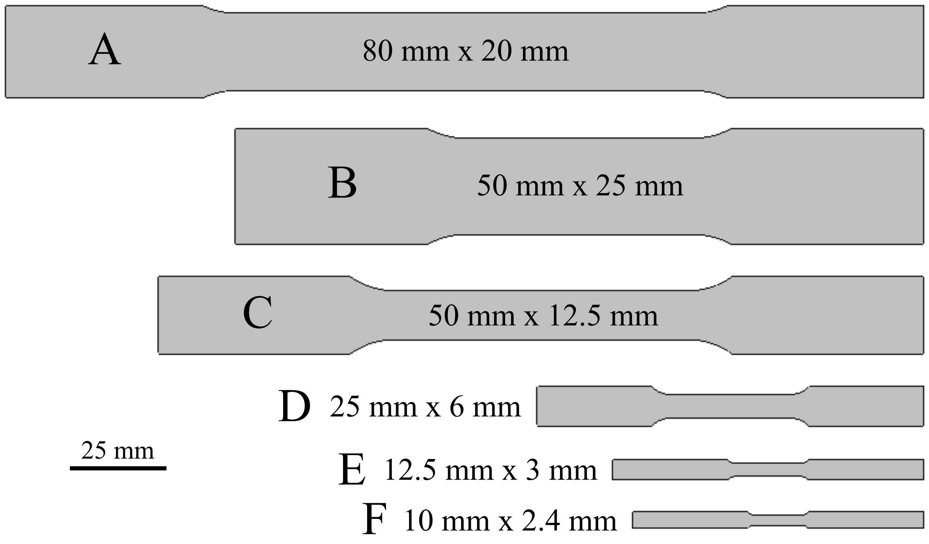

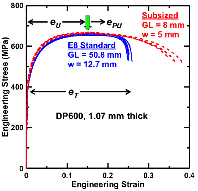

Gage Length
The two papers used two different tensile specimens. This may not seem important on the surface, but the “gage length” (shown below) has a strong effect on the recorded total elongation. This may explain why the total elongation was too low in the tensile specimens used with the attempted replication. The Lawrence Livermore researchers used a tensile specimens similar to “E” below with a 12.5 mm gage length while the researchers who attempted to replicate the heat treatment used “B” which has a 50 mm gage length.
Image from [4]
Subsize specimens with a short gage length have much higher total elongation as shown below, one with 8 mm gage length and the other with 50 mm. The 8 mm gage length has about 35-38% total elongation while the 50 mm has only about 25%. This helps explain why they were unable to match the elongation of the Richtig knife, because they were using bigger tensile specimens.

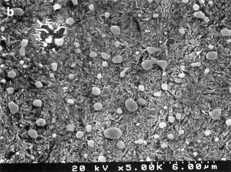

Another evidence of the large knife being underaustentiized is there is much more carbide present in the large knife which would indicate it was austenitized at a lower temperature and/or less time. I wrote an article about carbides dissolving during the high temperature austenitizing process in this article. Compare the spherical particles here:
Small knife which has relatively few spherical carbide particles
Large knife with many more carbide particles, some evidence of ferrite and/or pearlite
Therefore the difference in hardness between the two knives appears to be because of differences in austenitizing rather than the selection of austempering temperature. Why it was underaustenitzed is harder to know for sure. Possibilities include:

Superior properties in 52100
In the Materials Characterization article they compared to various austempered heat treatments of 52100. In a condition austempered at 300°C, both higher strength (blue, y-axis) and total elongation (green, x-axis) was achieved relative to the Richtig steel. So while the authors were complimentary of the Richtig properties, a cursory comparison with austempered 52100 revealed superior properties being possible.
