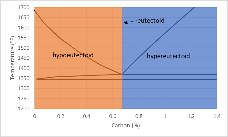

Another useful division between steels in the “eutectoid” point which I have labeled below, to the right of the eutectoid is high carbon “hypereutectoid” steel and to the left of the eutectoid is low carbon “hypoeutectoid” steel:
With steel at the eutectoid carbon content, heating it above 1360°F or so, the steel enters the austenite field marked in yellow in the first Fe-C diagram. The steel has transformed from “ferrite and carbide” to austenite. Austenite is the high temperature phase of steel which has a different arrangement of iron atoms than ferrite and has different properties, such as being non-magnetic. Heating to form austenite is an important part of heat treating called “austenitizing” which you can read about in this article. The carbide has dissolved to form the new phase, austenite, so all of the carbide is now gone. Low carbon hypoeutectoid steel transforms in a similar way except for it passes through the orange “austenite + ferrite” phase field, meaning that the steel transforms from ferrite to austenite over a range of temperature, and can have both phases present even after infinite hold times in that region. However, once it has reached a high enough temperature to enter the austenite phase field, after some time for the transformation to complete, it will be fully austenite with no carbide.
High carbon hypereutectoid steel is somewhat different, however, as it has the “austenite + cementite” field marked in blue. When the steel is heated to the temperature of austenite+cementite, some of the carbide dissolves to transform the low carbon ferrite to higher carbon austenite, but some fraction of carbide remains. If heated to yet higher temperatures, the carbide eventually dissolves in the yellow “austenite” phase field. High carbon knife steels are intentionally heated to the “austenite + cementite” phase field and quenched so that some carbide is retained. Learn about what happens during quenching in this article. Those carbides contribute to wear resistance, which in knives improves edge retention. The quenched steel is in a “non-equilibrium” state with high hardness, carbon-enriched martensite and less carbide than in the “ferrite+cementite” state it would like to be in. This is why in tempering very small carbides are precipitated as the steel attempts to reach that equilibrium state. Learn about the very small carbides that form during tempering in this article. At yet higher temperatures and sufficient time, the steel eventually reaches something close to the equilibrium state again where it is soft and easy to work. That process is a type of annealing, which you can read about here: Part 1 and Part 2.

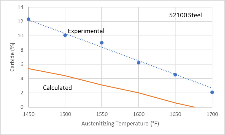

While sticking with simple iron carbide, the amount of cementite is controlled by the temperature of austenitizing and the amount of carbon. Lower austenitizing temperatures means more carbide and higher carbon means more carbide. Below is carbon content vs volume of cementite at a fixed temperature of 1375°F, where you can see that carbide increased with carbon above the eutectoid carbon content:
And carbide volume vs temperature for a 1.3% carbon steel to see how the amount of carbide decreases with higher austenitizing temperatures:
The above calculations are for equilibrium meaning an infinite hold time. In practice the carbide content is somewhat higher because some specified hold time at the austenitizing temperature is used prior to quenching. For example, below is 52100 steel (1% C, 1.5% Cr) with a 30 minute hold time prior to quenching, in comparison with the calculated values:

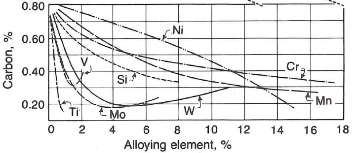

The eutectoid carbon content is not stagnant, but can change based on other alloying elements. For example, the above Fe-C phase diagrams I was showing were actually for a steel with 0.3% Mn and 0.3% Si, since those alloy elements are in most steels. The “pure” Fe-C eutectoid carbon content is at a somewhat higher carbon content, about 0.77%. The reduction in the eutectoid carbon content means that there is more carbide remaining undissolved after austenitizing. And that less carbon is required in the steel to have the “austenite + carbide” phase field. For example, below is the shift in the eutectoid with different chromium contents. With 0% Cr the two lines meet at 0.77% carbon, to the right of that carbon content is hypereutectoid steel with the austenite+carbide phase field. At 5% Cr, that carbon content has been shifted down to about 0.5% carbon, and down to only about 0.35% carbon at 19% chromium. So stainless steels and tool steels with significant chromium additions need less carbon to have carbides for wear resistance.
All alloy additions drop the eutectoid carbon, as can be seen in this simple plot:

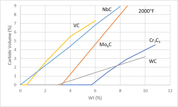

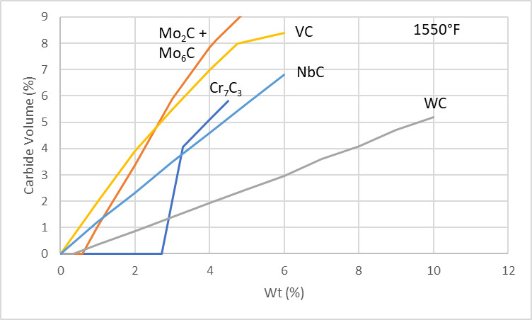

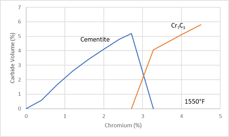

Different alloy additions are “stronger” carbide formers than others. Most elements have some minimum amount that needs to be added before the new carbide type is formed. And when multiple elements are added, there is somewhat of a competition where the strongest carbide former is the most likely to form carbides. For an example I have the effect of chromium additions on the carbide volume of a 1% carbon steel at a temperature of 1550°F:
You can see that up to a chromium content of about 2.7%, no “chromium carbide” is actually formed, it only increases the amount of cementite. There is a small amount of chromium that becomes a part of the cementite. So a steel like 52100 with 1.5% chromium does not usually form a chromium-rich carbide like Cr7C3 or Cr23C6 but rather has cementite which has been slightly enriched in chromium. You can read about 52100 and why chromium increases the amount of carbide in this article. Below is the amount of chromium carbide vs chromium content at a higher temperature of 2000°F. Just like with iron carbide, at higher temperatures more carbide is dissolved, so that more chromium is necessary to have some chromium carbide. And cementite never appears in the plot below because it dissolves at lower temperature:
Below is a chart showing how much carbide is formed after adding a given amount of the element in a 1% carbon steel at two different temperatures. The element in question is indicated by the alloy carbide listed next to its curve. So the NbC line is relative to Nb added to the steel in weight percent. Alloy carbides form at small additions of V and Nb. NbC is seen with the smallest Nb addition even at 2000°F. Greater amounts of Mo, Cr, and W are necessary to form carbides at 2000°F, showing that those carbides are not as stable and will dissolve at higher temperatures.

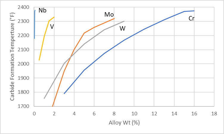

Niobium and titanium are very strong carbide formers, so adding a little bit of niobium will give you a little bit of niobium carbide, even at relatively high temperatures. Stronger carbide formers tend to lead to carbides that form at high temperatures and are stable up to approximately the temperature at which they form, so they don’t dissolve until very high temperatures. Below I have shown the formation temperature for carbides with different alloying elements added to a 1% carbon steel.
Carbides forming at higher temperatures usually means they are larger in the final product, which can be detrimental to toughness. The higher the temperature, the faster diffusion is so the carbides grow relatively rapidly. When no solid is present around the carbides they are able to grow more freely. If the carbide formation temperature is kept below 2000°F or so, the carbides will be dissolved at forging temperatures and re-precipitated at a lower temperature where they will usually be very small.

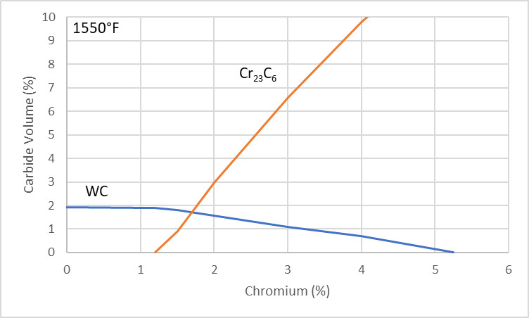

The tungsten carbide WC is found in low-alloy tool steels such as F2, 1.2562, 1.2519, O7, and Blue Super. Learn about these tungsten steels in this article. This carbide has a relatively unique position as being very high in hardness but also dissolves at forging temperatures (depending on the amount of W) so that the steel is easier to forge. The carbides dissolving at relatively low temperatures also makes the carbide easier to manage in terms of size. Many strong carbides will not dissolve until the steel melts which means they cannot be dissolved and re-precipitated at a lower temperature to make them smaller. One of the downsides of tungsten is that because it is a heavy element (in terms of atomic weight), so relatively large amounts of it are required to form a significant amount of carbide. At 1550°F, a 2% tungsten addition gives only about 0.9% WC while 2% vanadium gives about 4% VC.
Because tungsten is a relatively weak carbide former, it can be overpowered by other carbide formers, even chromium which is not the strongest carbide former as described earlier (need 2.7% Cr just to form chromium carbide). Most air hardening tool steels have at least 4% Cr, and that Cr reduces the amount of WC that is seen, below is a 1% carbon, 4% tungsten steel:
You can also see that the chromium carbide type which formed was Cr23C6 rather than Cr7C3 which is another of those peculiarities with carbides, when other alloy elements are present there may be a different carbide type that has formed.

So any steel with at least 4% Cr is unlikely to have any WC even with significant tungsten additions. This is doubly true with the higher austenitizing temperatures generally used with 4%+ Cr steels, usually at least 1700°F, because WC dissolves at lower temperature. When sufficient tungsten is added to a 4%+ Cr steel, WC doesn’t form in larger amounts, but a different carbide type forms instead, W6C. The W6C carbide is much softer than WC as shown in the hardness chart. This carbide is seen even with T1 high speed steel which has 18% tungsten.

This is a total “spectrum nitpick”, but in your description of the figure showing the eutectoid as f(Cr) content you said that the eutectoid was shifted down to 0.35% C at 19% Cr. If you look closely at the figure you’ll see that the 0.35% C eutectoid is on the 15% Cr contour. The 19% Cr contour has a vanishingly small austenitic region at somewhat higher C.
Sorry, but this sort of thing grabs my attention so I figured I’d point it out.
