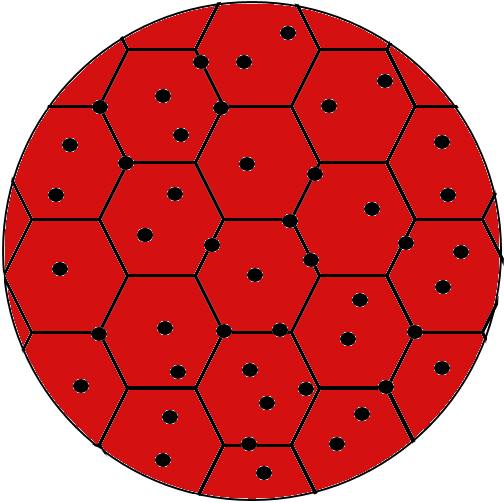

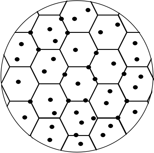

If we assume we start with an annealed microstructure of ferrite and carbides we get something that looks like the following schematic:
Here we have an idealized grain structure made up of boundaries and the black circles represent the carbides which are a very hard intermetallic made up of carbon and other elements such as iron, chromium, vanadium, etc.

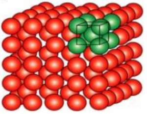

On a finer scale the ferrite is a “Body Centered Cubic” microstructure which can be represented by the following “unit cell” or the smallest possible unit which can describe the arrangement of atoms:
A BCC microstructure has an atom on each corner and one atom in the center, and is “cubic” or forming a perfect cube. In the unit cell each corner is repented by 1/8th of an atom which is shared by the surrounding unit cells, so when all of the unit cells are stacked together you get a complete BCC structure:

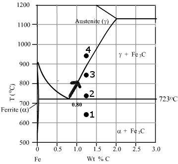

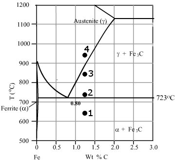

This microstructure represents “Point 1” on the following phase diagram [1]:
phasediag
If we heat the steel into the austenite + carbide region at point two the steel starts to transform to austenite rather than ferrite, first by nucleating austenite at carbides and at grain boundaries. Ferrite is very low carbon (<0.02%) but austenite requires much more carbon to be stable, something close to the eutectoid composition (~0.77%C). So the austenite nucleates on carbides since they are the source of carbon available. The carbides have to dissolve somewhat to feed carbon to the growing austenite. The carbides along grain boundaries are even more favorable because the grain boundaries are high energy areas, the steel “wants” to minimize its energy so the elimination of these boundaries is energetically favorable.

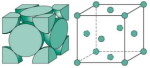

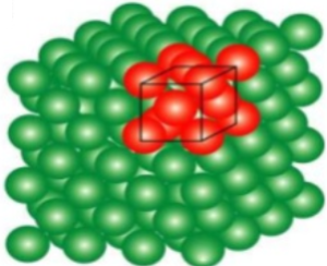

Austenite is a “Face Centered Cubic” microstructure, which again is a represented by a perfect cube with an atom on each corner, but instead of an atom at the center, an atom is present on each “face” of the cube, where half of an atom is in each unit cell:

With increasing temperature from that point the carbides dissolve leading to a smaller amount of carbide and the carbon content of the austenite increases corresponding to the line on the phase diagram indicated by the arrow:

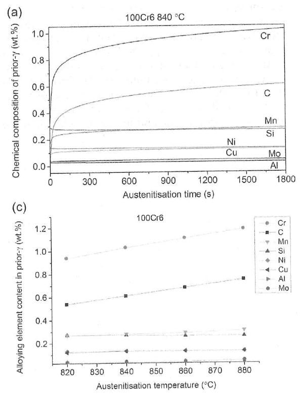

This doesn’t happen instantaneously, however, as it is limited by the rate of diffusion. Here is a model of carbon in solution with time for 52100 [2]:
52100 carbide dissolution
As the carbides dissolve the carbon and chromium in solution are increased as you can see in the chart.

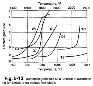

The type and distribution of carbides in tool steels affects the temperature at which grain growth occurs more rapidly, as can be seen in this chart for different tool steels [4]:

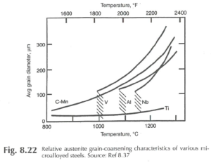

For low alloy steels the carbides dissolve at relatively low temperatures, but AlN are present in aluminum-killed steels to help suppress grain growth. Of course, vanadium additions are somewhat common to help suppress grain growth in steels such as W2 from the formation of a fine array of vanadium carbides. However, niobium and titanium can be even more effective for preventing grain growth due to the stability of NbC and TiC at very high temperatures [5]:
So grain size, carbon in solution, and carbide volume are controlled by the temperature and time at the chosen austenitizing temperature. One important aspect is the amount of other alloys in solution for sufficient hardenability, or elements like chromium for stainless steels. Sufficient chromium must dissolve in the austenite prior to quenching to martensite to ensure that good corrosion resistance is achieved. So there is a balance in choosing an austenitizing temperature to get the right amount of carbon and alloy is in solution, the correct carbide volume has been achieved, and excess grain growth has been avoided.
