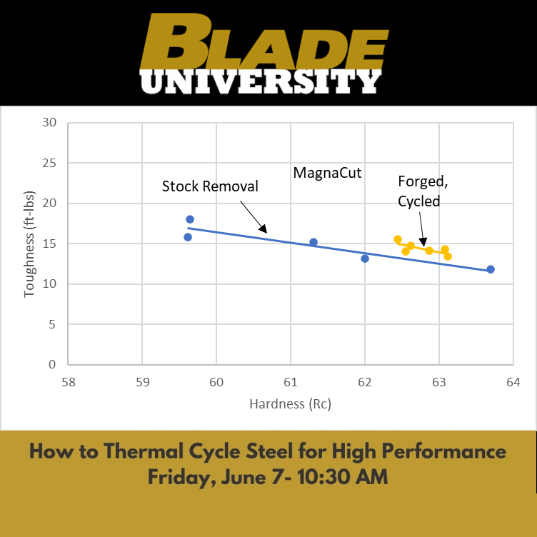

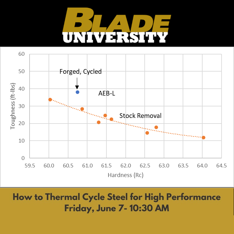

I will be at Blade Show Atlanta again this year. The big thing on my schedule is a Blade University class on June 7th, Friday morning. I have done different Blade University classes the past few years and it has been fun each time. This is a general class on thermal cycling using a lot of past studies that we have done which have been published to the website and in recent years to YouTube. However, we did a new study on AEB-L and MagnaCut to have better data on how to “thermal cycle” stainless and high alloy steels and we had some very interesting and exciting results. I am hoping that we can get some more bladesmiths to start forging stainless steels instead of the nearly-universal choice of carbon and low alloy steel. Buy tickets here: https://bladeshow.com/buy-tickets/
