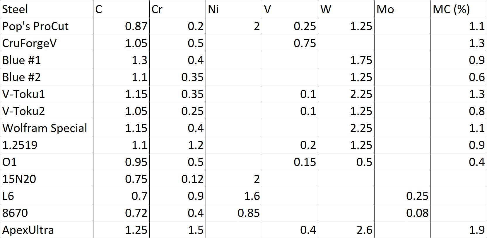

Composition and Tungsten/Vanadium Carbides
Here is the composition of Pop’s ProCut compared with other grades in its category. The far right column says “MC (%)” which is a calculation of how much total vanadium and tungsten carbide each steel contains after heat treating. One thing you will notice is that since tungsten is a heavy element it does not contribute as much to the MC as you might expect. For example, CruForgeV with 0.75% vanadium has more MC than Wolfram Special which has ~2.25% tungsten. ProCut uses a combination of vanadium and tungsten in a similar fashion to O7 and 1.2519 steels. So it has similar MC to steels like Blue #1, 1.2519/O7, and Wolfram Special, and more MC than Blue #2 and O1. The other nickel nickel steels (15N20, L6, and 8670) of course do not have any MC. These very hard carbides give the steel wear resistance.

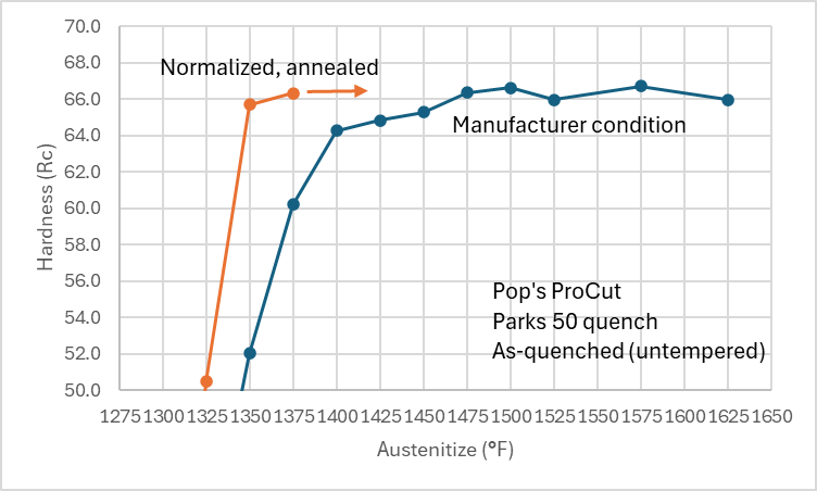

Austenitizing, Tempering, and Hardness
A major goal for this grade was to be “easy” to heat treat with a forge. This requires a wide range of austenitizing temperature where full hardness is achieved while avoiding a toughness drop with higher temperatures. 80CrV2 steel varies a lot with starting microstructure, and two of the mills that make the steel lead to very different heat treating response:
So we wanted to avoid this issue that 80CrV2 sees. We did this by keeping the chromium low and also working with the manufacturer to dial in the annealing procedure so that carbides aren’t too coarse (making them difficult to dissolve). I also compared the austenitizing response with my recommended anneal (described later):

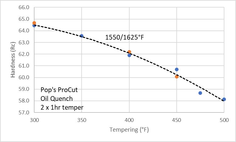

You can see that the hardness reaches its maximum around 1475°F and then does not change above that temperature. If using the anneal I recommend the microstructure is a bit finer and so this can be dropped even further to 1375°F. Thus for heat treating in a forge you can heat the steel to “a shade brighter” after reaching nonmagnetic and the steel will fully harden. If you forge and follow the recommending normalizing and annealing procedure you can even quench from nonmagnetic if you wish.

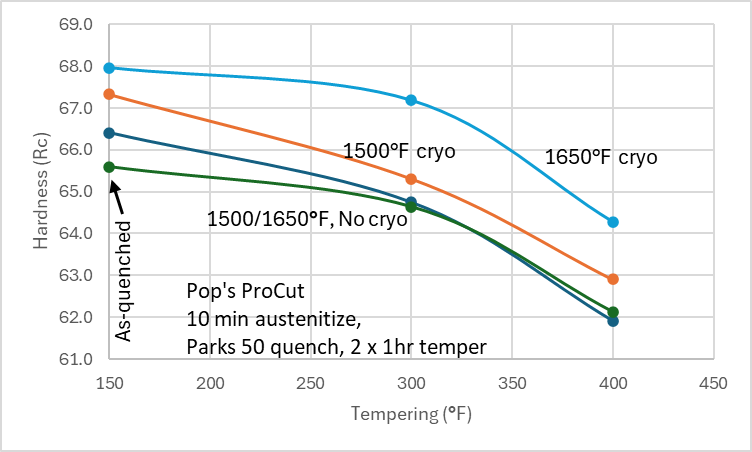

If the steel is austenitized in that range (1475°F or higher) the tempering is roughly the same regardless of the austenitizing temperature. Here are datapoints for both 1550°F and 1625°F:
You can see that the hardness is relatively high, still 64 Rc after tempering at 300°F, which is generally as low as I recommend for tempering most any steel. With a 450°F temper the steel is still above 60 Rc.

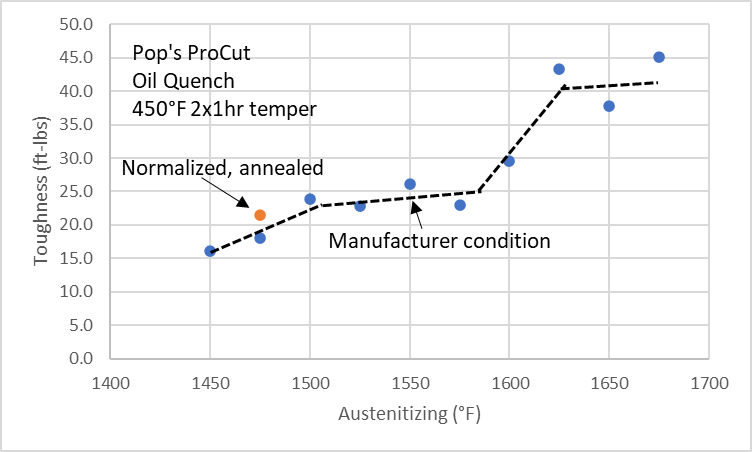

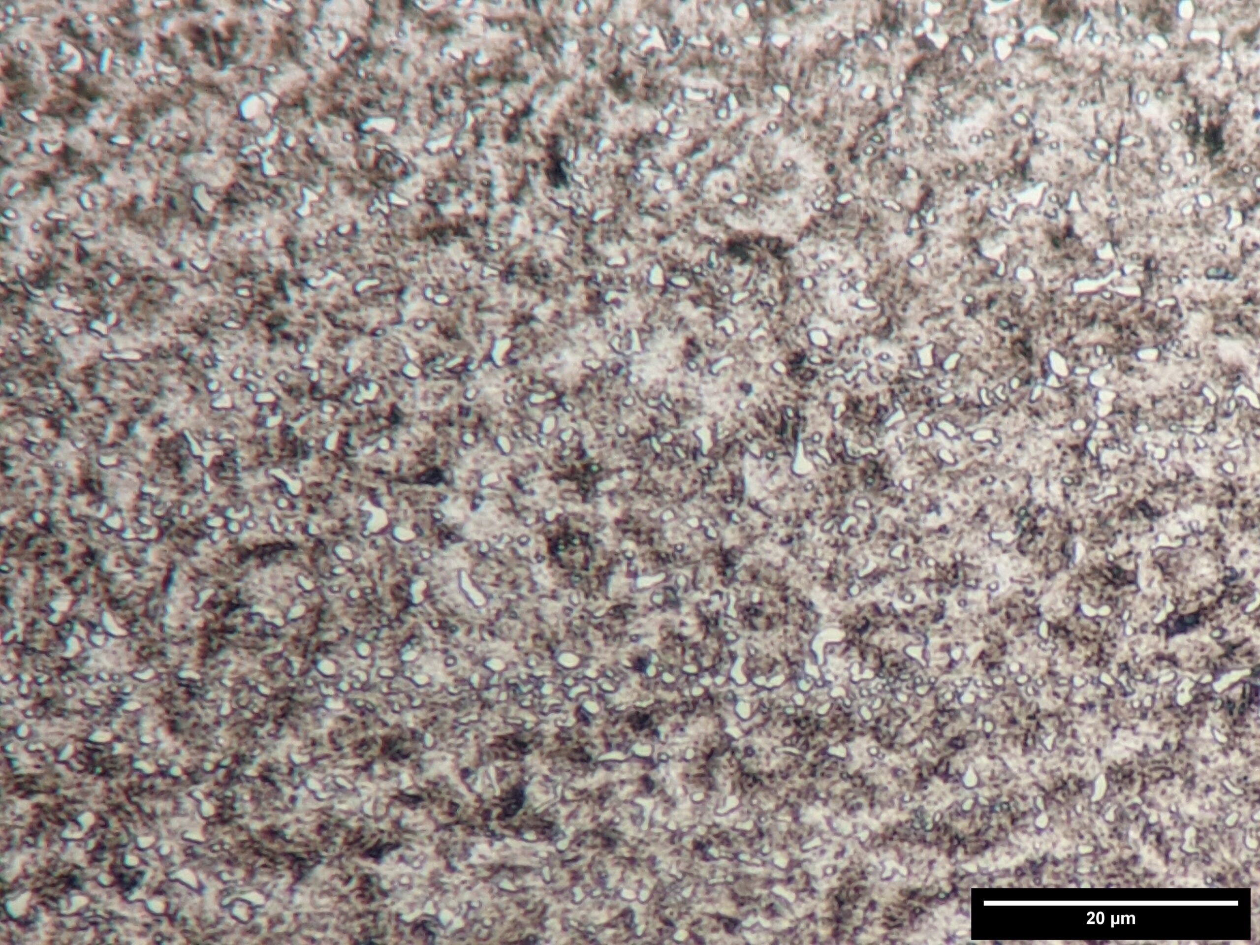

Austenitizing
In our heat treating and toughness experiments we found three different regions of toughness behavior:
Below 1500°F, the steel shows an increase in toughness with increasing temperature. From 1500-1575°F the toughness is roughly flat. 1625°F and above shows a big jump in toughness where it is flat again up to at least 1675°F. The reason for this behavior we figured out by looking at the microstructure. These images were taken by knifemaker Shawn Houston of Triple B Knives:
1425°F, 400°F temper
1475°F, 400°F temper
1600°F, 400°F temper
You can see that the carbide content is significantly reduced by austenitizing at 1475°F as opposed to 1425°F. This significant change in cementite (iron carbide) raised toughness. Then when the temperature is further increased to 1600°F and above, virtually all of the cementite is gone and all that remains is the small volume of hard vanadium and tungsten carbides. The presence of these small carbides is what prevents grain growth even at high temperatures. The carbides “pin” the grain boundaries.
15N20 and L6, in contrast, show a drop in toughness at much lower temperatures because they do not have those carbides to pin grains. The steel 1.2519 does have the W/V carbides but it sees a drop in toughness above 1500°F because it gets excess carbon in solution, leading to plate martensite. The carbon content in ProCut is controlled so that the matrix carbon does not reach excessive levels even at high temperature. This gives ProCut a very wide austenitizing range.

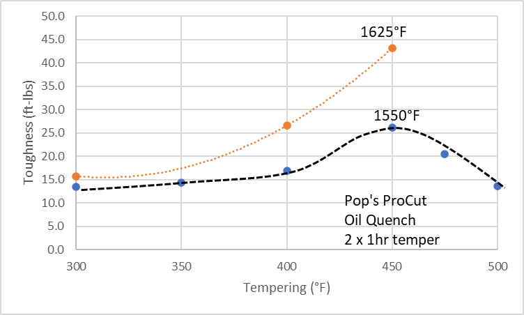

Tempering and Toughness
Like many other knife steels, ProCut sees a peak in toughness with a tempering temperature of around 450°F (230°C). Above that the toughness drops due to a phenomena called “tempered martensite embrittlement” which happens in all steels. There is lower toughness with tempering at lower temperatures as well, of course, corresponding with the higher hardness. The behavior of toughness with tempering temperature is roughly similar whether using the higher or lower austenitizing temperature range.

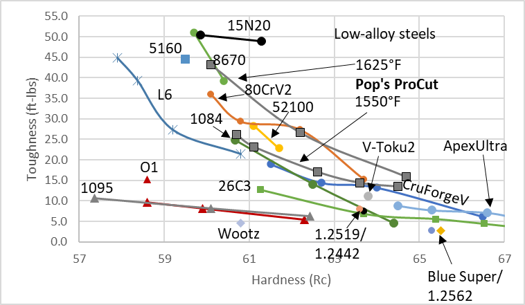

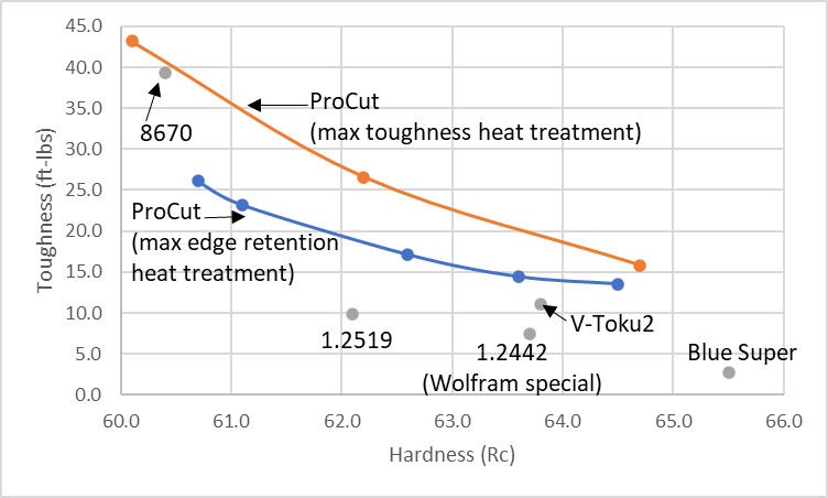

Hardness vs Toughness
This creates two different heat treating ranges, where the steel can be austenitized high (1625-1675°F) to max out toughness with some cost to wear resistance and edge retention, or austenitizing lower (1475-1575°F) to retain more carbide for wear resistance. The steel still maintains a toughness advantage vs previous tungsten/vanadium steels due to the nickel addition and controlled carbon content with the lower austenitizing range. However, with the high austenitizing range it achieves levels of toughness similar to 8670, 15N20, and L6 but with enhanced wear resistance due to the small tungsten and vanadium carbides.
To compare with other steels you can look at the following chart:

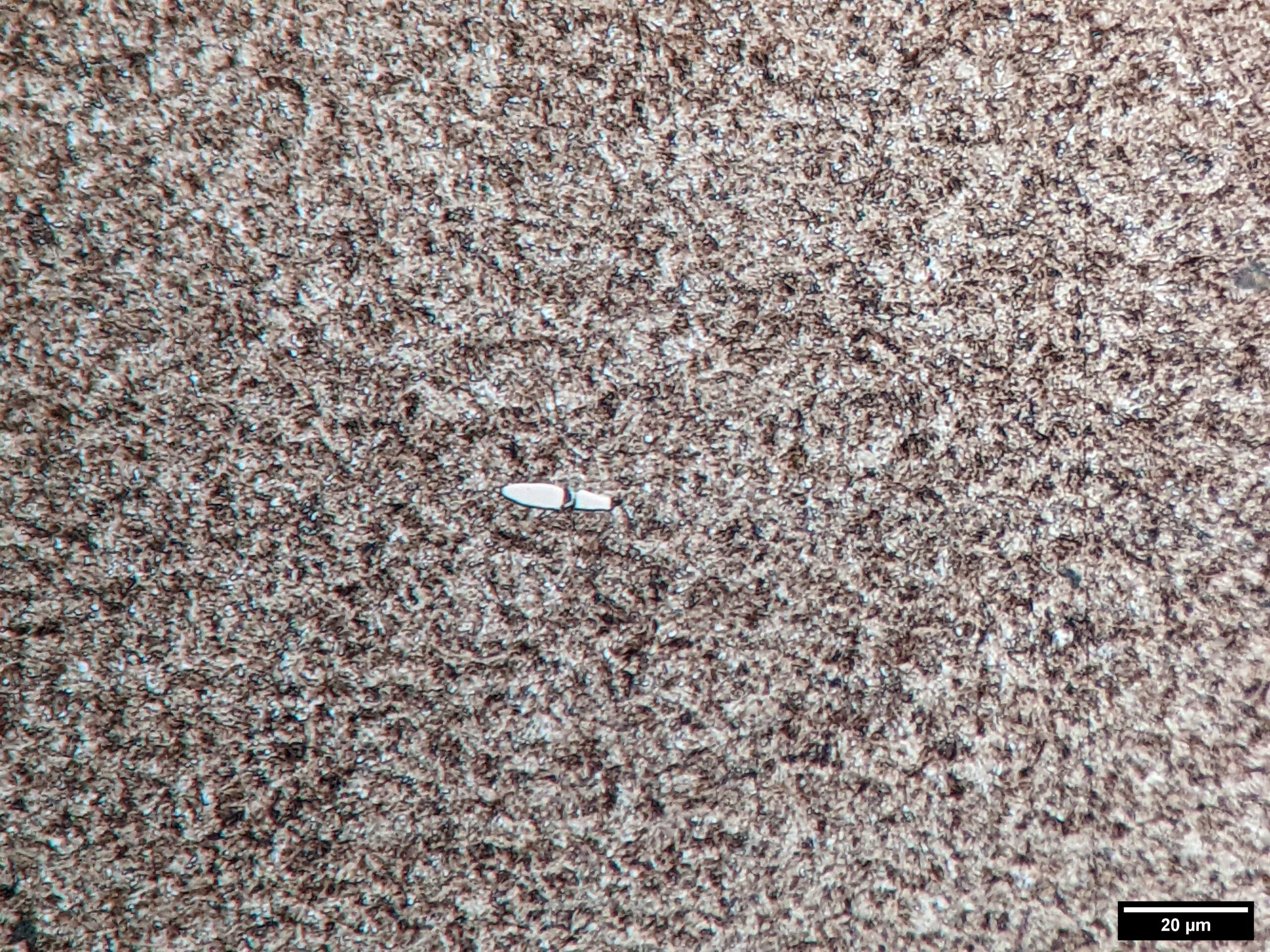

I don’t have a quantitative test for grindability. Reports from knifemakers so far say that grinding and polishing is very easy with the steel. Some low alloy steels developed for higher wear resistance like CruForgeV are more difficult to polish due to relatively large vanadium carbides that are found relatively frequently. This steel we controlled the W/V content to try to avoid large carbides. Because of the limitations of standard steelmaking (as opposed to powder metallurgy) there are still very occasional larger carbides but they are much rarer than a steel like CruForgeV. So far those few carbides don’t appear to be affecting polishing and finishing.
A lower magnification image of ProCut showing that large carbides aren’t observed most of the time
One of the rare large carbides in ProCut
A micrograph of CruForgeV showing large carbides. Notice there is a magnfication difference vs the ProCut images.

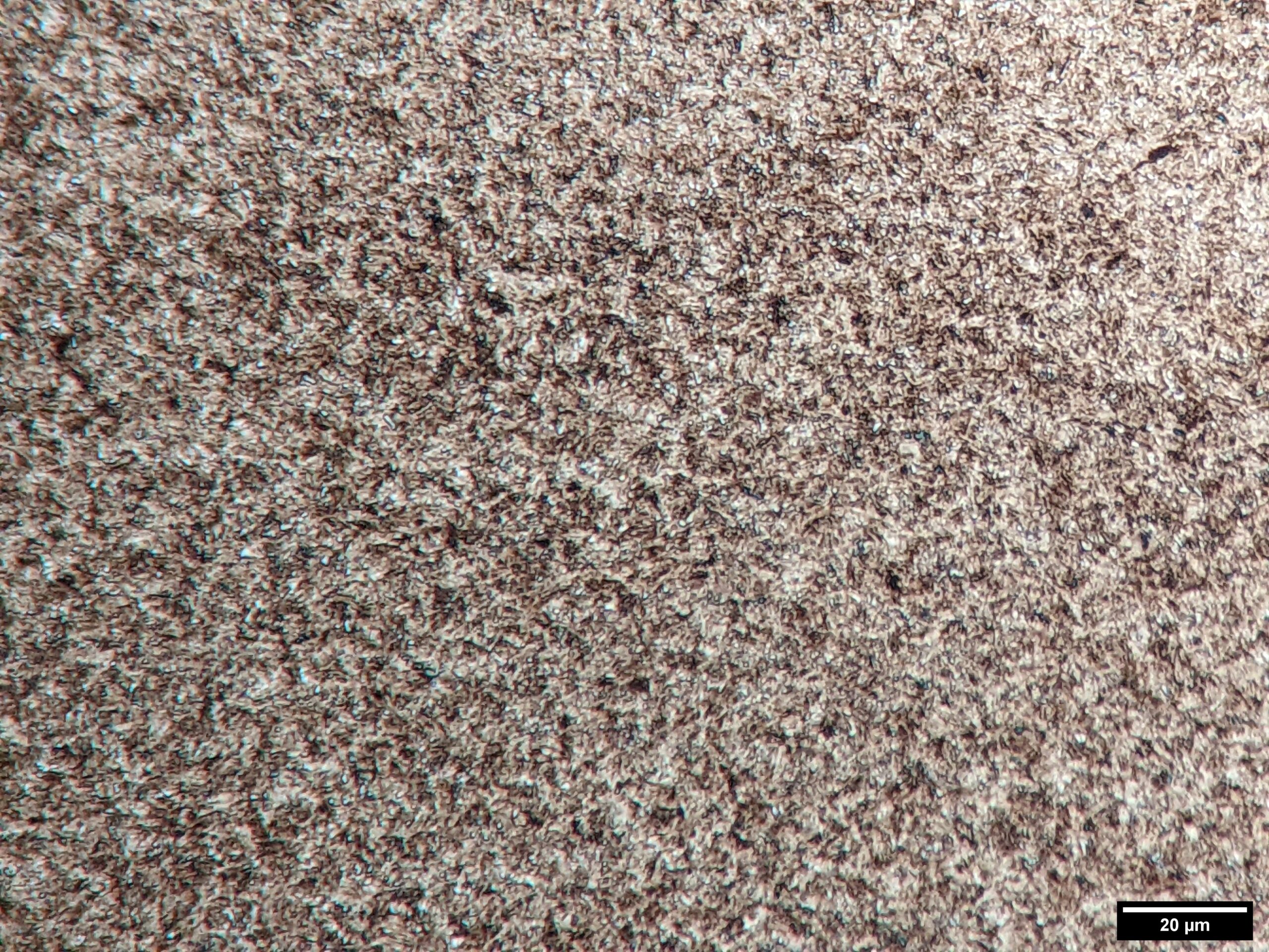

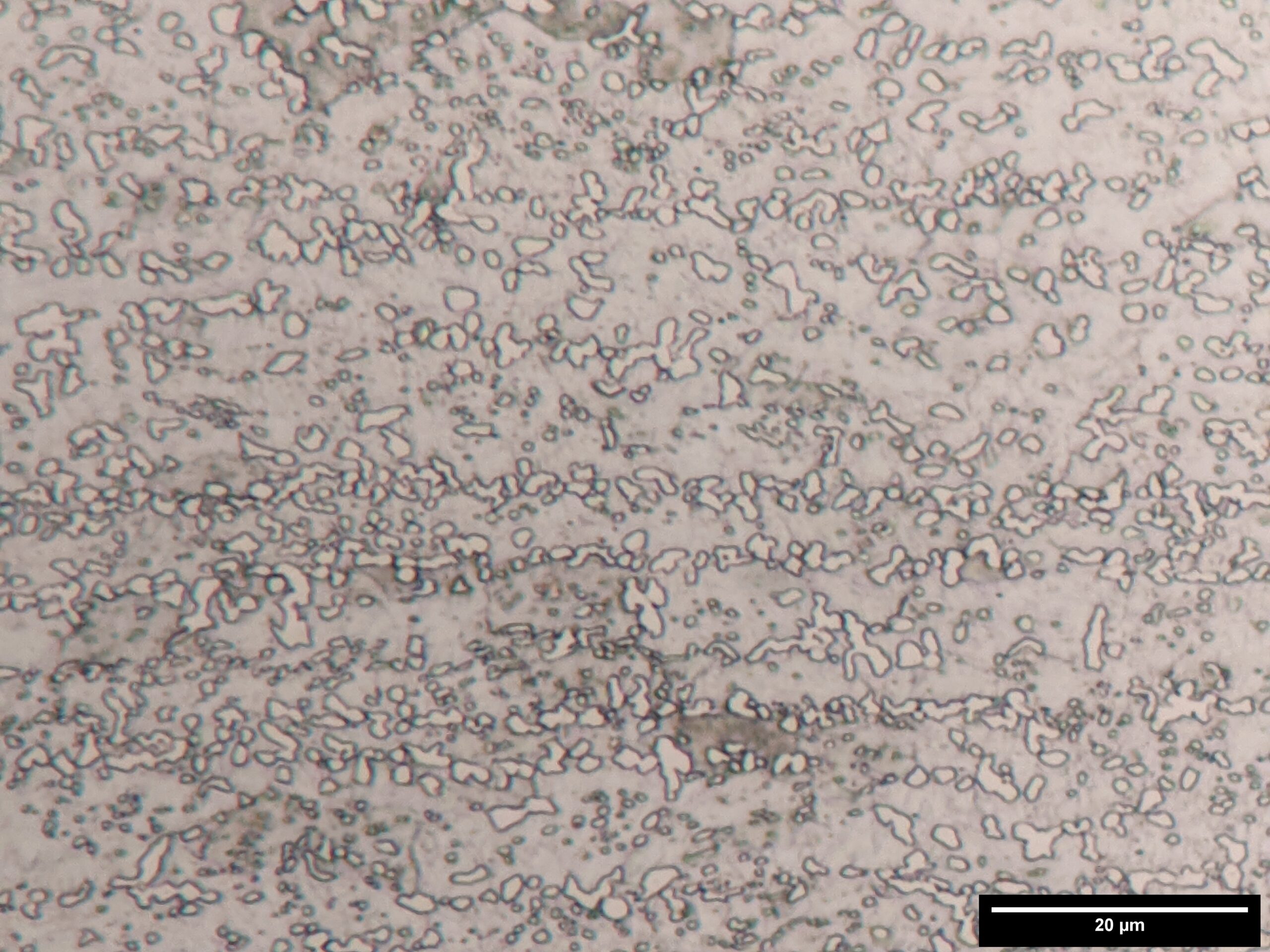

The “thermal cycling” procedure for ProCut is relatively simple. Like with other steels I prefer to do a single normalize and anneal, so only two steps. I have written about this procedure in past articles. The normalizing step is for dissolving any undesirable carbides and other structures. For this steel it would be in the range of 1600-1650°F where the cementite is dissolved. With a furnace you can hold at this temperature for 10-15 minutes before air cooling. With a forge by eye you just need to heat somewhere into that range or a bit higher.

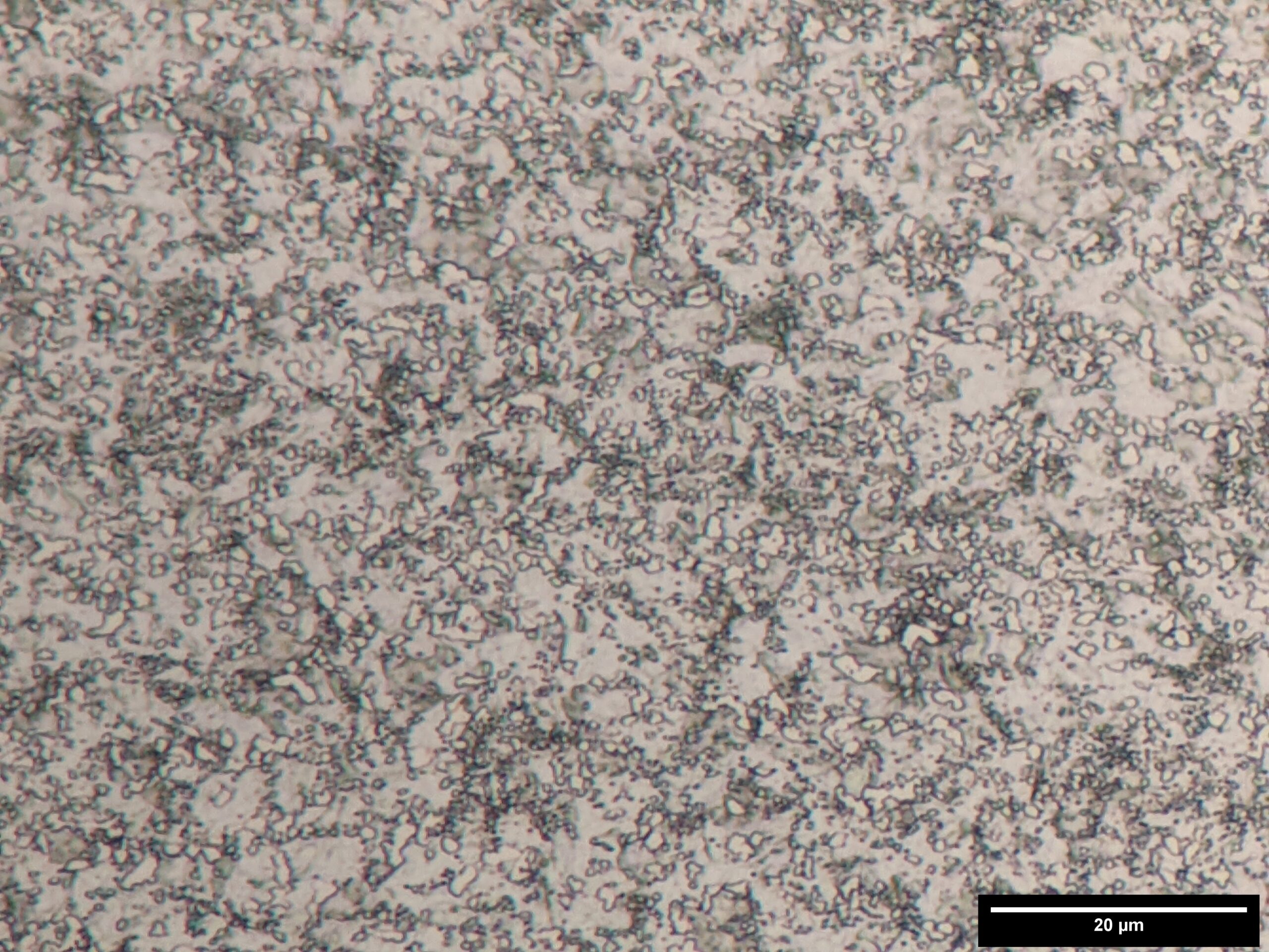

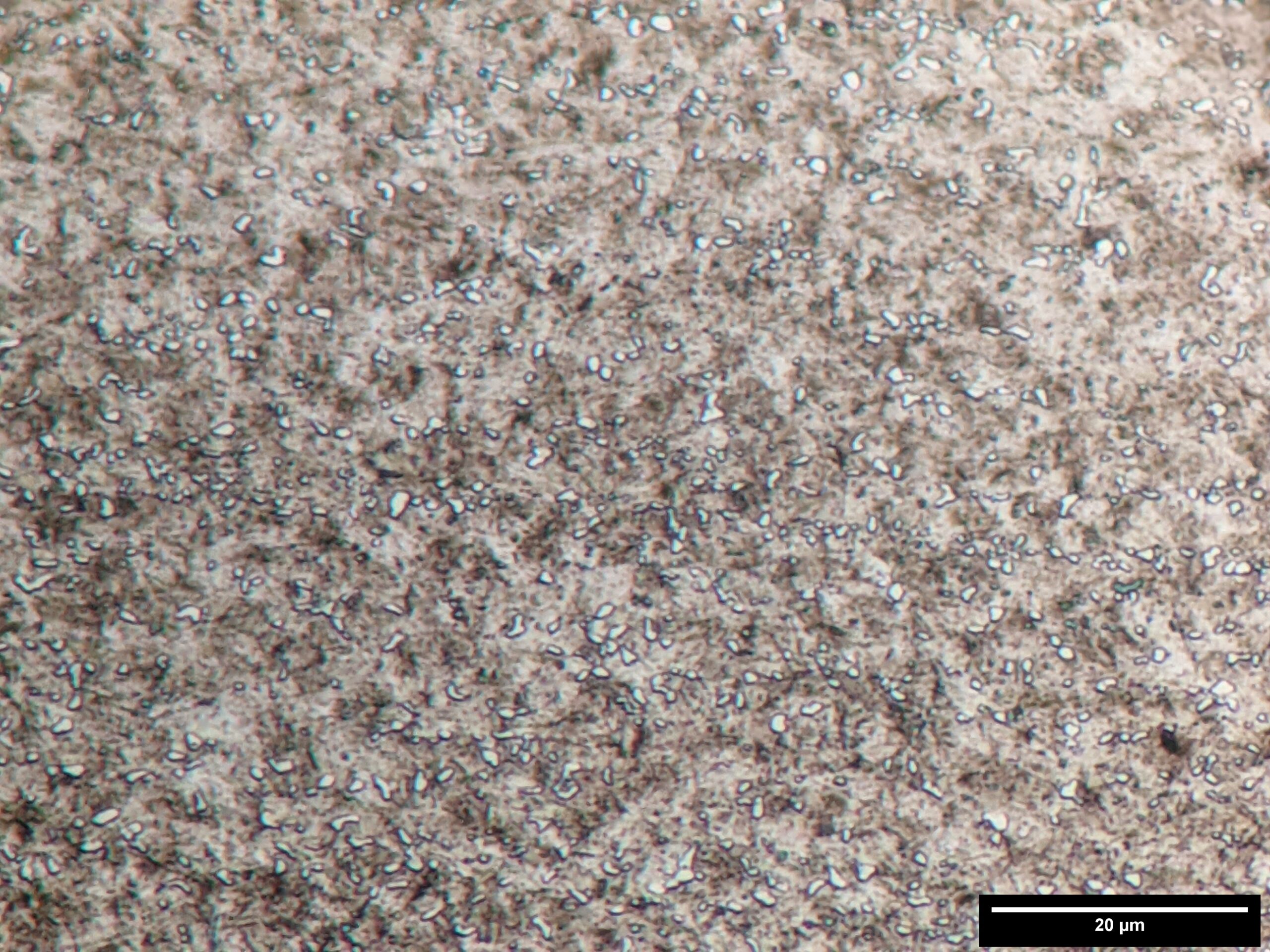

The annealing procedure is then done by heating to nonmagnetic and slow cooling. I recommend faster cooling rates than is typical for datasheets and this type of anneal is called a “Fast DET” anneal. For simple heat treatments you can slow cool either in a furnace or in an insulating media like vermiculite (available in the garden section of home improvement stores). I tried a range of cooling rates in my furnace. I held the steel for 30 minutes at 1350°F and slow cooled at different rates to measure the annealed hardness. At 50°F/hr cooling the resulting hardness was 23.9 Rc. After 500°F/hr the hardness was 24.5 Rc. I also tried setting the furnace to 1000°F/hr but it only maintained that cooling rate until about 1250°F and slowed from there, the average rate of cooling was about 680°F/hr. That resulted in 26.2 Rc, which is plenty soft enough. Shawn Houston did an anneal with 250°F/hr and he measured 21.2 Rc. Here is the microstructure after normalizing and annealing at 1350°F for 30 minutes, and cooling at 250°F/hr:

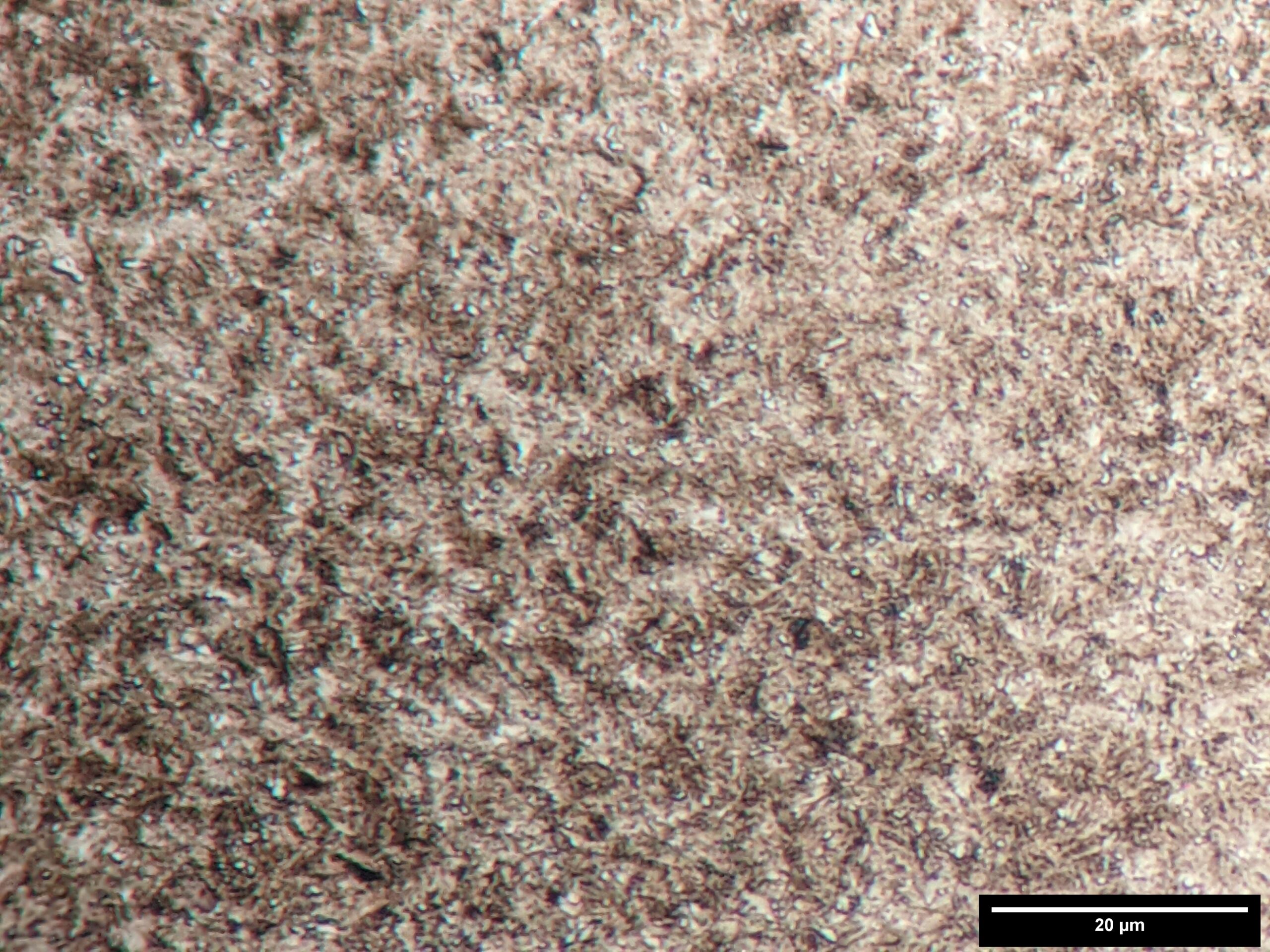

Normalized and “Fast DET” annealed microstructure of ProCut (21.2 Rc)
“As-received” annealed microstructure of ProCut (12 Rc)
You can see that the faster annealing procedure results in a finer microstructure which is why the austenitizing response was different (see the prior as-quenched hardness chart). The toughness was still relatively similar despite the very different starting microstructure (see the toughness vs austenitizing temperature chart). Those datapoints were generated using a 100°F/hr anneal which is what I recommended in the datasheet. Somewhat faster and slower cooling rates would have a similar result.

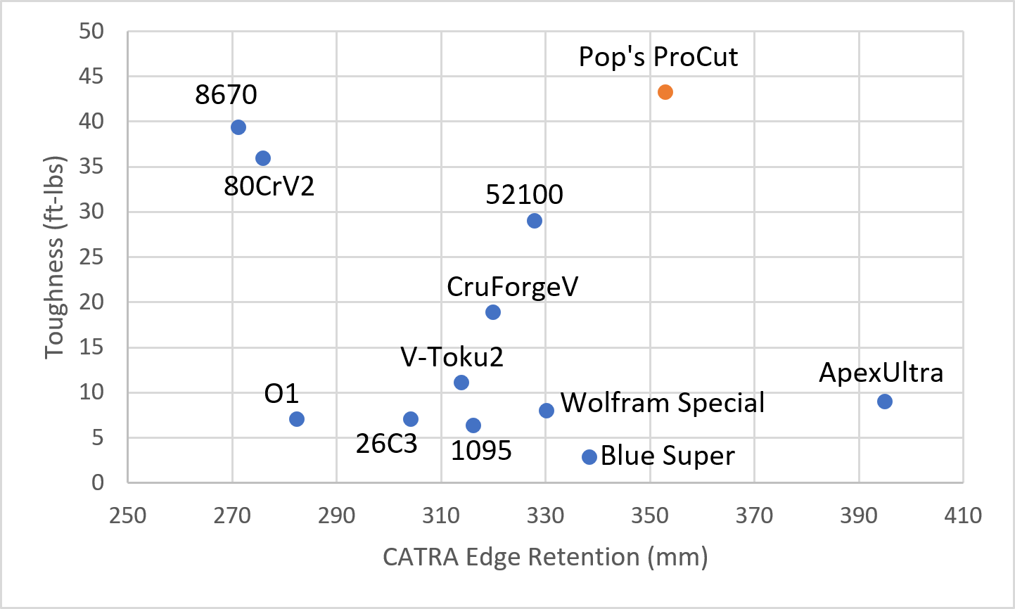

Pop’s ProCut did surprisingly well in the CATRA test. The heat treatments performed were 1650°F with a 450°F temper (61.2 Rc), and 1500°F with a 300°F temper (64 Rc). As I have written about before, CATRA is not the best for low alloy steels because the sand particles in the test media are harder than cementite (iron carbides). Even with different media they wouldn’t be at the top of the chart but they would be a bit better. It could be that the relatively low amount of cementite in ProCut helped for the CATRA test. But even if that were the case if we compare with another steel with low cementite content like 8670 or 1095, there was a significant boost to edge retention through the tungsten and vanadium additions. Perhaps with the lower carbon compared with other W/V steels meant that there was less of tungsten and vanadium found in the cementite, allowing them to form more of the hard WC and VC carbides.
With the high toughness plus the unexpectedly good CATRA numbers the ProCut looks very good compared with other low alloy steel options:

Cryo
There is a certain lore out there with knifemakers claiming that some steels “need” cryo and other steels “don’t benefit” from cryo. Part of this lore is that low alloy and carbon steels are in the “don’t benefit” category. Simple carbon steels and low alloy steels still see an increase in hardness with cryo, typically 0.5-2 Rc depending on the steel and the heat treatment. There is a small cost to toughness because of the increase in hardness. ProCut is the same. As an example of another low alloy steel we experimented with see 52100. I did experiments from 1500°F and 1650°F and found, as expected, that hardness increased. The higher temperature led to a bigger bump from cyro which is also typical. None of the edge retention or toughness tests I showed in the article so far used cryo in any of the heat treatments. But if you want even higher hardness for edge retention and strength you can add a cryo step after quenching.

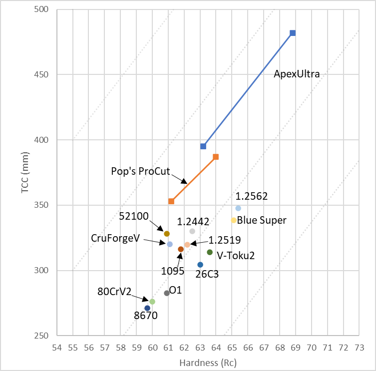

  4. Another exciting new development! Are the TCC/Hardness and Toughness/Edge Retention charts showing the higher or lower heat treatment (and what are the results for the other heat treatment)?
      1. I’m sorry, I only see one line on the graph under the Edge Retention heading and one point on the point under Toughness-Edge Retention Balance. Am I missing the other points?

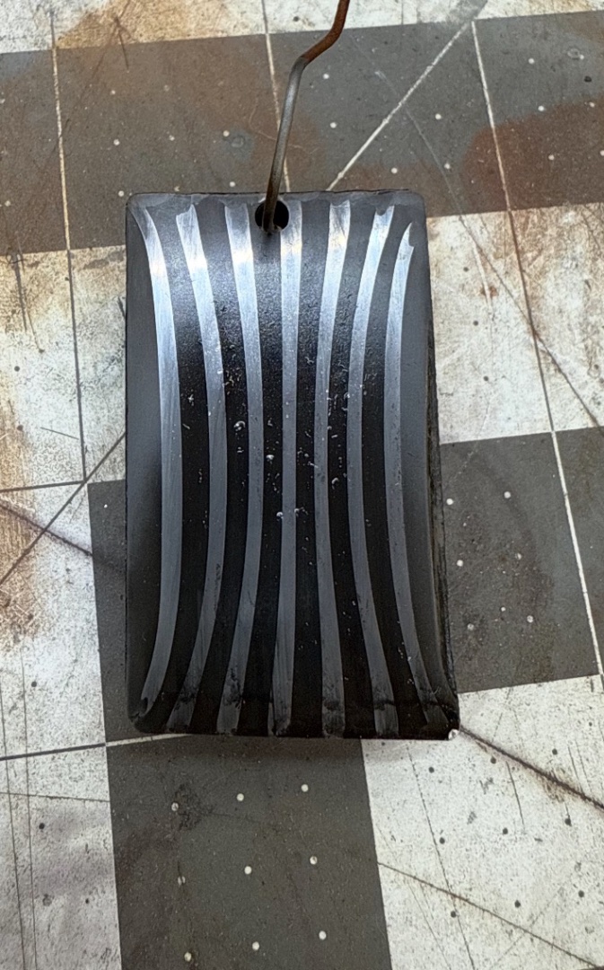

  20. Quick question Larrin. How would this steel work with differential hardening? Clay coated spine. Would it be a better practice to differentially temper it instead of the clay coat? Drawing the spine back with a torch instead of. I’m not looking for a Hamon, I’m just liking the toughness increase I can potentially get! Higher hardness edge with a spring tempered spine, would make a great wilderness survival/hunting knife. Thanks
      1. I have a question about the differential tempering process that has long vexed me. The process of drawing the hardness back with a torch, is often called “blue backing”, because the spine is heated until blue, which is 575F, which is right in the middle of the tempered martensite embrittlement range for a lot of steels. For most knife making steels the tempering temperature you recommend is usually around 400F, because most steels enter the TME range shortly above 400F. In order to have any gains in toughness from differential tempering, would the tempering temperature for the spine not have to exceed the TME range?
        Steel temper color chart link: https://knifemaking.com/pages/forging-steel-heat-color-chart?srsltid=AfmBOopUsE-QGNY5_gXdExm_SPxxI70eNC5p94YiKpkpbKXNYne3GqN7
        1. Toughness does go up again if you temper hot enough, though I agree that 575°F is likely to still be in TME. You would likely still gain some ductility by softening the spine though toughness would not be improved if you only went up to 575°F. Here is a picture of actual steel samples with different temper colors (though remember this is for carbon steels and some low alloy steels only): https://en.wikipedia.org/wiki/Tempering_%28metallurgy%29#/media/File:Tempering_standards_used_in_blacksmithing.JPG
