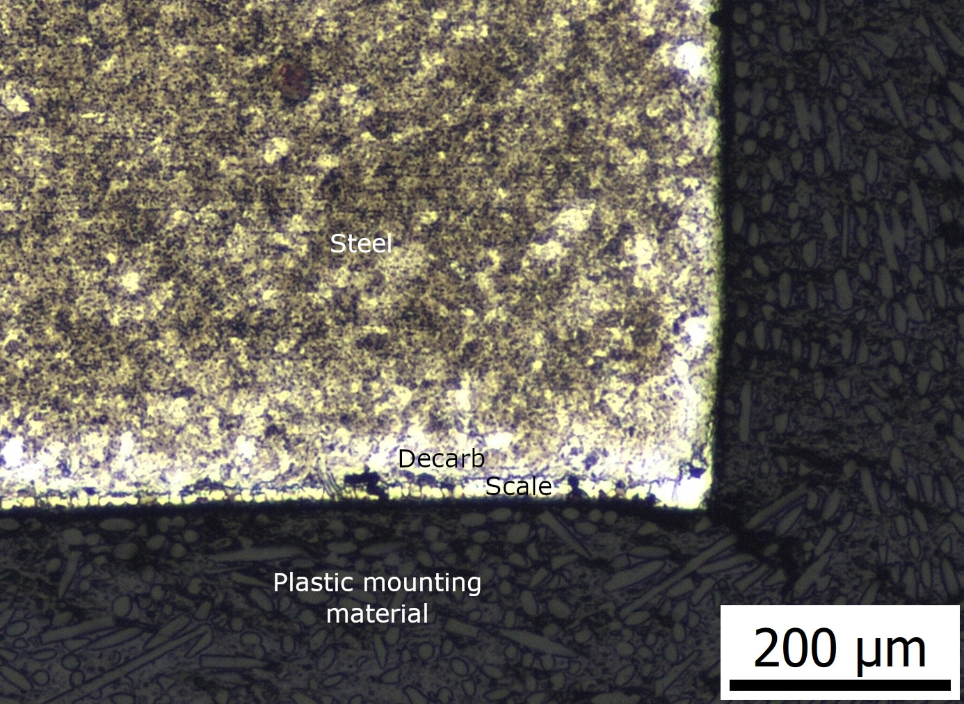

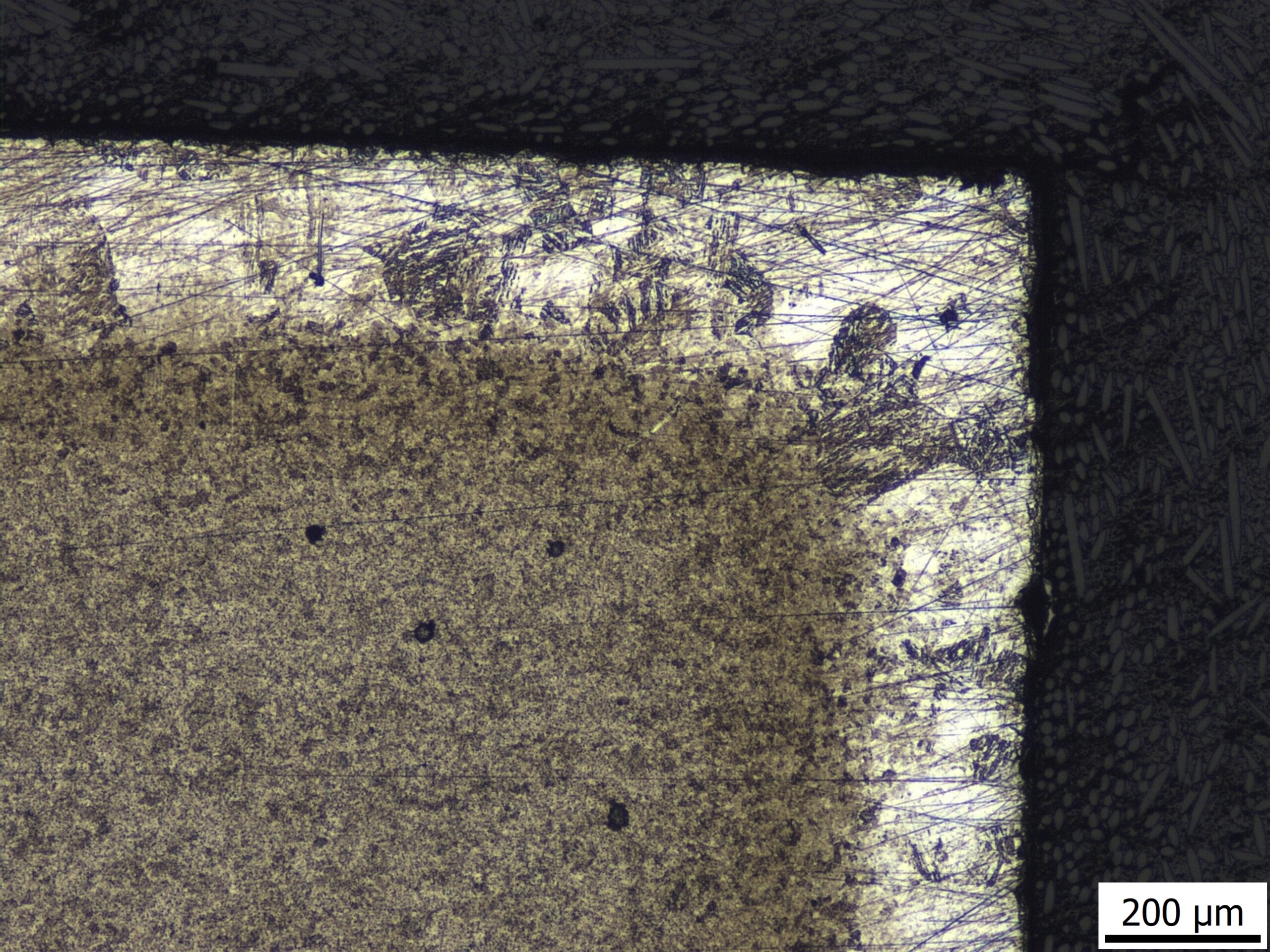

Looking at the cross section, the 52100 has a thin decarb layer and thin layer of scale. The AEB-L, however, had a very thick decarb layer measuring over 0.2 mm (~0.01 inches).

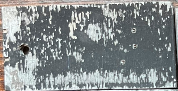

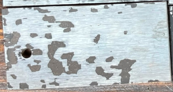

NoScale2000

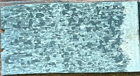

Another puzzling thing was that the NoScale2000 appeared to lead to even more scale than when heat treating it without any coating. The repeat experiment of 1095 also led to a lot of scale. When I brushed on the NoScale2000 there was still scale that formed it was just more “spotty.”

The 52100 coupon coated with NoScale200 also had a somewhat spotty appearance similar to the 1095 brushed coupon. The AEB-L NoScale2000 coupon looked at least as bad as the uncoated coupon, perhaps worse.
52100 NoScale2000 coupon

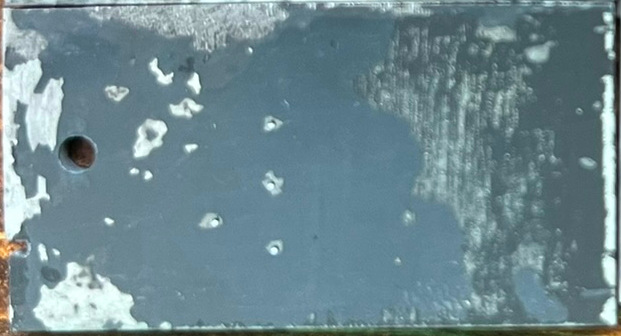

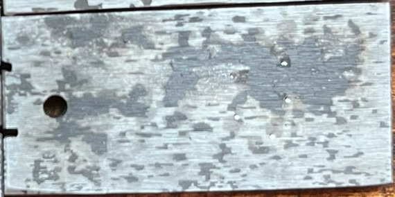

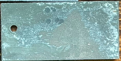

ATP-641 Coupons
Surprisingly the 1095 coupon coated with ATP-641 had some spotty scale that formed, not looking too different than the uncoated coupon. The 52100 coupon, however, didn’t have any obvious scale just some discoloration. But the AEB-L coupon formed scale and didn’t look very different than the corresponding uncoated coupon.

52100 ATP-641 coupon

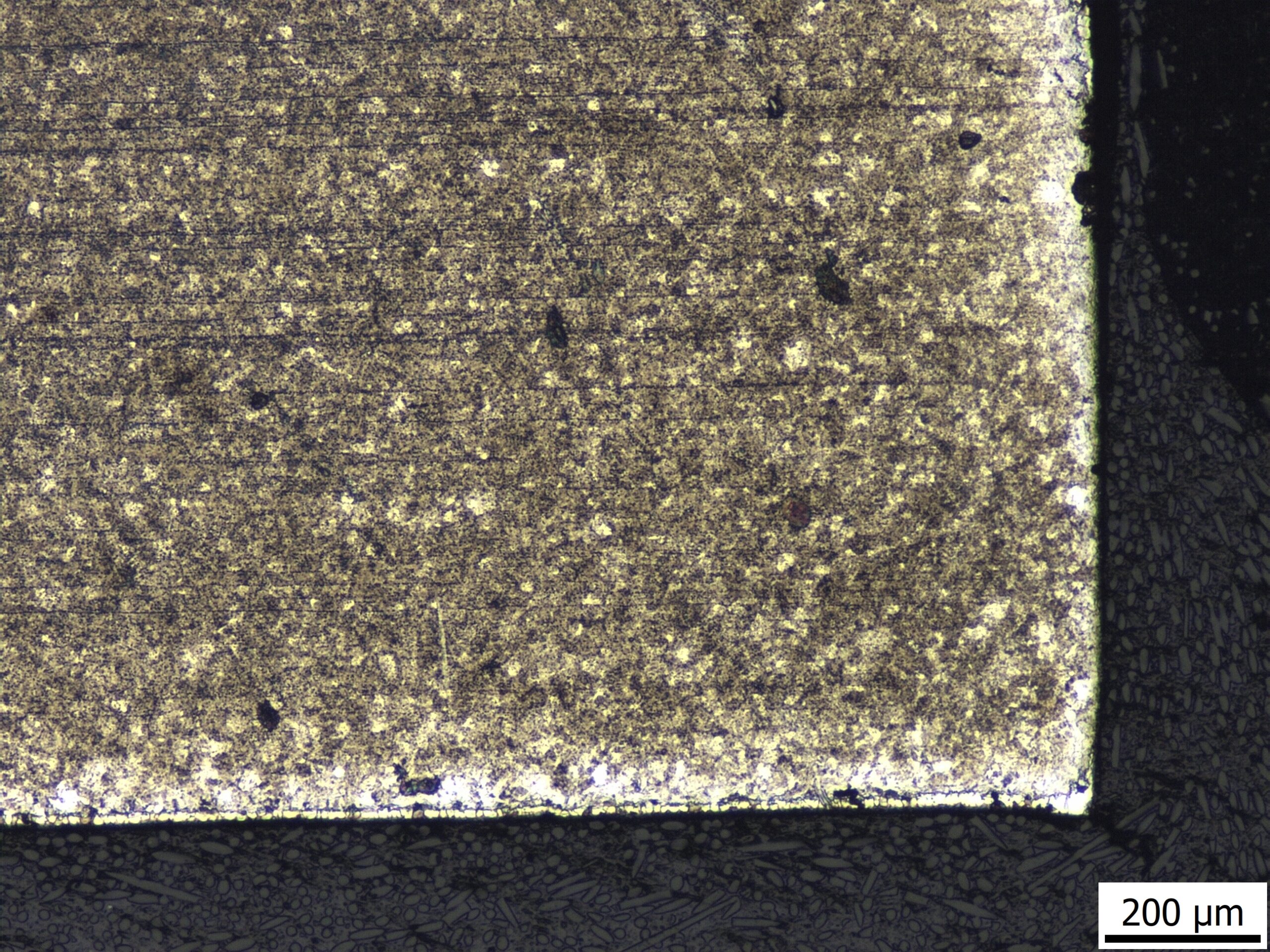

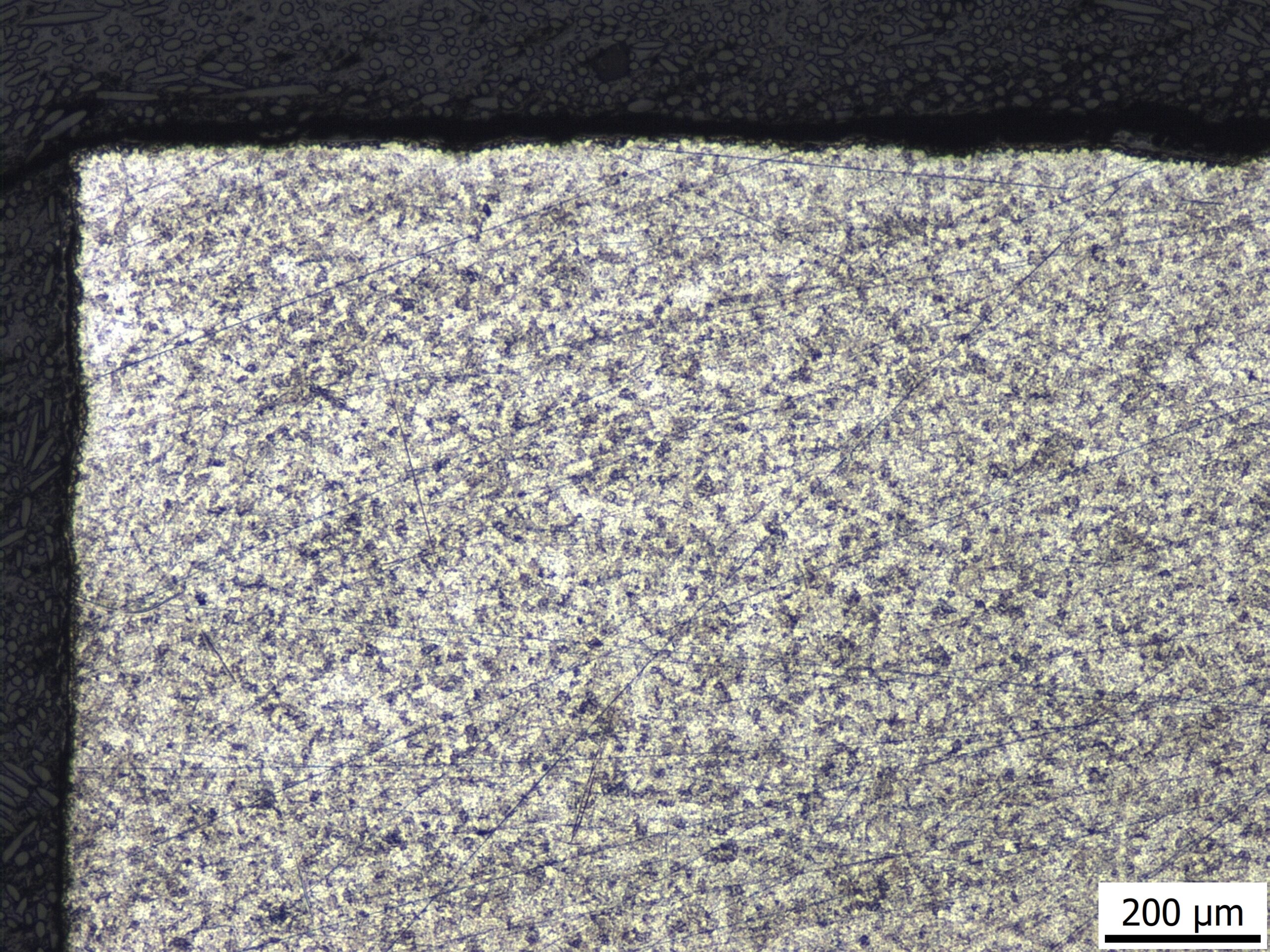

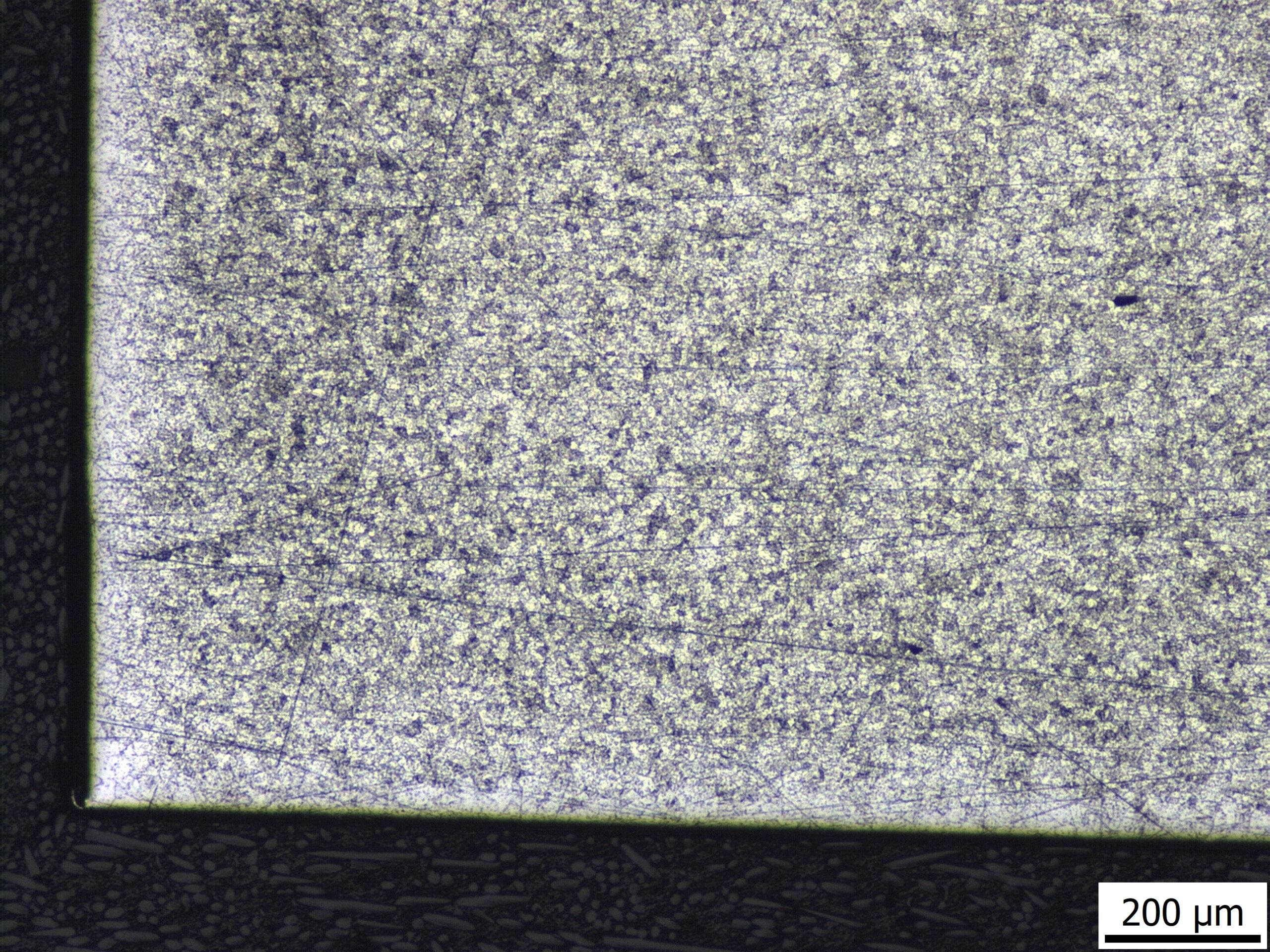

Looking at the cross-sections with metallography there is no obvious decarburization in either the 52100 or the AEB-L. This is somewhat surprising given the rough scale that formed on the AEB-L. Maybe the ATP-641 affected the surface in some way on its own while still preventing decarb.
52100 ATP-641 cross-section
AEB-L ATP-641 cross-section

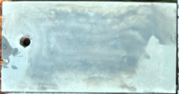

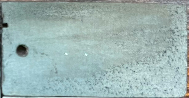

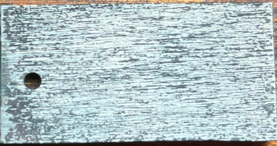

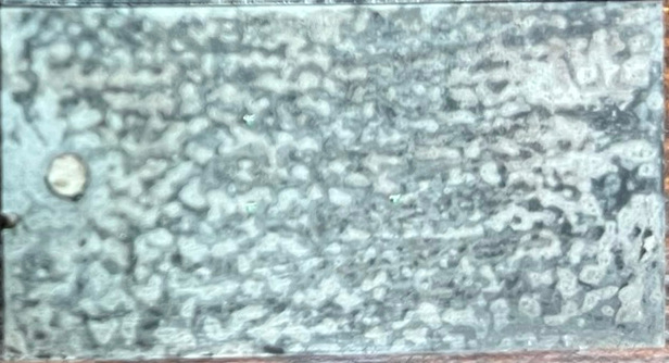

Turco Coupons
The 1095 Turco coupon had some scale that formed, lining up with the grinding marks. Perhaps this was because of the coarser 60 grit finish on the 1095 coupon vs the 120 grit on the 52100 and AEB-L coupons. The 52100 coupon had some discoloration and it is hard to tell if it was scale or not but otherwise looked good. The AEB-L perhaps had some light scale that formed but otherwise looked very good.

52100 Turco coupon

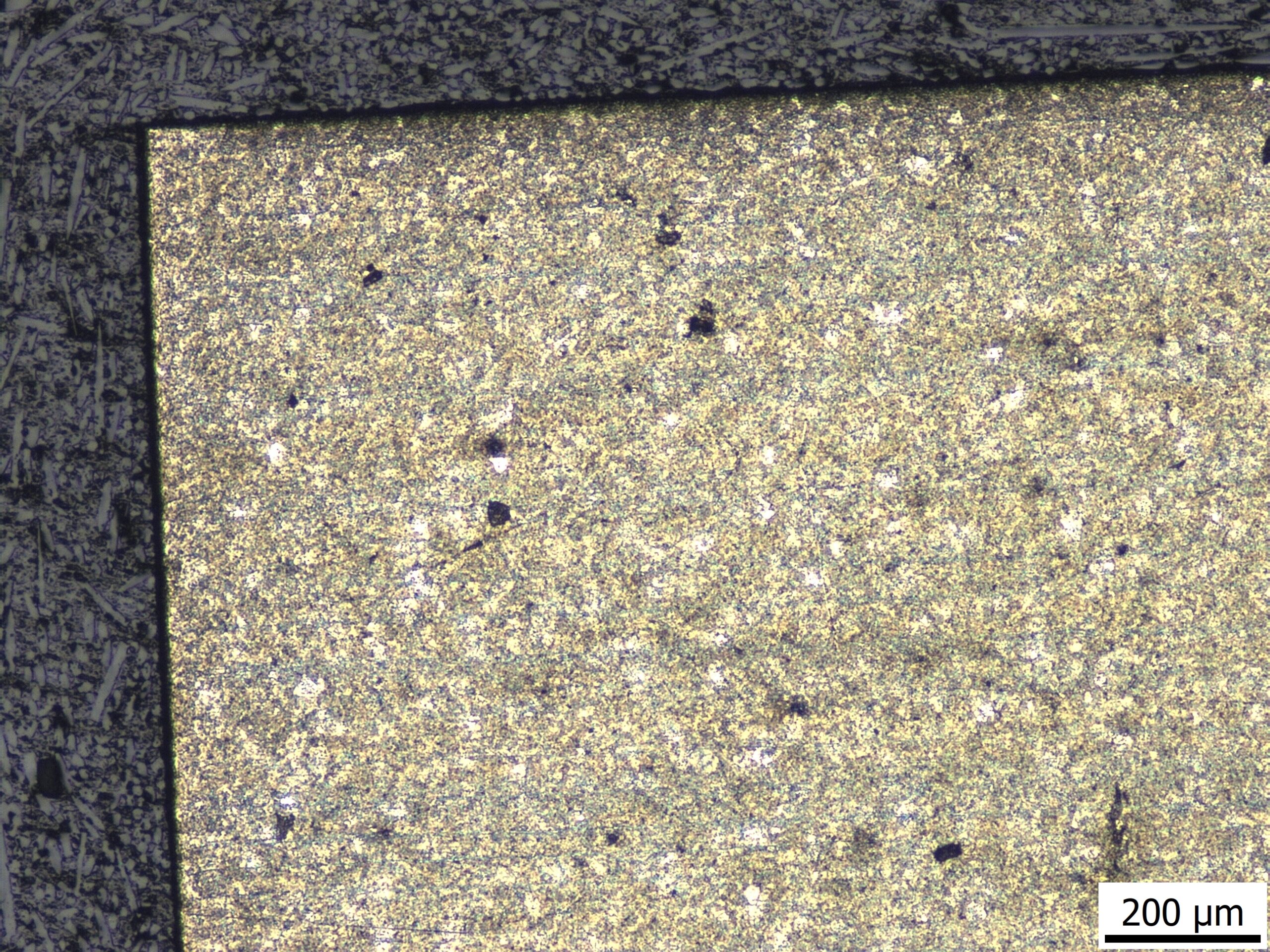

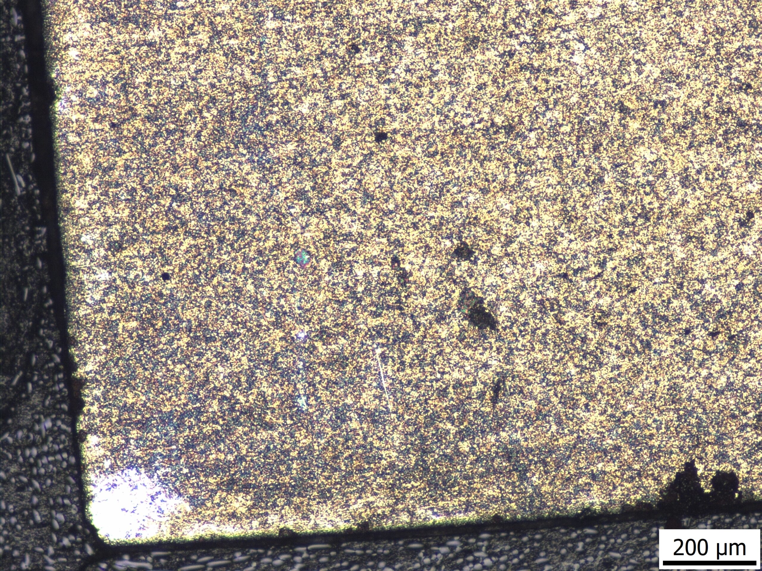

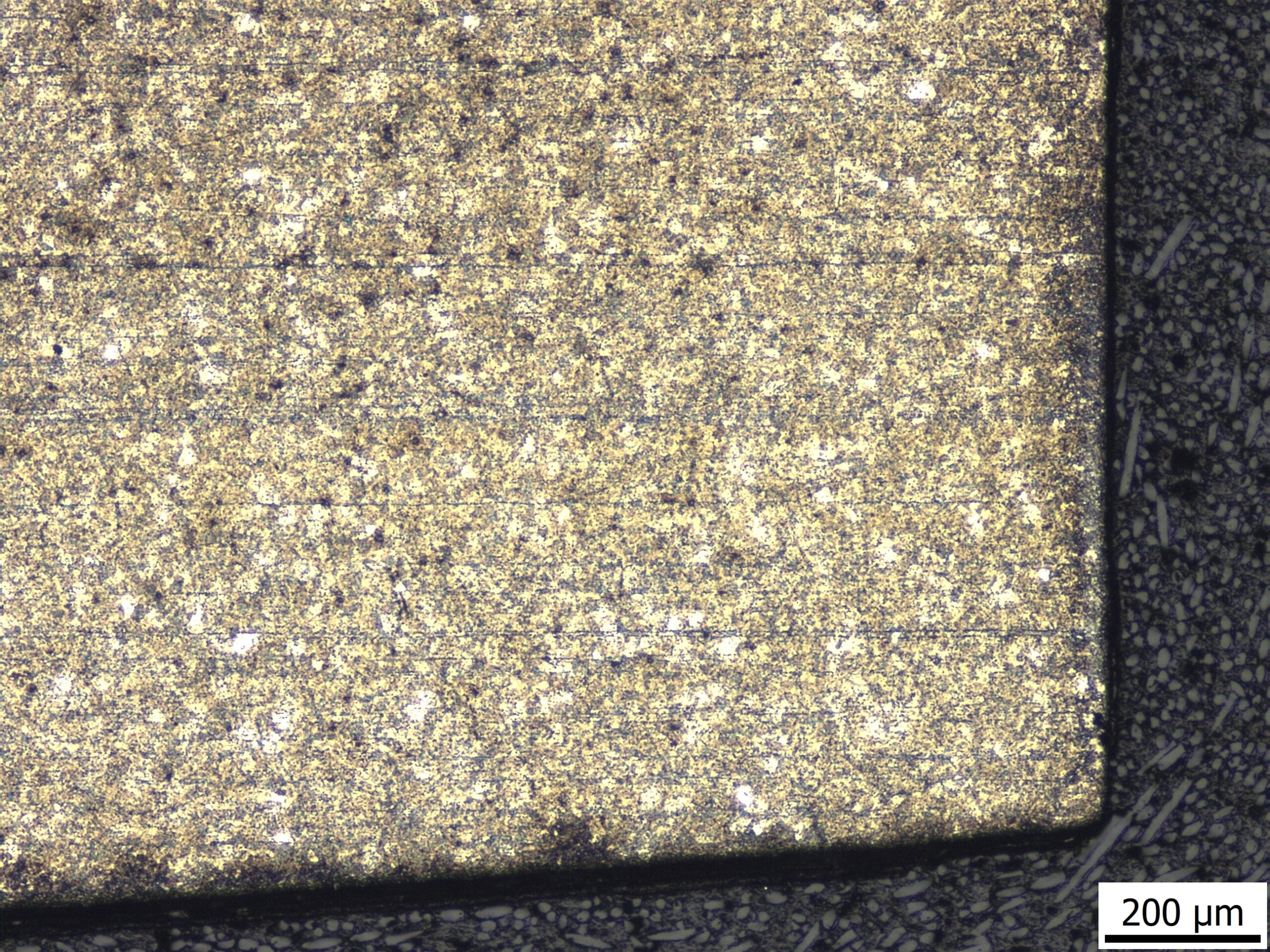

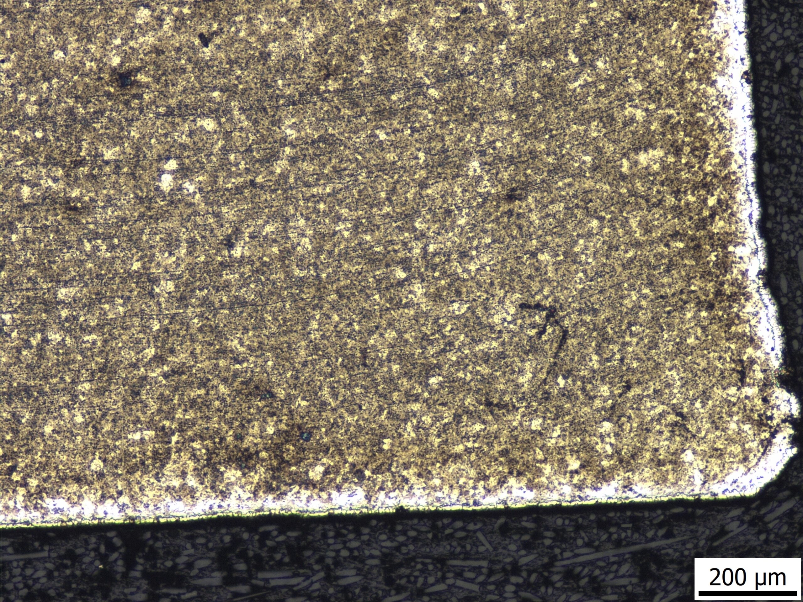

There was no apparent decarburization visible in the metallography analysis of the 52100 coupon. The AEB-L coupon also looked good apart from one corner where presumably the Turco had rubbed off prior to heat treatment.
52100 Turco cross-section
AEB-L Turco cross-section

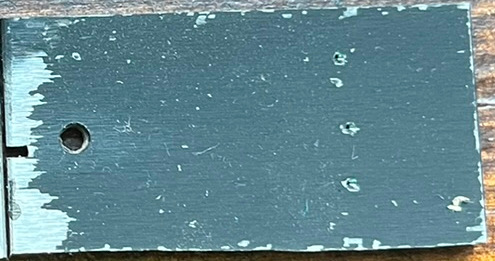

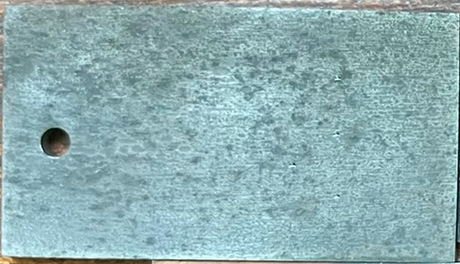

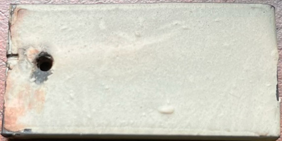

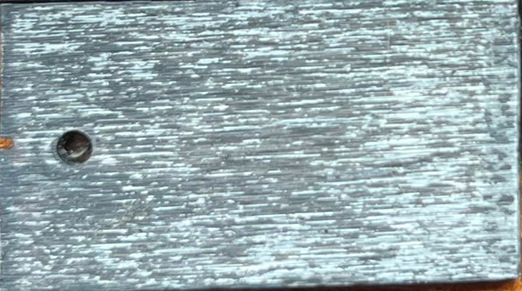

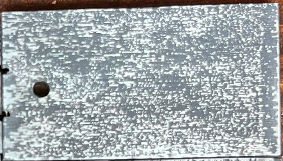

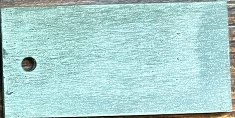

Condursal Z1100 Coupons

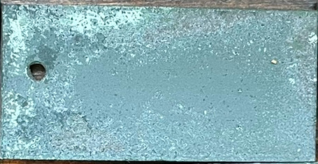

The Condursal seemed to be very similar to the Turco apart from color (green vs orange paint). The resulting coupons also looked pretty similar to the Turco coupons. For some reason there was more scale on the 52100 coupon. And the rougher 60 grit finish I did with these followup coupons also seemed to affect the amount of scale that formed somewhat. I did not do metallography with these coupons.

52100 Condursal Z1100 coupon
AEB-L Condursal Z1100 coupon

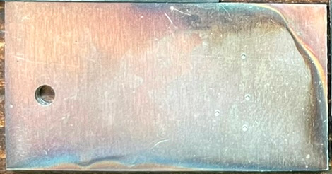

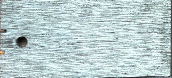

Foil
I only used foil with AEB-L. As expected the steel came out completely clean apart from some rainbow coloration from the small amount of oxygen left in the packet.
AEB-L foil coupon

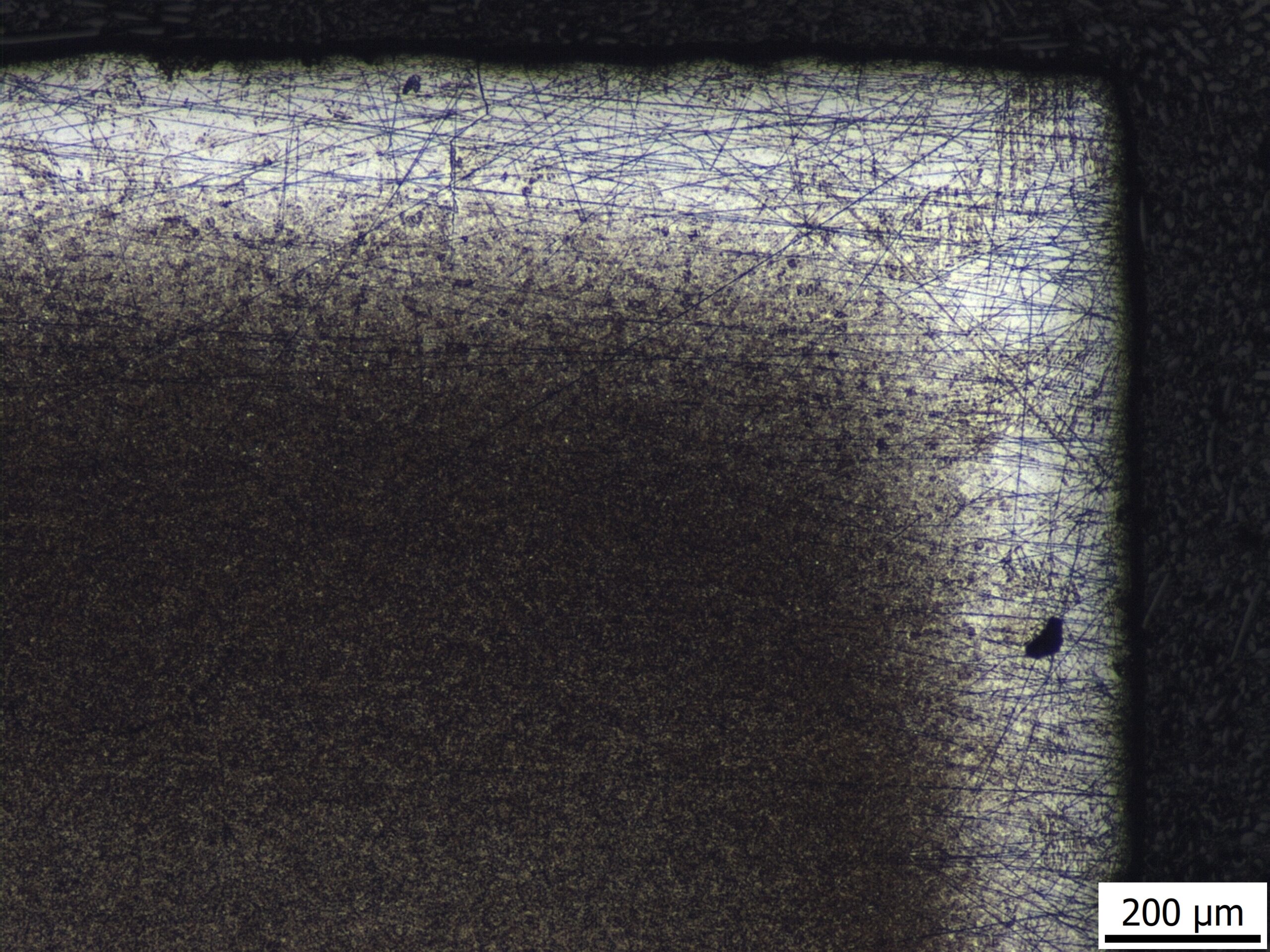

Surprisingly there is what looks like a thin decarb layer visible in the cross-section. Perhaps the little bit of oxygen that interacts with the steel is enough for a small amount of decarburization.
