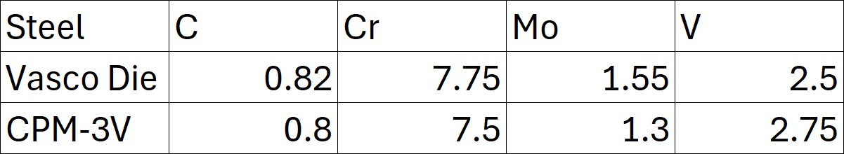

The thing most don’t know about CPM-3V is that it is a powder metallurgy version of an older conventional steel called Vasco Die. Vasco Die was patented by Harry Johnstin of VASCO in 1964 [1]. This was the first popular “8% Cr die steel” which created a new category. The most popular cold work die steels were (and are) A2 and D2. D2 is used for higher wear resistance and A2 is used for higher toughness. The 8% Cr is right in the middle between D2 (12%) and A2 (5%). And with the 2.5% vanadium for wear resistance and the relatively low carbon of 0.8% it has an interesting combination of properties, better overall than either A2 or D2. The steel was advertised as twice as tough as D2 while have ten times the wear resistance of A2. This created a new category of cold work die steel which is still seen today in steels like DC53 and Sleipner. You can read more about the history of Vasco Die and all of the developments that led up to it in my book The Story of Knife Steel. Vasco Die was never really used in knives, though the higher carbon version, Vasco Wear, did get used by some knifemakers, and by Gerber in some production knives. And of course CPM CruWear, the PM version of Vasco Wear, has also developed some popularity in recent years.

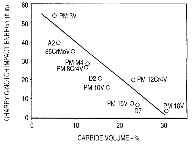

In the mid-1990s, Kenneth Pinnow and William Stasko of Crucible were looking to make a high toughness powder metallurgy tool steel. Up until that point, powder metallurgy steels had focused on high hardness high speed steels and creating new steels with higher wear resistance than was possible with conventional steelmaking like CPM-10V. Crucible’s highest toughness PM steel was CPM-M4 and that was basically an accident. Uddeholm had released Vanadis 4 in the late 1980’s to be a more balanced steel and its toughness didn’t even match CPM-M4. Uddeholm would later redesign this steel and call it Vanadis 4 Extra. Pinnow and Stasko realized they needed a steel with lower carbide volume. Powder metallurgy leads to higher toughness because it keeps the carbide size small, but to achieve the highest levels of toughness they needed to have less overall carbide. They experimented with a few compositions and found that a PM version of Vasco Die had excellent toughness and wear resistance.

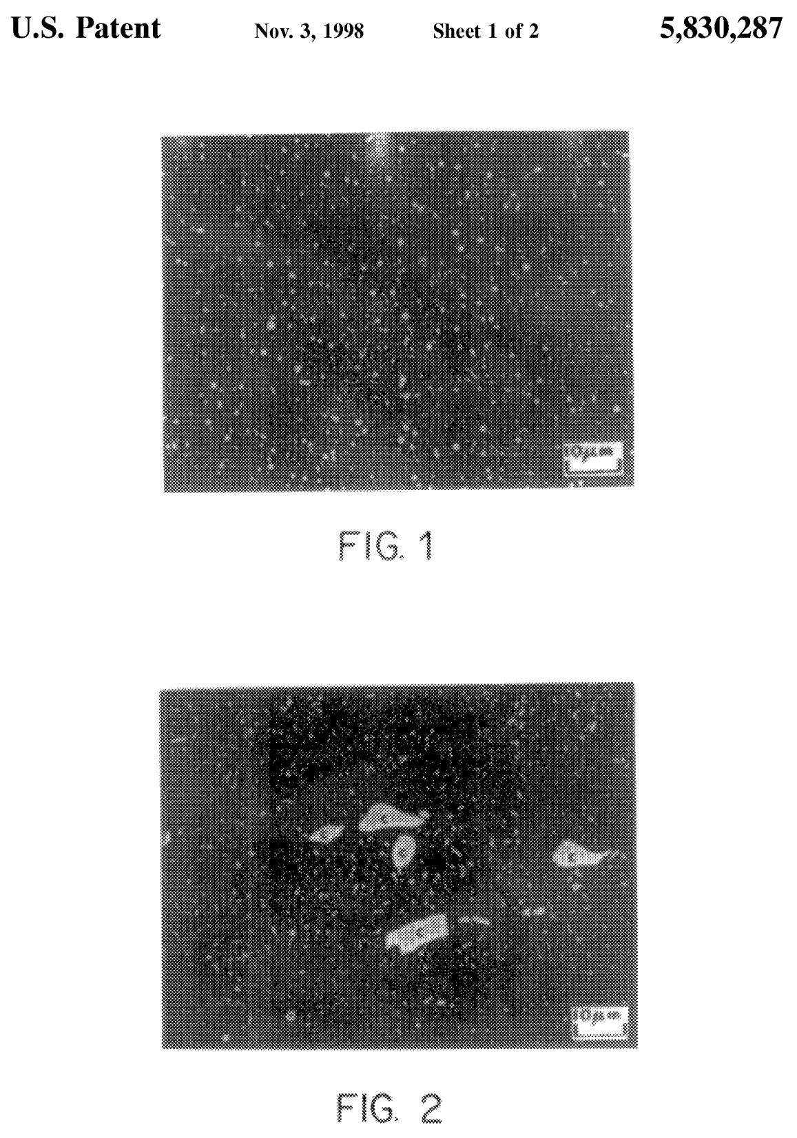

It is somewhat surprising to me that they managed to patent this steel in 1997 [2] since Vasco Die had already previously been patented (though the patent had expired). It seems their claim was that the powder metallurgy process significantly changed the steel, and in more ways than just making the carbides smaller. With conventional casting of steel there is significant segregation of elements, and this led to relatively large chromium carbides which couldn’t be dissolved in Vasco Die. With powder metallurgy, the heat treated microstructure is free from chromium carbide and has only vanadium carbide instead.
Images from 3V patent showing CPM-3V (Fig. 1) and Vasco Die (Fig. 2). The larger carbides labeled “C” are chromium carbides. 3V is only small vanadium carbides.

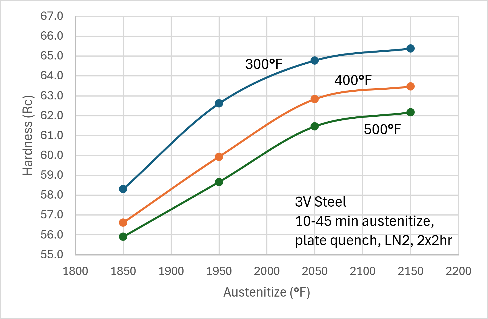

I did a new set of heat treating coupons for CPM-3V as I wanted to go a bit higher on austenitizing temperature than coupons I had done for the book Knife Engineering. The hold time at 1850°F was 45 minutes, 1950°F was 30 minutes, 2050°F was 20 minutes, and 2150°F was 10 minutes. While CPM-3V is typically heat treated in the 58-62 Rc range because of its excellent toughness, it can be heat treated to higher hardness if desired. This is significantly higher than the 61 Rc the datasheet shows the steel maxing out at. This is because I used the low temper range (300-500°F), rather than the datasheet recommended high temper range (1000-1050°F).

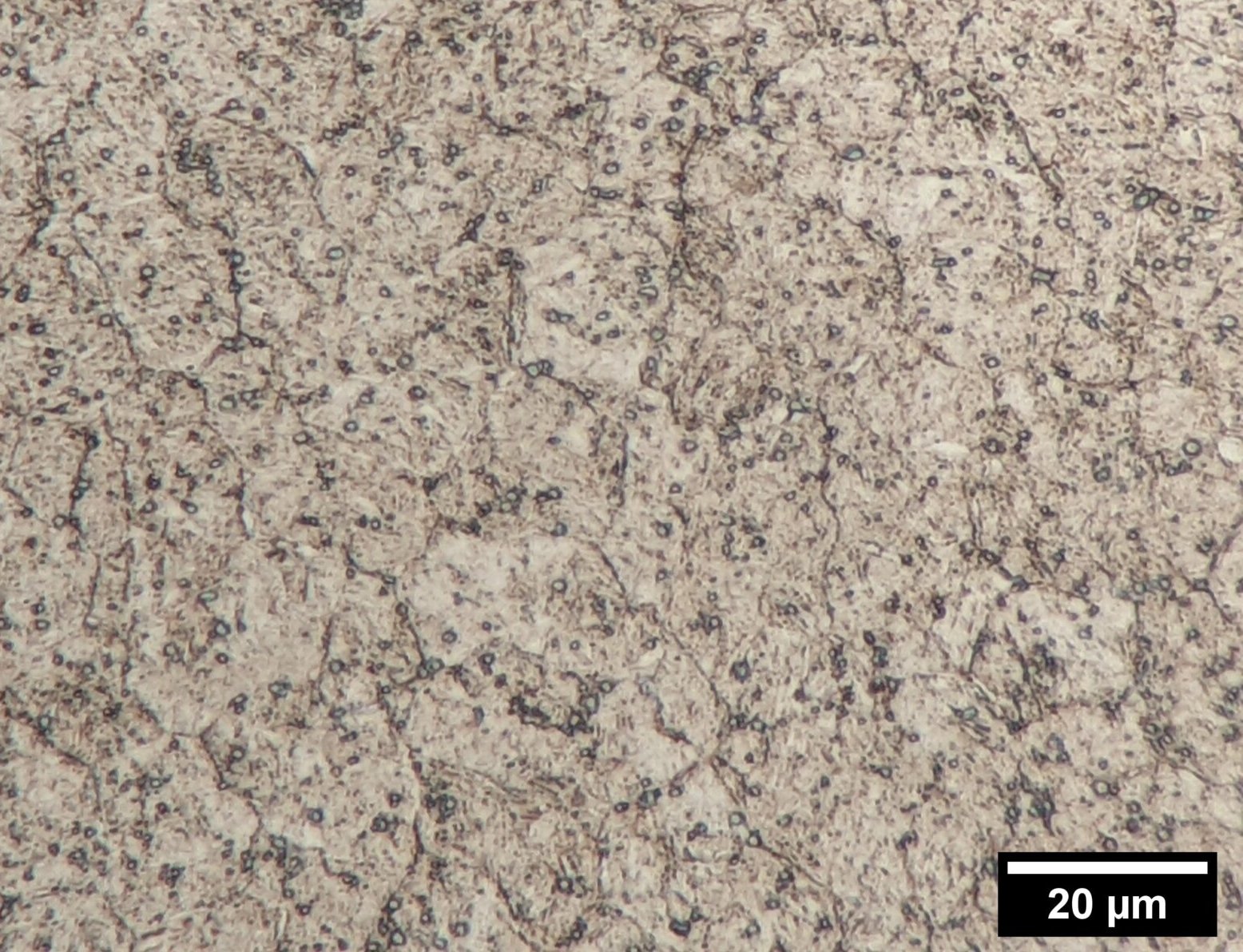

CPM-3V has about 5% vanadium carbide, and is free of chromium carbide despite the relatively high chromium content. This is in contrast to Z-Tuff which has about 3% chromium carbide and only 1% vanadium carbide. CPM-1V also has about 1% vanadium carbide but about 2% M6C (molybdenum/tungsten carbides found in high speed steels). So 3V has only a bit higher carbide volume than those two steels but it is all the hard vanadium carbide type which should mean more balanced properties.
3V (1925°F) – 5% carbide volume
Z-Tuff (1925°F) = 4% carbide volume
CPM-1V (2050°F) – 3% carbide volume

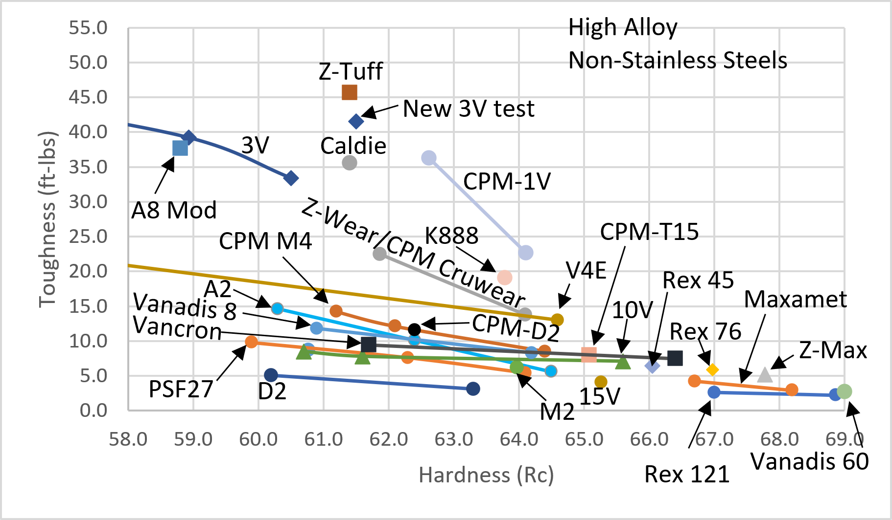

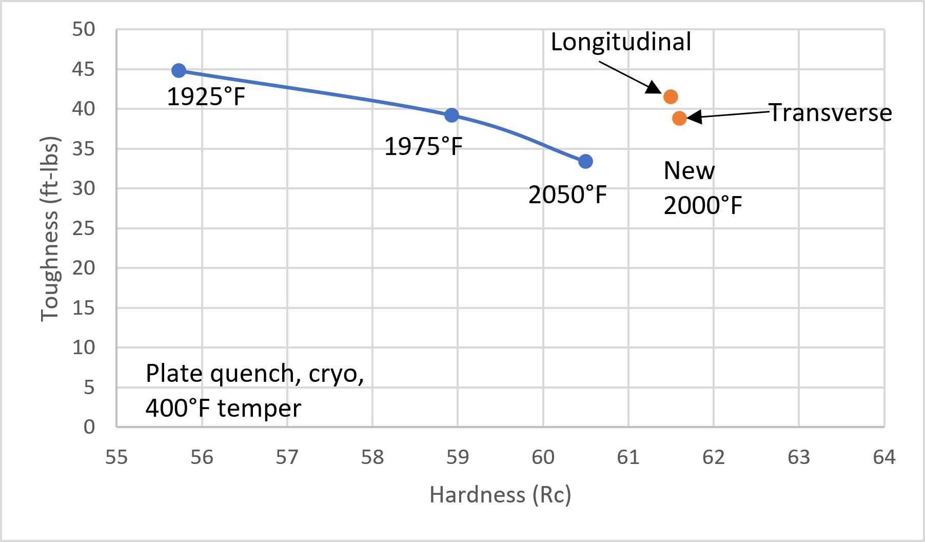

So for a new experiment on CPM-3V I decided to test both the longitudinal and transverse toughness and see if the transverse toughness was really as bad as it was shown in the 3V mod patent. I used an austenitizing temperature of 2000°F, plate quench, cryo, and a temper at 400°F. This resulted in about 61.5 Rc, which is significantly higher in hardness than our original 3V toughness tests. Those coupons were heat treated by Warren Krywko who heat treated a whole bunch of toughness coupons that I tested early on. I think maybe the cooling rate in quenching he was performing was somewhat slower than what I did, maybe because he was doing many specimens at the same time in the plate quench. That is significant because a slower cooling rate leads to both lower hardness and lower toughness, as I wrote about in last month’s article. All of the coupons we heat treated were tempered at 400°F rather than the 1000°F temper the datasheet recommends, because of our earlier findings with CPM-CruWear/Z-Wear.
Comparing the hardness-toughness to the previous CPM-3V tests I found significantly better properties. The transverse toughness I measured was only ~7% worse than the longitudinal, which is quite impressive. The transverse toughness reported in the 3V mod patent looks like an anomaly, I have never seen such a large difference between longitudinal and transverse toughness. Though I have to say, the very small drop between longitudinal and transverse toughness I measured here is quite impressive.
With the improved toughness measurements 3V nearly rivals the results of Z-Tuff and CPM-1V which both have lower carbon and vanadium. This actually does make some sense, as the carbide volume is similar between the three steels. To me the composition designs of Z-Tuff and CPM-1V are not totally optimal because they have a significant amount of non-vanadium carbides. The best toughness-wear resistance balance is generally achieved by having all vanadium carbides. Perhaps in the future we could explore higher hardness heat treatments like in the 62-64 Rc range.

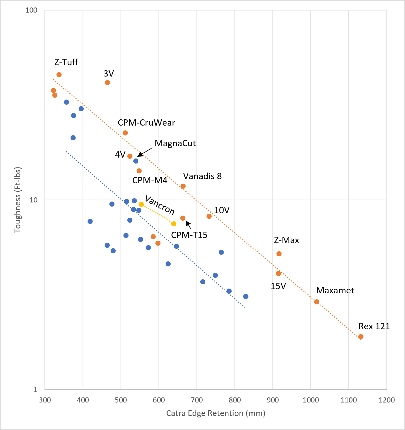

I tested the CATRA edge retention of 3V way back in my giant CATRA study. It did exceptionally well for its level of toughness at 463 mm cardstock cut, significantly higher than CPM-1V and CD1/Z-Tuff. Looking back I do think the heat treatment used was cheating a bit, as the tempering temperature was only 300°F. If the tempering temperature was a more appropriate 400°F, the austenitizing temperature for the same hardness would be higher and thus there would be a bit less carbide in the steel. However, this would only marginally affect the final result.
Edge Retention-Toughness Balance
The combination of wear resistance and toughness of 3V is quite impressive. I added a new datapoint for 3V with its newly higher toughness test. I had to adjust up the CATRA edge retention based on the predicted change with hardness for the chart since the CATRA knife was 1.4 Rc lower than the toughness coupon. CPM-3V is really in a class of its own for the level of toughness it has for the level of edge retention. Of course it doesn’t do anything too crazy when it comes to edge retention, but it is sufficient for many knives and has excellent toughness to go with it.

If you revised your old 3V toughness measurement by almost 50%, if I extrapolate the old curve to 61.5, how can we trust any of the other data points ?
Like if you improved your toughness so much by improving HT wouldn’t you be able to do the same for other steels ? Also 3V is pretty common so how can we assess how optimized your HT is for more rare/exotic steels ?
good comment its an interesting question. Although it should be pointed out that the toughness is represented on a log scale to show that the difference between a steel with 50% more toughness is not as great as the same difference in regards to edge retention, as experienced by the user of the knife. This can be seen by the many knives made in D2 which is a relatively low toughness steel but can perform hard tasks without much problem in a lot of cases.
The toughness data is good enough to differentiate a high toughness steel from a medium toughness and a low toughness steel which is likely good enough to select a steel for a particular application and much better than any other data available. The variability is likely due to the inherent variability in heat treating steel and inherent variability in the taking of this measurement due to crack propagation being somewhat unpredictable. The only way around this would be to test significantly more samples which would be time and cost prohibitive.
As I stated in the article, a faster cooling rate during quenching led to improved hardness and slightly improved toughness. So it would not be appropriate to extrapolate hardness-toughness from previous tests and then say the toughness was increased 50%. You can read more about the effect of cooling rate here: https://knifesteelnerds.com/2025/03/24/factory-vs-custom-heat-treating-of-knives/
