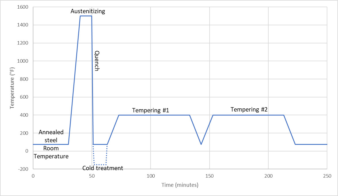

Heat Treating Steps and Equipment Types
There are three major steps of heat treating performed by a custom knifemaker or a factory, and an optional fourth:
  1. Austenitizing – heating the steel up hot and soaking
  2. Quenching – Rapidly cooling the steel
  3. Tempering – reheating the steel to a lower temperature such as 400°F (200°C) for 1-2 hours. This is typically performed 2-3 times (cooled to room temperature in between).
  4. Cryogenic or cold processing is an optional step that can be performed after the quench or in between tempering steps. It involves cooling the steel to as low a temperature as possible.

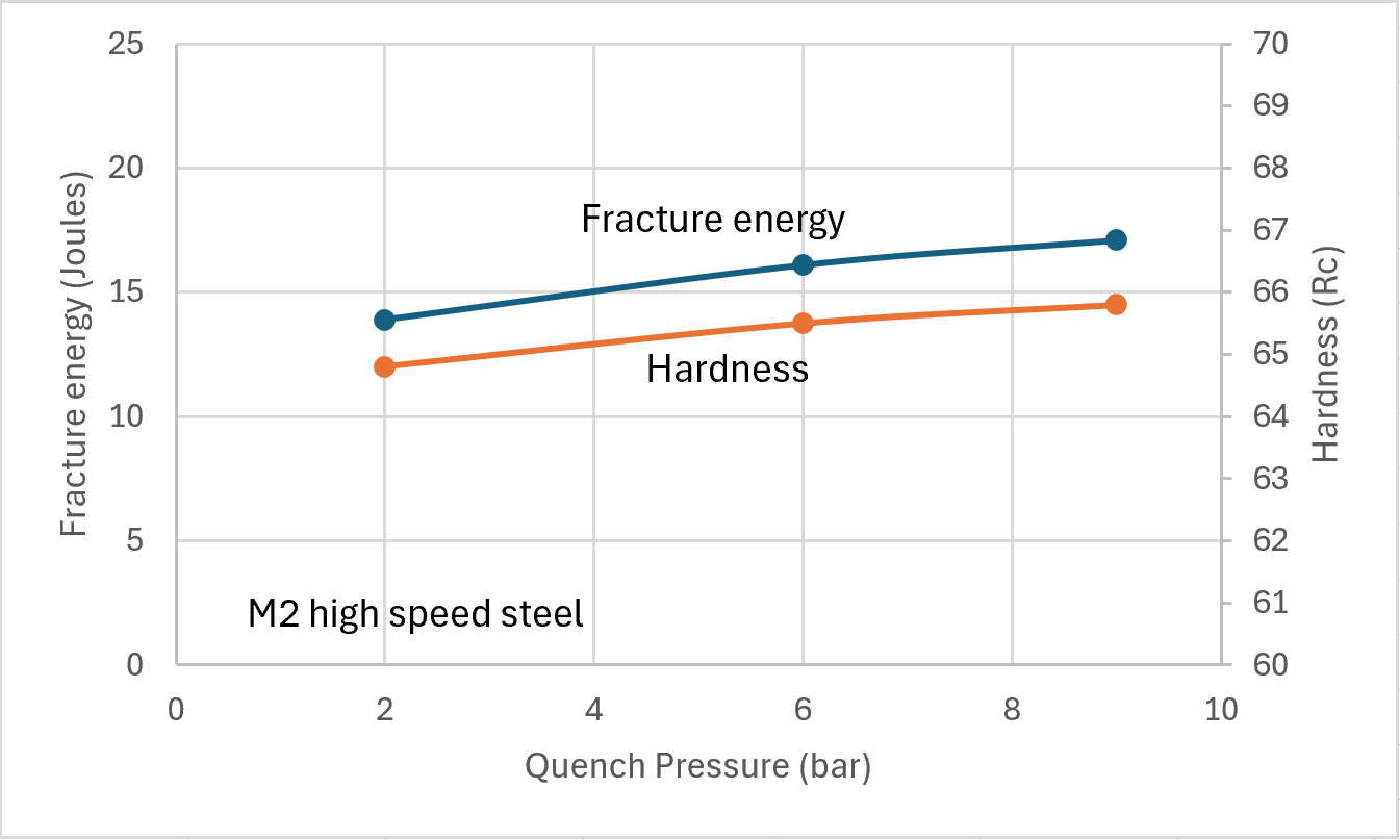

Quenching also varies quite a bit. Steels are rated by “hardenability” in terms of how fast they need to be quenched. The general categories are “air hardening,” “oil hardening,” and “water hardening.” An air hardening steel can be quenched with pressurized gas or even just in still air. Oil hardening knives are quenched in oil, and water hardening steels are quenched in water. Factory knives tend to use air hardening steels, in part because they are better suited to large batch heat treating, and in part because all stainless steels are air hardening. With custom knives, “plate quenching” has become popular in the past couple decades. Plate quenching involves placing the steel between two plates (usually aluminum) and the plates draw heat out of the blade. This is faster than sitting in air and also helps maintain flatness during quenching. The most common quenching method for factories is a pressurized nitrogen gas quench. The pressure of the gas is typically rated in “bars” where a “1 bar” quench would be atmospheric pressure, and 2 bars would be double atmospheric pressure. The higher the pressure, the faster the quench. However, this is not the only factor that matters. How “loaded up” the furnace is will also dictate the quench rate. If many blades are stacked with each other, that increases the volume of each and thus it takes longer to cool it down. You can easily imagine how a 4 inch thick block of steel takes longer to cool than a 1/8″ thick blade. And if a relatively small number of blades are in the furnace, and they are well separated, that will mean a faster quench rate even with the same pressure quench. The heat treaters usually want to load up the furnace as much as possible for efficiency. Here is a random YouTube video that shows vacuum furnaces:
Slower quenching means that hardness and toughness is reduced. Below shows a published study [1] on M2 high speed steel tested with 2 bar, 6 bar, and 9 bar quenching in a vacuum furnace. They tested the hardness and also toughness with a bend fracture test. With higher quench pressure, both properties were improved. With slow cooling, carbides are precipitated at the grain boundaries. This depletes carbon from the matrix, reducing hardness. And those precipitated carbides are brittle and reduce toughness, especially since they are present on grain boundaries.
Data adapted from [1]

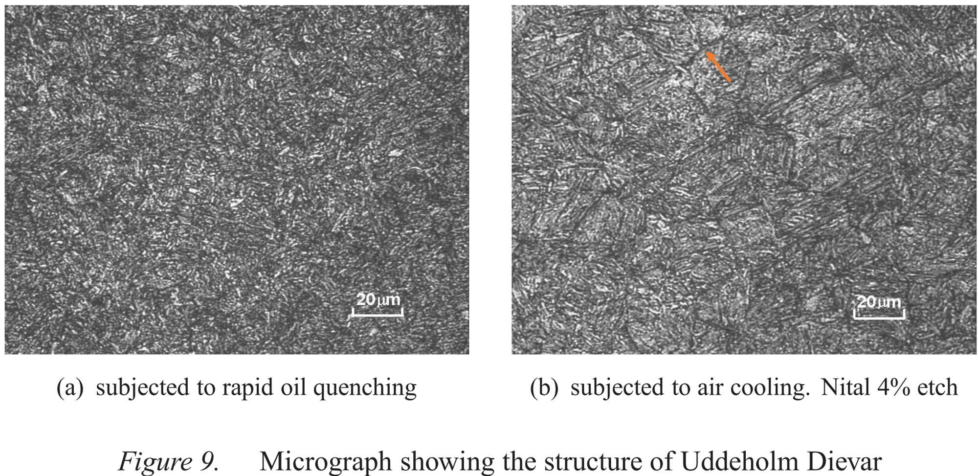

In a study on Uddeholm Dievar tool steel [2] they compared toughness between air cooling and oil quenching. They found the same 48 Rc hardness with both conditions but the oil quenched steel had 25% better toughness. They took micrographs of both conditions, and you can see the grain boundaries in the air cooled steel. The dark grain boundaries are visible because of the carbides formed along those boundaries.
Vacuum furnaces are not the only method used by production knife facilities but are by far the most common. One counterexample is Paul Bos heat treating, which is located at Buck Knives and also performs all of the heat treating for Buck. See the video below. They use a conveyer belt furnace and the steel comes out the other side and cools in air. This type of cooling is generally faster than a pressure quench in a vacuum furnace because of how much time it takes to cool down a fully loaded vacuum furnace.

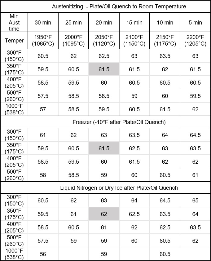

The final hardness of the steel comes from several factors. Austenitizing from a hotter temperature, or tempering from a lower temperature, usually means higher hardness. Cold or cryo processing can increase the hardness another 0.5-3 Rc depending on different factors. However, even with the same austenitizing, tempering, and cryo setup, the quench rate will affect the final hardness. This is one of the biggest differences between typical factory and typical custom heat treating.

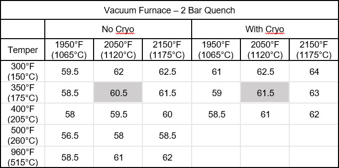

For the MagnaCut datasheet I measured hardness for a whole range of austenitizing and tempering combinations with “plate quenching” with no cryo, a household freezer, and liquid nitrogen. We also sent steel to Peters Heat Treating, which has typical factory vacuum furnaces that use a pressurized gas quench. They tested with a “2 bar” nitrogen gas quench. You can see that the hardness after the pressurized gas quench by Peters (bottom) is typically 0.5-1 Rc lower than when I plate quenched individual pieces.
Different steels can be more or less sensitive to these differences. MagnaCut has 2% Mo in it which increases its hardenability (thus it is less sensitive to quench rate). However, AEB-L has no Mo and thus it can benefit more from a fast quench. Of course an oil hardening steel would be very soft even with a high pressure quench in a vacuum furnace. For air hardening steels I have heard reports of up to 2 Rc difference between a plate quench and a 2-bar gas quench in a vacuum furnace.

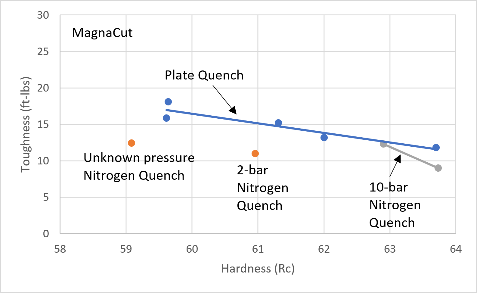

I have toughness data for vacuum furnace heat treating of MagnaCut from three different heat treaters that use vacuum furnaces, which I have compared against my own experiments with plate quenching.
The “2-bar” and “Unknown pressure” heat treaters were targeting the same hardness with the same temperatures. I am not sure the reason for the discrepancy in hardness. For toughness, both are a similar offset below the “Plate Quench” numbers because of the slower quench speed. Presumably they had a similar quench rate. The slower quench rate led to a reduction in toughness for a given hardness. The faster 10-bar quench also used a higher austenitizing temperature and a higher target hardness, so the faster quench is not the only reason for higher hardness. However, for a given hardness this heat treatment was closer in toughness to the “custom” heat treatment using a relatively rapid plate quench.

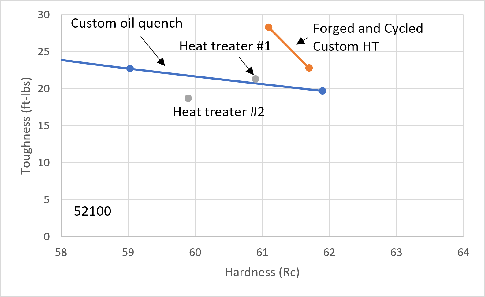

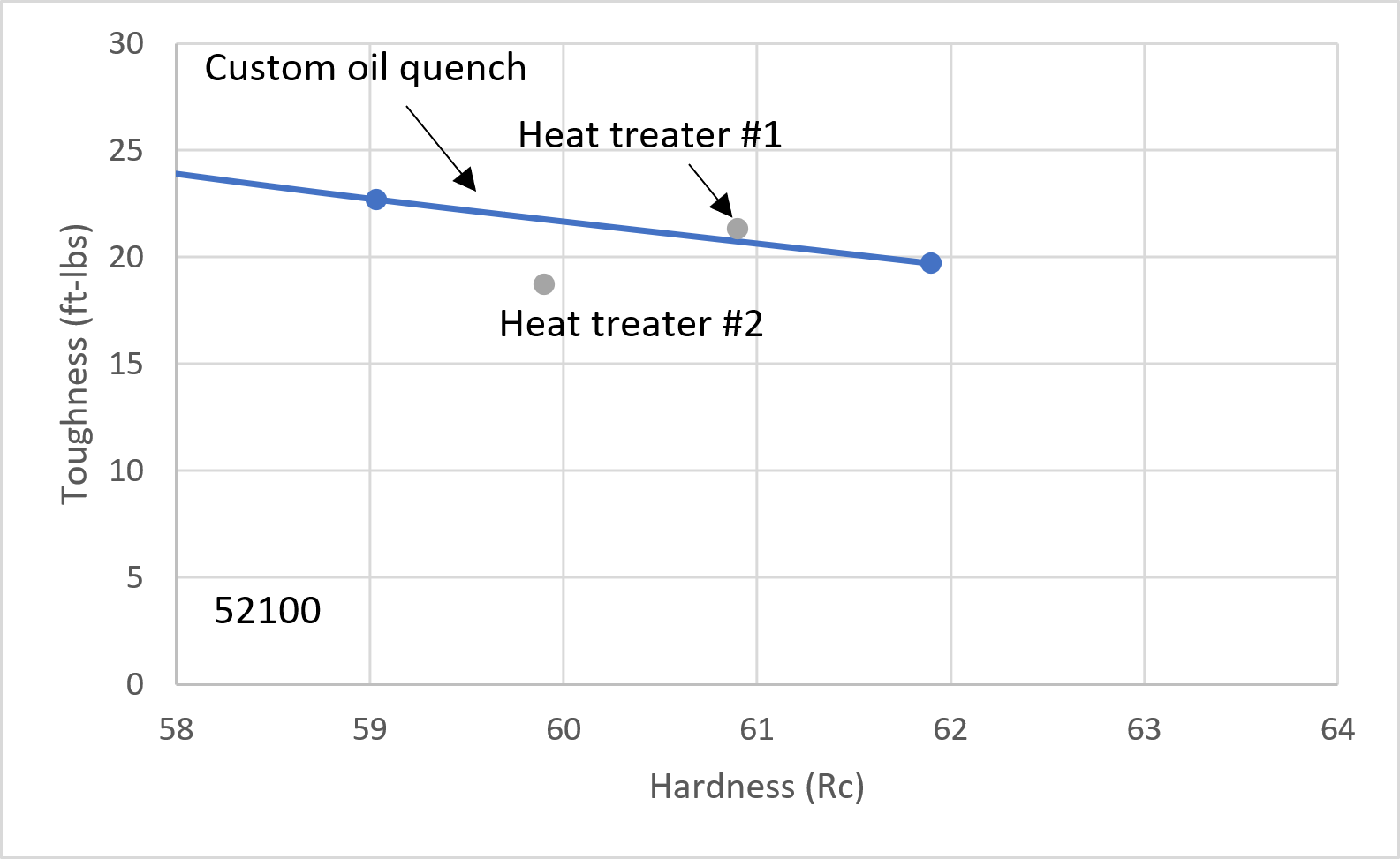

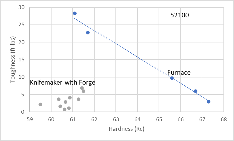

Below are results from heat treating of 52100 with a heat treatment performed by knifemaker Warren Krywko and also two heat treatment facilities that can do oil quenched blades:
The austenitizing temperatures and quench rate were similar in the case of 52100 since all were quenching in oil. Therefore the hardness and toughness was similar whether it was done in a small shop or by a commercial heat treatment company.

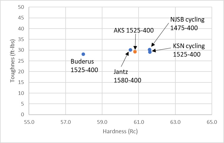

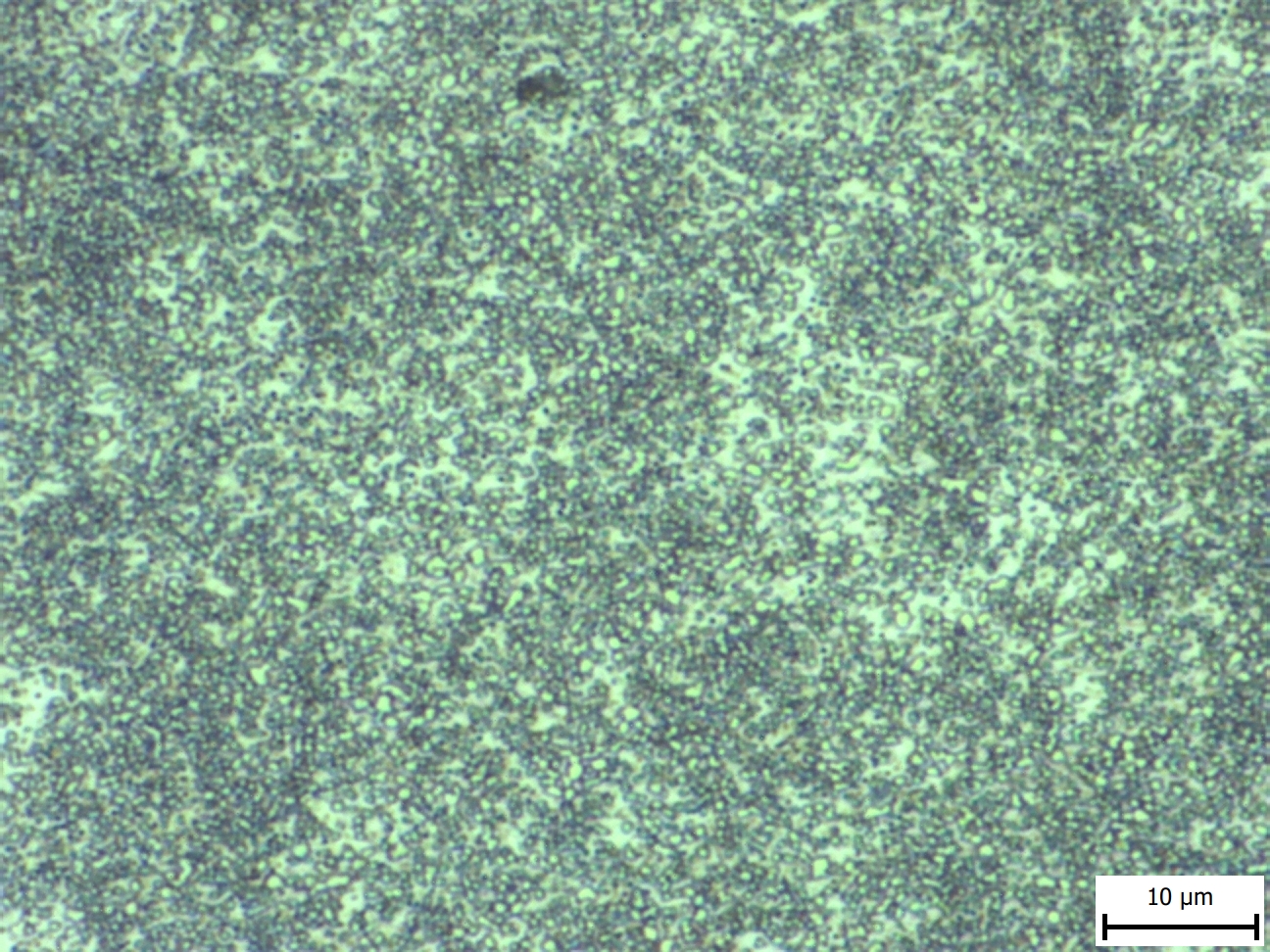

Forging and Thermal Cycling by Custom Knifemakers

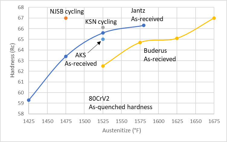

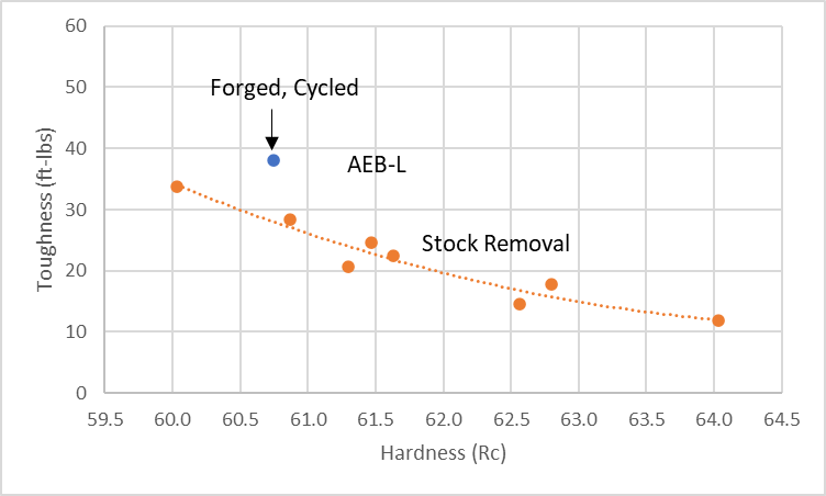

One way that custom knifemakers will try to make their heat treatments better than factory knives is in forging and thermal cycling of their blades prior to the steps we outlined above (austenitizing, quenching, and tempering). While knifemakers typically will claim that forging, and especially thermal cycling, is for the purpose of refining the grain size, instead the biggest differences are from affecting the carbide structure prior to austenitizing. The steel manufacturers typically want the steel to be as soft as possible for easy machining and grinding by the end customer. The very soft steel is achieved by having a relatively coarse annealed microstructure. If instead the carbides are smaller and the steel is a bit harder in the annealed condition, then the hardness-toughness balance can be improved somewhat. By modifying the normalizing and annealing process (called “thermal cycling” by knifemakers) you can achieve these results. Click here for an article about normalizing and annealing. This thermal cycling could likely be replicated to some extent even in a factory setting, but typically the time, logistics, and cost make this less feasible when hundreds or thousands of blades are being produced. Below I have the same 52100 chart as before but this time I added in results from 52100 that was forged and thermal cycled by my father Devin Thomas. To be clear, it was the modification to the carbide structure through a different normalizing and annealing process that led to the change in properties, not the forging. You can read about the process that was followed in this article on 52100.

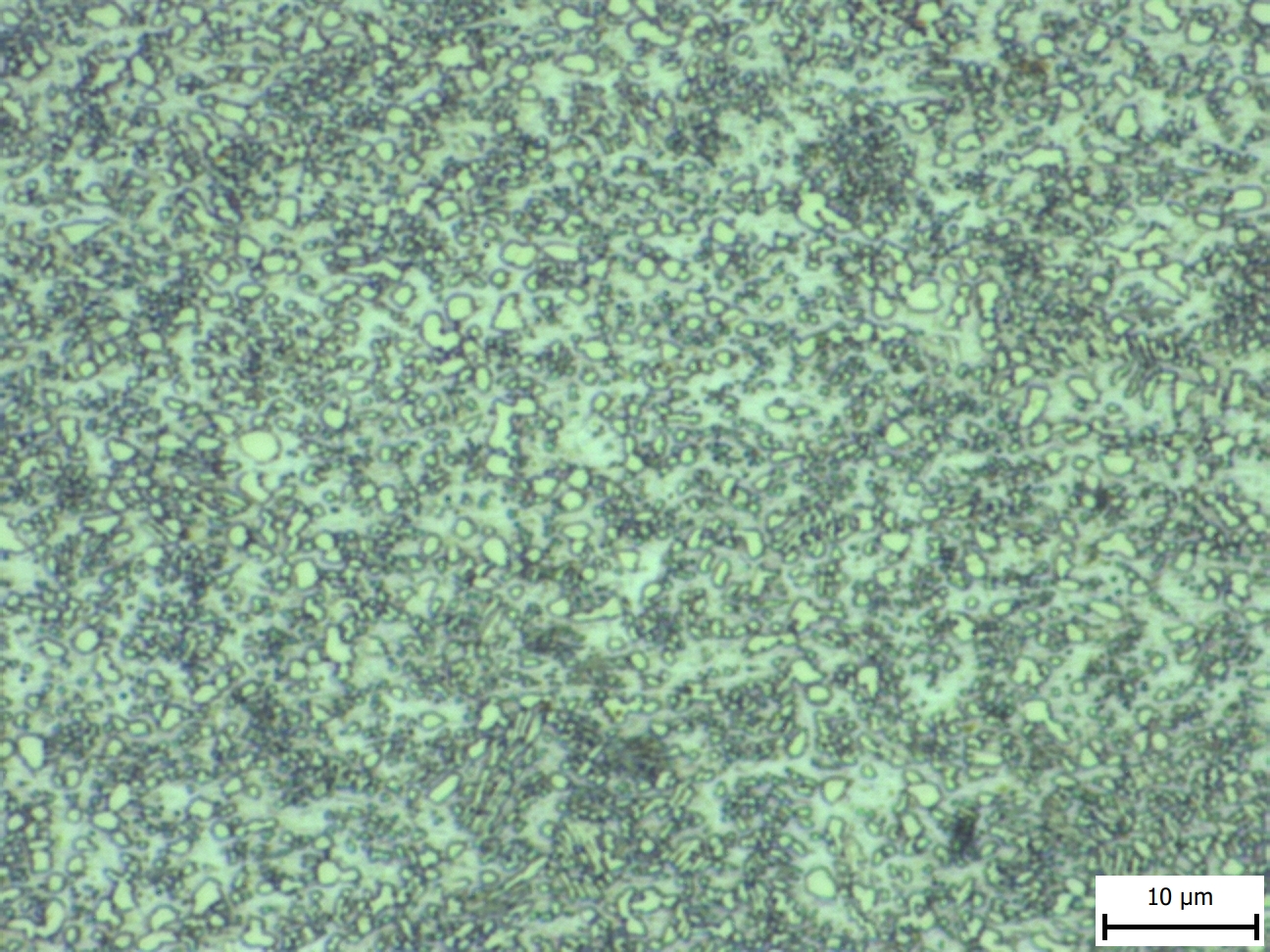

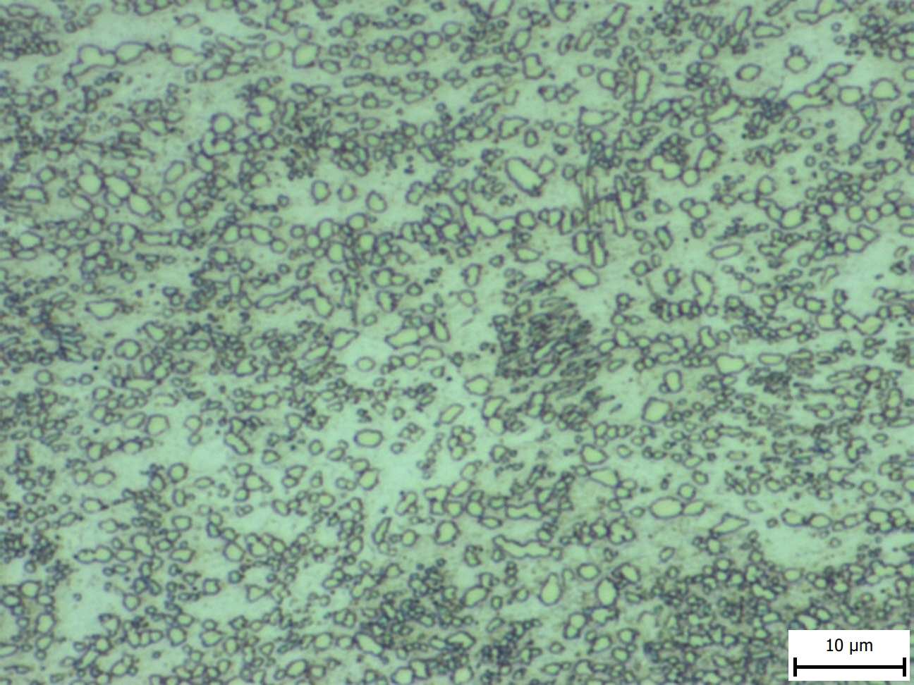

Some steel manufacturers will have a coarser starting structure than others, leading to differences in how the steel responds to heat treatment. In my study on 80CrV2, I found that one steel manufacturer’s steel needed significantly higher temperatures than the others to achieve the same hardness. Notice how the “Buderus” material is softer than the steel labeled “Jantz” or “AKS” which were also heat treated as-received from the manufacturer. The “KSN cycling” used my own recommended normalizing and annealing. The cycling procedure I performed did not start with forged steel, showing that the improved microstructure can be achieved without forging.
We found that this result lined up with the starting microstructure:
Buderus-annealed 80CrV2
Jantz-Supplied 80CrV2
80CrV2 with “KSN cycling”
The smaller carbide size also led to improved toughness for a given hardness with 80CrV2. Notice that toughness was similar for each condition but at higher hardness when the starting carbide size was smaller:

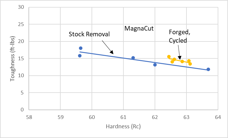

While “thermal cycling” is much, much more common with simple carbon and low alloy steels, there are improvements to be had even with stainless steels by refining the carbide structure. Below are results for AEB-L and MagnaCut:
You can see that in both cases we had relatively small improvements to the hardness-toughness balance by improving the annealing process that was used for those two stainless steels. You can read about how those were optimized in this article on forging and annealing stainless steels.

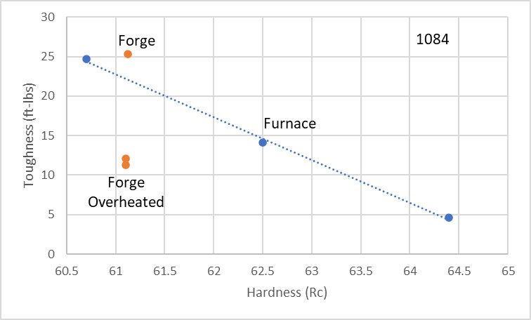

In many cases the difference is pretty small between a “basic” heat treatment and one with more involved thermal cycling. Usually with more complex and “dialed-in” heat treatments the potential improvements are small, on the order of 10-20%. When I refer to a “dialed-in” heat treatment I am also referring to other aspects like optimizing austenitizing and tempering temperatures. I have many articles on my website for various steels, such as when I found that CPM-CruWear has better toughness with a low temperature temper of 400°F/200°C despite the fact that the datasheet recommends the high temperature range (~1000°F/540°C) instead. However, these types of temperature optimizations can be (and sometimes are) done by either factories or by individual custom knifemakers.
When using complex or “fancy” heat treatments, the chance of making the steel worse is usually greater than the chances of making it better. I think every buyer should be skeptical of knifemakers that are claiming their heat treatments are significantly better; without quantitative, controlled testing methods the knifemaker is unlikely to know whether an improvement has been achieved. I have heard many knifemakers claim improvements based on changes they made that basically have no chance of improving anything. And some of those modifications are actually making it worse. For Knife Steel Nerds I have tested heat treatment changes I was sure would improve the steel, but instead found worse properties. For example, I did a rapid triple quench heat treatment of 1084 using salt pots. The hardness ended up the same, but I was shocked to see that the toughness had been significantly reduced, especially since the grain size was small in all three tested conditions. The normal furnace heat treatment is labeled “Furnace in air,” the short salt pot heat treatment is labeled “Salt pot, 3 mins,” and the triple quench is the same label with “(x3)” added. In this case the best result was with the basic and boring heat treatment.
But the above examples I have given on improved (or worsened) custom heat treatments all assume furnace heat treating with well controlled temperatures. There is a much more common and pernicious form of custom heat treating which is largely accepted in custom knifemaker circles: forge heat treating. The biggest problem with forge heat treating is that the temperatures are not well controlled. Typically the knifemaker does not even know for sure what the temperature is. There are some methods, like using a magnet, that are used to try to be more consistent, but none are as good as using a furnace with well controlled temperatures. Some steels are more sensitive than others, and some methods are better at being consistent, but none are perfect. Knifemaker/metallurgist Juha Pertulla did an experiment with forge heat treating of 1075 steel where he found that holding the steel for only one second beyond reaching nonmagnetic had already led to increased grain size and reduced toughness. Using 80CrV2 with its vanadium addition made the steel less sensitive to overheating. In my own experiments with forge heat treating I also found 1084 steel (similar to 1075) to be sensitive to overheating:
I have had multiple knifemakers argue with me that I am wrong about the unreliability of forge heat treating. Three of them have sent me steel they heat treated to show me how their forge heat treatments are consistently high in performance. Every case I have tested so far has resulted in poor toughness from overheating. Here is one example:

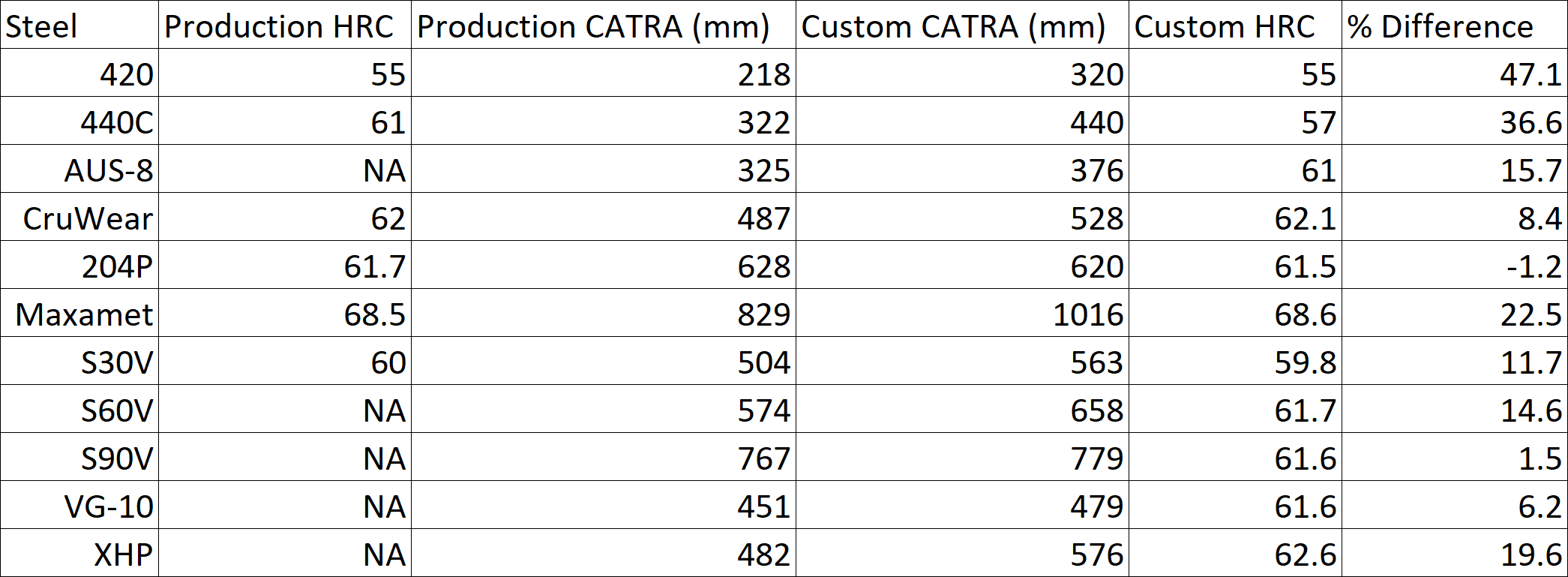

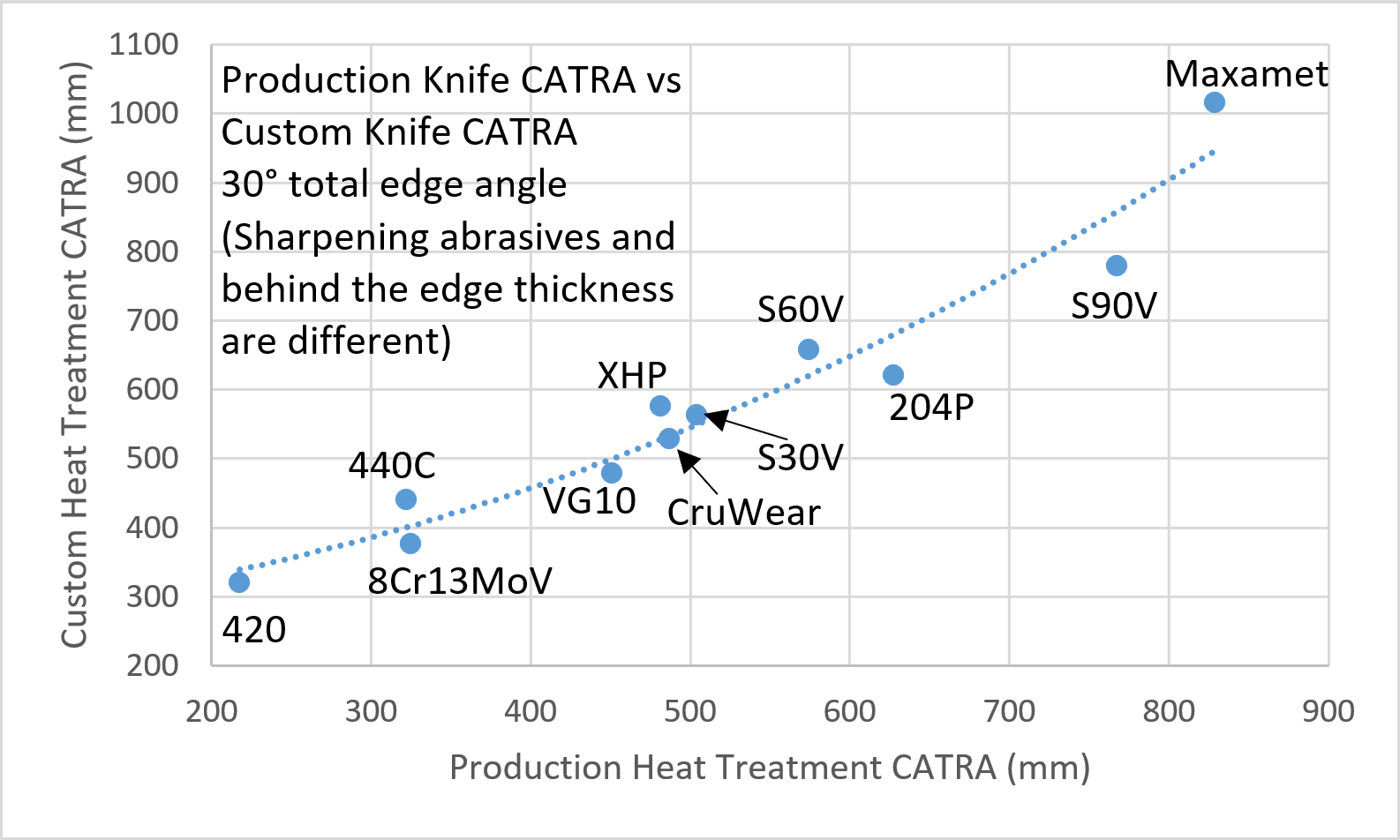

Many years ago I analyzed a set of CATRA edge retention data from a major knife manufacturer and wrote two articles about it: Part 1 and Part 2. Later I obtained my own CATRA tester and did a large set of tests on a wide range of steels. I have had some knife enthusiasts argue that because I was performing my own custom heat treatments that my tests should not be accepted out of hand. Usually this is because they think a steel over- or under-performed relative to where they had already decided this steel should be on the chart. To study this I compared a range of steels that I had tested to the knife manufacturer’s dataset:
The relative position of each steel was basically the same whether it was my tests with “custom” heat treatments or the knife manufacturer with “factory” heat treatments. However, you will notice that my results were consistently somewhat higher than the knife manufacturer, averaging about 17% better. This is not because my heat treating was superior, but rather due to differences in the design of the blades, the edge geometry, and how the blades were sharpened. The “behind the edge” thickness was greater with the production-made test knives. Also, the knives that I tested were sharpened with an Edge Pro which keeps the edges very “triangular” without rounding. The factory sharpened knife edges instead have a more convex shape, which makes them behave more like an edge sharpened to a more obtuse angle. The factory knives were given a polishing step at the end of sharpening. My knives were sharpened to 400 grit, relatively coarse, which gives the steels enhanced slicing edge retention. I have tested the effect of edge finish on CATRA edge retention in the past:

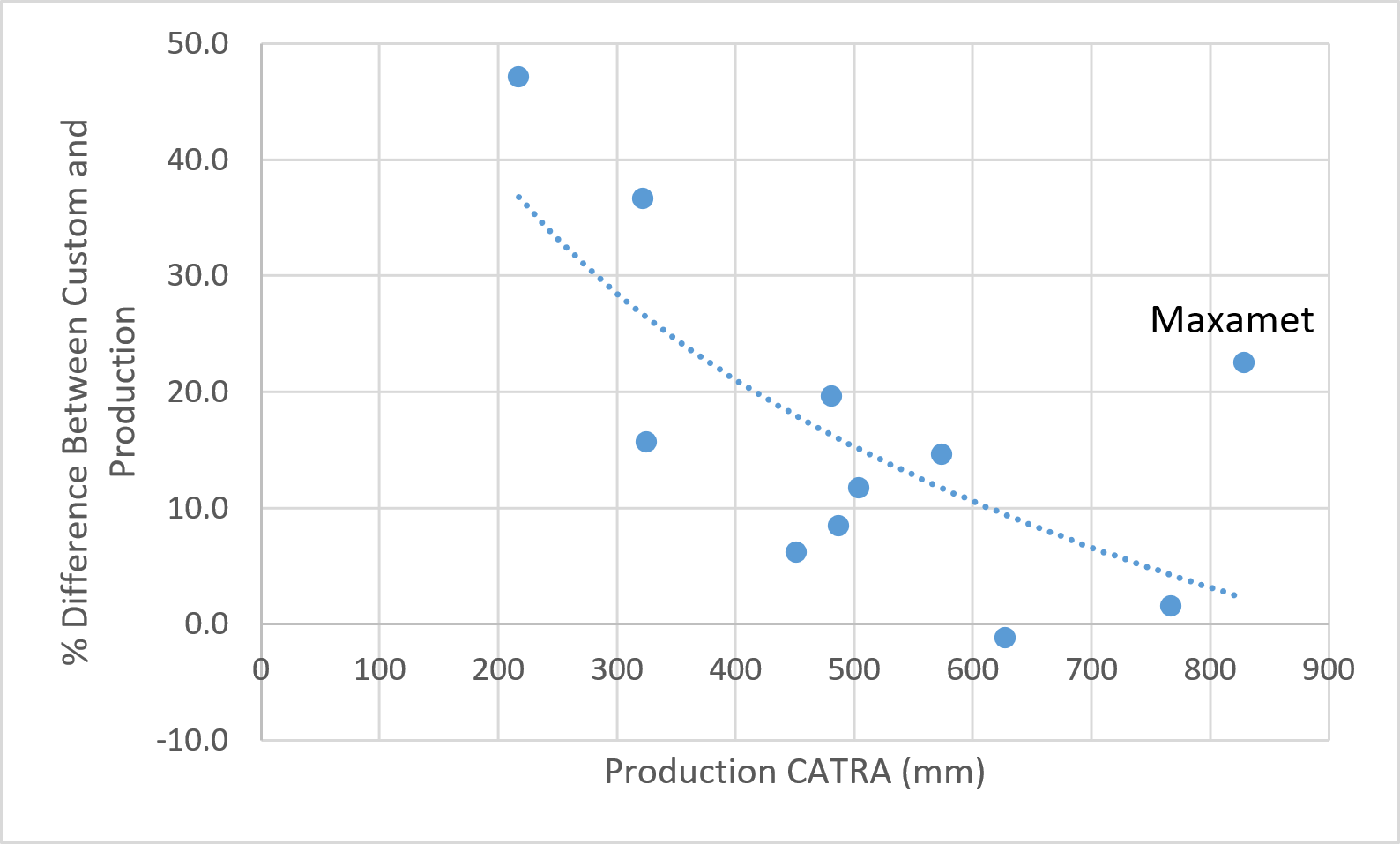

Another clue is seen when we plot the percent difference between my “custom” knives and their factory knives vs the total CATRA edge retention:
If we ignore Maxamet, the percent difference is greater with lower edge retention steels. I promise I do not have secret heat treatments that can make 55 Rc 420 steel cut 50% longer. Instead it was because of the differences in sharpening and edge geometry. With the low wear resistance of 420, how much cardstock it cut was largely controlled by its cutting ability (sharpness and edge geometry) rather than its wear resistance.

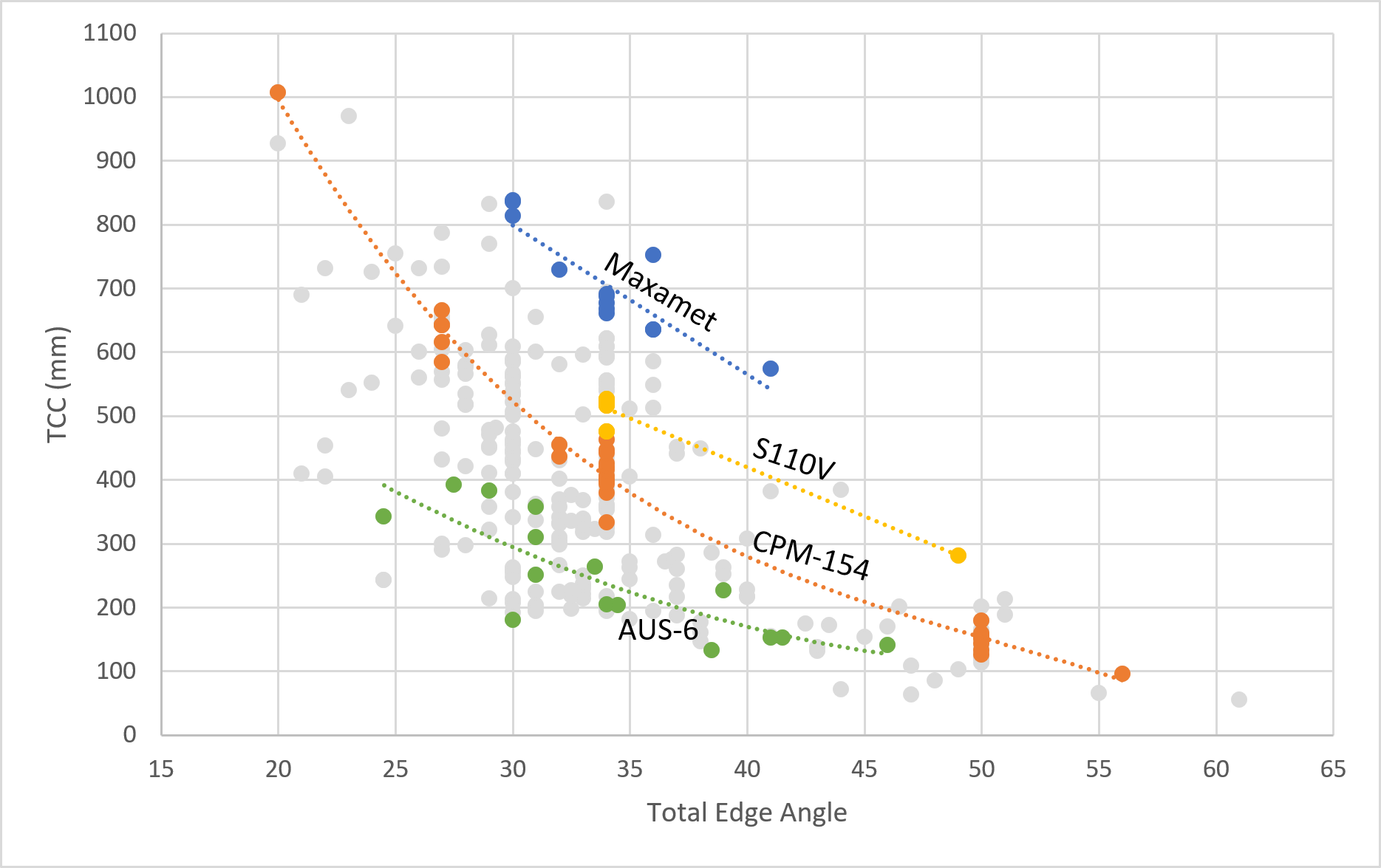

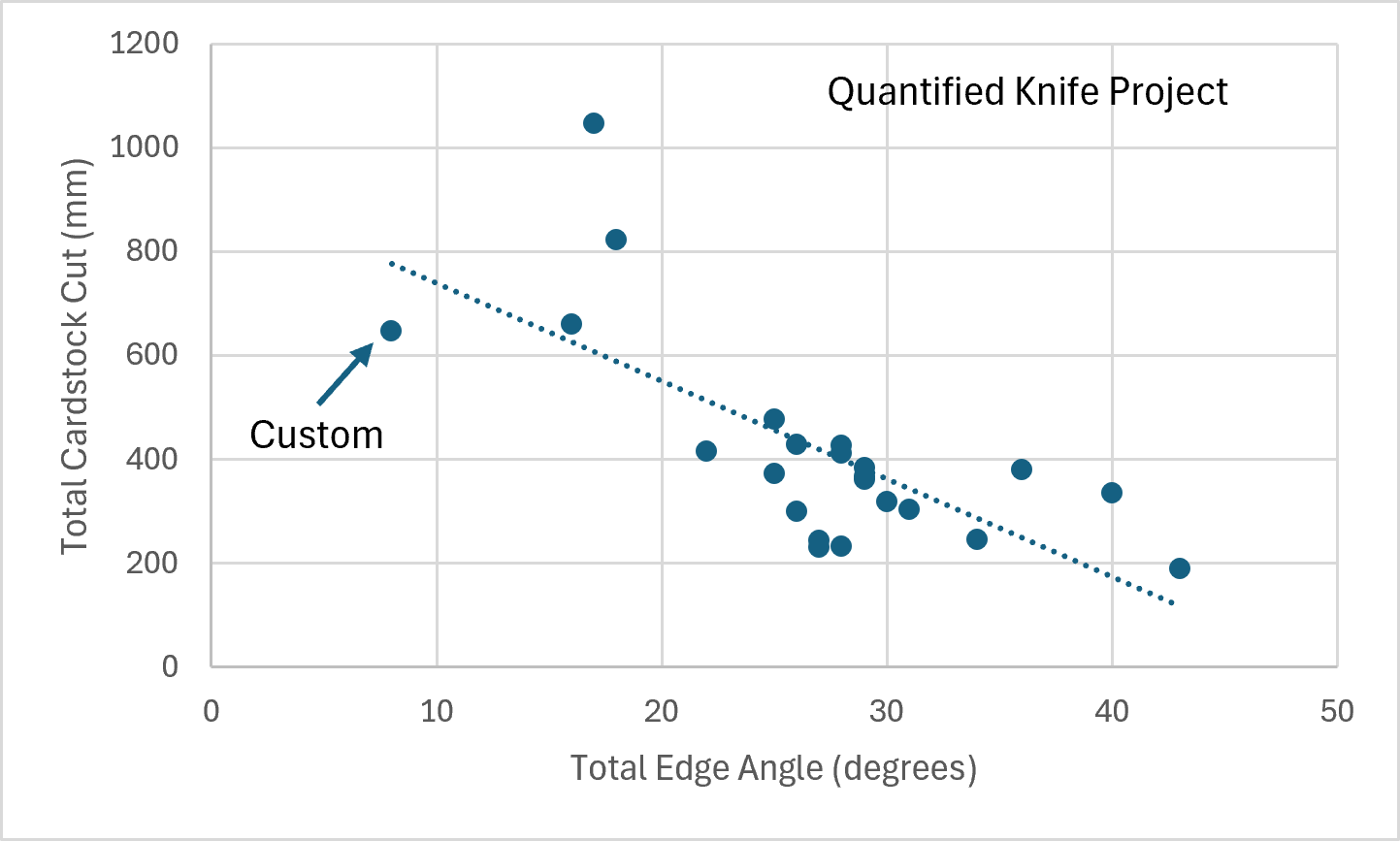

To illustrate just how important the edge geometry is, here is a chart showing the effect of total edge angle vs CATRA edge retention:
You can see that AUS-6 with a 27 degree edge (13.5 degrees per side) cut about 400 mm of cardstock. This matched the performance of the significantly more wear resistant CPM-154 with a 34 degree edge, which is only 3.5 degrees per side greater. And that same 400 mm is measured with the very wear resistant S110V with an edge angle of about 41 degrees. If CPM-154 is given a 27 degree edge instead, it matches Maxamet with a 41 degree edge! So small differences in sharpening can make a big difference in the result of an edge retention test.
Custom knives are often given thinner edges than factory-made knives. In general, when superior edge retention performance is measured with custom knives, it is due to better edge geometry rather than any kind of super, unmatchable heat treatment. When a custom heat treatment does perform better with identical edge geometry and steel it can usually be attributed to higher hardness. In my own CATRA experiments, the effect of hardness is greater than other changes to the heat treatment. This is in contrast with toughness measurements where I often find significant differences when changing heat treatment variables.

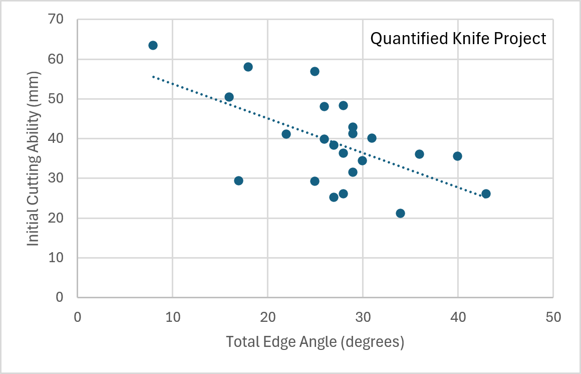

For one more dataset that shows the importance of edge geometry I can show the “Quantified Knife Project” of Seattle Ultrasonics. I performed the CATRA tests for this project. We measured the cutting performance of a range of low- to high-end factory knives and one custom made knife. For the initial cutting ability (how much cardstock cut in the first back and forth strokes), the only difference in performance was edge geometry and sharpening. In this case the correlation with edge angle is very strong as we would expect:
However, even when we plot edge angle vs CATRA edge retention, we find overall the trend with edge angle is still very strong:
For the majority of the knives, the strong effect of edge geometry completely washes out any potential analysis for the effect of steel type and heat treatment. This is despite the fact that there is a wide range of steel from 56 Rc low wear resistance stainless steels (1.4116) in many of the European knives to ~60 Rc VG10 in many of the Japanese knives. The main exception to the trend are those values at ~820 and ~1050 mm. Those are for the steel advertised as “FC61” steel which is a proprietary name. I have seen speculation that the FC61 is similar to AEB-L or 13C26 (relatively low wear resistance), but this very high performance would seem to point towards it being something more wear resistant. However, not many of the knives were below 20 degrees so there aren’t many other comparisons.
Another specific knife I want to point out is the custom Moritaka knife, the only custom knife that we tested. It was one of the best performers at ~650 mm. This was in Blue Super steel which in my testing with a 30 degree angle was only at 338 mm. So the superior results for this custom knife were not from a super heat treatment or magical forging but instead from a smaller edge angle. Of course it should be noted that the very low edge angle also makes this edge more delicate; it is more likely to chip in use. Everything is a tradeoff.

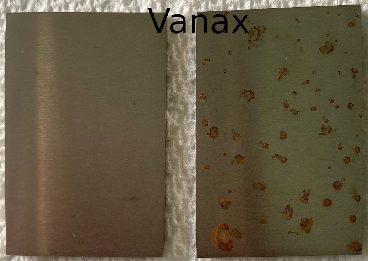

The carbides precipitated during a slow quench are also detrimental to corrosion resistance. Of course, other heat treating variables also matter. A higher austenitizing temperature means more chromium carbide is dissolved, putting more chromium in solution for better corrosion resistance. And it is relatively common in industry to use the high tempering range of 950-1050°F (510-565°C) which reduces corrosion resistance. This can make the very high corrosion resistance Vanax behave more like a “normal” stainless steel. I have an article on my corrosion resistance testing here. This high temperature tempering range can be used by both custom knifemakers and commercial heat treaters but I see it somewhat more often with commercial heat treating.
Vanax tempered at 400°F on left and 1000°F on right. Sprayed with 1% saltwater for 24 hours.

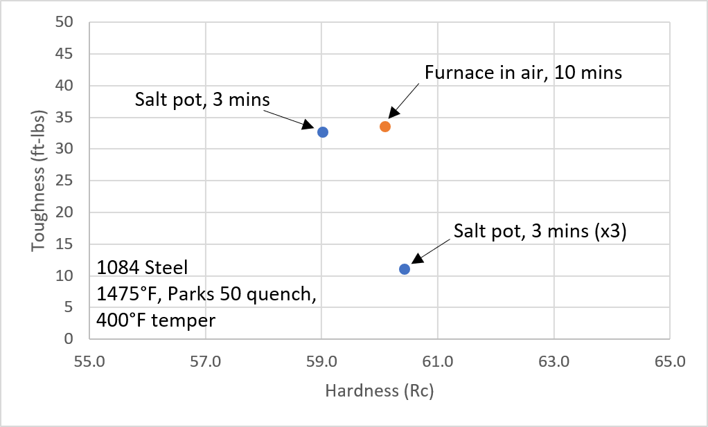

  2. I would be surprised if someone running a business and heating 52100 in a forge could consistently get good hardness and good toughness at the same time. I’d like to send some induction forge samples at some point to see how they turn out, but at the same time, I’m not sure the frequency of the common induction forges can get 52100 where it needs to be for a quick heat to get high hardness. I’ve made a bunch of chisels (thicker than coupon samples – the induction forge is keyed to them better than it would be thinner pieces) out of 52100 that land around 63/64 after 2 400F tempers and have very compact grain and none have untoward behavior, but I’ve also had to resort to leaving some length and punching the edge off initially to double check grain size under magnification, and to hardness test every single chisel. At a scale when you’re making one or two things an hour, this time commitment isn’t a problem. Industrially, I’m sure it wouldn’t work.
    the 1084 sample is puzzling – not doubting the results, but from a thermal cycling standpoint, a quick heat only to bordering nonmagnetic and no more and then cooling seems better than what’s effectively a bunch of soaks. The results you found are undeniably worse and good as a “don’t do this” scenario, though.
