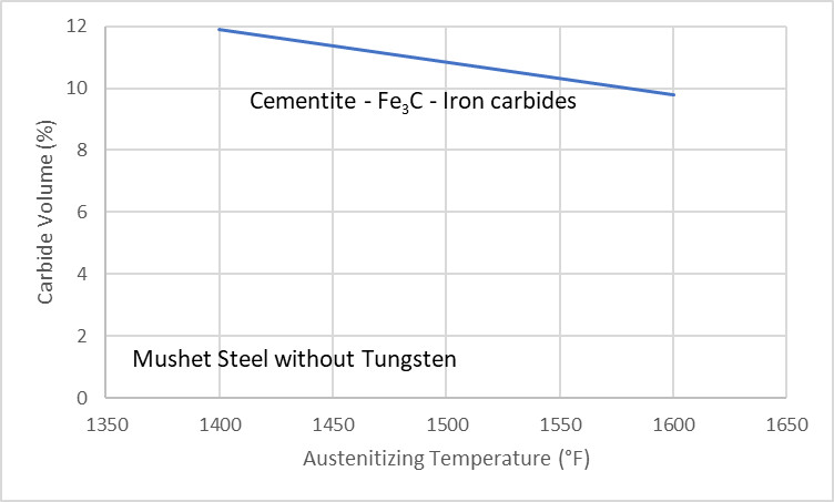

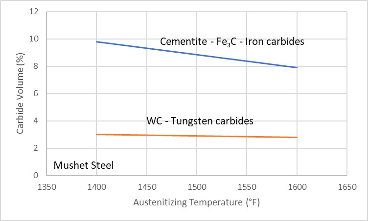

In the figures you can see that the amount of cementite is slightly reduced, but a significant amount of tungsten carbide is present in the Mushet steel, which contributes greatly to wear resistance. The combination of air-hardening and high wear resistance of what was called “R. Mushet’s Special Steel” led to many competitors creating their own “self-hardening” steels because they could be hardened in air and therefore reduce distortion and cracking that can occur during severe water quenching, and because the increased wear resistance from tungsten, cutting tools could be operated at much greater speeds [1].

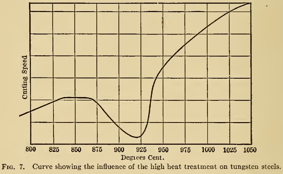

Up until that point steel was heated to a hardening, or austenitizing, temperature between around 1400-1600°F prior to quenching to form martensite. However, Taylor and White threw old conventions out the window and tried every parameter they could think of to maximize cutting speed. While the discoveries in question are usually attributed to Taylor and sometimes also to White, there were many people involved, as Taylor said, after listing several contributors [5]:
During these years we have consulted so freely together in all matters relating to these experiments that with few exceptions hardly a step has been taken which can be said to have originated with any one man. Therefore, whatever credit or blame may come to this work should be impartially divided among us. In writing this paper, then, no effort will be made to discriminate, as to the results which have been obtained in our investigations, between the work of one man and another. Mr. White is undoubtedly a much more accomplished metallurgist than any of the rest of us; Mr. Gantt is a better all-round manager, and the writer of this paper has perhaps the faculty of holding on tighter with his teeth than any of the others.

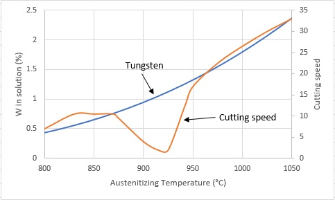

They performed experiments with Mushet steel and several modifications of it. Conventional wisdom in the past was that austenitizing at too high a temperature would lead to grain growth and a decrease in performance. Taylor and White also found a decrease in performance above conventional temperatures, but also went even higher. The great discovery that they made was that when Mushet steel was hardened at very high temperatures, a massive increase in maximum cutting speed was achieved [1]:

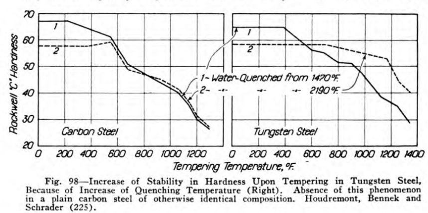

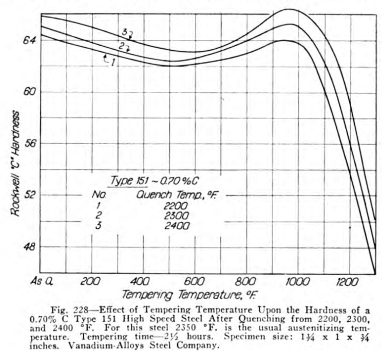

The reason for the initial decrease isn’t clear to me, and was later called into question [6]. However, the mechanism for why there was improvement at higher temperatures is now well understood. At higher temperatures more tungsten carbide was dissolved, allowing tungsten to be in solution after hardening. Tungsten in solution delays the reduction in hardness with high tempering temperatures or even increases hardness at appropriate temperatures [7]:

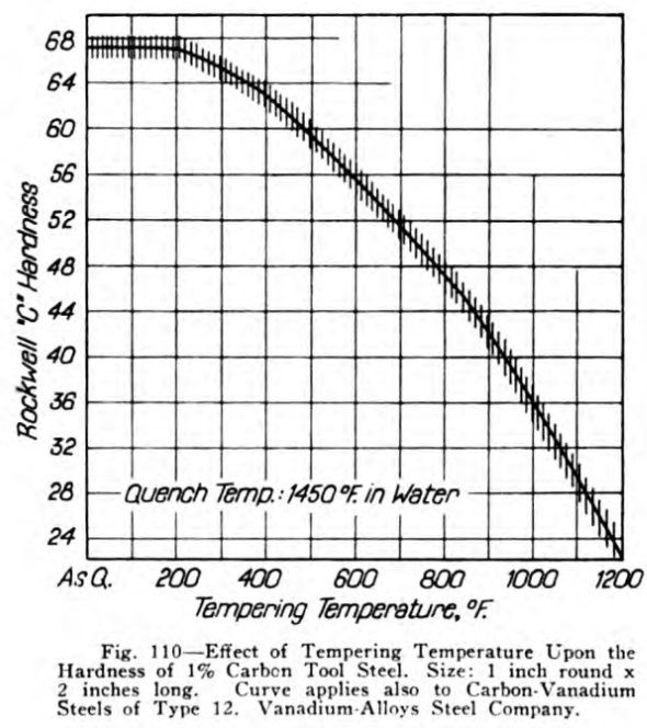

The figure shown above shows two steels, a simple 1.5%C steel (1), and a 1.5%C steel with 8% tungsten added (2). The left shows both steels austenitized at 1470°F, where both steels show similar behavior with tempering above 550°F or so, because the tungsten-added steel has little tungsten in solution. However, when austenitized from a very high temperature (2190°F), the tungsten steel softens more slowly with increasing temperature. Therefore, Taylor and White discovered that the cutting tools could be run at very high speeds because they could be heated to relatively high temperatures while maintaining their hardness. I used JMatPro to calculate the tungsten in solution vs austenitizing temperature and then overlaid it on the same plot showing the effect of austenitizing temperature on cutting speed:
A very good correlation can be seen with tungsten in solution. The mechanism by which tungsten increases hardness at high tempering temperatures is too large a topic to cover in this post, but a summary is that higher amounts of tungsten leads to precipitation of very fine tungsten carbides that increase hardness at the higher tempering temperatures.

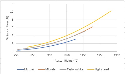

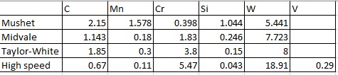

Taylor and White studied their new high temperature austenitizing heat treatments on many different alloys, including the following [5]:
From top to bottom this shows the general progression that they followed when finding better and better alloys to maximize cutting speed. First they switched from Mushet to Midvale steel which lowered the carbon content, raised the tungsten, and switched from manganese to chromium for hardenability which they report led to superior behavior. They switched to a steel with higher chromium for better hardenability for air hardening and a steel referred to as “Taylor-White,” which is what was originally patented by them, though that patent was later rescinded because it was revealed that they did not develop the steel itself but simply the heat treatment process [6]. See the end of this article for a discussion on why they switched from manganese alloying to chromium alloying to achieve the “air-hardening” property. They then found that even higher amounts of tungsten led to even better cutting speeds while using an 18% tungsten steel that became the prototype for the high speed steel T1. It is unknown who developed the 18% tungsten steel that they studied, but Taylor and White had switched to it by 1903 [6]. At one point T1 steel was 80% of the high speed steel market [3]. I again used JMatPro to calculate the maximum possible tungsten in solution for each of these alloys:
Each steel is plotted to just below its melting temperature, which is how hot Taylor and White were austenitizing the steels. So moving from Mushet to Midvale steel led to a doubling in possible tungsten in solution, and the high speed steel could have a full 10% tungsten in solution after austenitizing. This steel shows a significant increase in hardness with high tempering temperatures, as shown with the similar T1 [3]:

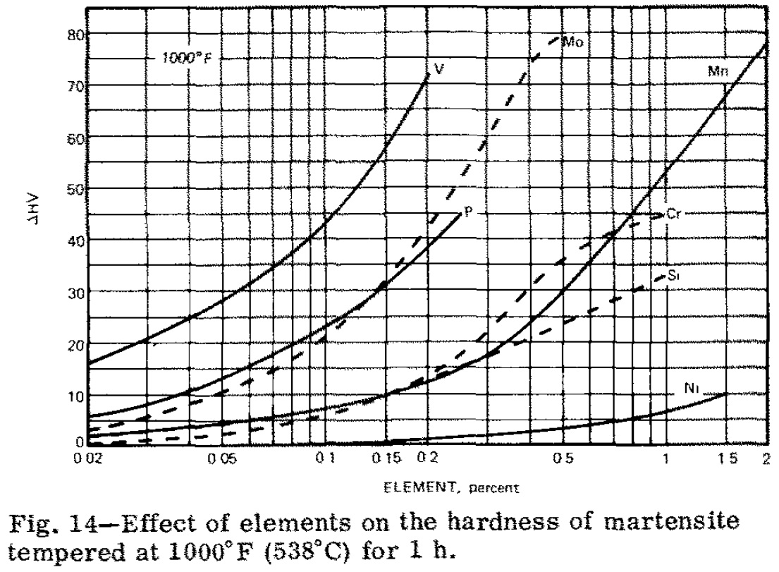

Another reason for the use of chromium may be that because higher amounts are used for achieving air hardening properties, it improves “tempering resistance” for higher hardness with the high tempering temperatures used. Chromium and manganese contribute to hardness with high temperature tempering to a similar degree, so the typical use of 2-3x as much Cr as Mn leads to higher hardness after tempering [13]:
