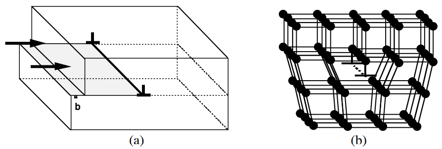

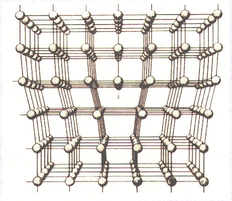

Permanent deformation is all about the movement of dislocations, or line defects, in the material. These dislocations can be thought of as a missing row of atoms, or what would happen if an extra plane of atoms were shoved into the structure leading to a gap in the crystal structure, such as is illustrated here:
These dislocations, or line defects, are not bad. They are “defects” in the crystal structure, but should not be thought of as microcracks or a defect in the material that needs to be fixed. All materials contain dislocations and they cannot be avoided. When yielding of a material occurs, or plastic deformation, it happens through the movement, or slip, of dislocations. This is the mechanism by which the material “moves” or deforms. The movement of dislocations occurs much more easily than the breaking and reforming of large groups of atoms. Large groups of dislocations move so that there are significant changes in the shape of the material. The movement of a dislocation can be visualized by thinking about a shear stress being applied to the crystal structure, where the line connected by two upside down “T’s” represents the dislocation [6]:
The dislocation moves through the material through half-step shifts in the atomic bonds with the plane of atoms above the dislocation, as you can see in this simple animation [7]:

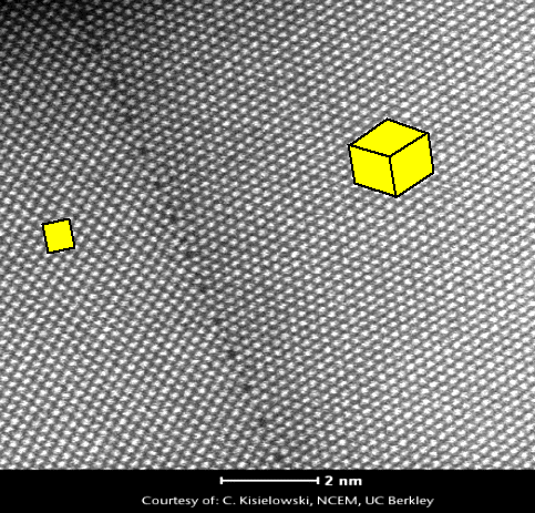

Up to this point I have been showing models and illustrations to demonstrate dislocations, but they can be observed through transmission electron microscopy. Here is a video showing the movement of dislocations [8]:
You can see that the dislocations are all moving in tandem, seeming to push each other along. Dislocations can not easily cross each other, as they apply a stress on one another, and when they do intersect they can no longer move through normal slip. Therefore when there is a large density of dislocations the material is stronger because a greater stress is required to move them, and the movement of dislocations is what controls the start of yielding, or permanent deformation.

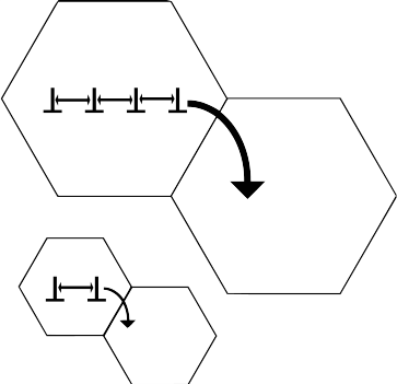

Dislocations are not the only imperfections in the crystal structure of steel. Grain boundaries are also a type of crystal defect. Grain boundaries act as barriers to the movement of dislocations, as these boundaries are intersections between different crystal orientations, where the slip plane for dislocation movement is effectively ended [9]:
This can be illustrated with a simple schematic of the change in orientation of the atomic planes at the grain boundaries:

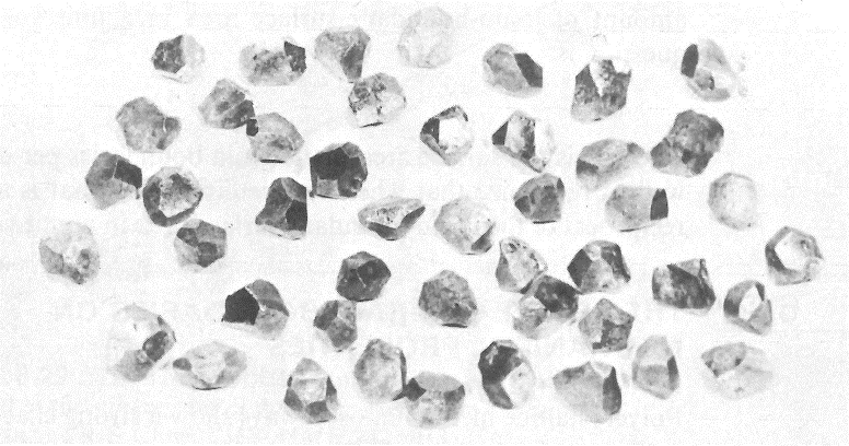

These grains can actually be removed from material with special techniques so you can better visualize their 3-Dimensional nature [10]:
The dislocations “pile up” at the grain boundaries, until sufficient stress is built up that the dislocations either change orientation to slip on the adjoining grain boundary into the new crystal plane for the new grain, or dislocations are created in the neighboring grain.  A video of dislocations piling up at a grain boundary with new dislocations being generated on the other side is seen here [11]:

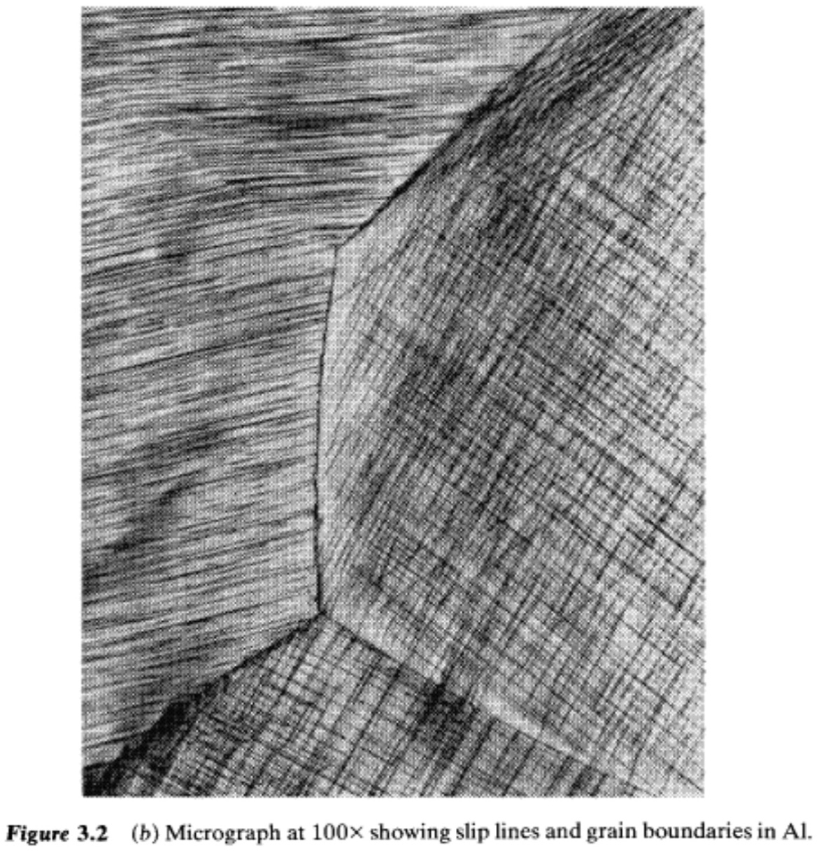

On a larger scale slip lines created by these dislocations can be seen in micrographs, and sometimes even with the naked eye [12]:

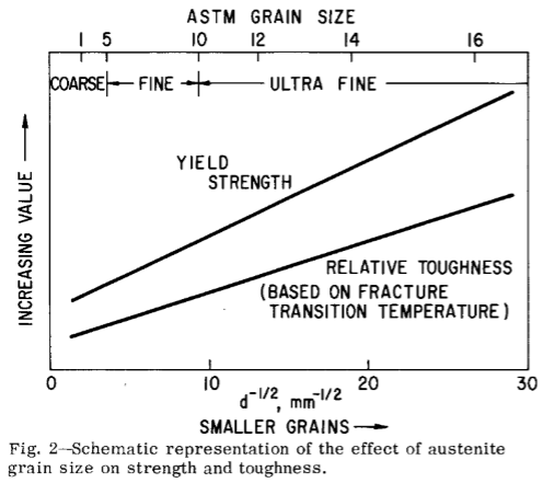

Therefore the grain size is important to this behavior, because naturally there are more boundaries to dislocation movement if the grain size is finer. However, the number of dislocations that pile-up on the boundary is also smaller [13]:
The stress generated on the dislocations by themselves is greater when more dislocations have piled up. So more stress is applied on the dislocation pileup at the boundary, so the dislocations more easily cross into the neighboring grain to yield the material for plastic deformation. With a small grain size only a small number of dislocations pileup so the stress on the boundary is very small. This all results in what is called the “Hall-Petch” relationship where a decrease in grain size leads to an increase in the yield stress [14]:
Toughness is improved by other mechanisms, of course. Toughness is controlled by the formation and growth of cracks during impact. Therefore, the grain size must control the behavior of crack growth in some way. The crack grows along the crystal planes of the individual grains, once the crack reaches a grain boundary it must re-initiate in a new crystal plane:
Here is a model someone created and posted to YouTube that shows the process [15]:
The smaller the grain size the more boundaries there are where the crack has to re-initiate. Therefore the smaller the grain size the greater the toughness.

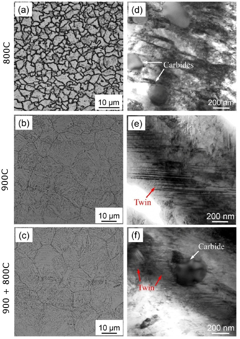

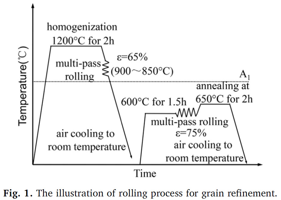

So in this new study they set up a novel experiment to adjust the grain size of 52100 and a newly designed medium carbon steel and then see if grain size affected the formation of plate martensite. They used a low temperature rolling process to refine the grain size prior to the final hardening treatment:
The grain refinement process meant that with sufficiently low hardening temperature they could achieve a very fine grain size in the final heat treated steel. But with a higher hardening temperature the grain would grow and they would be able to compare between the two different grain sizes. They then did three final hardening treatments:
  1. Heated to 800°C (1472°F) for 8 minutes followed by quenching
  2. Heated to 900°C (1652°F) for 8 minutes followed by quenching
  3. Heat to 900°C for 8 minutes, then transferred to 800°C for 3 minutes, followed by quenching
There is a reason that they used the third heat treatment with the two different temperatures. Increasing the hardening temperature doesn’t only increase the grain size, but it also increases the carbon content, and as said before higher carbon content leads to an increase in plate martensite. So they used the two step process to first grow the grains at 900°C followed by reducing the temperature to 800°C where the carbon content of the austenite is reduced prior to quenching to form martensite with a reduced carbon content vs the 900°C condition. Then they got the following micrographs from the three conditions where they marked the plate martensite with arrows labeled “twins” because plate martensite forms by a mechanism called twinning:
The researchers also found a corresponding increase in ductility with tensile testing showing that toughness was improved with the replacement of plate martensite with lath martensite. With the medium carbon steel they used the same hardening temperature with increasing time at temperature so that the grain size grew but the carbon content and final hardness saw little change. They saw a similar increase in ductility with finer grain size and also found that with fine grain size the plate martensite was no longer observed.
In conclusion, a refined grain size (approximately 4 microns or less) may lead to the replacement of brittle plate martensite with tougher lath martensite. I’m not sure we can be 100% confident that there wasn’t still a contribution from higher carbon content based on the described heat treatments, but it is a very intriguing possibility perhaps worth further study.
