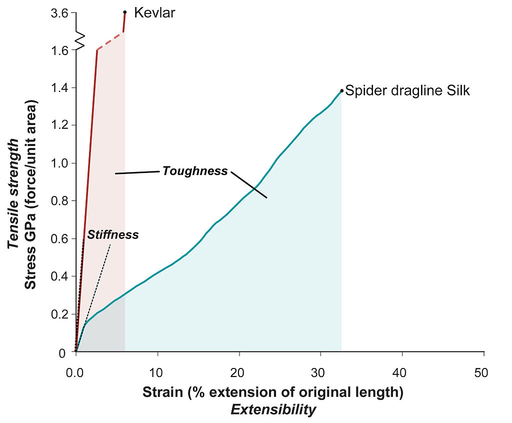

To discuss chipping we have to start with fracture mechanics of materials, and in this case steel. Chipping itself is just fracture, so by definition resistance to chipping is controlled by toughness. Unfortunately there are many definitions of toughness. I covered one definition of toughness in the article on spider silk, which is the area underneath the stress-strain curve:
There is a brief intro to tensile testing in the article on flexing and bending. In the tensile test a material is pulled until it fractures. The stress (σ) is the load divided by the cross section, and strain is the change in length divided by the original length. Therefore, stress and strain are normalizing terms that are affected by the size of a specimen. A load applied to a small sample results in a larger stress than the same load on a large sample. With the definition of toughness given by the area underneath the stress-strain curve, greater values of toughness are given by stronger materials (high stress) with high ductility (high strain).

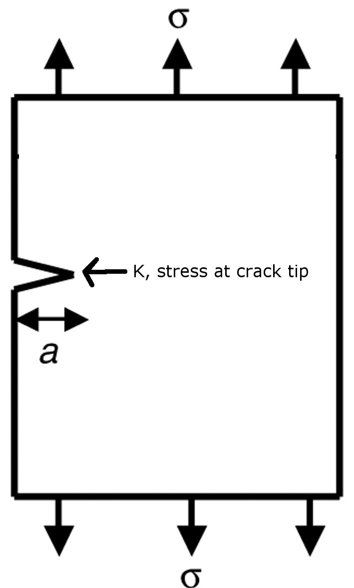

Fracture Toughness
An important measure of toughness is the resistance to fracture in the presence of a pre-existing crack. This is important because most parts in service have some level of imperfection to them. For example, a knife edge sharpened to rougher finishes will have larger scratches than a finely sharpened edge, and these scratches can be thought of as pre-existing flaws [1]:
Fracture is measured in terms of K, or “stress-intensity factor” which is the stress at the crack tip. K is proportional to the stress and the square root of the size of the flaw. Therefore a larger flaw means that less stress is required to cause fracture:

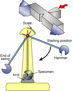

Charpy Impact Testing
Impact testing is performed by dropping a heavy weight on a pendulum through a sample and measuring the degree that the sample resisted fracturing. If there was no sample present the weight would reach the same height on the other side. The more resistant the sample is to fracture the lower the height is that the weight reaches on the other side. Charpy impact samples are often “notched” so that fracture occurs in a consistent region and has lower variability [2]:

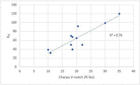

Fracture Toughness vs Charpy Toughness
The two major differences between charpy toughness and fracture toughness are 1) charpy testing is dynamic (falling pendulum breaks sample) rather than static (specimens slowly pulled apart) and 2) fracture toughness is performed on pre-cracked samples while charpy samples are typically not pre-cracked. Charpy toughness testing cannot generate a “material property” in the same way that fracture toughness can because the values are always affected by sample size. Therefore, “serious” fracture analysis is typically performed with fracture toughness testing. Fracture toughness is usually more expensive than charpy impact testing, however, and even with these differences charpy v-notch testing and fracture toughness results are often highly correlated [3][4]:
One of the reasons that charpy v-notch and fracture toughness are highly correlated is because the presence of the notch in the charpy specimen greatly reduces the energy required for crack initiation. However, in the case of unnotched samples the situation is somewhat different because there is no stress riser for lowering the energy required for crack initiation. This makes unnotched testing somewhat more variable because the crack can initiate anywhere over a certain distance because there is no notch. However, this also means that the effect of crack initiation on fracture is better captured by unnotched specimens, or gentle notches like c-notch or u-notch. Because unnotched or c-notch charpy testing incorporates both crack initiation and propagation, it correlates much more strongly with the area under a tensile curve [5]:

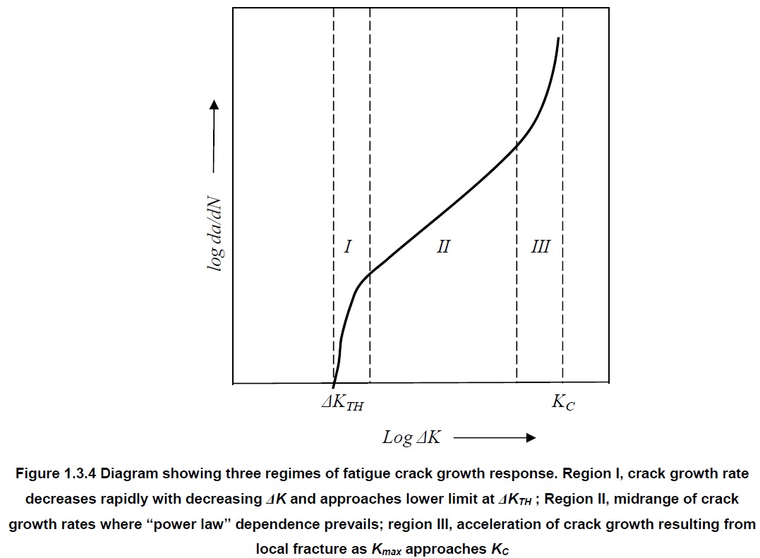

The damage to a material due to repeated loading is called fatigue. A three-point bend fatigue test can be seen in the following video:
The higher the stress applied, the smaller the number of cycles a sample can withstand prior to fracture. With sufficiently low applied stress the material will never fracture (at least with martensitic and ferritic steel), and this stress level is known as the “fatigue limit” or “endurance limit” [6]:
Below a certain number of cycles, the material reaches a region of “low-cycle” fatigue (high stress) rather than “high-cycle” fatigue (low stress), usually the cutoff point is given as 1000 or 10000 cycles, so failures in knives are almost always in the low-cycle fatigue regime. Typically low-cycle fatigue is at sufficiently high stress levels where small amounts of yielding (permanent deformation) occurs. Micro-chipping and chipping of edges occurs in the low-cycle fatigue region [7]. Low-cycle fatigue is more greatly controlled by toughness and less by the slow crack growth dominated by high-cycle fatigue [8]. This can be understood through analysis of the effect of ΔK on crack growth [7]:
This plot shows the crack growth rate on the y-axis and ΔK on the x-axis. ΔK is the difference in stress intensity factor, K, during loading and unloading (leading to fatigue), ΔK = Kmax – Kmin. So if a sample is loaded to a certain stress and then unloaded it would be ΔK = Kmax – 0 = Kmax. As described earlier, higher stress would mean a higher K value and a larger crack would mean a higher K value. At sufficiently small stress there is no growth of cracks, but above ΔKTH the cracks grow. Region I is slow crack growth, but the rate of growth increases with higher ΔK. Region II shows the region with moderate crack growth rates that are consistent over a relatively wide range of ΔK values. Region III is characterized by more rapid crack growth, and with sufficiently high ΔK then the piece breaks in one cycle and is therefore equal to or greater than the fracture toughness, KC. With sufficiently high stress applied a sample can jump into Region III or even to KC, but K is also controlled by crack size. Therefore, even with a fixed stress applied the ΔK can grow because the crack is growing, meaning that a sample can move through all three regions shown in the plot. Region III can describe low-cycle fatigue as it has a high stress-intensity factor on a crack tip. The higher the stress the closer the behavior is to fracture toughness, KC. Therefore because chipping and micro-chipping is controlled by low-cycle fatigue, we would expect toughness to have a strong effect on chipping of knife edges.

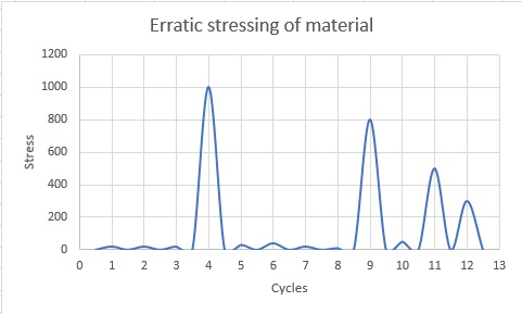

While testing in the laboratory usually uses a constant stress or strain, use of knives is by humans, and humans do not apply constant stresses, so the pattern might look more like this:
In this case the damage to the material is cumulative; the application of a low number of large stresses reduces the number of smaller stress cycles that the material can withstand.

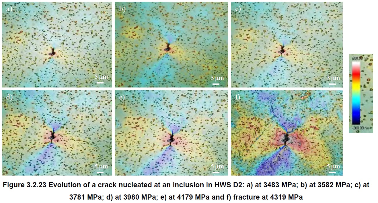

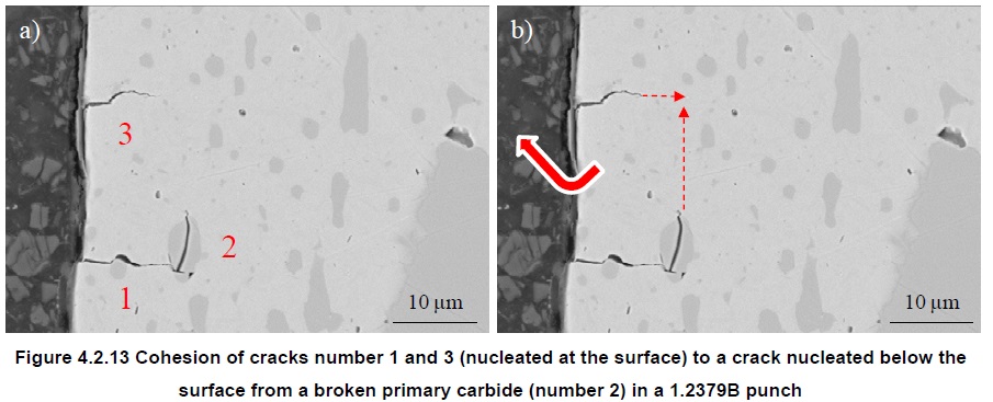

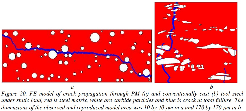

While crack initiation can certainly occur at previous flaws, in the absence of sufficient flaws they occur at microstructural features instead. With steels used in knives there is usually some amount of hard, brittle particles called carbides that contribute to wear resistance. Often large carbides are present where cracks form, either at the interface between steel and carbide or cracking of the carbides themselves [9]:
Larger carbides require less applied stress to crack than smaller carbides. In a comparison between conventionally cast 1.2379 (D2) steel and a powder metallurgy steel HWS it was found that the stress required for crack initiation was vastly different (note difference in magnification) [7]:
The stress required for cracking of carbides in the D2 was found to be only 700-900 MPa, while steels with smaller carbides required higher stress levels to crack the carbides. The cracking of these carbides is particularly bad because the cracks can easily grow along segregated carbide bands [7]:

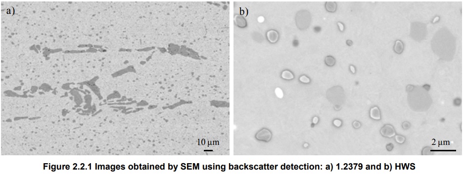

However, cracking of carbides was not seen in the HWS powder metallurgy steel, but instead the cracks initiated at impurities because they were larger than the carbides, and therefore the stress required for cracking at impurities was lower than for carbides. The stress required for crack initiation was still much higher than that required for D2, however, on the order of 3400-3600 MPa [7]:
Crack Initiation vs Fracture Toughness
One interesting thing found in the study comparing D2 and HWS was that the fracture toughness of HWS was actually lower than D2. HWS had fracture toughness of 20 MPa*√m while for D2 it ranged from 22-28 MPa*√m depending on orientation. The researchers reported that because the carbides are so small and evenly distributed in the powder metallurgy steel that they are, on average, closer together than for D2. Therefore a pre-existing crack can more easily grow throughout the steel by jumping from carbide to carbide [9]:

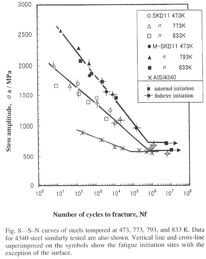

Effect of carbide volume on low-cycle fatigue
In a study comparing D2 (SKD11) with a modified steel with lower carbon and chromium for lower carbide volume and smaller carbides (M-SKD11), they found that with low-cycle fatigue the stresses allowed were much higher with the lower carbide volume steel:
The D2 steel had 13.5% carbide volume, and a maximum carbide diameter of 21.5 microns, while the modified steel had only 4.5% carbide volume with a maximum carbide diameter of 14.4 microns. There is also a comparison point with 4340 steel, which would be expected to have significantly lower carbide volume than either, but because of its lower strength (correlated with hardness) it cannot withstand the same degree of stress. At high stress levels the researchers found that cracks initiated at the surface with large carbides at the origin of the fracture. The stress level required for surface initiation in D2 was 1100 MPa, but for the modified steel was 1800 MPa. This is why when loaded to a similar stress level the modified steel with less carbide and smaller carbides lasts for 1-2 orders of magnitude more cycles than D2. The difference is greatest for a small number of cycles and high stresses which is the region of interest for knives when it comes to chipping resistance.

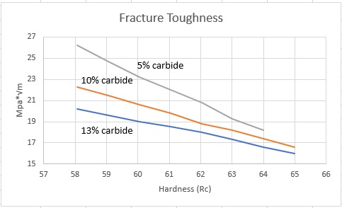

Higher carbide volume has also been found to lead to lower fracture toughness and lower impact toughness as measured by charpy or izod. Therefore a lower carbide volume improves resistance to both crack initiation and crack propagation. Higher hardness also reduces both fracture and impact toughness, and the effect of carbide volume becomes smaller at high hardness [12][13]:
Effect of Grain Size

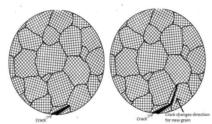

I wrote an article about the effect of grain size on toughness: How Does Grain Refinement Lead to Improved Properties?
To summarize that article, smaller grain size means that a growing crack must re-initiate and change direction as it meets grain boundaries. Therefore a smaller grain size means higher toughness:
I also showed some examples of toughness numbers with different grain size in articles on austenitizing, particularly Part 2 and Part 3. Here is a chart I shared in Part 2:

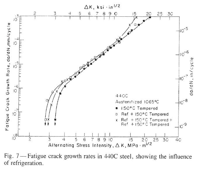

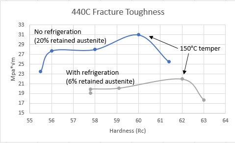

Effect of Retained Austenite
It is very common for custom knifemakers to use cryogenic processing of their steels which eliminates most of the retained austenite in the steel. I wrote a forum post about what retained austenite is and what cryo treatments do. Toughness testing usually shows an increase in toughness with greater retained austenite, as can be seen in this figure for 440C [5]:
However the concern sometimes is that through stressing of the steel with retained austenite present that the austenite will transform to (untempered) martensite and therefore the brittle phase will act to reduce toughness. However, fatigue testing of material paints a different picture, where the retained austenite containing steel, which converts to martensite during cyclic loading, has higher resistance to fracture [5]:
From that figure it can be seen that the steel with retained austenite had both a higher ΔKTH (stress intensity required for crack growth), and at high ΔK approaching KC (low-cycle fatigue and fracture toughness) the resistance to fatigue is better. The behavior in the steady crack growth region is similar between the two. During crack growth there is stress on the surrounding austenite and it transforms to martensite. Martensite is a larger phase (less dense) than austenite and therefore during the transformation the expansion from the transformation leads to “plasticity-induced crack closure.” A stress applied to the crack closes it and therefore the stress required for crack propagation is greater. A micrograph showing a crack growing within a ferrite (red)-austenite (green) microstructure is shown below, where transformation of the austenite to martensite can be seen around the crack (green austenite becomes black martensite) [14]:

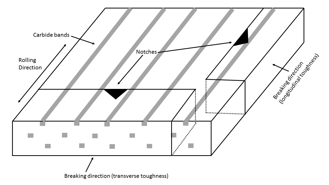

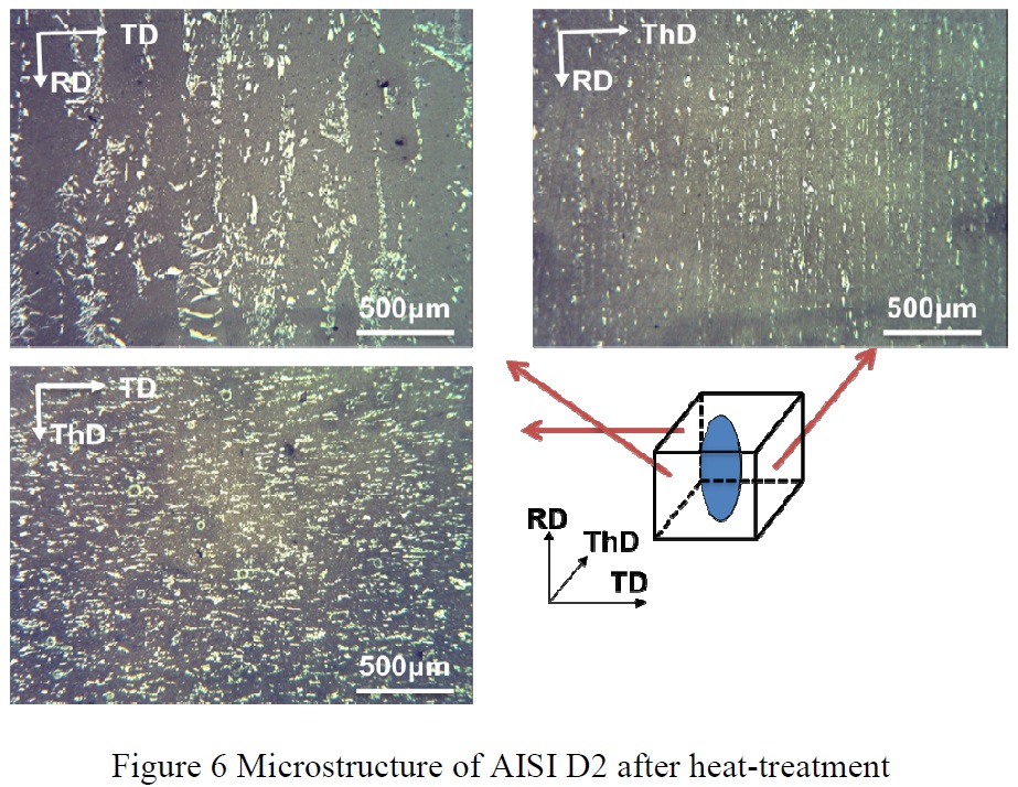

Importance of Orientation

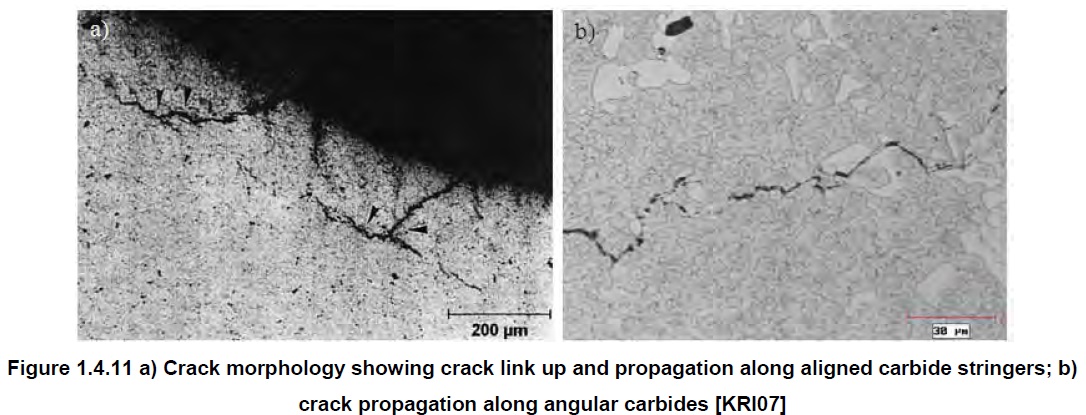

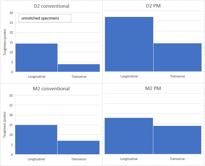

Steel is typically rolled to the final thickness, and carbides and impurities are oriented along the rolling direction. This leads to segregation of carbides in “stringers” that can be preferential bands for crack formation [15]:
“RD” is the rolling direction, “TD” is the transverse direction (perpendicular to the rolling direction), and ThD is the thickness direction. With the aligned segregated carbides, it matters which orientation a toughness test is performed:
With the transverse toughness specimen the notch and the breaking direction are aligned with the segregated carbide bands. Therefore the crack can grow along those bands of carbides and the toughness with transverse specimens is lower when compared with longitudinal specimens. Powder metallurgy helps to reduce carbide segregation and therefore improve transverse toughness but has a smaller effect on longitudinal toughness [16]:
The direction of loading of edges has been found to have an effect on their fracture. Generally knives are oriented along the rolling direction so that the carbide bands are parallel to the edge:
Therefore side loading requires less stress to fracture the edges and chipping can occur along the carbide bands [15]:
If the knives are oriented along the transverse direction instead, then the tips of the blades would fail more easily in a similar fashion:

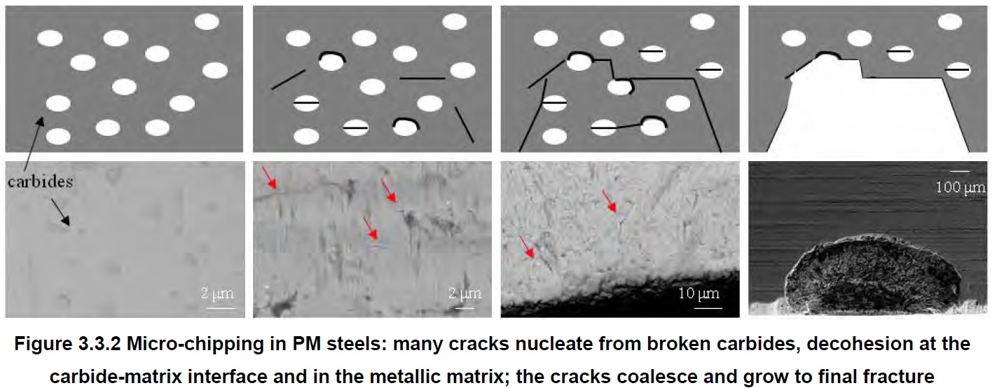

Micro-chipping of edges does not require the stress to reach the level of catastrophic growth of cracks, but can occur through the initiation and growth of small cracks that link up and lead to fracture. Micrographs illustrating this can be seen here [7]:
This is exacerbated by the segregated carbide bands that are aligned along the rolling direction, which is what helps drive the crack propagation and linking parallel to the edge. While powder metallurgy steels have a lower degree of banding and segregated carbides, the short propagation of cracks can still occur, linking up the cracks to form a micro-chip [7]:
Micro-chipping is on a “micro” scale meaning that the chips are often not visible to the naked eye but require magnification. Therefore, micro-chipping is usually perceived as a loss of sharpness rather than obviously visible chipping. The short growth and linking up of carbides occurs through crack initiation at carbides and then growth through low-cycle fatigue.

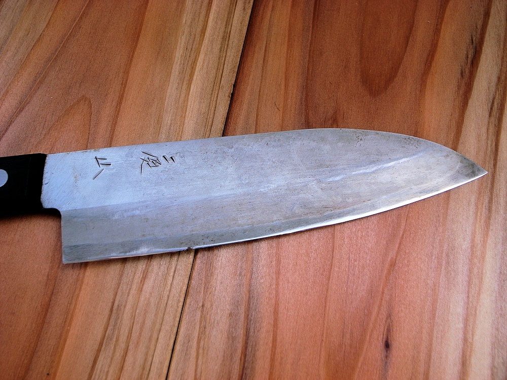

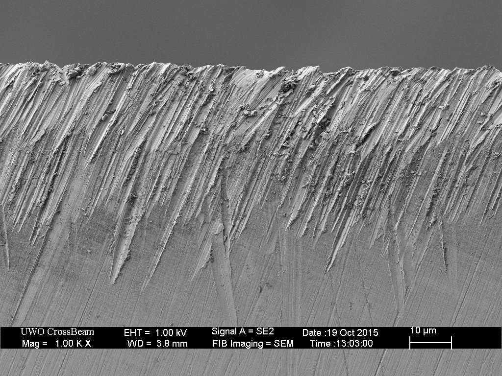

Conclusions and Micro-chipped Knife Edge

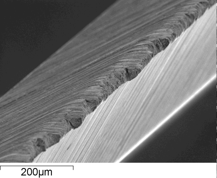

In 2007 Sandvik metallurgists sent me micrographs of several steels along with images of various damaged edges to demonstrate failure mechanisms of knives. They have low-res versions on their site [18]. I think it’s a good idea to analyze these to see if the mechanisms discussed in the rest of this article line up with our observations:
First of all I think it’s clear that there are scratches in the edge from sharpening which as described earlier can act as preferential sites for crack initiation. In the second image as marked with arrows you can see the cracks that formed parallel to the edge as shown in this article. And the chips themselves are longer than they are tall perhaps indicating that the cracks formed by cracks linking up along the rolling direction. Therefore I would say that mechanisms of micro-chipping and chipping are all aligning along similar lines from multiple sources. Chipping is controlled by steel toughness though there are different mechanisms in play. Micro-chipping is more controlled by low-cycle fatigue and linking up of cracks that form along carbides. Chipping is on a more macro scale and the stress must reach the fracture toughness of the steel. Larger carbides, a greater volume of carbides, and segregation of carbides all increase susceptibility to chipping. Hardness, grain size, and retained austenite all affect toughness and therefore the crack formation, propagation, and chipping and micro-chipping in addition to the carbides.

    1. Dear Larrin,
      I am looking at the chart fracture toughness vs hardness. Each curve (5, 10 and 13% carbide) are going toward lower K1C when HRc increases. This can only go with the size and distribution of carbides as percentage is constant. There should be fine (and plenty of it) particles on one side (the hard side?) vs a few big chunks of carbides. But if fine particles are on the hard side, it should mean higher K1C.
      I cannot give it any sense. Are we talking about primary and secondary carbides together? Please help

  5. As a side note, the two micrographs at 100 and 200 micro m seem to show burred edges.
    During the sharpening process, for the edge angle to decrease near the edge, the edge has to be deformed, probably back and forth through stropping or honing, which might weaken the edge.
    Just saying these might be micrographs of freashly sharpened blades, not even damaged through use.
      1. They reminded of me of some these (less dramatic) burr micrographs: https://scienceofsharp.com/2015/01/11/what-is-a-burr/
        I thought it was interesting since you were describing the crack initiation from the honing scratches and I was wondering if the honing process might have also played another role through edge fatigue. I might very well be wrong!
