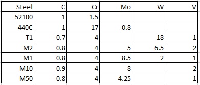

It is impossible to understand 154CM without some knowledge of the history of bearing steels [1][2][3][4][5]. 52100 was the standard from the early 1900’s; in a classic 1949 textbook on bearings, the only steel discussed is 52100. A couple carburizing grades were used for certain applications and 440C was used when corrosion resistance was required. The invention of the gas turbine engine, however, led to the development of many new steel grades after World War II.
With the higher loads, speeds, and temperatures required, alternative materials were explored for bearings, as 52100 was not usable above about 350°F. High speed steels, however, with their “hot hardness” can be used at higher speeds and higher temperatures. In Britain they began using T1, the commonly used tungsten-alloyed high speed steel (see The History of the First Tool Steel). There was also some use of M2 which has a combination of tungsten and molybdenum for hot hardness. In America because of the fear of a tungsten shortage, they were exploring molybdenum-only high speed steel options (or at least low tungsten options), and there was some limited use of M1 and M10 high speed steels. By 1954 there was significant research being conducted on Latrobe MV-1, which was given the designation M50, and it quickly became the standard high temperature bearing steel, and continues to be so to this day. A summary of the steels just discussed are shown below:

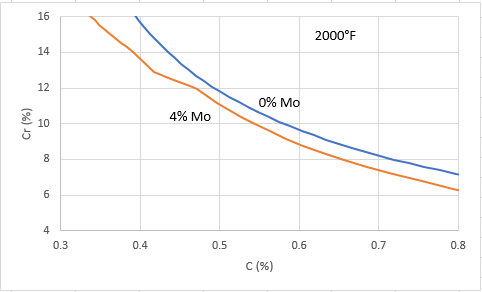

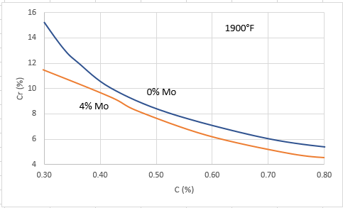

One of the difficulties of designing stainless steels is the balance between hardness and corrosion resistance. For a simplified example, higher carbon leads to higher hardness and higher chromium leads to higher corrosion resistance. However, you can’t simply keep adding both and gain a very high hardness, very corrosion resistant steel. Beyond a certain point the carbon and chromium contributes to carbides instead, which improves wear resistance but has no effect on hardness or corrosion resistance. This was described by Verhoeven in his book originally written for bladesmiths in the section on Stainless Steels [14]. Here are figures calculated using Thermo-Calc for carbon and chromium in austenite (not the “bulk” composition of carbon and chromium):
The lines above show the maximum combinations of carbon and chromium in austenite at high temperature (1900 or 2000°F). It can be seen that increasing the carbon content of the austenite lowers the chromium content, and vice versa. Below or to the left of the lines all carbon and chromium is in solution while above the lines carbides are formed beyond the maximum carbon/chromium content. Therefore to gain higher hardness a drop in corrosion resistance is required becaus the chromium must be lowered. While the 4% Mo addition lowers the C-Cr line, it must also be remembered that Mo improves corrosion resistance. Therefore, a higher carbon content with somewhat lower chromium can be used instead, such as in the following figure:

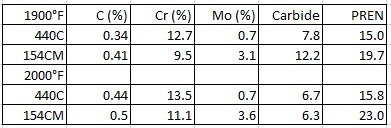

This change in composition to have lower chromium in solution but higher carbon helped lead to higher attainable hardness for 154CM vs 440C. 154CM can also be austenitized at higher temperatures without “overaustenitizing” when compared with 440C, which results in yet higher carbon in austenite and higher hardness. See Austenitizing Part 1 and Part 2 for more information on selection of austenitizing temperatures and overaustenitizing. Here is a comparison between 440C and 154CM showing carbon and chromium in solution along with the carbide volume and PREN number at 1900°F and 2000°F:
154CM therefore has higher hardness than 440C, and a higher PREN number, but lower chromium in solution. Therefore 154CM would be expected to have higher corrosion resistance in salt water and has also been reported to have superior corrosion resistance in HCl and H2SO4 [15].

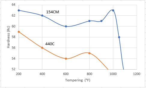

Tempering
A comparison of the tempering curves of 440C (~1875°F) and 154CM (2000°F) from Crucible are shown below [16][17]:
The secondary hardening is much less in the 440C and at a lower temperature (800°F) versus 154CM where its peak reaches 63 Rc at 1000°F, which demonstrates the superior hot hardness of 154CM. This can allow the use of some high temperature processes such as coatings, and also lower susceptibility to overheating during grinding. The high temperature tempering does, however, reduce corrosion resistance because the secondary hardening occurs due to precipitation of chromium and molybdenum carbides [18]. Low temperature tempering is better for high corrosion resistance.

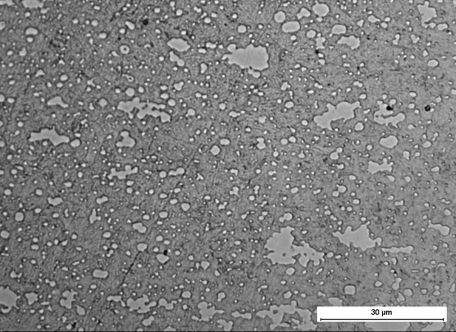

154CM/ATS-34 and 440C are both conventionally cast high carbon stainless steels and have relatively large chromium carbides in the final heat treated state:
440C
154CM
ATS-34
From the micrographs it appears that the carbides are somewhat larger in 154CM than they are in 440C. This corresponds with the higher carbide volume; I determined a carbide volume of 17% for 154CM and 12% for 440C through point counting of the micrographs, which is similar to the values reported by Crucible [16]. The higher carbide volume of 154CM would be expected to lead to lower toughness than 440C but better wear resistance. Below I will discuss what toughness and wear resistance testing has revealed in practice.
