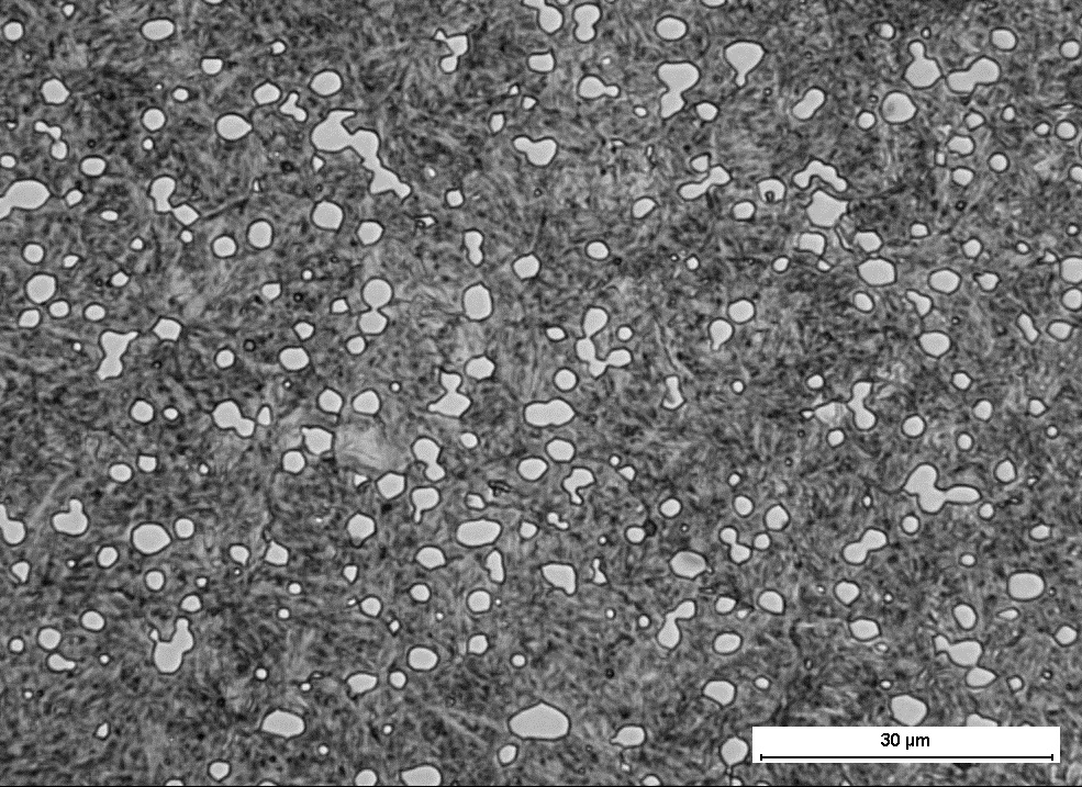

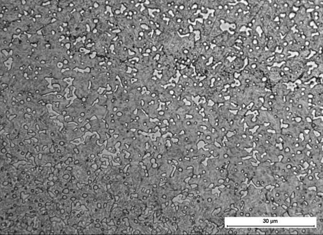

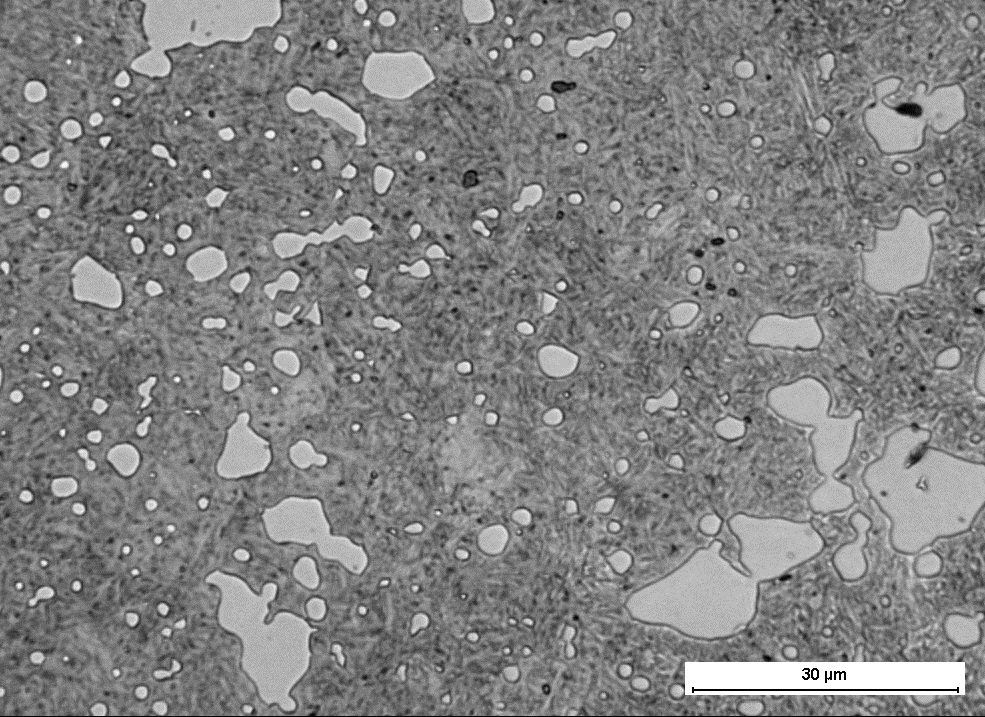

The reason why almost any steel will have relatively low toughness that is designed for very high wear resistance is the large amount of carbide that is present in the microstructure. You can read more about the effect of carbides on toughness in the article I wrote on microchipping and in the summary of edge stability theory. For example, comparing AEB-L/13C26 to 154CM, CPM-154, and S30V, you can see a stark difference in carbide volume (grey particles):
13C26
154CM
CPM-154
S30V
You can see that while the powder metallurgy process greatly reduces the size of the carbides in 154CM, it does not affect the amount of carbide. While smaller carbides do help with limiting crack initiation, toughness is still reduced by having a large volume of carbide. That can be seen with charts from both Uddeholm [11] and Crucible [12]. The Uddeholm chart shows three different carbide contents along with the change in toughness with hardness; the three steels are Vanadis 4 Extra, Vanadis 8, and Vanadis 60. The Crucible chart shows the change in toughness from carbide volume when each steel is heat treated to approximately 60 Rc.

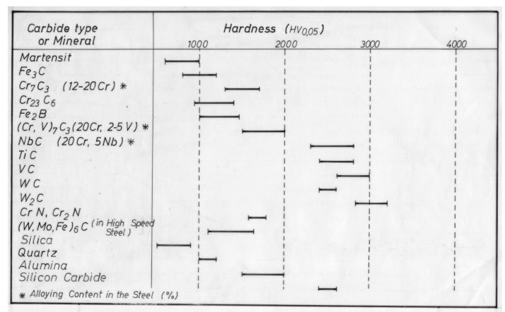

Steels like 3V and Vanadis 4 Extra get their combination of wear resistance and toughness by having a relatively small volume of carbide (<10%) but having all of those carbides be the very hard vanadium carbide. However, the majority of the current “super steels” have much more carbide than that, as summarized in the following table [13][14][15][16][17]:
This effect of high carbide content on toughness cannot be overcome with powder metallurgy, as shown in the charts by Crucible and Uddeholm, which show both conventional and powder metallurgy steels. This means that many of these “super steels” have inherently low toughness and therefore have difficulty with impact applications or in handling high stresses in thin edges. While a steel with a small volume of carbide can also have poor toughness, carbide volume can be thought of as setting an upper bound for potential toughness of a steel. None of the current “super” stainless steels have less than 10% carbide volume, and most are 15% and up. I would like to see one of the major steel companies develop a lower carbide volume powder metallurgy stainless steel so that it is more balanced in terms of toughness and wear resistance rather than focusing primarily on wear resistance.
