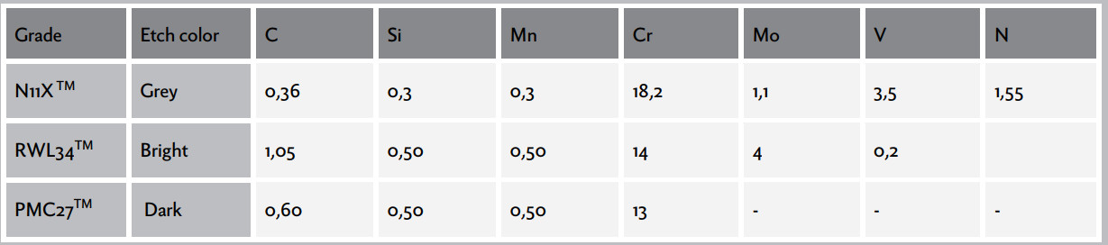

I at first assumed that they would be using Nitrobe77 in some fashion since that is a nitrogen-alloyed steel that they have been selling that as a monosteel for a little while now. However, they use a different name for the core steel: N11X. A different steel produced by Erasteel? A modification of Nitrobe77? The datasheet gives the composition for the core steel as the following:
Is it Vanax?
I thought that the composition of N11X looked remarkably similar to Uddeholm Vanax, and comparison with the Vanax datasheet [2] confirms that it is in fact identical:
Are they using Uddeholm Vanax or is the steel produced by Erasteel (a frequent partner of theirs) under license? I emailed Damasteel and Per Jarbelius sent some interesting information about the development of the steel as well as more history of nitrogen-alloyed steel development in Sweden. He stated, “N11X™ has similar composition to Vanax® SuperClean and is used by the permission of Uddeholm. The Damacore® DC18N™ is an all powder metallurgy made steel.” You can read the full statement from Per at this link here: Damacore Background. He also sent a copy of the PowerPoint presentation given at Blade Show West about the new product which you can see here: Damacore PowerPoint. In his email to me, Per said, “The main thing I want to stress is that the development of the Damacore was first initiated by the knife making community who asked for a high-quality product from Damasteel. The challenge of achieving this was substantial since we wanted to stick to our trademark being all powder metallurgy made. We also wanted to achieve a product that was aesthetically appealing and carrying the recognition of being Damasteel.”

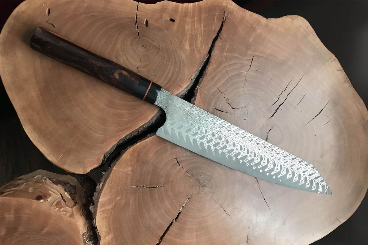

It requires some development work to design a new damascus product, in this case the DC18N which includes not just the N11X core but also the laminated damascus “sides” of the san-mai damascus. They chose to use their standard mix of RWL34 and PMC27 for the damascus part of the san-mai. Selecting steels for damascus and san-mai is not trivial because the steels must be compatible in several ways, including:
  1. Austenitizing (hardening) and tempering temperatures must be similar so that adequate hardness, toughness, and corrosion resistance is achieved for all three steels
  2. The size changes that occur during heat treatment must be sufficiently compatible that splitting does not regularly occur
  3. Good contrast after etching must be possible

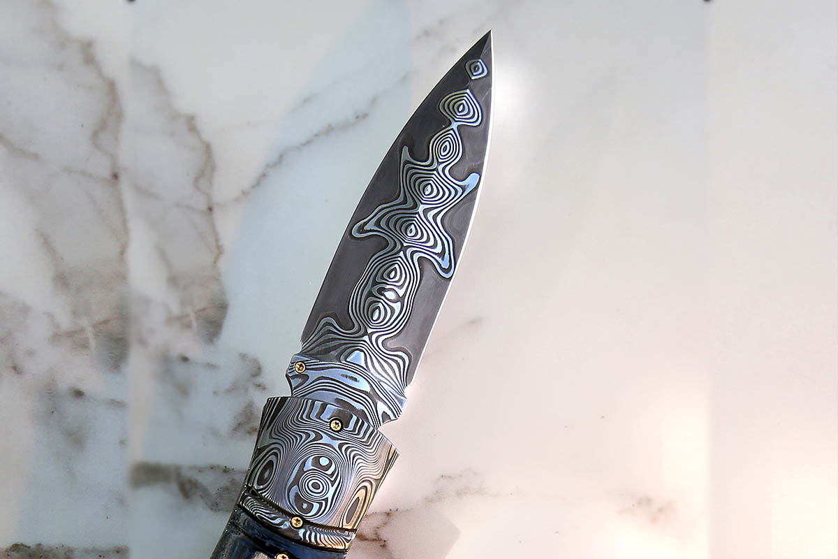

In the PowerPoint presentation on Damacore DC18N it states that a new manufacturing process was developed for “centering the core.” In san-mai damascus keeping the core steel centered and even is difficult and when poorly done it results in uneven pattern distribution in finished blades. In the available photos of knives made with DC18N it does indeed appear that the core steel is well-centered.
Using their standard mix of RWL34 and PMC27 means that they can use steel they already own and are familiar with. It also means that current customers of Damasteel can use the same etching procedure they already use for the standard Damasteel product. The use of the N11X core provides superior slicing edge retention, while retaining similar hardness and toughness. In other ways the choice of RWL34/PMC27 is odd. For one thing, a major benefit of using nitrogen-alloyed steel is the superior corrosion resistance. However, RWL34 and PMC27 are not known for having particularly great corrosion resistance. Therefore they have laminated a core steel known for its very high corrosion resistance with steels that are more susceptible to corrosion. Meaning that pitting or rusting of the damascus sides may occur if the steel is used in corrosive environments where N11X excels. Perhaps one might argue that people are not generally using knives with expensive Damascus steel in seawater. It would be a little more exciting to see Damasteel use high corrosion resistance steels for the damascus sides or even a mix with all nitrogen-alloyed steels.
