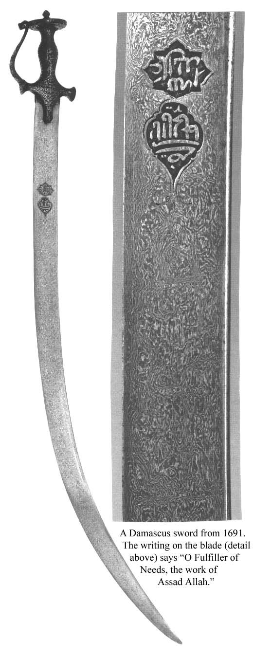

1. Crucible, or Wootz, steel was first produced in India and Central Asia and produced into swords anciently from at least the 3rd century AD [1]. It is made by producing small ingots of high carbon steel that are then forged and thermal cycled in a specific manner to lead to carbide bands that produce the final pattern when the steel is etched [2][3]:

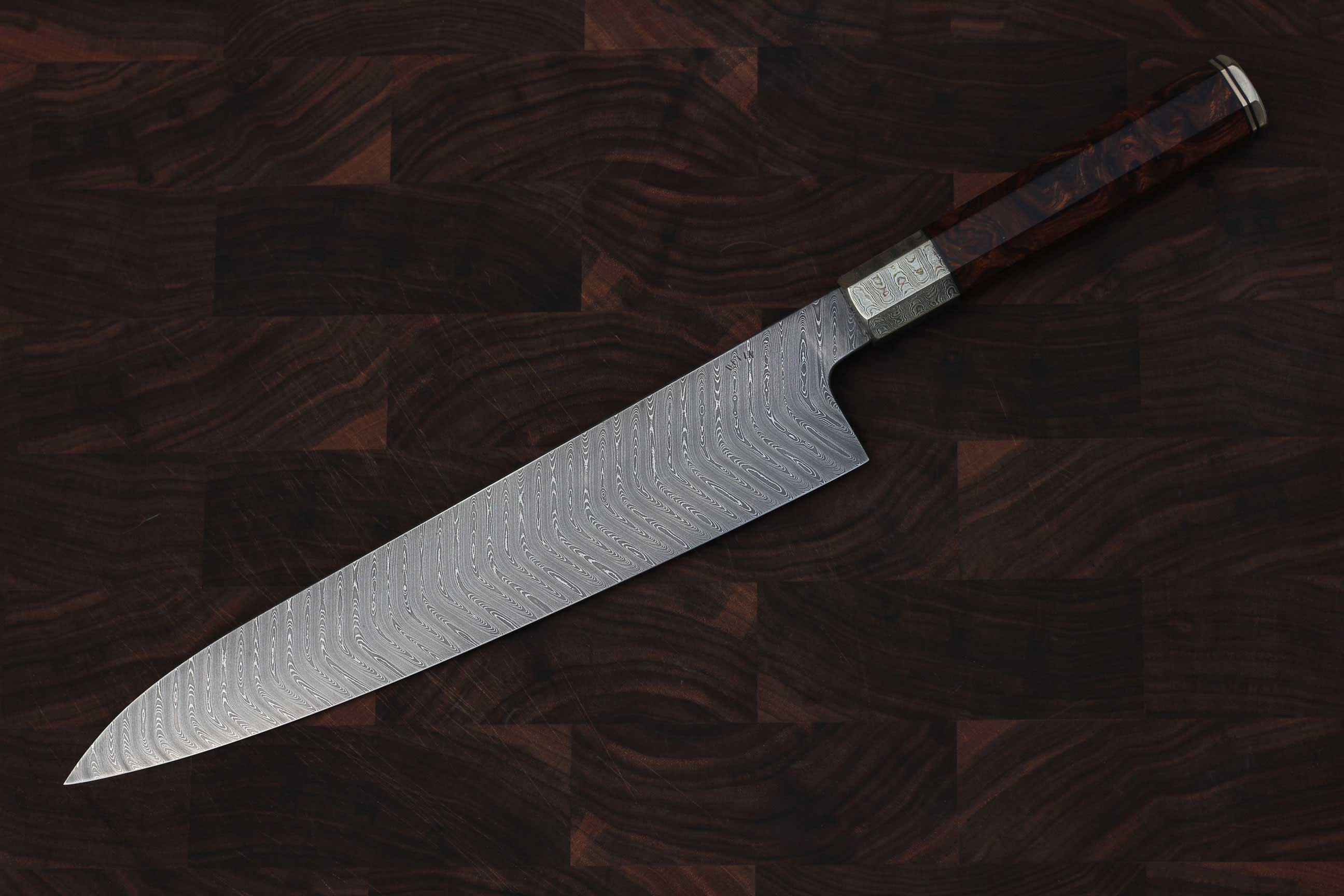

2. Pattern-welded steel is the result of forge welding two or more different steel types together that will etch at different rates and therefore provide contrast in the final product [4]:
Pattern welded steel has also been around for many centuries, from approximately the 2nd century AD [5], produced in swords in Europe in different locations such as Scandinavia. A similar process was also used by Japanese swordsmiths. Pattern welding was also commonly used for the production of gun barrels prior to the 20th century; the process was required so that strips of steel could for formed into a round barrel.

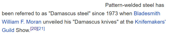

Myth: Bill Moran first named pattern-welded steel “Damascus” steel
This idea is currently summarized on the Wikipedia page for Damascus steel:
However, pattern welded steel has been called Damascus since well before Bill Moran, and from many different sources. Pattern-welded steel has been conflated with crucible Damascus steel at least as early as 1824 [6], as described in this 1837 article on Damascus steel [7]:

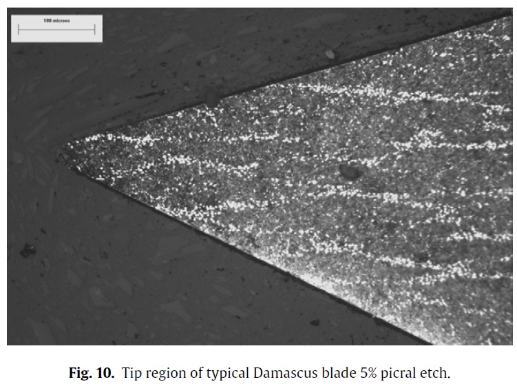

Swords made from crucible Damascus steel were said to have been able to have cut a silk scarf in one stroke [16] due to their superior qualities. Sharpening experiments on Damascus, 1086, and 52100, found that Damascus steel did not take a sharper edge than the other steels, though 60 Rc steel was found to take a better edge than 40 Rc steel [17].
Myth: Damascus steel cuts longer than conventional steel
Similar to the above myth crucible Damascus steel has also been claimed to have superior edge retention to conventional steel. A CATRA edge retention study [18] was performed with Damascus, 1086, and 52100 at 40 Rc and 60 Rc. You can read about the CATRA test here. At 40 Rc the Damascus steel was found to have a slight advantage over 1086 and 52100 but at 60 Rc the situation was reversed. This is somewhat surprising due to the high carbon content of the Damascus (1.6%). Perhaps the aligned carbides do not cross the cutting edge in an appropriate pattern to provide superior edge retention [18]:

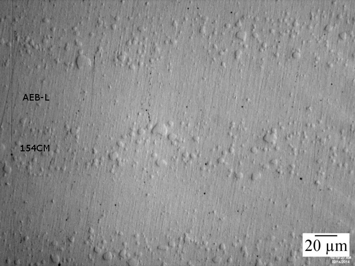

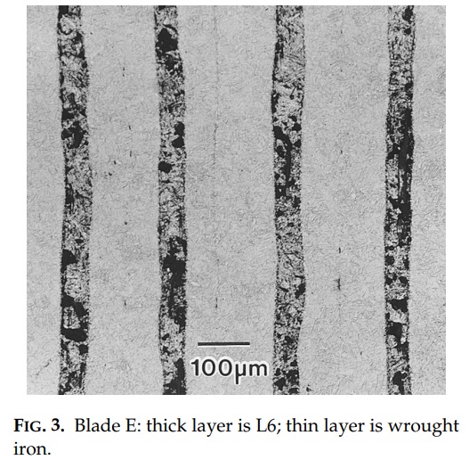

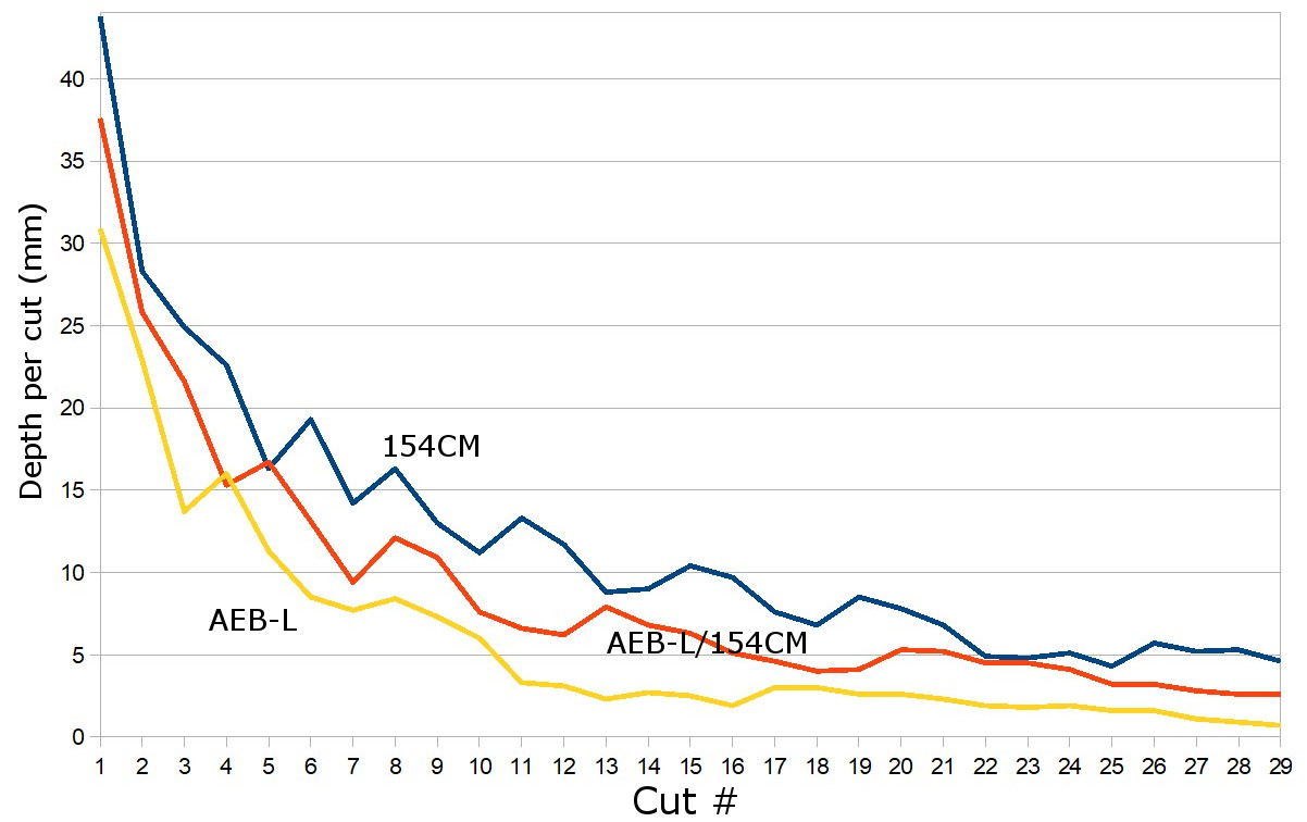

Pattern welded steel has also been claimed to have superior edge retention due to various mechanisms such as the “damascus cutting effect” where it is proposed that one steel type wearing faster than the other leads to micro-serrations [19]. My father and I completed a CATRA study with pattern-welded steel in 2011. We used stainless damascus with a 50:50 mix of AEB-L and 154CM with approximately 200 layers in a ladder pattern to ensure that the two different steels are crossing the edge, and compared that with knives in either AEB-L or 154CM. All three knives had the same design and edge geometry. I have a micrograph of the steel though it isn’t very good due to a non-ideal etchant, but you can see the vast difference in carbide structure between the two steels by comparing the raised particles in the layer marked 154CM vs the layer marked AEB-L:
The large number of carbides in the 154CM makes it much more wear resistant than the AEB-L, and indeed in the CATRA tests 154CM had more than 2x the wear resistance (435 mm vs 190 mm total cardstock cut). When the two steels are combined it behaves as a composite material; the edge retention is essentially right in between the two monosteels, with 330 mm of cardstock cut.
You can see that the depth of cut was lower for the pattern-welded steel and AEB-L from the very first cut. I believe that is due to there being wear during even the first cut rather than because of a difference in edge geometry or sharpening. However, only one test was performed per steel. In summary, no evidence of improved edge retention was found due to using pattern-welded steel.

You talked about sharpening experiments between “Damascus”, and a couple other types of regular modern steel. Where these experiments undertaken with an original authentic Wootz Damascus blade that was verified to be one of the ones which didn’t merely come out with a pattern, but was actually tougher for the amount of edge retention it displayed?
Or are you talking about doing the experiment with a pattern welded blade? I ask because this is a huge difference.
You should read the cited paper by Professor Verhoeven. Neither he nor myself would confuse Wootz with pattern welded Damascus, of course.
I didn’t imply that you would. I just didn’t see you specify which was used for the testing you described in your article. Based on your response I’m guessing it was wootz but I guess I will have to go dig through your citations to get a clear answer. Thanks for the article.
Also I just watched a documentary about that blade smith who was smelting ore from the mines near Damascus(the place), and they made it seem like some of the blades made back then looked identical and were even probably made by the same smiths, but the process wasn’t 100% and sometimes the blade wouldn’t come out with as good of properties, but by any other measure it was wootz Damascus. So I’m wondering if they actually destroyed the blade after the sharpness testing so they could examine the molecular structure and verify that it wasn’t one of the blades that for all intents and purposes was wootz Damascus, but because the process sometimes didn’t create as good of a ductile/edge retention combo like when it worked perfectly, it didn’t have the properties ascribed to the “mythical Damascus blades”.
Also I looked up citation 17 and did not once see upon skimming any mention of using a legitimate wootz Damascus blade. I definitely could have missed it. Is this the document that citation refers to? https://www.relentlessknives.com/newsletter_files/KnifeShExps.pdf

One really interesting (to me) observation from the AEB-L/154CM damascus micrograph is that the carbide size in the 154CM layers isn’t much smaller than the carbides in your 154CM monosteel micrograph, despite reduction of each layer to around 30 microns thick.
