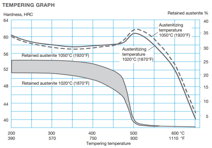

Above is a tempering chart for Caldie steel (0.7C-5.0Cr-2.3Mo) which shows both hardness vs hardening temperature and also retained austenite. You can see that at low tempering temperatures (<400°C) the retained austenite is basically constant. You can also see that the hardness decreases with higher tempering temperatures up to about 350°C and then it increases to a peak at around 520°C (950°F). Therefore tempering in the secondary hardening region above 400°C can lead to both high hardness and also the elimination of retained austenite.

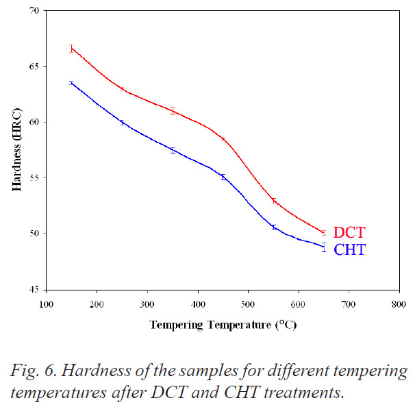

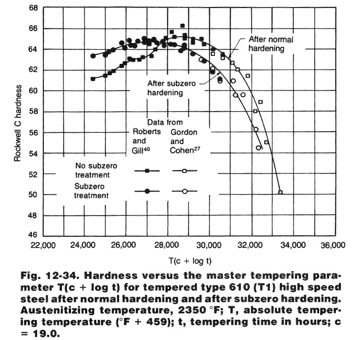

Subzero or cryo processing prior to tempering also shifts the tempering-hardness curve to lower temperatures when using the secondary hardening range of tempering [2]:
This means that in general, a lower tempering temperature is required to achieve the same hardness level with secondary hardening. Using the same tempering temperature as without a subzero treatment will lead to a greater degree of tempering. More tempering can be good or bad depending on the situation. Excessive tempering can lead to coarsening of tempering carbides which can reduce toughness. However, if the tempering was insufficient without subzero, the use of subzero processing may increase toughness due to shifting the “optimal toughness” range.

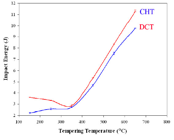

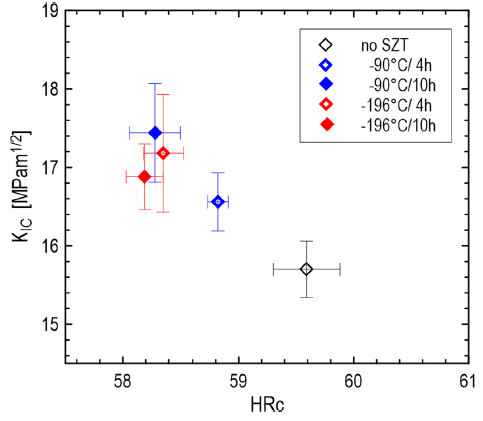

I looked into the three studies that showed an improvement in toughness with cryo. One study on Vanadis 6 [16] found a reduction in hardness after cryo (likely due to the shift in hardness with secondary hardening described above) and after the toughness was plotted vs hardness it is clear that there was no change in toughness after cryo:

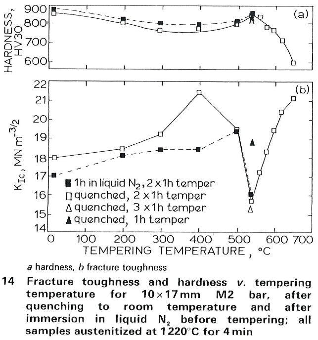

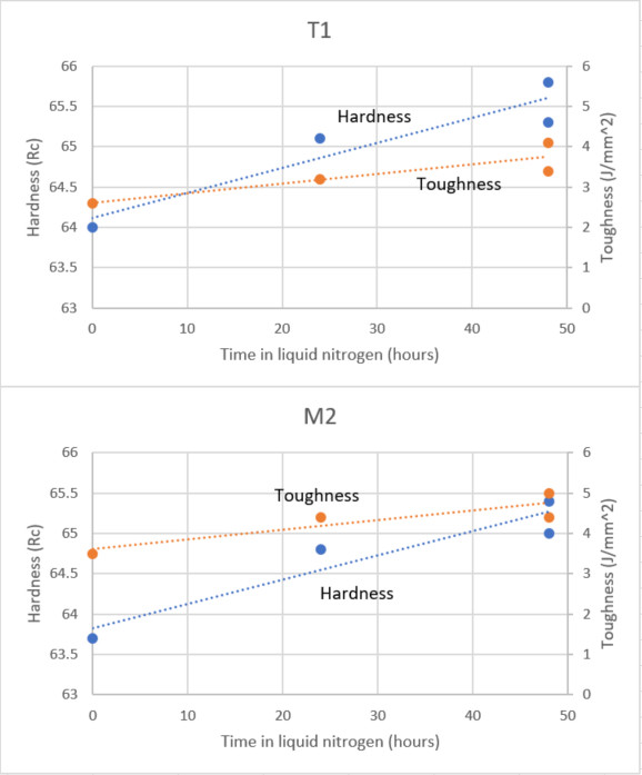

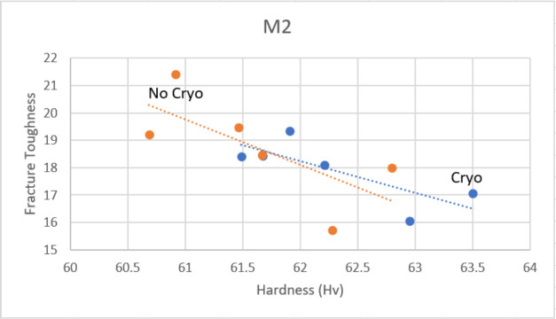

M2 and T1
Another study on M2 and T1, two common high speed steels found both a an increase in hardness and also a small increase in toughness [4]. They also found that performing a 48 hour liquid nitrogen between quenching and tempering had improved toughness and hardness relative to a 12 hour treatment, and that 3 separate cycles totaling 48 hours was even better. This result is somewhat surprising to me and I haven’t seen it replicated. Other studies typically do not claim an increase in hardness with more time at cryogenic temperatures.

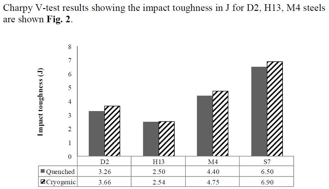

In another study they looked at D2, H13, M4 (non-PM), and S7 tool steels [21] which were heat treated with an upper temper (>400°C), both with and without a 20 hour cryogenic process at liquid nitrogen temperatures. No hardness information was presented but there was a chart giving toughness numbers with very tiny improvements in toughness:
Why Toughness was Increased
One thing that is consistent with all of the above studies is that they all used the upper temperature tempering range. You can read more about this type of tempering in this article. This is significant for a few reasons:
1) Using an upper temper eliminates retained austenite even without cryogenic processing. Therefore comparing cryo vs standard means that there is very little difference in retained austenite.
2) Cryogenic processing shifts the hardness tempering curve to lower temperatures: Effectively, the steel has been tempered to a greater degree by using cryogenic processing. However, when the liquid nitrogen process was effective in also increasing the hardness or maintaining it at a similar level this may lead to a small improvement in toughness.
3) If there is truly no difference in toughness between using cryo and not, then there is some chance that either a small negative or small positive difference is measured when adding a cryo step. This is due to experimental scatter. Positive results are more likely to be published. This is even without considering intentional or unintentional data mining for positive results.

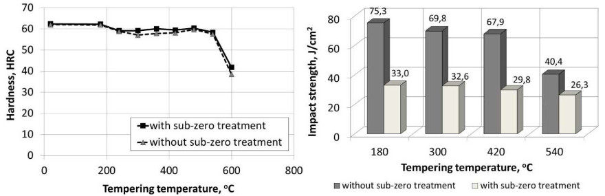

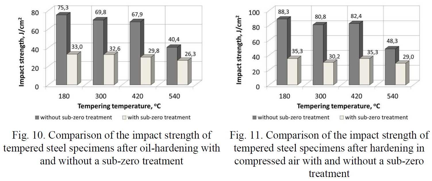

The most commonly reported result of subzero or cryogenic processing of steel was a reduction in toughness [3,5-7,9-10,13,15,17,18,20,22]. Typically the reduction in toughness after cryo or subzero processing is attributed to the transformation of retained austenite. Retained austenite is a ductile phase and therefore can help improve toughness. In an article on the effects of Si additions in steel I showed that part of the improvement in toughness from Si is due to retention of austenite.
Sometimes the change in toughness with cryo and the elimination of retained austenite can be rather drastic, such as this study on Elmax with a dry ice subzero process where the toughness is basically halved (oil quenched on the left, air quenched on the right) [17]:

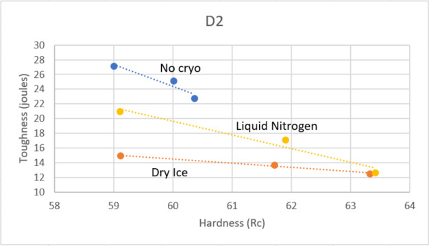

Or this study on D2 where they looked at both subzero (dry ice) and cryo (liquid nitrogen) where the use of liquid nitrogen led to an improvement in toughness relative to dry ice but both had significantly less toughness than the base condition with no subzero [10]. Some studies claim a difference in properties between using subzero and liquid nitrogen separate from retained austenite transformation, which will be covered more in Part 3.

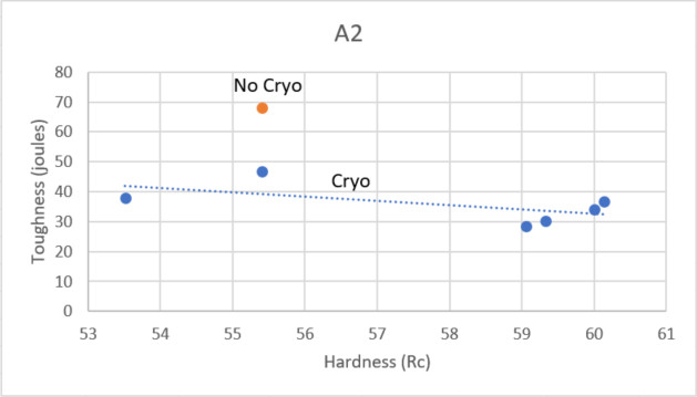

And to round things out another study on A2 tool steel showing a reduction in toughness by using cryo [5]. They tried 0.5 hr and 24 hr liquid nitrogen as well as liquid helium, and all cases led to a reduction in toughness relative to no cryo:

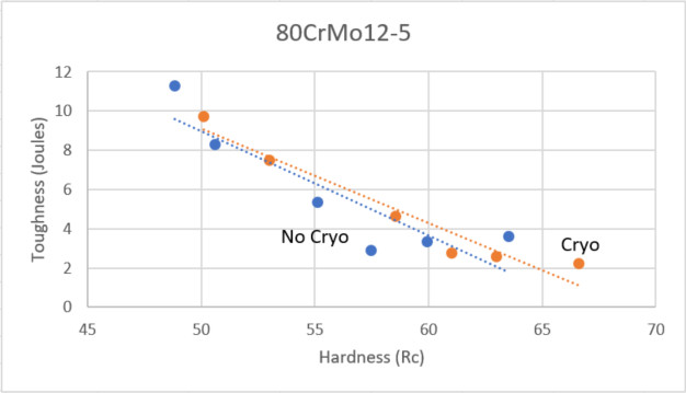

Cryo generally increases hardness which we would expect to lead to a reduction in toughness. Some studies that showed a reduction in toughness with cryo do not show a difference if the toughness is plotted vs hardness. This compensates for the effect of hardness and allows us to compare cryo vs no cryo in a more apples-to-apples fashion. One example is this study with M2 where when plotted vs hardness there is no clear difference in toughness when cryo is used [20]:

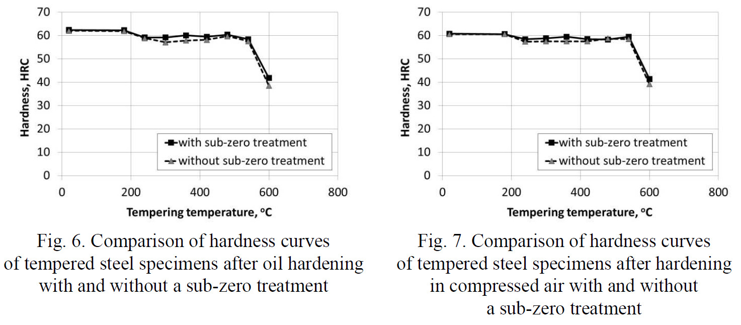

Another example was a tool steel 0.8% C, 3% Cr, and 0.25% Mo (called 80CrMo12-5) where a reduction in toughness was seen with cryo but when compensated for the increase in hardness there is no obvious difference between with cryo and without [13]. DCT refers to the cryo treated material and CHT is the conventional heat treatment. This study used a range of tempering temperatures (150-650°C) but the effect of cryo seems to be consistent across the entire tempering range.

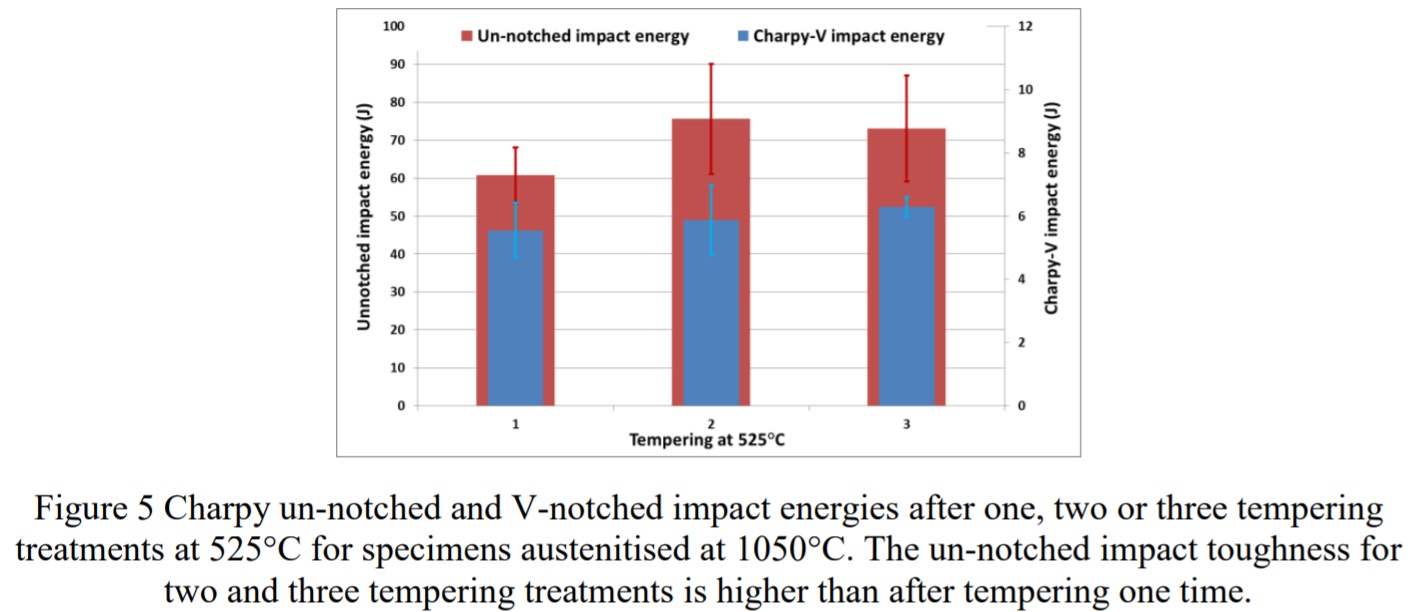

All of the studies where no change in toughness was observed were all with steels given an upper temper [8,11,12,14,19,23], which makes sense for the reasons explained before, that secondary hardening leads to an elimination of retained austenite so there is little or no difference when a cryo step is added.

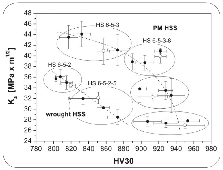

One fairly complete study looked at both conventional and powder metallurgy high speed steels. The powder metallurgy steels had significantly higher toughness than the conventionally produced steels. Within those two categories, hardness was a much stronger factor for toughness than whether cryo was used. The black dots indicate a heat treatment that included a cryo step and the white circles did not use a cryo step [19]:

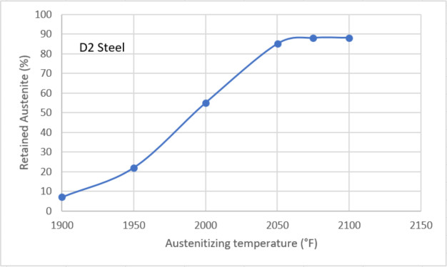

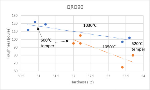

In a study on a steel called QRO90 (0.4C-2.6Cr-2.25Mo-0.9V) they looked at the effect of austenitizing temperature (hardening temperatures of 1030 or 1050°C), tempering temperature (520 or 600°C), with or without a one hour hold at -180°C before tempering. A lower austenitizing temperature led to superior toughness for a given hardness, you can read about why in this article. The higher tempering temperature led to lower hardness and higher toughness. When plotted vs hardness there is no clear difference between the cryo and non-cryo samples, with much more effect of austenitizing or tempering temperature [23]:

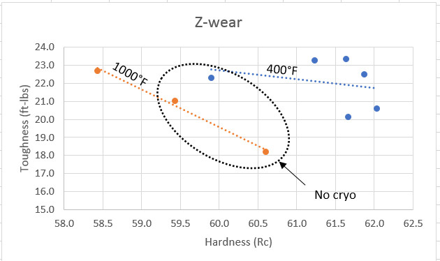

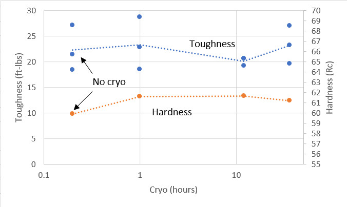

Z-Wear Toughness Study
Along with knifemaker Warren Krywko I did a toughness study on Z-Wear, which is identical to CPM Cru Wear. This study was referenced near the beginning of this article. We looked at a range of heat treatment parameters including the austenitizing/hardening temperature and low vs high temperature tempering (400 vs 1000°F). We also looked at the effect of cryo where we compared no cryo, and 1 hour, 12 hour, and 36 hours in liquid nitrogen. Each included cryo directly after quenching and before tempering. An austenitizing temperature of 1950°F and tempering temperature of 400°F was used. Therefore these heat treatments were not affected by the secondary hardening effects described above. The different times in cryo were tested because of the studies that have indicated that that is an important variable such as the M2 and T1 study cited above. The results obtained were as follows:
There was a clear increase in hardness by adding in a cryo step, and the hardness was essentially flat with increasing cryo time. The toughness is also flat though any small differences are difficult to see due to the inherent scatter of toughness testing. There may be a small reduction in toughness with a 12 hour cryo treatment. Therefore there was an increase in hardness but no corresponding decrease in toughness, for an improvement in the hardness-toughness balance. Other changes to heat treatment led to more clear differences in toughness so this is not a case where the test was not sufficiently precise to show changes in heat treatment. For example, the comparison between 1000°F and 400°F revealed a clear difference:
For the reasons explained above I was surprised that there was no difference in toughness found when using cryo with Z-Wear and a low temperature temper of 400°F. Generally a reduction in retained austenite and increase in hardness with cryo leads to a reduction in toughness. It is encouraging that a cryo treatment does not necessarily reduce toughness even with a low temperature temper though this is not the case with every steel and heat treatment. Perhaps future studies will reveal more.

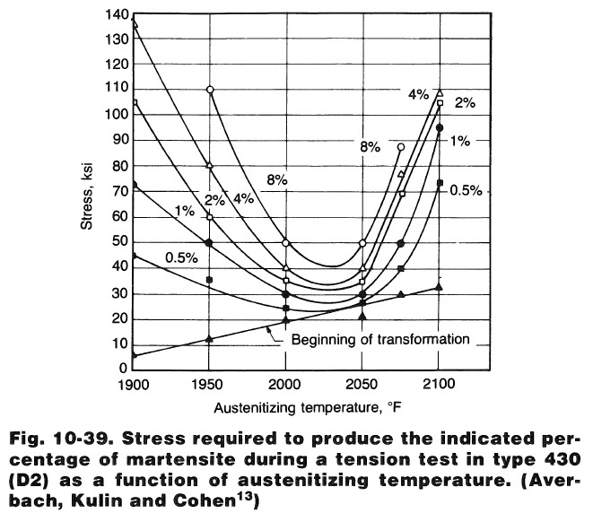

Steels with austenite will transform to martensite when a stress is applied, such as when the steel is bent, pulled, or otherwise deformed. This is known as a strain-induced or stress-induced transformation. This increases the strength of the steel as strong martensite is formed. This martensite is untempered, however, which also decreases the ductility and toughness of the steel after the martensite has formed. Below I have images of a 301 austenitic stainless steel (100% austenite) with increasing percentages of strain (% change in length while pulling a bar of steel) showing the formation of martensite [25]:
Despite having a much smaller amount of austenite, tool steels with retained austenite also see a transformation to martensite when sufficient stress is applied. Cryogenic processing of tool steel is sometimes recommended to avoid the formation of untempered martensite during the life of the tool. A study on D2 steel found that relatively low levels of stress can lead to the transformation of austenite to martensite [26]:
Somewhat surprisingly, the stress required for the start of austenite transformation increased with more austenite. However, the stress required for the 8% transformed retained austenite reached a minimum with 2000-2050°F austenitizing temperatures. Those austenitizing temperatures are too high for typical heat treating of D2, fortunately. Typically a temperature of 1825-1900°F is recommended. Regardless, it is apparent that austenite can transform from induced stress which leads to untempered martensite. It’s hard to mentally visualize the level of stress required to cause the austenite transformation, but the level of stress is well below the strength of the heat treated D2 [2]:

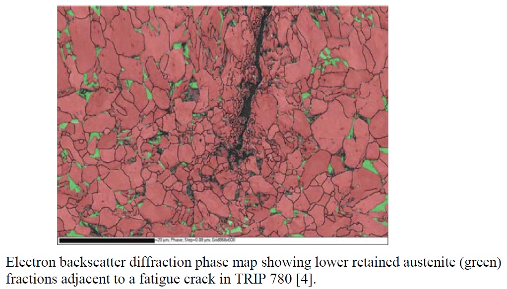

Effect of Retained Austenite on Fatigue

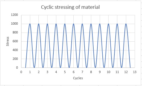

In contrast to the above discussion is low-cycle fatigue testing of steel. This type of testing is described in the article on chipping of steel. In low-cycle fatigue a relatively large stress is applied to steel and then released, and this is repeated until the part fails. The higher the stress the fewer the cycles necessary for the part to break. Similar mechanisms occur with repeated stresses to knife edges leading to micro-chipping.
It has been found that the transformation of retained austenite to untempered martensite can actually slow down crack growth during this fatigue testing. Martensite is a larger phase than austenite and the volume change “pushes” the crack back together. You can see this in the image below where austenite is green and transforms to black martensite around the crack where the material was stressed [28]:
Retained Austenite and Untempered Martensite Summary
The transformation of retained austenite to untempered martensite is generally considered to be a bad thing because of the brittle nature of untempered martensite which reduces ductility and toughness. Fatigue testing shows benefits of retained austenite transformation. In fatigue testing the benefits were seen when there is a crack present already (crack growth) so this improvement is not present in every scenario.
