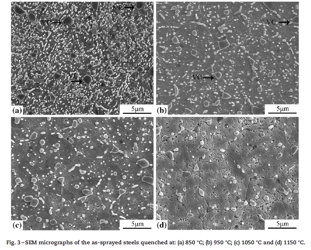

As covered in Part 1, carbide volume decreases with increasing temperature. As an example, here are micrographs showing carbides in a spray-form version of the original Vanadis 4 (non-Extra) [1]:
Vanadis 4 austenitizing
This steel is a good representation of what can occur with more complicated steels versus our simple low-alloy steels illustrated in Part 1. In this case we have two major carbide types: vanadium carbides and chromium carbides . The MC carbides are larger in part because they form at a higher temperature during solidification. Thermodynamically the vanadium carbides are more stable, they form at higher temperatures and they also dissolve at higher temperatures when austenitizing. So at the lowest austenitizing temperature of 850°C, many small chromium carbides are present after quenching, with some of the somewhat larger vanadium carbides as well. With an austenitizing temperature of 1150°C, those vanadium carbides are mostly unchanged but there very few chromium carbides remaining. This is confirmed by thermodynamic calculations for this composition:
Austenitizing Cr carbides V carbides
850°C 8.5% 8.3%
950°C 5.2% 8.3%
1050°C 2.7% 8.2%
1150°C 0.0% 7.8%
All of this is important because we know that carbide size and volume greatly affect toughness, as I summarized in a previous forum post [2].

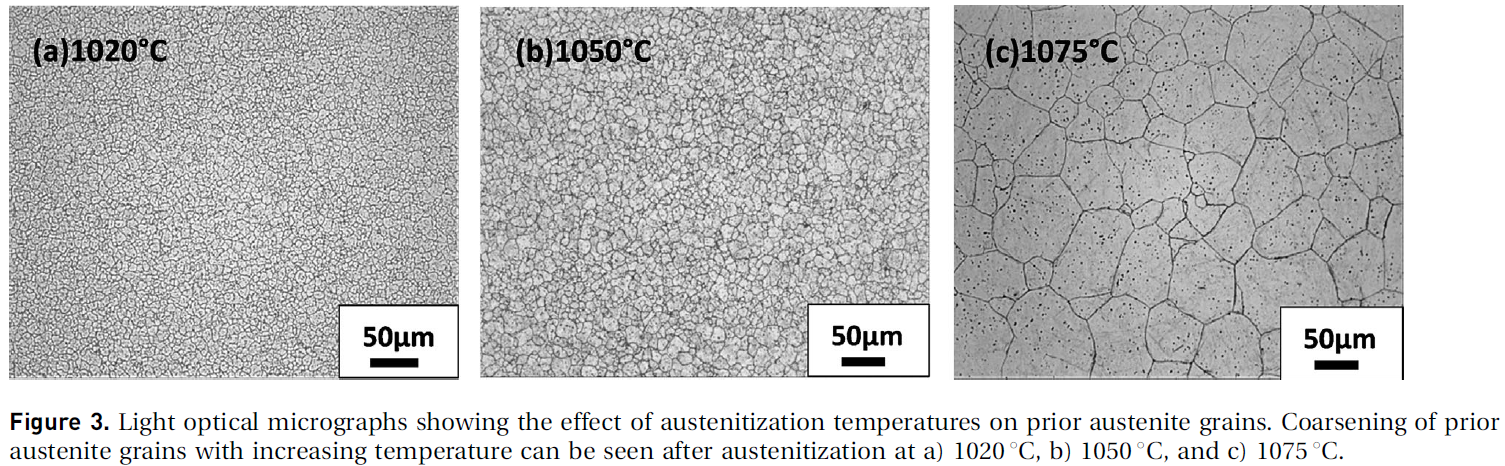

Another important factor we covered in Part 1 was grain size. Here are images of the prior austenite grain size in Uddeholm Caldie with increasing austenitizing temperature [3]:
Caldie grain size
Here there is a pretty dramatic difference in grain size with austenitizing temperature, though the 1075°C austenitizing temperature is above what is recommended by the Caldie datasheet [4].

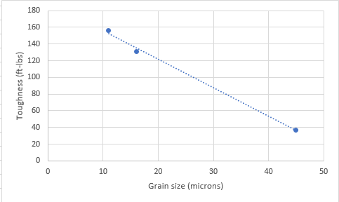

That change in grain size had an obvious impact on toughness. After tempering at 200°C, the hardness between all three was similar but the toughness was quite different:
Austenitizing Retained austenite (%) Grain size (microns) Hardness (Rc) Toughness (ft-lbs)
1020°C 19 11 60.3 156
1050°C 23 16 60 131
1075°C 28 45 59.7 37
Or I put together this chart to illustrate the effect of grain size a little more clearly:

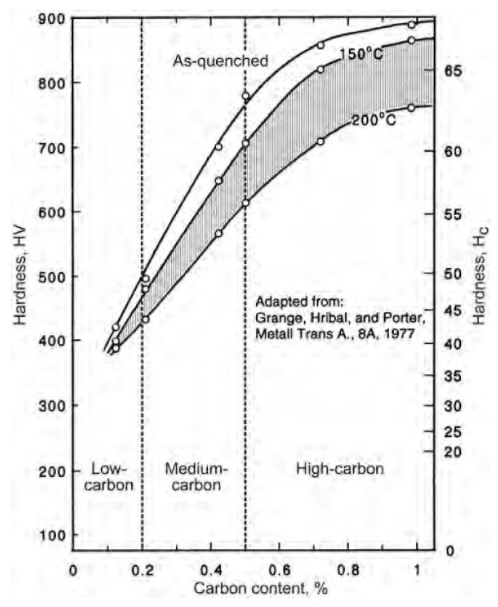

Carbon Content in Martensite
As the carbon content increases with higher austenitizing temperature, that also increases the carbon content of the final martensite, which is why higher austenitizing temperatures lead to higher hardness [5]:
carbon vs hardness

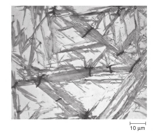

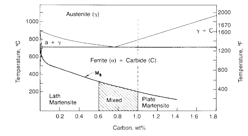

The amount of carbon in martensite also changes the type of martensite that forms; there is a transition from “lath” martensite to “plate” martensite [6]:
lath and plate martensite
This transition from lath to plate martensite is important because plate martensite has poorer ductility, in part due to the formation of microcracks during the transformation of martensite [7]:
microcracks in plate martensite

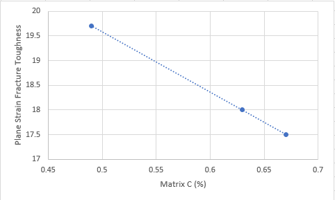

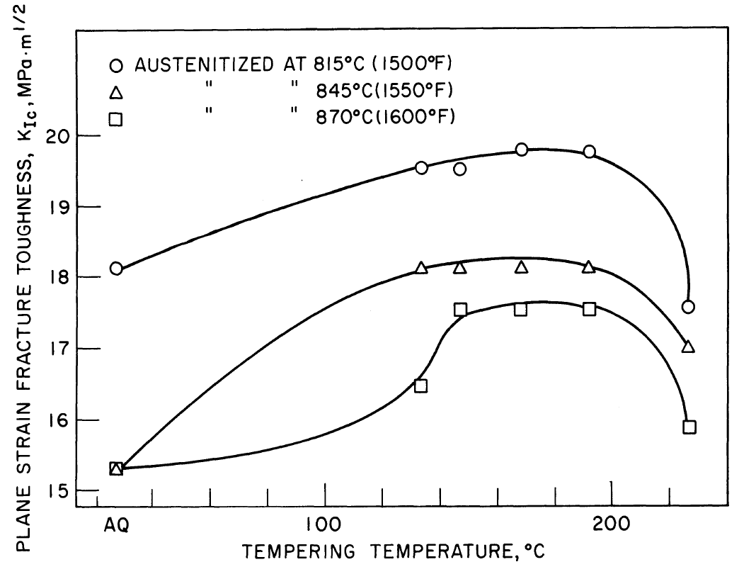

Higher carbon martensite has poorer toughness than lower carbon martensite, even when tempered down to the same hardness. Here is an example from a study on 52100, where an increase in austenitizing temperature led to a reduction in toughness even when the grain size and hardness were found to be the same [8]:
Austenitizing Matrix C Carbide volume Grain size RA @ 150°C RA @ 230°C
1500°F 0.49% 8% 16 microns 8 0
1550°F 0.63% 6% 16 microns 15 0
1600°F 0.67% 5% 16 microns 17 0
Austenitizing As-quenched 135°C 150°C 170°C 195°C 230°C
1500°F 63 63 62 61 60.5 60
1550°F 64.5 64 63 62 61 60
1600°F 65 64 64 62.5 61.5 61
52100 toughness
Most of the factors are constant between the three selected austenitizing temperatures except for carbon in solution, which is what the authors proposed was the cause for the differences in toughness. When I plotted carbon vs toughness for the 170°C tempering temperature, I got a very convincing trend:

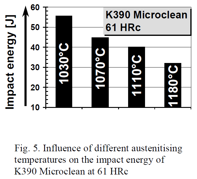

Grain size is refined and carbon in solution is reduced by using the lower austenitizing temperature range; however, carbide volume is reduced by using higher austenitizing temperatures. How do those factors interact? In general, the effect of carbide volume is less than the effect of grain size and carbon in solution. Perhaps this is due to the largest carbides still being present with high austenitizing temperatures as was shown in the Vanadis 4 images. Therefore, a lower austenitizing temperature usually leads to superior toughness, as can be seen with K390 that was all tempered to the same hardness [9]:
K390 toughness
This is assuming the tempering temperature selected is sufficient, of course, but tempering is not the focus of this article. But in general it is better to set the final hardness with the austenitizing temperature than with tempering.

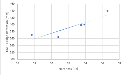

How does the selection of austenitizing temperature affect edge retention? Does using a lower austenitizing temperature for greater carbide volume lead to superior wear resistance? There was a study conducted using CPM-M4 with CATRA edge retention testing where they compared different heat treatment parameters [10]:
Austenitizing Tempering Hardness Carbide volume CATRA
2000 925 63.5 17.4 399
2000 1125 57.7 17.3 371
2100 1025 63.9 19.6 401
2200 925 66.6 14.7 440
2200 1125 60.8 14.2 365
If we plot hardness vs CATRA result we get a very good correlation:
CPM-M4 catra test
However austenitizing temperature or carbide volume does not appear to correlate with CATRA. Therefore, for a given steel hardness is the most important factor for edge retention.

    But something caught my eye and left me with a lot of questions. It’s a bit off topic, but still: In the 52100 study you quoted [8], there is a sharp drop off in toughness at 230°C tempering, after a relatively stable plateau for 135°C-195°C. I can’t tell if this is because of the retained austenite vanishing (there are only 2 data points for RA in your article – are there more in the quoted study?). Or is it already tempered martensite embrittlement? Or are these 2 phenomena inextricably linked anyway?
    And the practical question is: how do you temper for getting a sweet spot of hardness and “usable” toughness? I guess I’m keeping my eye out for the future tempering article(s) discussing toughness.
    Thanks again for the incredibly informative article.
    1. You can read the thesis here: https://dspace.mit.edu/bitstream/handle/1721.1/70610/07354787-MIT.pdf?sequence=2
      You are correct that tempered martensite embrittlement occurs from both retain austenite transformation and also cementite precipitation and it can be difficult to separate them without cryo testing. In the thesis they attribute the loss of toughness to loss of retained austenite but say that it is puzzling.
      Hopefully I can write more tempering articles soon. There is a long list.
      1. Thanks for the link. 200 delicious pages of PhD thesis…
        Found the data I was looking for. And yes, at first glance the retained austenite is relatively stable up until 195°C, and vanishes at 230°C. Good correlation.
        But then I would expect the samples with the most RA to also loose the most toughness. and… it is not the case! The 815°C austenitized sample lost the most toughness, while having by far the least RA.
        So the phenomenon seems to be a bit more complicated then just some extra toughness linearly dependent to the amount of RA.
        Anyway, thanks again!

    In the first picture, about the carbide volume, i noticed a lot of voids in the matrix. It might be related to the spray technology, but made me wonder if in general when big carbides dissolve they might leave voids in the matrix (if we don’t forge).
    Maybe the polishing technique might not always show this in the micrography of the samples?
    Do you know if the matrix is able to “fill” the spaces formerly occupied by the carbides? We usually don’t bother too much because we assume that omogeneization would take care of carbide size and distribution, but might we be missing something? We are concerned about microcracks in plate martensite, but if we start with big carbides we might end with micro voids acting as crack initiation sites, or am i out of track?
