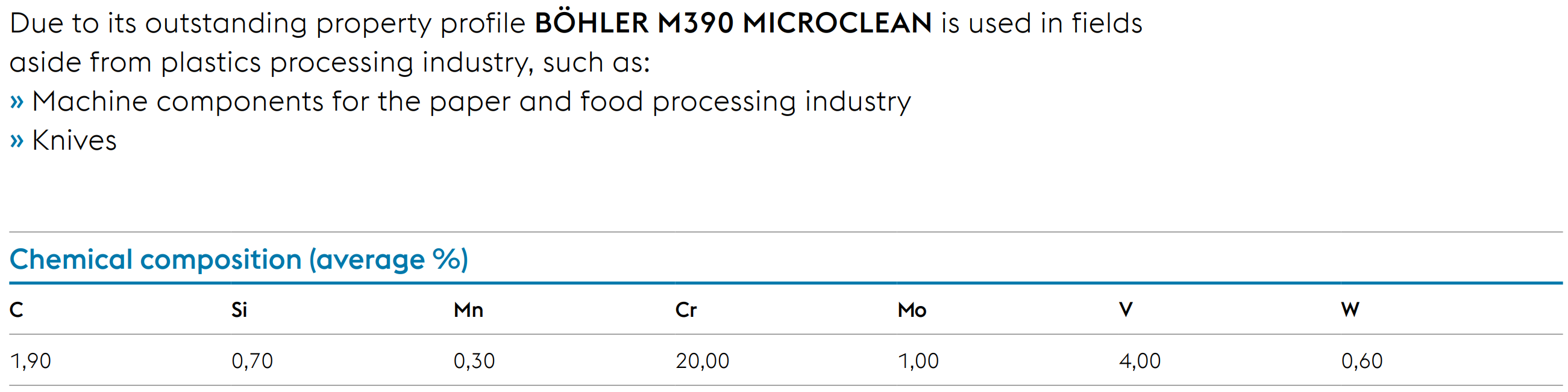

I find that reading or listening to marketing material can be misleading on the actual properties of steels so first let us analyze what they said about the composition of the steel. Helms said that the difference betrween M390MK and M390 was “Just…carbon content” and in the other statement he said that it was “higher” carbon. He also said that the carbon was “more regulated and controlled.” So we should discuss why the carbon content would need to be “regulated” or “controlled” in the first place. When you look up the datasheet for a steel and read off the composition you will see a single number for each element, such as the following for M390 [4]:
You’ll notice that above the composition chart for M390 here (not M390MK), it does clarify that this is the “average” composition. For a steel with a standard specification, such as D2, there is a required composition range for each element. So even though D2 might have an average composition of 1.5% carbon and 12% chromium, there are allowable ranges, for D2 they are 1.4-1.6% carbon and 11-13% chromium. In addition to these ranges which are required by the official specification, steel companies also have internal specifications. So perhaps the company might determine they can have a tighter range for D2 and so their carbon range is 1.5-1.6% instead. For a proprietary steel, however, the ranges are set only by the steel company internally. These ranges are usually not public, though they may be listed on composition certification sheets in some cases. It is not possible to have every heat of M390 be exactly 1.9% carbon, 20% chromium, etc. so there is a range that the company will shoot for like 1.85-1.95% carbon and 19.5-20.5%, though I do not know what the actual values are. The range they shoot for will be based partly on what the steel company can achieve on a regular basis as they obviously don’t want to be scrapping steel all the time. In some cases minimums or maximums may be set because they know the steel will not achieve the desired properties if it falls out of a certain range. Oftentimes multiple measurements of the steel composition are taken from the molten steel while they are making additions, so if a measurement comes back low then they will continue to add more until they get into their desired range. While trying to avoid overshooting, of course. As a further complication, the composition of a steel will not be perfectly consistent throughout and steel that is in the top, bottom, sides, or center of an ingot may be slightly different than a measurement at another location, for example.

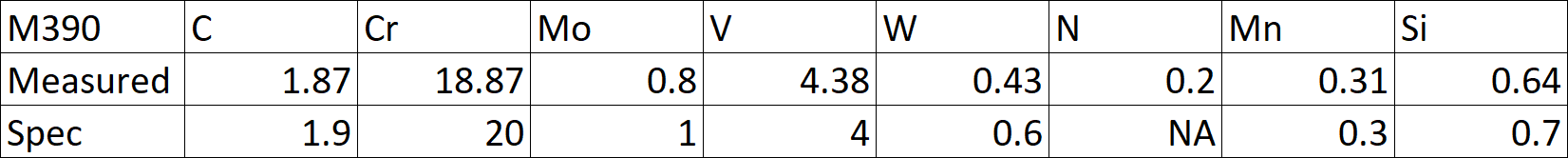

So when Helms mentioned that the steel would have a more controlled and higher carbon content, that presumably means that the range they are asking for is tighter than the previous internal range by Böhler, and also the average is higher. Based on the statements it is not clear if the actual upper end has been raised or only if a narrower range is aimed for in the upper end. So if the internal carbon range were 1.85-1.95%, for example, they could be targeting 1.9-1.95% instead, or if the upper limit were increased it could be 1.9-1.98% instead. These are only possibilities, as they have not told us what the actual numbers are. I was considering purchasing one of the M390MK knives to measure the composition directly, but due to the change being described as a “tweak,” along with the statistical nature of composition variation, measuring the composition may very well lead to misleading information about the actual composition. For example, I could have a knife with steel that is on the upper end or lower end of a certain element like chromium and therefore cause me to think that the chromium has changed when in fact it has not. Or the equipment I use may have a slightly different calibration than Böhler’s, again leading to a misunderstanding on what has changed. So I think taking the statements from Microtech that the difference is a small change in carbon makes more sense than trying to measure the change. For example, a few years ago I measured the composition of some M390 using a standard technique called Optical Emission Spectroscopy (OES) along with a combustion measurement for carbon and nitrogen. For the composition I measured I got a relatively low value for chromium (<19%), but this could very well be a calibration issue or a relatively low chromium heat (or both). But if this had been a measurement of M390MK I might think that they had reduced the chromium when in fact they had not done so.
A measured composition of typical M390 from a few years ago.

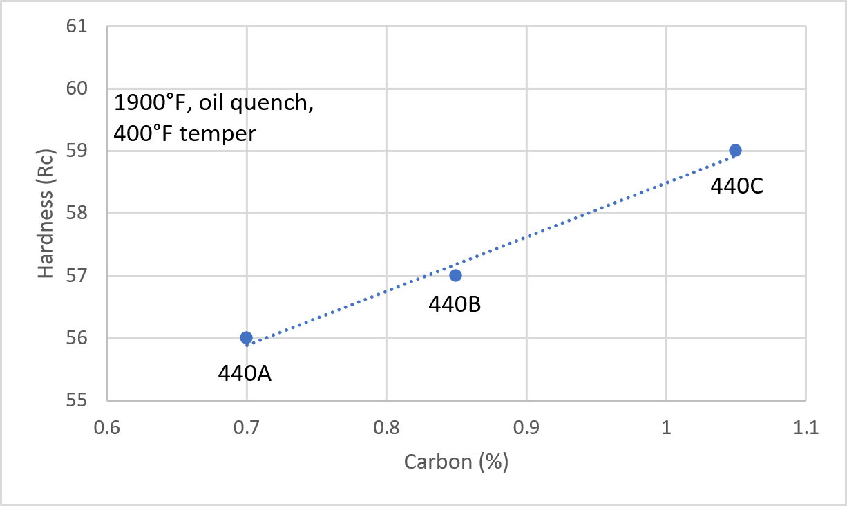

How Does Increased Carbon Affect Properties?

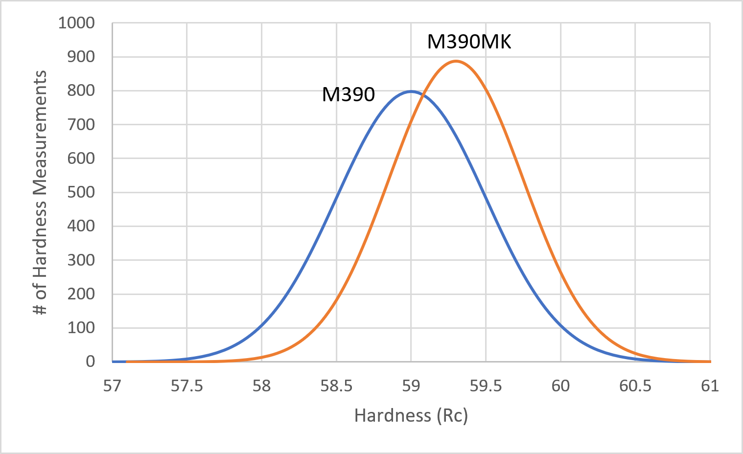

The basic changes from higher carbon include an increase in hardness and wear resistance and a decrease in corrosion resistance. If the carbon is only being changed by a small amount, a “tweak” as Marfione said, we would expect the difference to be relatively minor. A “statistical” difference, perhaps, though there very well could be M390 heats of steel out there already with the same or at least extremely similar properties. If we imagine a bell curve of heat treating response, for example, the “tweaked” version hardness distribution would be bumped up by some small amount, likely less than 1Rc, or even 0.5 Rc. And the distribution would be slightly “tighter” due to the smaller distribution of carbon. Below shows a hypothetical example of how they might end up:
Hypothetical change in hardness distribution of heat treated knives by using M390MK instead of M390 (not based on any experimental data).
As the change in carbon is reported to be relatively small, I don’t expect the actual change in measured hardness, corrosion resistance, or wear resistance to be particularly large. It might even be difficult to measure without testing a large number of specimens to get some kind of bell curve such as the hypothetical one shown above. But this effect of carbon in stainless steels is well understood. Such as 440A, 440B, and 440C, which all have the same composition except they have different carbon contents. Each has ~17% chromium and an optional Mo addition along with 0.7% carbon (440A), 0.85% carbon (440B), or 1.05% carbon (440C). From what Microtech has told us I think the carbon change in M390MK is smaller than this example, but it is well known that using 440C gives you higher hardness than 440A at the cost of some corrosion resistance and toughness.
Hardness from Carpenter datasheets
