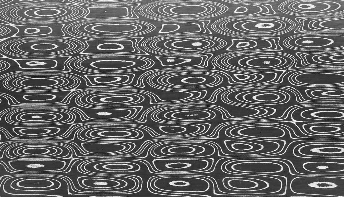

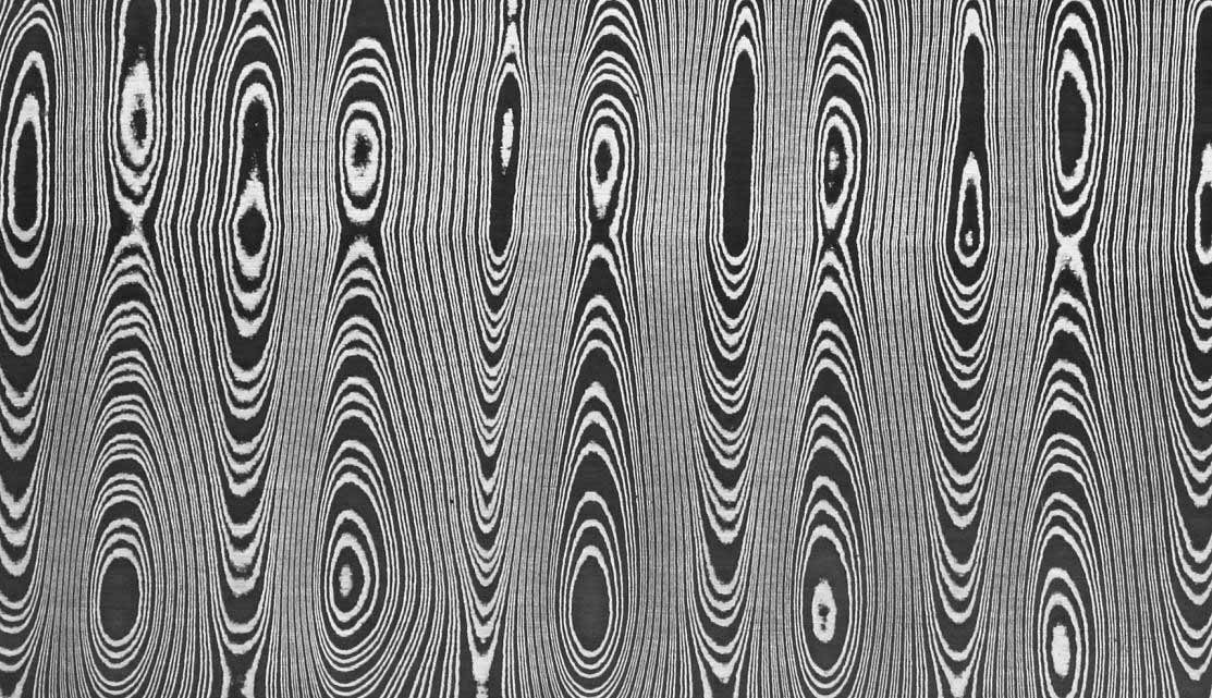

What is Pattern-Welded Damascus?
I went with the clickbait title of Damascus vs Super Steels because this has been a frequent question on internet discussion forums over the years. However, the question ultimately doesn’t make much sense. Pattern-welded Damascus is a product of two or more steels forge welded together by diffusion bonding. You could forge weld two or more “super steels” to each other as well. So what does “Damascus” vs “Super Steel” even mean? And what is a “super steel” anyway? I have an old article I wrote on this subject before (click here), there is no real fixed definition of super steel, but it typically refers to “new” steels with high edge retention. As long as there have been super steels there have been people saying that we don’t need super steels and the old classics are good enough. The steels being referred to as “super” changed over the years; while people talked about 154CM as a super steel in the 1970s, now the people saying the old steels were good enough are often talking about steels like 154CM.
Wootz Damascus, however, is a single steel with a pattern that results at the microstructure level, not by forge welding multiple steels together.
Image of diffusion bonding from [1]

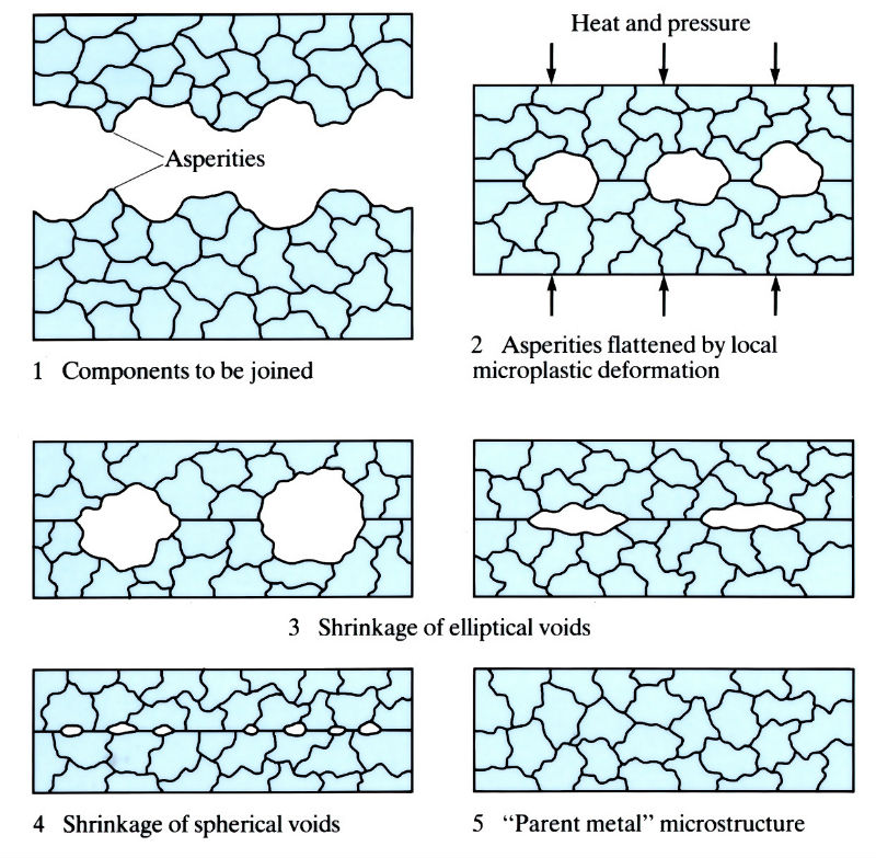

Steels will bond to each other automatically at high temperatures, most of what forge welding entails is getting all of the surfaces to contact each other; even very flat steel is not perfectly flat and smooth on a fine scale. What flux does is remove oxides so that the iron-based surfaces will touch each other and diffusion occurs between the two steels.

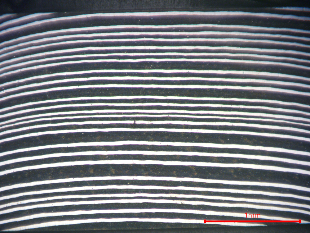

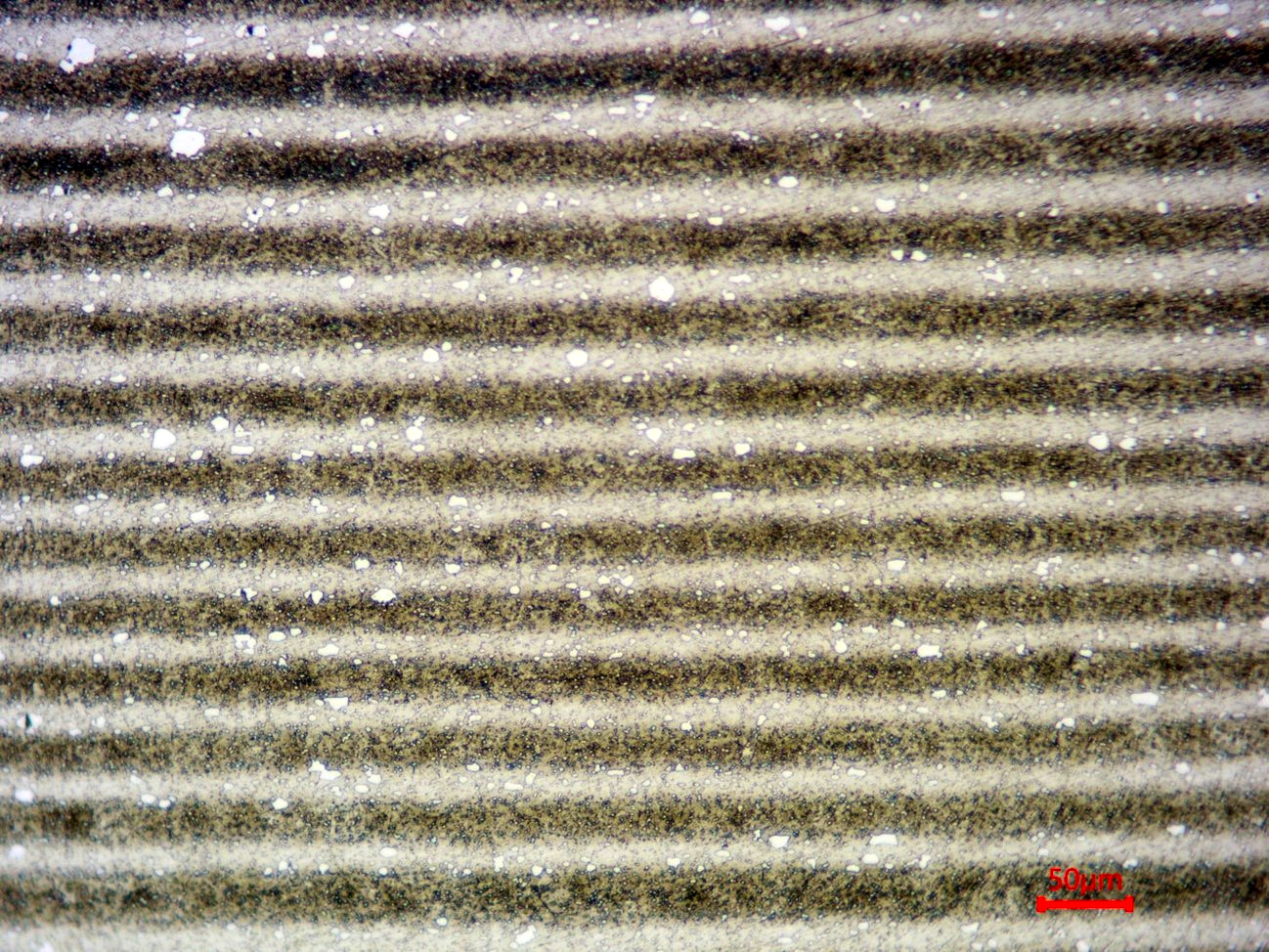

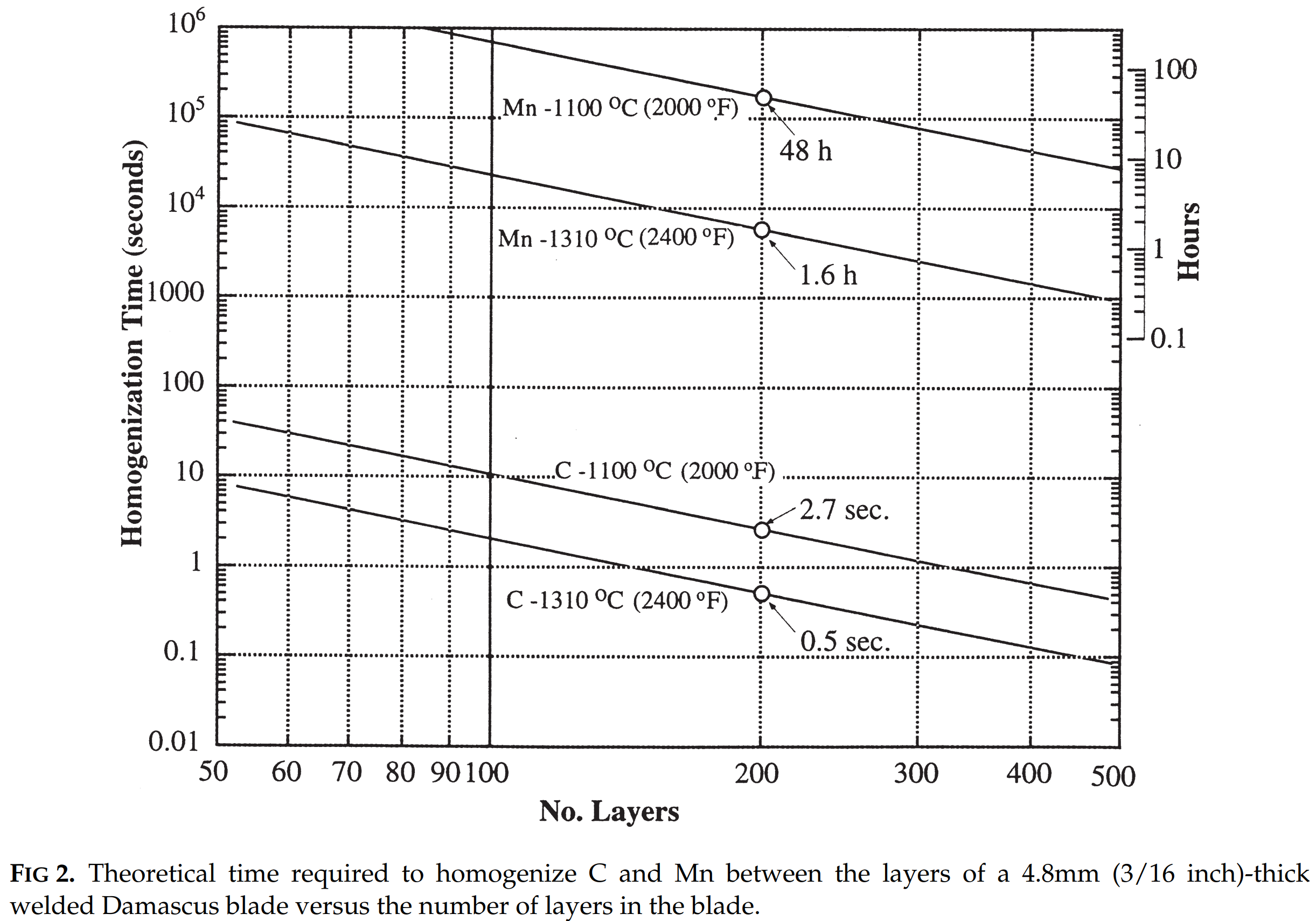

Damascus Cutting Effect and Diffusion
Another claim about Damascus cutting performance has been that alternating soft and hard layers would lead to a “serration” effect and therefore greater slicing edge retention. Bladesmiths claimed this would result from using low carbon and high carbon steels together in Damascus. However, carbon is a very small element and diffuses between layers of pattern-welded Damascus very rapidly. A study [2] performed by metallurgist Dr. John Verhoeven and bladesmith Howard Clark found that carbon equalizes between steels, and simulations determined that it would happen in seconds at normal forge welding temperatures with typical layer counts. They measured the hardness of individual layers for several steel combinations and found that the hardness was the same. The contrast after etching in Damascus instead comes from the larger elements such as manganese or nickel which take much longer to diffuse.
Chart from the Verhoeven-Clark study [2]
However, there are still ways to achieve a combination of hard and soft layers. One is to use an unhardenable metal such as nickel along with steel. Another is to use two steels with different “hardenability” levels. If an air hardening steel is used along with a water or oil hardening steel in Damascus, when cooled in air the air hardening steel will harden while the water or oil hardening steel transforms to soft pearlite. Tai Goo has talked about using the air hardening steel A6 in Damascus. A6 gets its high hardenability from manganese rather than chromium like most other air hardening steels. This means that it can be heat treated at lower temperatures like water or oil hardening steels.
Could the “Damascus cutting effect” be real? Would it even be beneficial if it did occur?

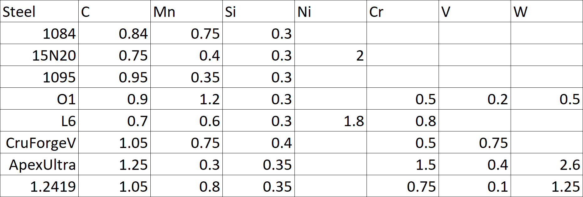

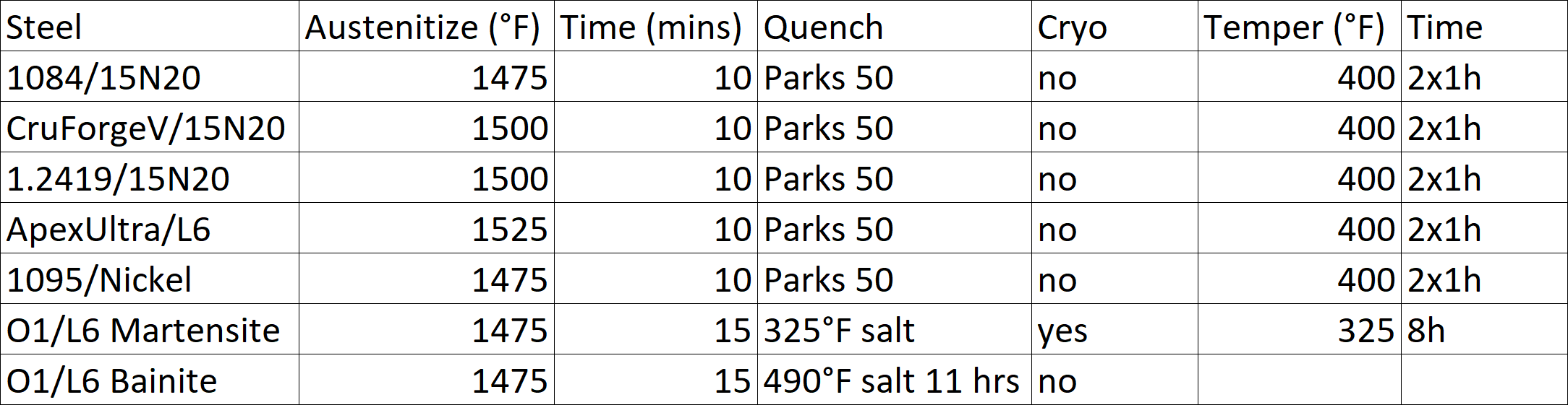

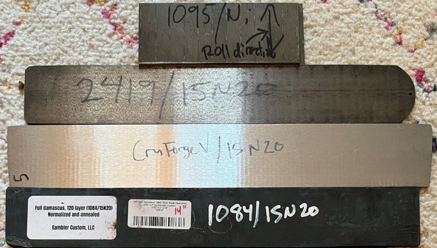

Carbon Steel and Low Alloy Damascus Combinations Tested
We tried a whole range of Damascus combinations. Perhaps the most commonly used is 1084 and 15N20. Both are low allow simple steels with a similar carbon content, but the 15N20 has 2% nickel. The nickel addition leads to the steel resisting etching and therefore there is contrast between the two. While 1084/15N20 is pretty common for custom knifemakers, when it comes to purchased Damascus it is much more difficult to purchase. But I was able to get some in random pattern by Gambler Custom (Payton Pelland).
I also got some random pattern O1/L6 from KC Lund with samples that were machined by William Brigham. O1/L6 is probably the second most common “double high carbon” combination though the two steels are somewhat higher in alloy, and therefore somewhat trickier to forge weld. I have not gotten the heat treatment specifics from KC Lund yet, though he said that the martensite heat treatment included a cryo step, and the bainite heat treatment was austempered using salts. You can read more about bainite heat treatments in this article.
Another somewhat more complex mix that we tested was CruForgeV/15N20 which I purchased from Salem Straub with a ladder W’s pattern.
Other low alloy combinations I tested was 1095 with pure nickel in ladder pattern by Devin Thomas, and 1.2419 with 15N20 in W’s ladder pattern by Devin Thomas

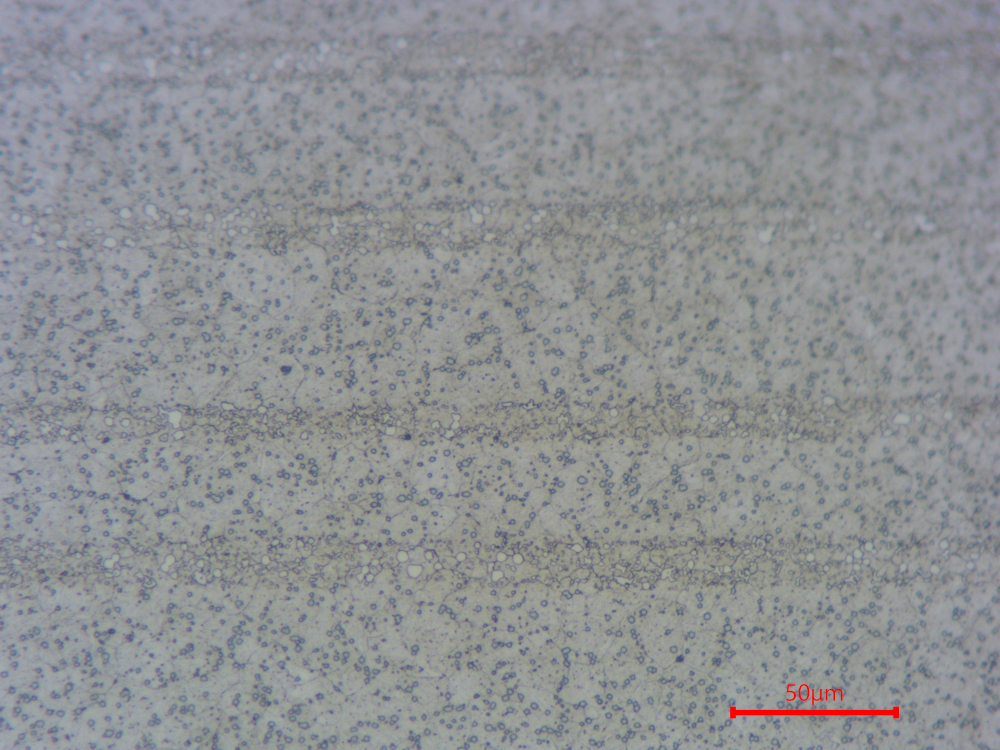

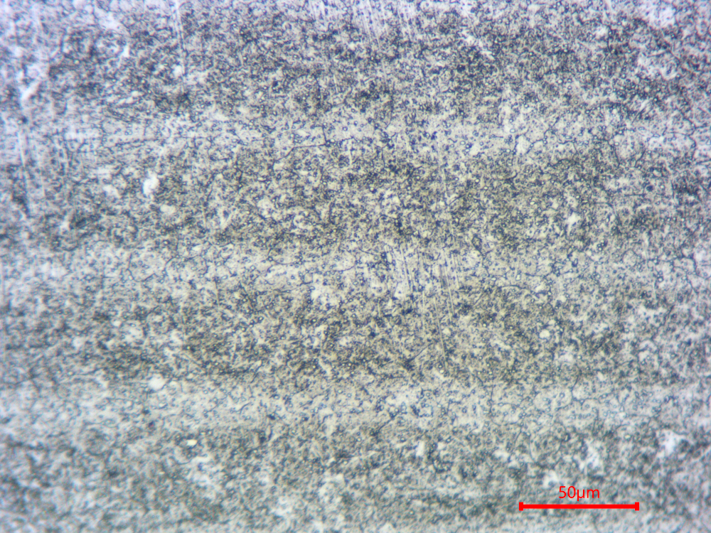

In general, the higher wear resistance steels and those in ladder pattern did the best. This included ApexUltra, 1.2419, and CruForgeV, all steels with tungsten and/or vanadium additions for hard carbides. The “plain” or “monosteels” for comparison are shown with orange dots. I have a dotted line through the random pattern steels as well as a dotted line through ladder pattern steels, and clearly the ladder pattern steels are higher in slicing edge retention. A broader CATRA chart with more plain steels is later in the stainless Damascus edge retention section.

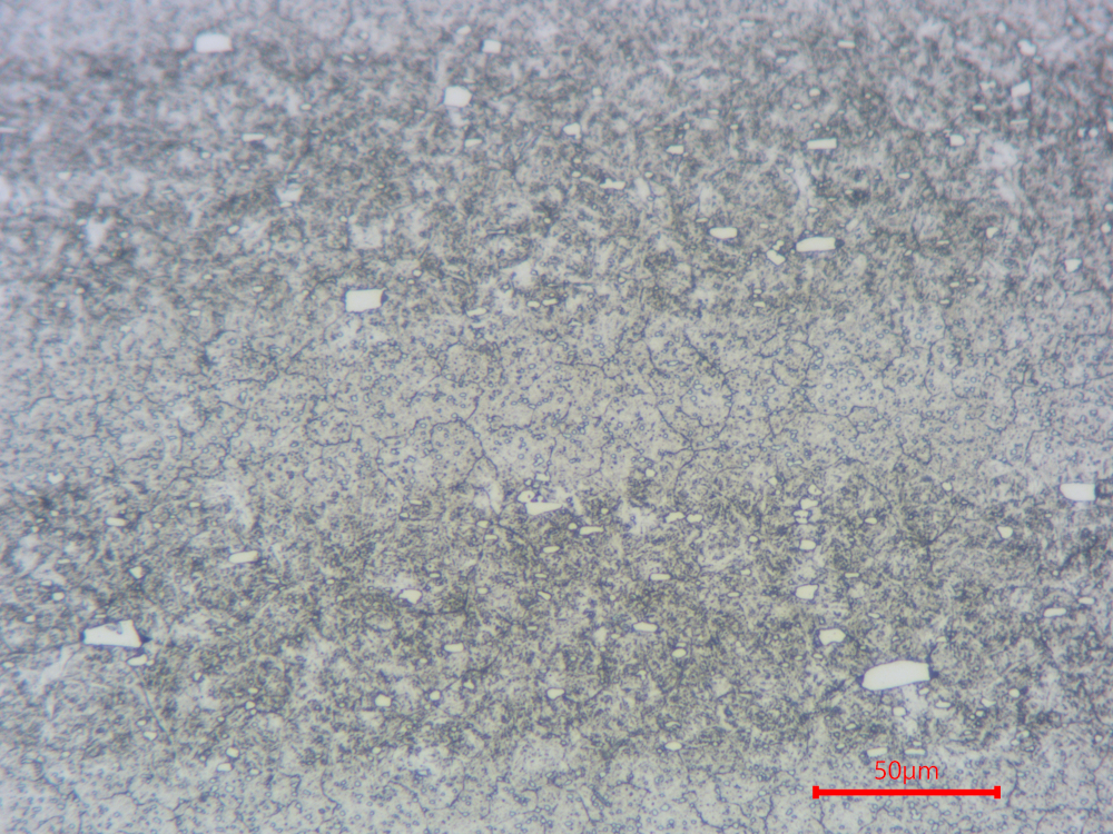

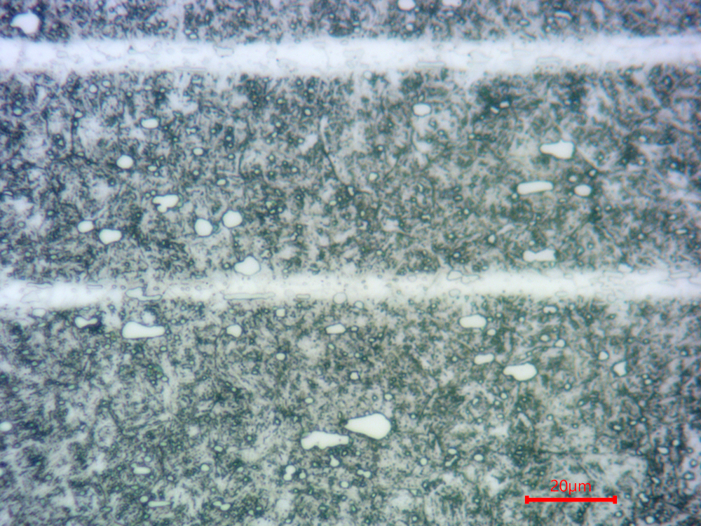

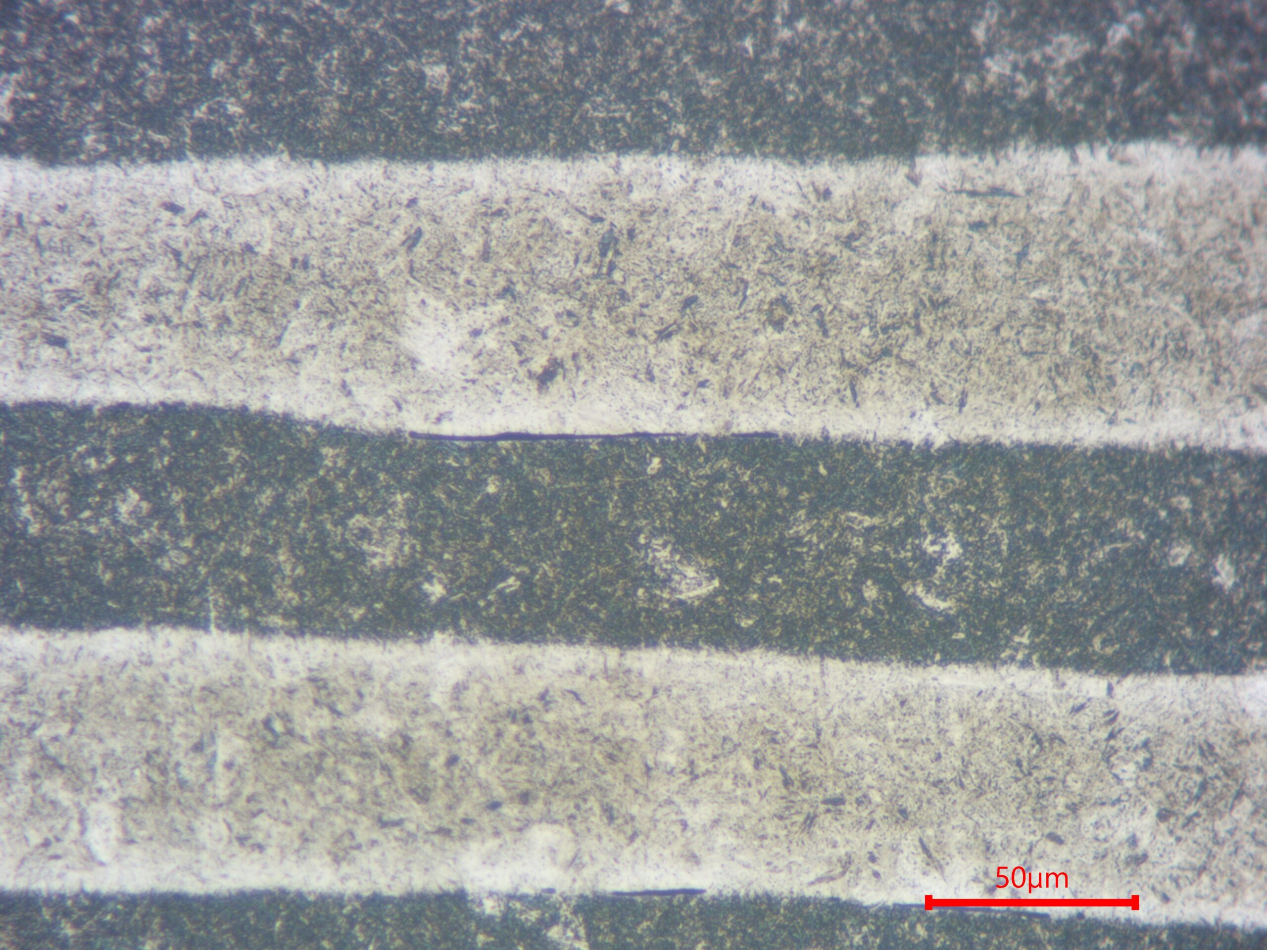

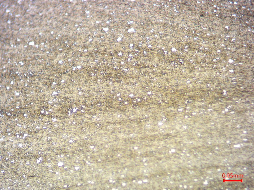

The higher wear resistance of the higher carbon steels is visible in the microstructure where the steels have greater carbide volume. See the microstructures of the 1.2419/15N20 and CruForgeV/15N20 below compared with O1/L6 and especially the 1084/15N20 (ApexUltra/L6 and 1095/Ni micrographs coming later in the article).
1.2419 (dark) and 15N20 (light)
CruForgeV (dark) and 15N20 (light). There are some larger vanadium carbides in the CruForgeV.
O1 (dark) and L6 (light). There are scratches from the polishing process in the L6.

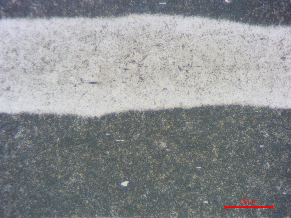

1084 (dark) and 15N20 (light). There are short regions of delamination between the two layers.

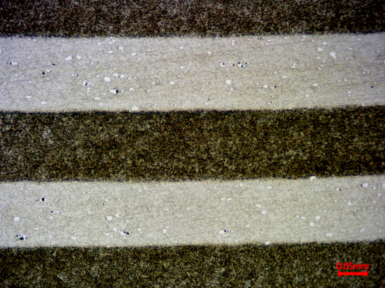

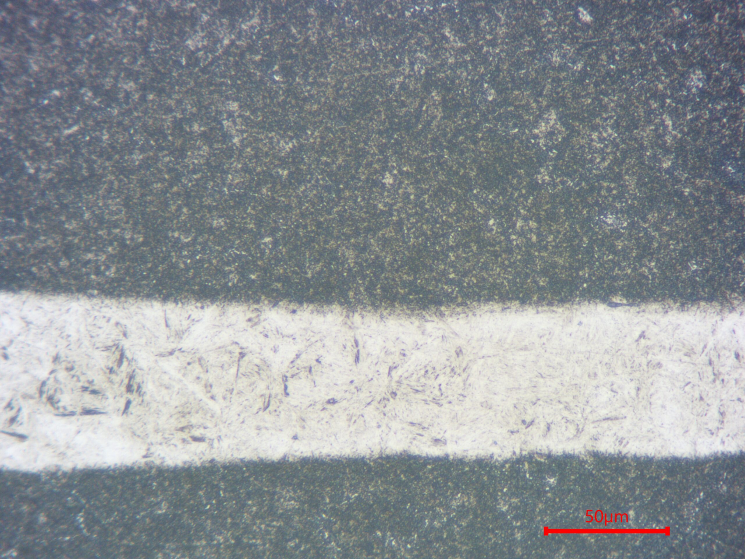

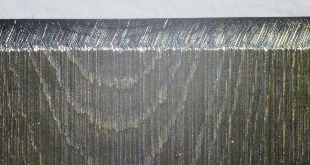

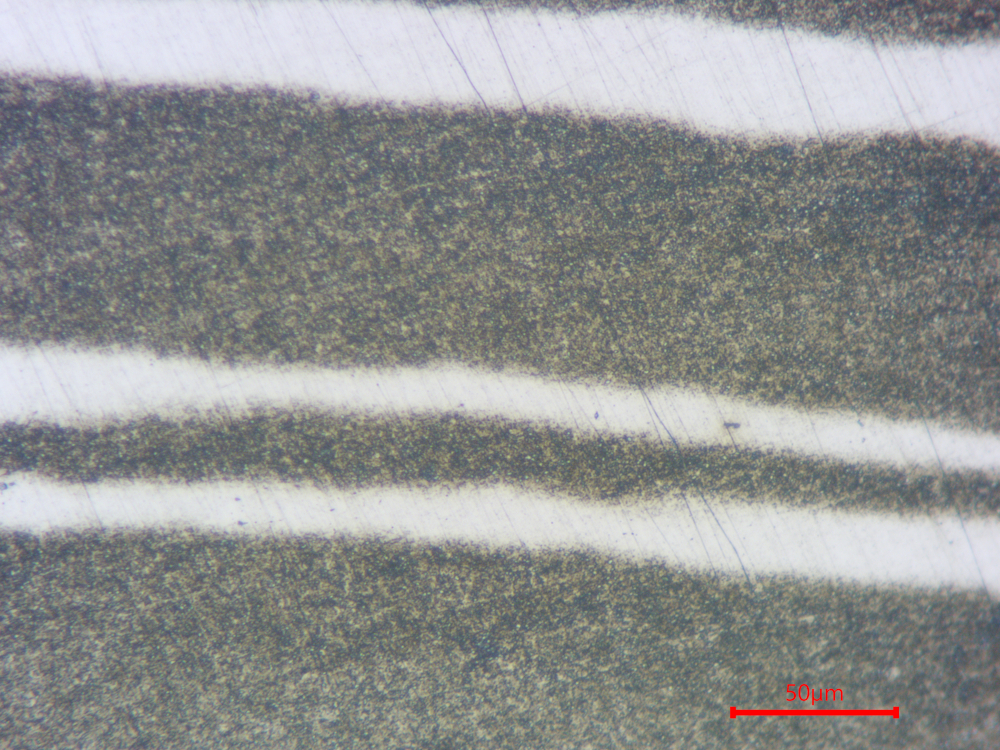

Damascus Cutting Effect Confirmed

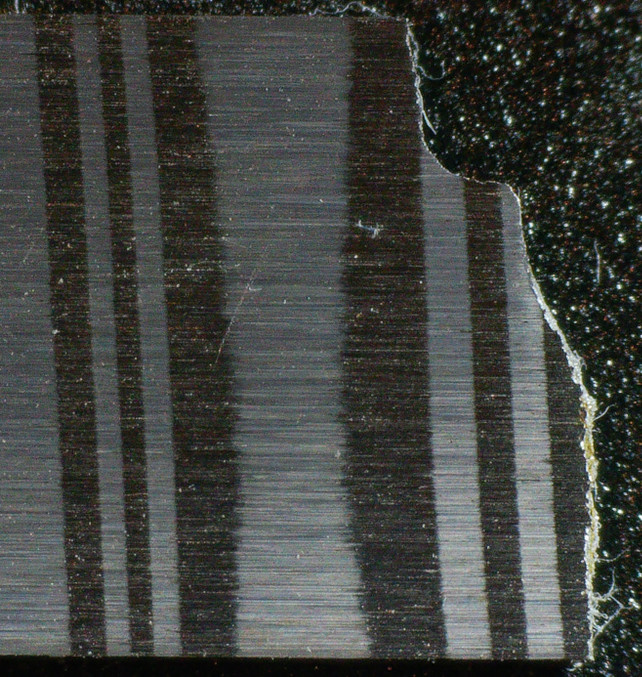

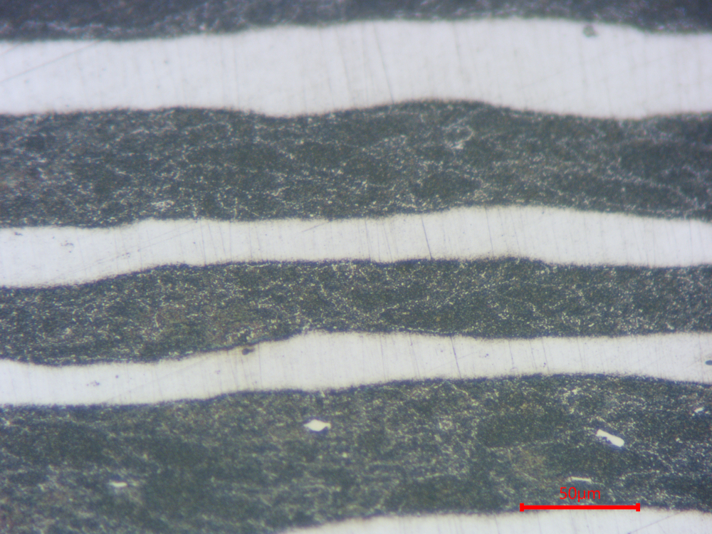

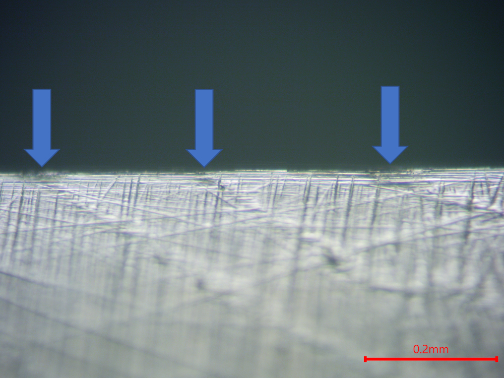

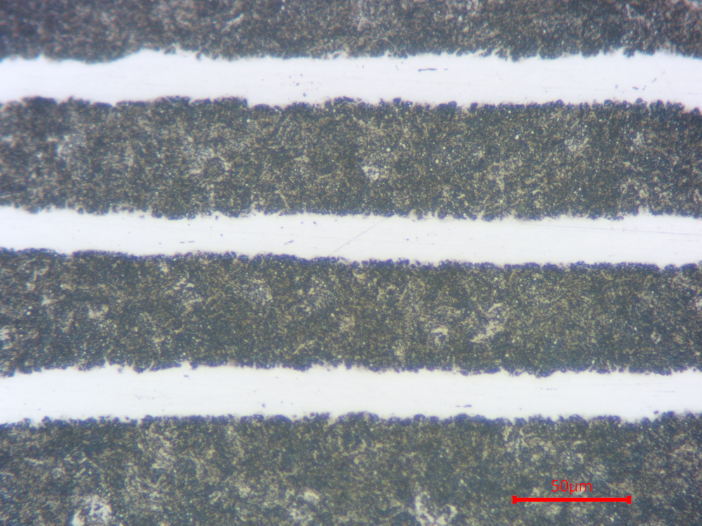

There is another important datapoint on the above chart and that is the 1095/Nickel combination. Nickel is a soft metal so sometimes bladesmiths will avoid it in their Damascus so as to have all hard steel in the edge of the knife. The composite hardness reading was ~51.5 Rc after heat treating though this value is somewhat misleading. The soft nickel leads to lower hardness though the 1095 itself was roughly 62 Rc (I couldn’t scratch it with a 60 Rc file). There is only about 8% nickel in the steel but it has a relatively large impact on the Rockwell hardness. Despite the 8% soft nickel, the 1095/Nickel Damascus had higher edge retention than any of the other low alloy combinations, even the ApexUltra/L6 ladder pattern Damascus. To investigate what led to this high edge retention I took images of the edge after testing:
Dark lines are visible in the worn edge which correspond to the nickel layers. These worn layers were not visible in any of the other tested steels, though perhaps it is there but simply very subtle. Looking at the edge at higher magnification there are rough, worn regions of the edge which align with where the nickel layers intersect the edge:
This appears to confirm the “Damascus Cutting Effect” theory of hard and soft layers in slicing edge retention. However, it could be that in other types of testing the soft nickel layers are less desirable. Perhaps in chopping or push cutting with high stresses those nickel layers could become a detriment. Here is the microstructure of the 1095/Nickel as well:
The 1095 is the dark layer with bright carbides in it for wear resistance. The nickel is the bright layer without any visible microstructure features in it. There may be some impurities in the nickel which show up as dark features. Any metal has some level of impurities, including steel, though they often aren’t visible when the steel is etched to reveal the microstructure. There is no evidence of significant diffusion between the steel and nickel layers, though the mating surfaces are relatively rough, perhaps in part due to how soft nickel is during forging, though maybe there is some nickel diffusion as well.

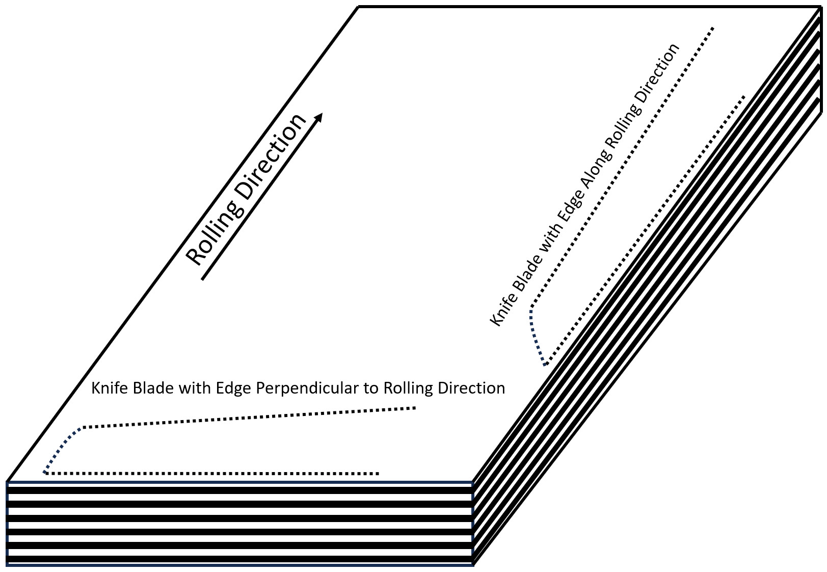

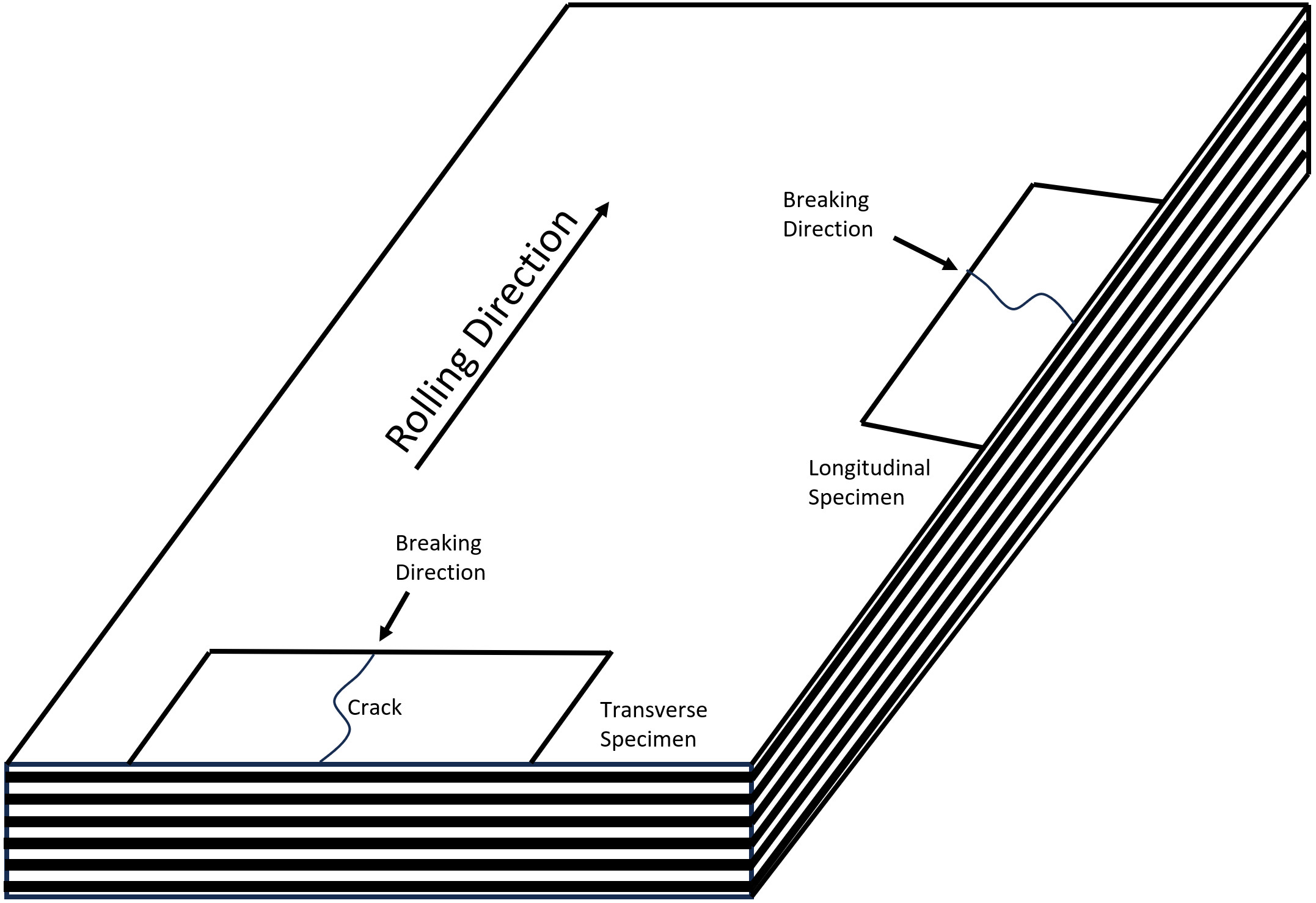

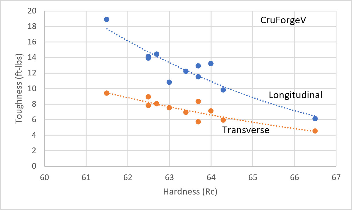

Toughness vs Sample Orientation

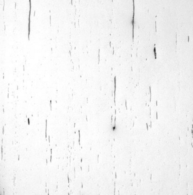

The direction in which specimens are broken when testing impact toughness matters. Steel is hot rolled at the mill and therefore has elongated features along the rolling direction. These include inclusions and impurities like manganese sulfides and in tool steels there are often “carbide stringers” which are elongated in the rolling direction.
Manganese sulfides in steel (rolling direction is vertical) [3]
Carbide stringers in high speed steel (rolling direction is vertical) [4]
“Transverse” toughness specimens are broken so that cracks grow along the rolling direction, and therefore toughness is usually somewhat lower because the crack can grow along these elongated features. “Longitudinal” toughness is usually higher because the crack grows across these elongated features and is therefore largely unaffected by the segregated nature of the brittle microstructure features.
When it comes to pattern-welded Damascus, with straight layers the longitudinal vs transverse toughness remains largely the same. The crack does not grow across layers, and so the crack growth is still controlled by the rolling direction. Knives are typically cut out from steel plates so that the edge is along the rolling direction, and therefore when a knife is chopping it behaves similarly to a longitudinal toughness test. However, it is somewhat common, especially with larger plates, that knifemakers or knife companies will cut out knives so that the edge is perpendicular to the rolling direction, and therefore the edge toughness behavior would be more similar to a transverse toughness test.

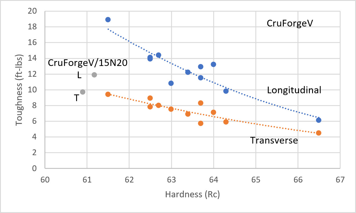

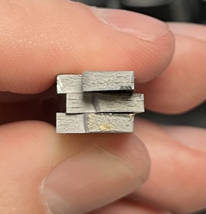

Toughness of CruForgeV/15N20 Damascus
Previously my father and I did a sizable study on CruForgeV steel toughness, including forging, annealing, and quench and temper variables. A significant difference between longitudinal and transverse toughness was measured, as expected. You can read this study if you click here.
When we tested the CruForgeV/15N20 Damascus in both orientations, we found that the transverse toughness was similar with the straight CruForgeV for the same hardness, but the longitudinal toughness was very similar. In other words, the longitudinal toughness seems to be worse than CruForgeV when tested by itself.

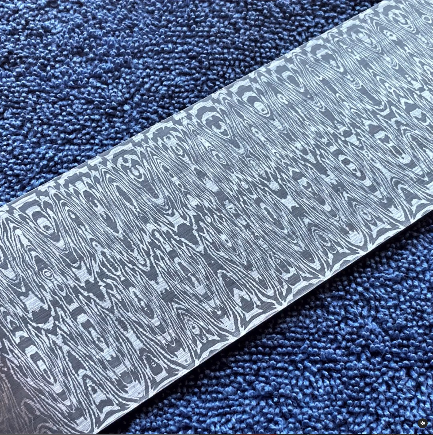

There are a couple important things to note from this result. One is that the high toughness 15N20 doesn’t seem to be helping the toughness of the CruForgeV. The toughness appears to be primarily controlled by the “weakest link” steel with lower toughness. This makes some sense because the cracks still initiate in a similar fashion in the more brittle material. Apparently the crack growth through the higher toughness steel does not have a large impact on the resulting toughness. Another pattern which will be further explored in the upcoming sections is that ladder patterned steel has worse longitudinal toughness than plain steel. This was unexpected to me since the ladder patterning leads to a “wavy” appearance along the cross-section but no vertical sections which would align with the cracks in specimen. However, it does make some sense two-dimensionally since there are intersecting lines with the surface that are aligned with the crack direction in longitudinal toughness tests.
Salem Straub Damascus with a “W’s” ladder pattern, which led to vertical features that mean reduced longitudinal toughness

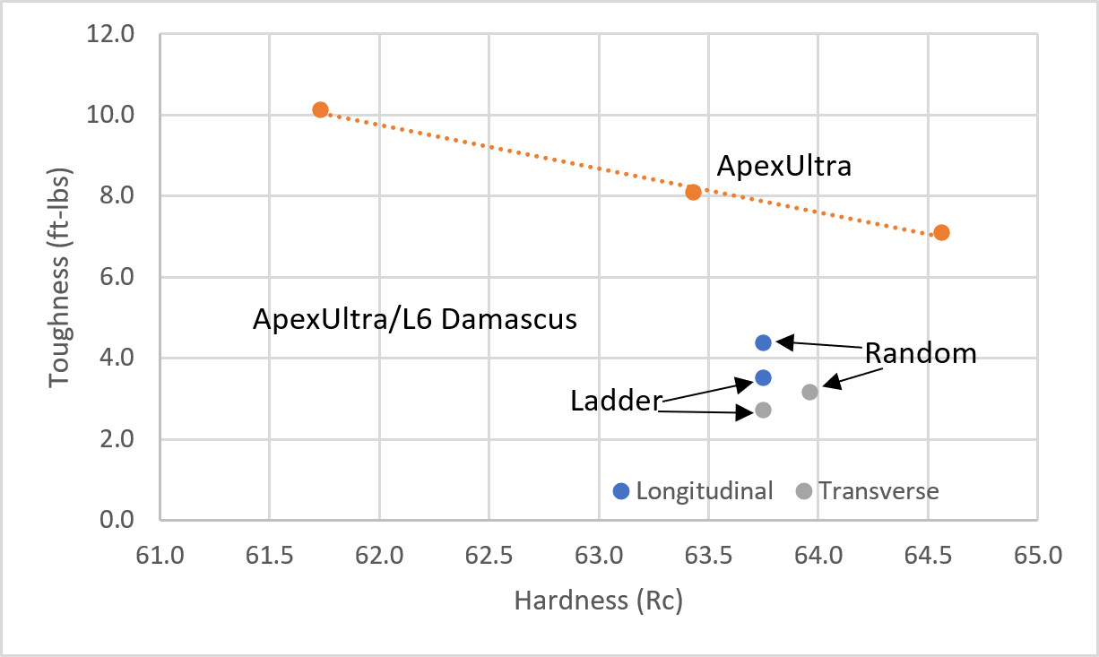

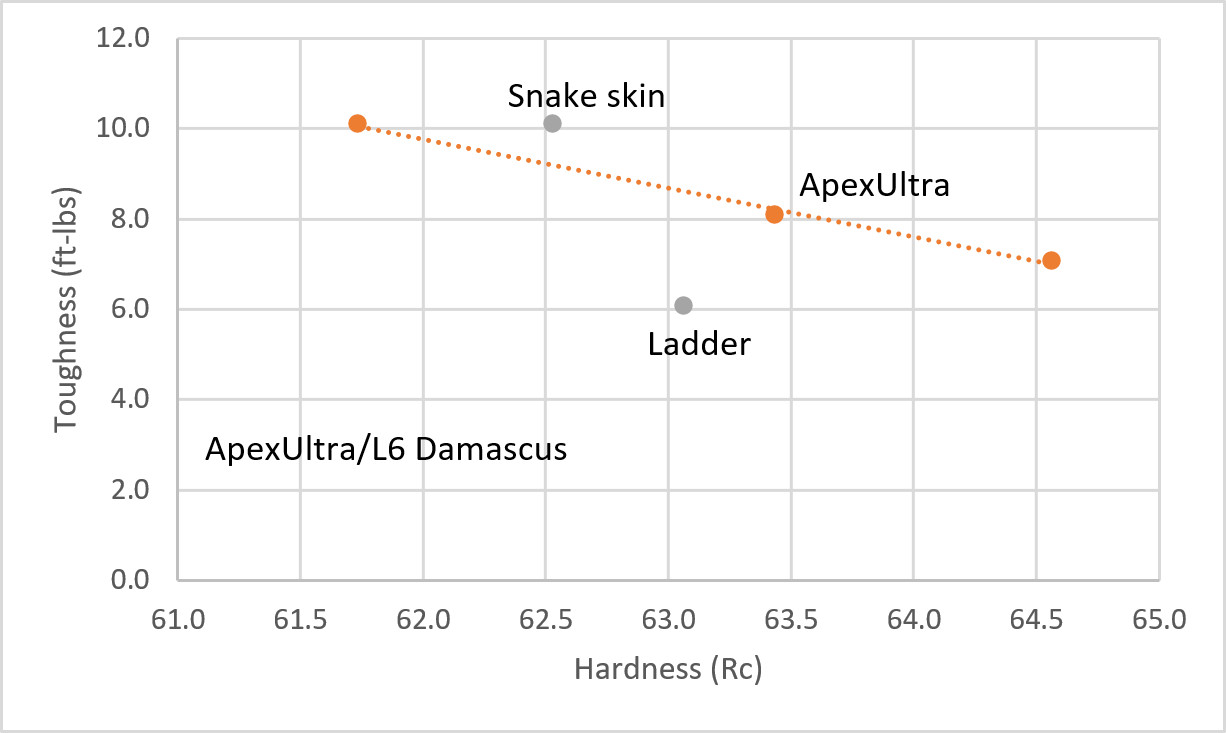

We did an experiment with ApexUltra/L6 Damascus where we tested both ladder pattern and random Damascus in both the longitudinal and transverse directions. We confirmed that ladder pattern led to worse toughness, and that transverse toughness was worse in either case. However, the toughness was surprisingly bad. When we looked at the microstructure we found carbides along the grain boundaries in the ApexUltra layers. This tends to happen in very high carbon, low alloy steels, especially when they have more than about 1.1% carbon. ApexUltra has 1.5% Cr which helps prevent this behavior but not entirely. My father forged in a low temperature range with the Damascus and did not perform a normalize and this was not sufficient to prevent grain boundary carbide.
Ladder patterning and transverse testing lead to lower toughness
Grain boundary carbide is visible in the ApexUltra layers
My father and I brainstormed the issue and decided to normalize the steel again to eliminate the grain boundary carbides. A plate quench was used after normalizing to ensure that the bad carbides didn’t form. The steel was normalized at 1850°F for 15 minutes, plate quenched, grain refined at 1450°F for 10 minutes, then annealed at 1450°F for 30 minutes followed by 100°F/hr cooling. This time we looked at two patterns: ladder and snake skin. The snake skin patterning does not have the vertically aligned features to lead to worse longitudinal toughness. We only measured longitudinal toughness in this case. The toughness improved up to a similar level to plain ApexUltra, especially with the snake skin pattern. This again confirms the previous test with CruForgeV that found that the steel with lower toughness largely controls the overall toughness behavior.
ApexUltra/L6 Damascus re-tested after no thermal cycling to eliminate grain boundary carbide
Ladder pattern
Snake Skin pattern

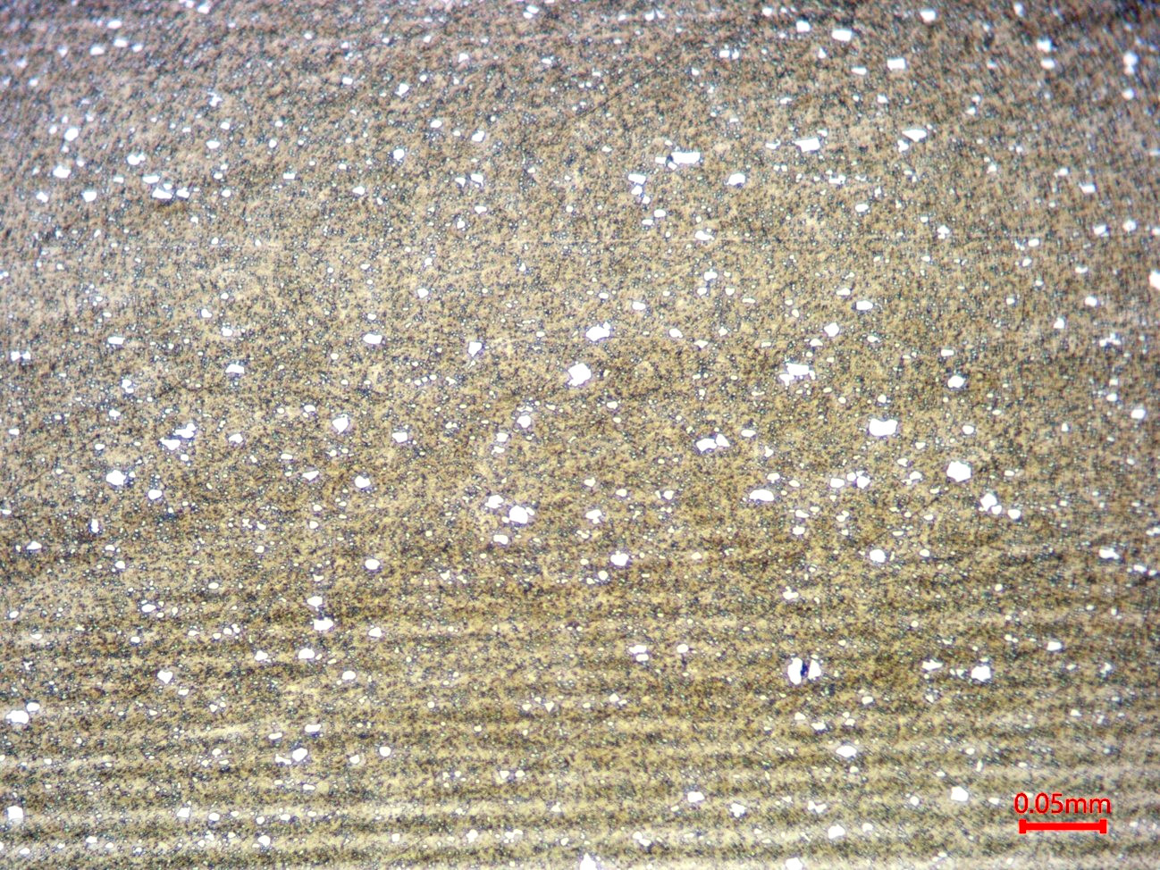

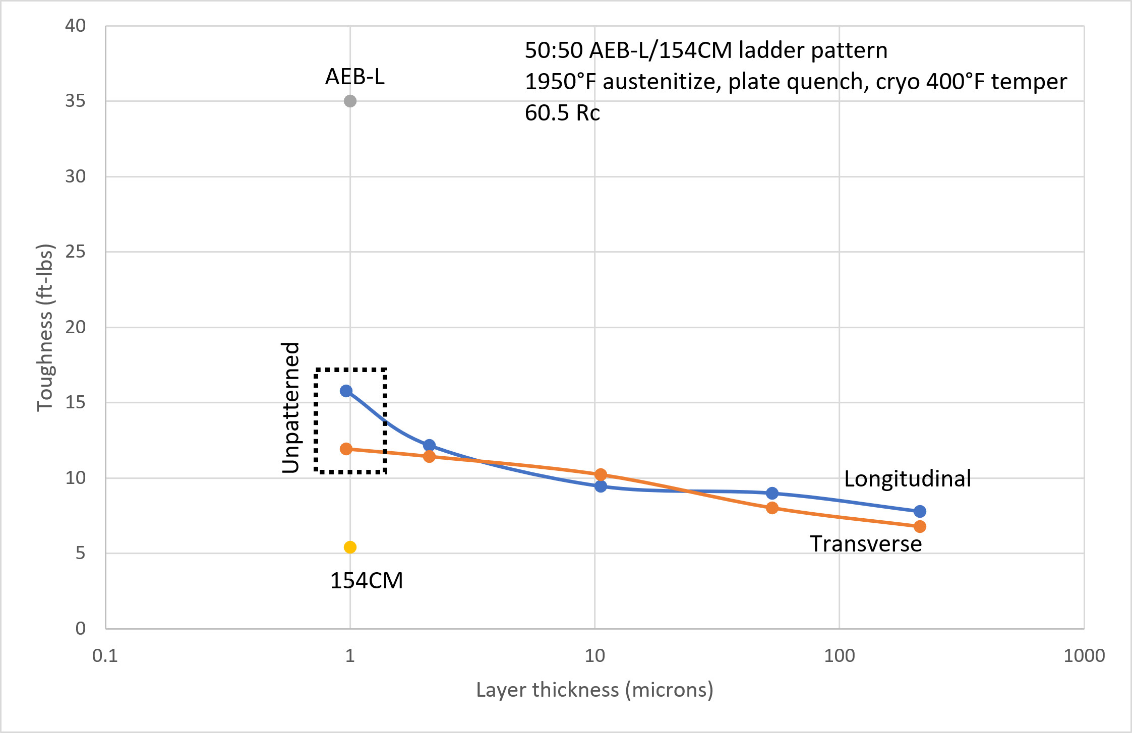

Study on Improving Carbide Structure of High Alloy Steels Through High Layer Counts
One relatively rare claim with Damascus steel is improving the microstructure through high layer count forge welding. We did a study on AEB-L/154CM Damascus in a 50:50 ratio. AEB-L has a very fine microstructure due to its composition design and excellent processing by Uddeholm. This is despite the fact that AEB-L is a stainless steel which is produced with conventional techniques, not powder metallurgy. 154CM is a conventionally produced high carbon stainless steel and so has relatively coarse carbides within it. There are powder metallurgy versions available (CPM-154 and RWL-34) but we wanted to see if it is possible to improve the carbide structure through forging.
154CM has coarse carbides
AEB-L has very small carbides

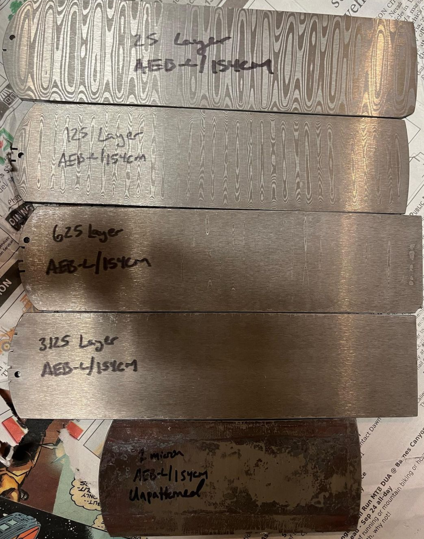

So the question we had was whether it is possible to reduce the size of these 154CM carbides. For example, if you forge down to a very high layer count, the layers can be much thinner than the carbides themselves. Would the carbides be forced down to a size smaller than the layer thickness? And if no, perhaps simply the high forging reduction ratio would lead to a significant reduction in carbide size anyway. So we did layer counts of 25, 125, 625, and 3125, all ladder patterned. The 3125 layer Damascus was further rolled down without patterning to achieve a final approximate layer thickness of 1 micron.  The 25 layer Damascus is very coarse, the 125 layer Damascus looks pretty good, the 625 is too fine; it is difficult to see the pattern. The 3125 layer Damascus there is no visible pattern.
Another thing to keep in mind is that as the layer count goes up, and the layers become thinner, there is less distance required for diffusion between the two steels. Therefore, the steel becomes more homogenous as the layer count increases. Eventually, if the layer count is high enough and there has been sufficient temperature and time, rather than layers we simply have a homogenous steel. In the 25 layer steel there are distinct layers of the two steels:
25 layer Damascus of AEB-L and 154CM. The “bright” layers are 154CM with larger carbides.
With 125 layers there are still clear layers, though perhaps the transition between the two steels is somewhat less distinct.
125 layer Damascus of AEB-L and 154CM
At 625 layers, the layers are sometimes difficult to see, and the transitions are very diffuse. Another thing to note is that many of the larger carbides cross through the layers; they don’t stay in the 154CM layers.
625 layers

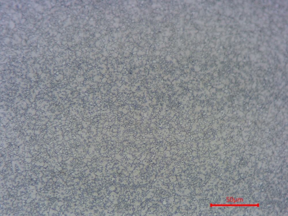

At 3125 the layers are no longer visible. It is clear that the carbides were not reduced to below the ~2 micron layer thickness. However, the carbides were reduced to a smaller size than the original.
3125 layers ladder pattern
With the un-patterned 3125 layer count steel with ~1 micron layer thickness it looks similar:
3125 layers no patterning (random)
Without a full statistical analysis it is hard to tell how much the carbide size was reduced through the forge welding. There are still some larger carbides present in the Damascus even with the high reduction in forging. However, the ultimate goal is a toughness improvement so of course we tested the toughness of the Damascus material. The higher the layer count the higher the toughness, with a fairly convincing trend. With ladder patterning the transverse and longitudinal toughness were very similar, which is line with the tests described for the low alloy steel Damascus. The un-patterned ~1 micron layer thickness material showed a difference between longitudinal and transverse toughness with the longitudinal toughness being significantly higher. The toughness was closer to 154CM than to AEB-L, but there does seem to have been a benefit to having the higher toughness AEB-L in the mix. The layer thickness is approximate based on the forging reduction, as with the patterning the layer thickness is not consistent, and at high layer counts the layers are no longer visible.
Looking at an etched surface of a broken specimen, there did appear to be crack growth that occurred along with the ladder pattern layers (see below). This seems to confirm the effect of ladder patterning on longitudinal toughness. So despite the fact that these vertical lines do not go throughout the entire cross-section it still leads to a reduction in toughness.
Fractured impact toughness specimen in the 25-layer AEB-L/154CM.
In terms of edge retention there was no clear difference in layer count with CATRA testing. We didn’t have a large enough piece to test the un-patterned Damascus. The edge retention was quite close to 154CM despite the significantly lower edge retention of the AEB-L layers. This may be due to the ladder patterning effect that was discussed in the low alloy Damascus section.
However, this somewhat contradicts a much earlier CATRA study that my father and I did on AEB-L/154CM Damascus. It was the first CATRA study we ever did, done at Spyderco who graciously allowed us to use the machine. We had three knives: AEB-L, 154CM, and 50:50 AEB-L/154CM Damascus in ladder pattern. We brought them to Spyderco unsharpened so that they could put their preferred edge on them. However, it turned out the method at the time was sharpening by hand on belts. Now I use a fixed angle sharpening method with an Edge Pro and check the sharpness with an Edge on Up tester to ensure consistency. The result of the study was that the AEB-L/154CM Damascus tested right in the middle of the two individual steels. Perhaps it was due to inconsistency in sharpening that we got this seemingly intuitive result.
Original study on AEB-L/154CM ladder pattern Damascus that didn’t test as closely to 154CM as the new experiment

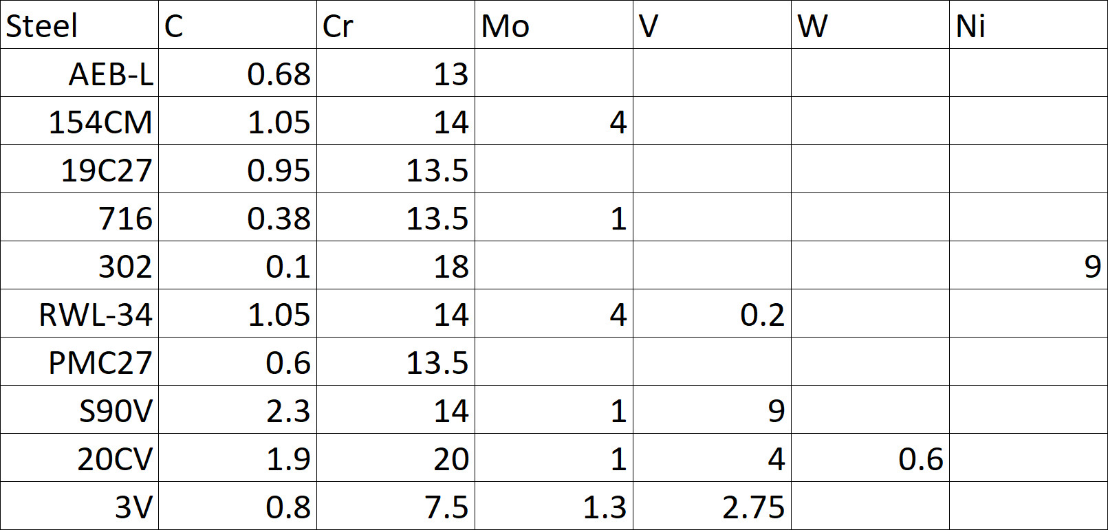

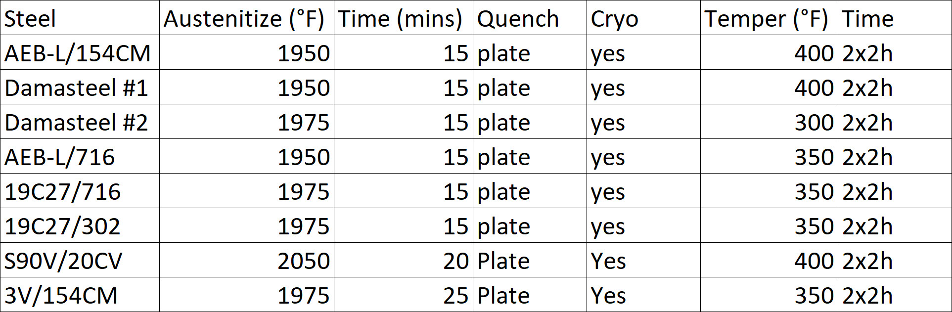

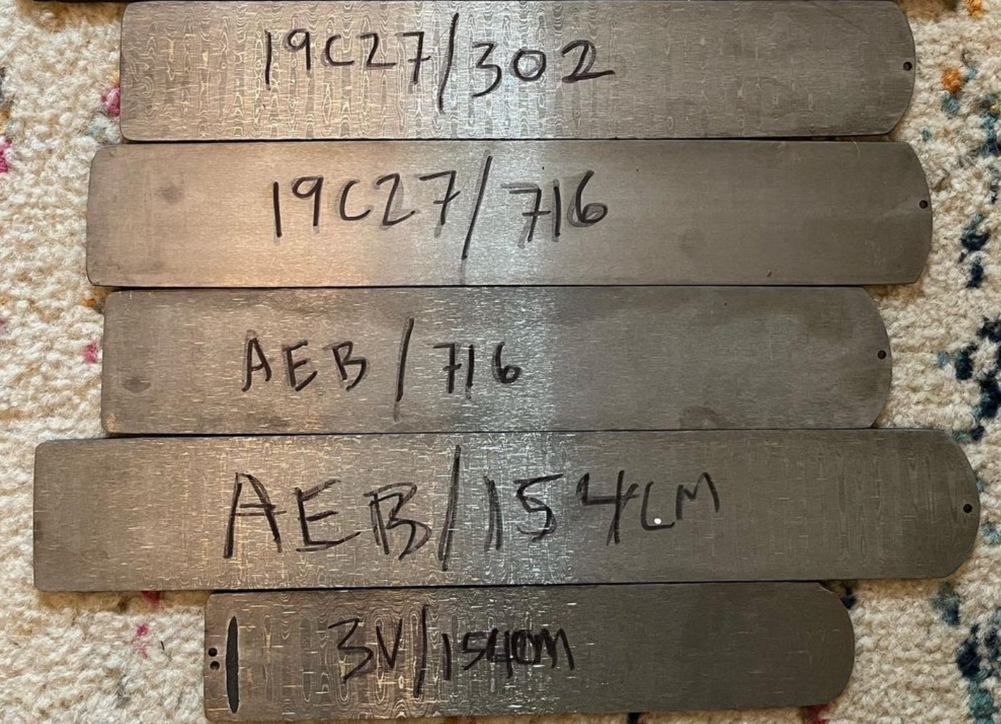

Stainless and High Alloy Damascus Combinations Tested

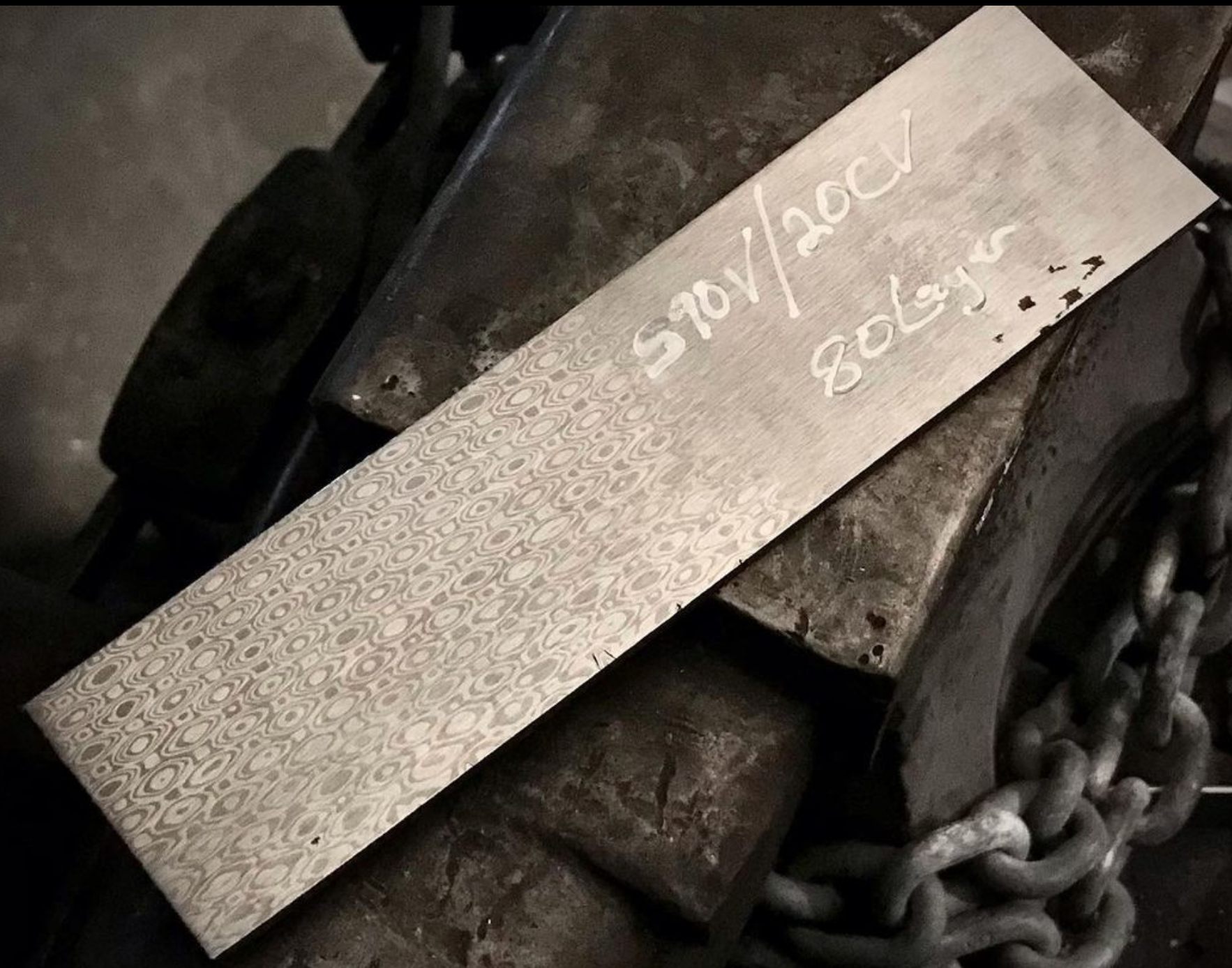

For high alloy steel combinations I purchased S90V/20CV by Cosmo Knives (Seth Burton), an impressively high alloy stainless steel combination, both of them powder metallurgy steels.
I purchased some Damasteel which is made with RWL34 (powder metallurgy ATS-34/154CM) and PMC27 (powder metallurgy 12C27). The Damasteel was in the “Hugin” pattern which looks like ladder but the pattern becomes looser and “straighter” as it approaches the center.
Damasteel Hugin pattern CATRA blade
And Devin Thomas made 3V/154CM, 19C27/302, 19C27/716, AEB-L/716, and AEB-L/154CM, all in ladder pattern. 716 is a 420-type steel though on the upper end of carbon for that grade (without being 420HC), and a 1% Mo addition. Alleima (previously Sandvik), has a new Damascus product with 19C27/7C27Mo2 made in collaboration with Balbach Damast. 7C27Mo2 is the same as 716. I was unable to obtain the Alleima product in time for this study but the 19C27/716 is the same combination (my father says he made this combination before Alleima came out with the new product). 302 is a low carbon austenitic stainless steel.
One common theme for many of the high alloy steels is combining with a Mo-alloyed steel such as 154CM (4% Mo) or 716 (1% Mo). However, S90V and 20CV both have 1% Mo but a contrast is obtained anyway. Seth thinks it is due to the vanadium difference. I think there are a lot more high alloy combinations left to explore. With different etchants this could also lead to combinations which were not previously thought possible.

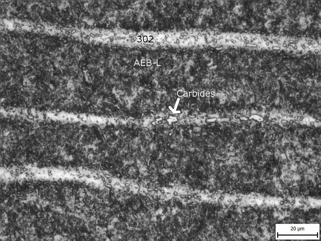

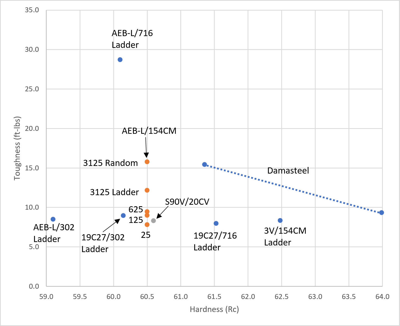

Toughness of Stainless and High Alloy Damascus
The highest toughness of these combinations was the AEB-L/716, the only combination which included two high toughness steels. It likely could have tested even higher if it had been random straight layers instead of ladder pattern. The relatively low toughness of 19C27 and 154CM meant that 19C27/716 and 3V/154CM were not spectacularly high. CPM-3V is known for having very high toughness, I have tested it to be over 30 ft-lbs, but the relatively low toughness of 154CM meant that it was only moderate. S90V/20CV Damascus did quite well for its level of wear resistance, which is a combination of the powder metallurgy technology and the patterning, which is relatively similar to the previously discussed snake skin pattern.
The 19C27/302 Damascus was relatively similar to 19C27/716, which normally I would assume means that the toughness of the 19C27 was the controlling factor. However, the microstructure and the AEB-L/302 Damascus test tells a more complex story. The AEB-L/302 coupon is one I tested a few years ago, the only test on Damascus I had performed before this study. I had assumed the AEB-L/302 would test very high, as AEB-L is a very high toughness steel and 302 is a low carbon, low hardness austenitic stainless steel which should test even higher. However, the AEB-L/302 instead tested similarly to high carbide stainless steels like 440C or 154CM. Looking at the microstructure revealed that large chromium carbides had formed in the 302 layers. This is presumably from carbon diffusion from the higher carbon AEB-L to the very low carbon 302. However, this doesn’t automatically lead to large carbides. When diffusion occurs it first segregates to the boundary between the two steels leading to a locally higher carbon area. This very high carbon region may have led to more rapid carbide growth, or even partial melting. When steel melts and resolidifies carbides can become much larger than when they form in solid steel. Carbon greatly controls the melting temperature of iron and steel, which is why “cast iron” is iron with a very high carbon content for easier and lower temperature casting. Large carbides are visible in the 302 layers of both the AEB-L/302 and the 19C27/302.
AEB-L/302 Damascus with large carbides in the 302
19C27/302 Damascus
Edge Retention of Stainless and High Alloy Damascus
As expected the S90V/20CV Damascus did much better than everything else, thanks to the high vanadium in the two steels, 4% in the 20CV and 9% in the S90V. It was by far the highest even though it didn’t have the benefit of ladder patterning. Vanadium carbides are among the hardest that form in steel and they have a very strong influence on wear resistance and slicing edge retention. There are several steels along a similar trendline in the center of the chart. The trendlines show the approximate effect of hardness on CATRA edge retention across a range of steel. Surprisingly, the 19C27/302 tested as well, or even slightly better after compensating for hardness, than the AEB-L/154CM, Damasteel, 19C27/716, and 3V/154CM. Perhaps this is in part due to a Damascus cutting effect in softer 302 layers. Though an alternative theory would be that large carbides formed in the 302 helped with wear resistance.
The 19C27/716 also did surprisingly well, similar to Damasteel even though the overall carbide content should be higher in the Damasteel. In other words, the average carbon content of Damasteel (0.83%) is higher than the 19C27/716 (0.67%). Perhaps this is because the Damasteel didn’t have a true ladder pattern as the layers were largely straight at the edge of the knife.
AEB-L/716 did the worst as expected due to the lower carbon content, carbide volume, and the wear resistance of the individual steels. However, it was similar to plain AEB-L, likely benefitting from the ladder patterning. Also it should be noted that it did better than most of the low alloy Damascus combinations. The harder chromium carbides in stainless steels means that they typically have higher wear resistance than low alloy steels with softer iron carbides.
