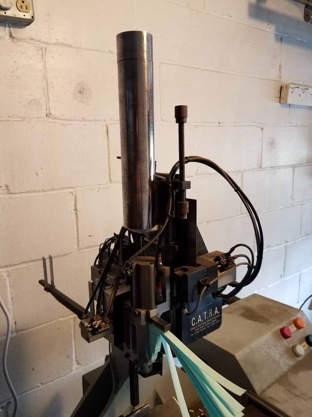

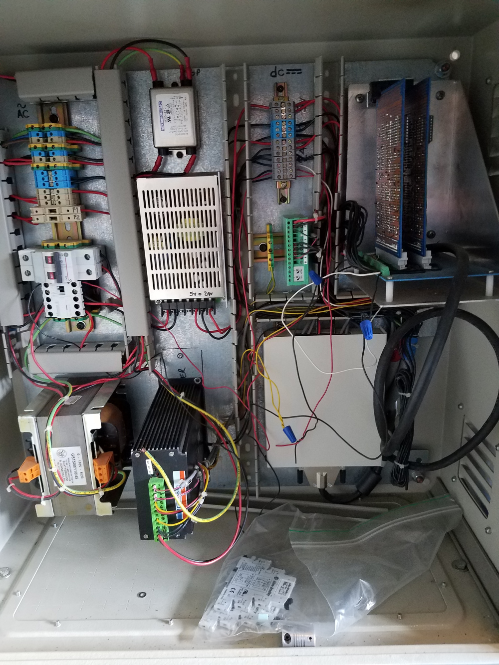

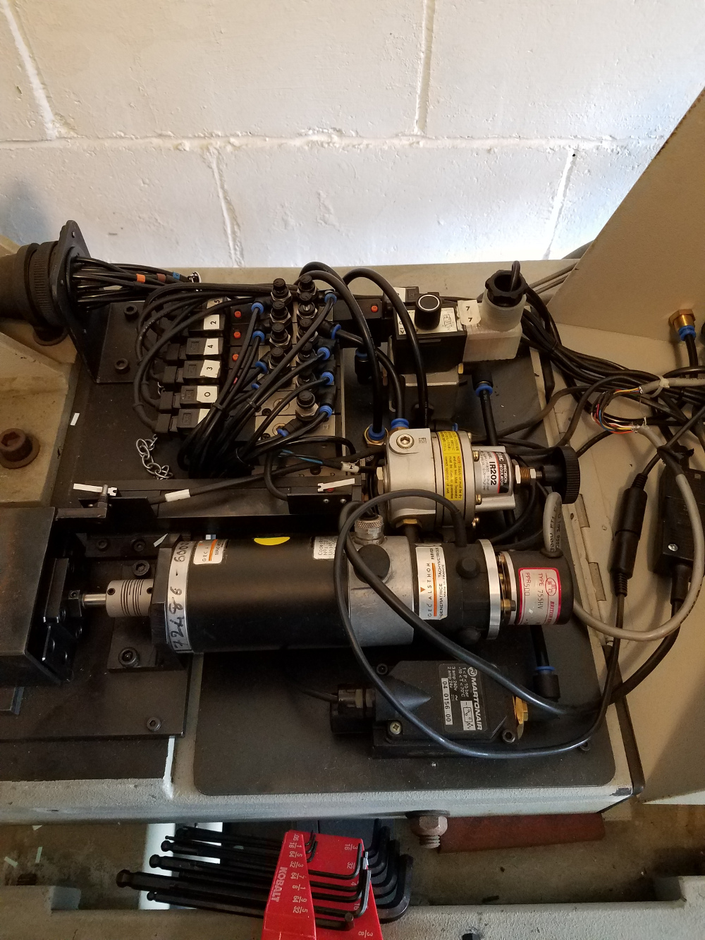

My CATRA Edge Retention Tester
While consulting for a knife manufacturer, I learned that they had recently replaced their CATRA edge retention tester because the old one had given them some problems. I asked if they could pay me with the old CATRA tester rather than with money. My wife was not happy when she learned how much money I gave up to instead take an old edge retention tester which may or may not work correctly. And that was before she learned how much space it would take up in the garage. However, I was very excited because a CATRA edge retention tester costs several 10’s of thousands of dollars and purchasing one was never going to be a possibility.
When I learned I would be getting the edge retention tester, I took just about every knife steel that I had and started heat treating a set of blanks for testing. That was just before Christmas. I then got the tester in mid-January and my excitement was tempered (amazing heat treating pun) a bit. Several parts of the machine were damaged in shipping and I was not sure if I would be able to get it working again. Among the parts of the machine I had to fix included:
- The air regulator was broken and needed replacing.
- The head of the machine was damaged and several parts needed to be straightened before it would function.
- The sensor that detects when it has run out of test media was no longer reading correctly.
- The sensor that detects forward and backward movement was not functioning.
- The sensor that detects whether the cardstock clamp is in position was not functioning.
- A couple circuit boards had come loose leading to improper readings.
- The software was not working and it needed a fresh install.
- Once all of those things were fixed and I was ready to run it for the first time, a “shaft coupler” decided to break. Then Amazon sent me the wrong one.
So fixing all of that took me about 45 days and a lot of yelling and swearing. The machine is surprisingly complicated but at the same time it performs a relatively simple task. A stack of paper stock with 5% silica (sand) in it is lowered onto a knife with a fixed load (50 Newtons) and the knife is moved back and forth. The knife cuts into the paper which allows the head to lower, the distance the head lowers is recorded for every “cut” of the knife. In other words, it records how much paper is cut with each stroke. After 120 strokes (60 back and forth “cycles”) the test is complete and the total amount of paper is added up, called the Total Cardstock Cut (TCC) reported in mm. You can see the tester running in the following video, which I recorded “vertically” because it was originally recorded for Instagram and also because I am a monster who holds his phone the wrong way while taking video:
The tester is pneumatic and the series of tubes and circuit boards used to operate the machine can be somewhat daunting at first, but again, most of what it is doing is lowering and raising a head with clamped cardstock and moving a knife back and forth. Technically any media of an appropriate size could be put in rather than the standard silica-impregnated paper but thus far I have only used the paper.
On the other hand, some components of the machine are simpler than I would have thought. The 50 Newton force is maintained by a big steel cylinder on top of the head of the machine. Also the paper comes loose as 10mm wide strips, and they must be stacked together by hand and inserted into the machine which is somewhat tedious.

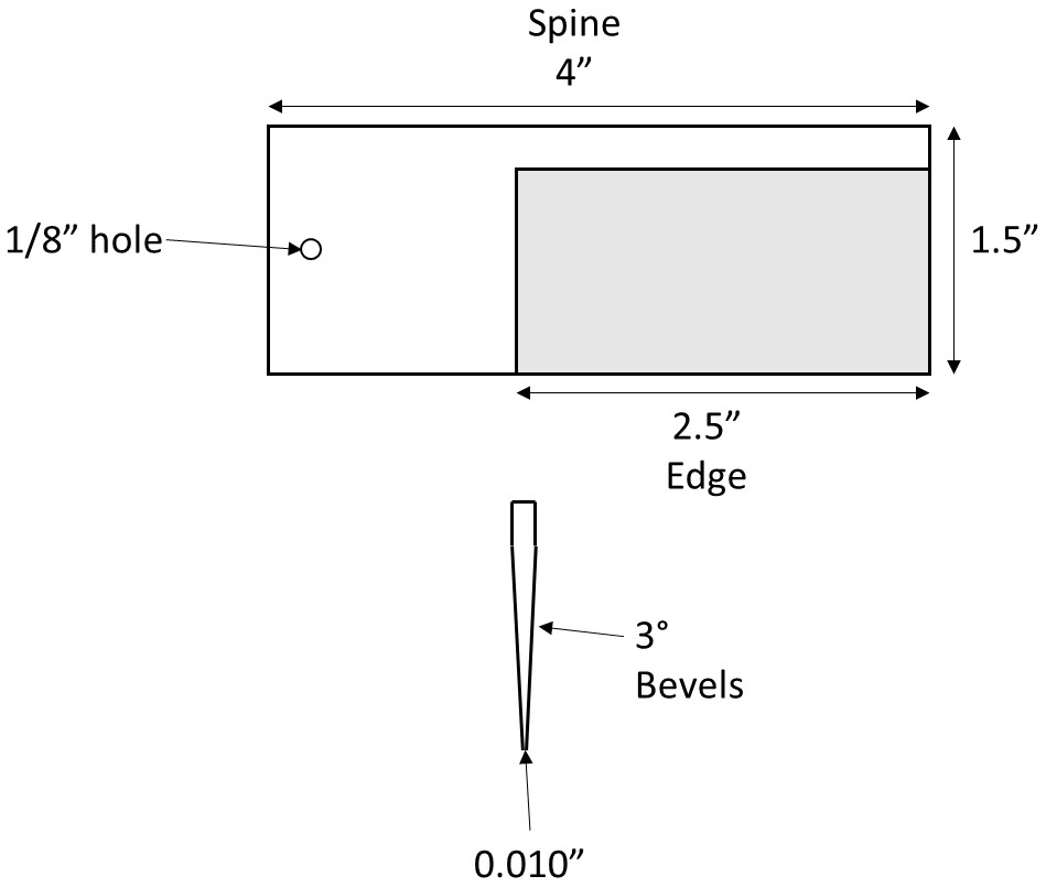

A knife edge retention tester in itself is not necessarily useful without a good set of experiments to perform on it. There have been other attempts at comparing the edge retention of different steels in the past. For example, Bohler-Uddeholm did a set of CATRA experiments on 11 different steels: BU CATRA. There were also big CATRA datasets I wrote about in the previously linked articles. And rope cutting experiments have been done by many people. There were several things I wanted to do to generate the best test results I can. One is using a consistent knife design to eliminate the effects of different edge geometries and knife designs. For example, many of those reporting edge retention experiments are limited to what knives are commercially available which means they have little control over heat treatment and edge geometry. Using different edge geometries in particular makes comparisons about steel or heat treatment almost impossible. For example, here is the difference in measured edge retention for 154CM with different edge angles:
The edge angle can be relatively easy to change with sharpening. However, thickness behind the edge, the angle of the “primary bevel” behind the edge, and the shape of the edge can all affect the result. And different knife companies will heat treat steels to different hardness levels using different heat treatment parameters such as some using cryogenic processing and others not. So I decided to make a simple test knife design which utilizes a rectangular shape (straight edge so curves do not affect cutting) with a consistent primary bevel and edge thickness. Keeping the primary bevel the same means that steel of different thickness can be used, only the height of the primary bevel changes based on the stock thickness.
The test uses a 40mm cutting distance, so the 2.5″ (65mm) provides some extra edge so that the position of the knife doesn’t have to be 100% precise and so that the ends can be avoided which are sometimes a bit more difficult to sharpen. The 1/8″ hole was used for convenience such as to thread wire through before dipping in liquid nitrogen in the heat treatment process. After I heat treated and surface ground all of the blanks, I shipped them to knifemaker Shawn Houston of Triple B Handmade (Big Brown Bear) who ground the bevels and put the initial edge on the knives. We sharpened the knives to 30° (15 dps). To maintain precise angles, an Edge Pro was used and the resulting angle was checked with a laser goniometer.

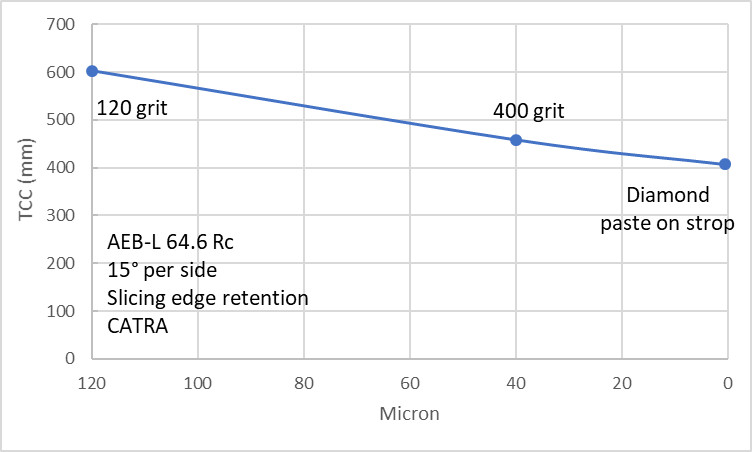

We decided on a 400 grit (40 micron) “metallic bonded” CBN stone, meaning the CBN abrasive is throughout a metallic matrix rather than a CBN coating over a plate. Using bonded CBN rather than abrasive on a plate makes it cut more like a traditional stone whereas diamond and CBN plates tend to leave deeper scratches [1]. A relatively coarse 400 grit was chosen because, when slicing, a coarser finish leads to superior edge retention due to the “micro-serrated” nature of the edge, a fact which has been pointed out by many people performing tests when slicing materials like rope, such as Cliff Stamp [2], Jim Ankerson [3], and Phil Wilson [4]. However, the previously linked 154CM article found a peak in edge retention with a 600 grit diamond plate, with reduced edge retention using a lower 325 grit or higher grits like 1200 or 8000. This was somewhat puzzling and perhaps was due to the relatively poor sharpness that can result from very coarse diamond plates like the 325, or deburring challenges from such a coarse stone. I tested the effect of the degree of polish with tests of an AEB-L knife with a 120 grit metallic bonded CBN, the 400 grit we ended up using, and then polished up through 0.5 micron diamond paste on a strop. The edge retention was reduced with higher levels of polish. I plotted vs micron rather than grit because of the many different grit systems which leads to more confusion than anything.
So a 400 grit stone was chosen to use a finish which is more optimized for slicing without going crazy with something very coarse like 120 grit which is somewhat unlikely to be used by most knife owners. Unlike when slicing, with push cutting, a higher polish is superior because of the higher potential sharpness and the reduced resistance when pushing the knife through the material. The use of very hard CBN (cubic boron nitride) helps when sharpening steels with high hardness carbides like vanadium carbide which are harder than aluminum oxide, the most common abrasive used in sharpening stones.
The resulting sharpness was checked with the Edge on Up tester to ensure the knife was measured as no higher than 150g with the BESS media. This test is not perfect for our purposes since we are testing edge retention with a slice but the sharpness is measured with a push cut. However, the BESS tester helped with ensuring the sharpness was relatively consistent between knives and across an edge of an individual knife. Also, when burrs were present this generally resulted in reduced sharpness on the tester, and those burrs were not always noticed when feeling the edge or slicing paper.

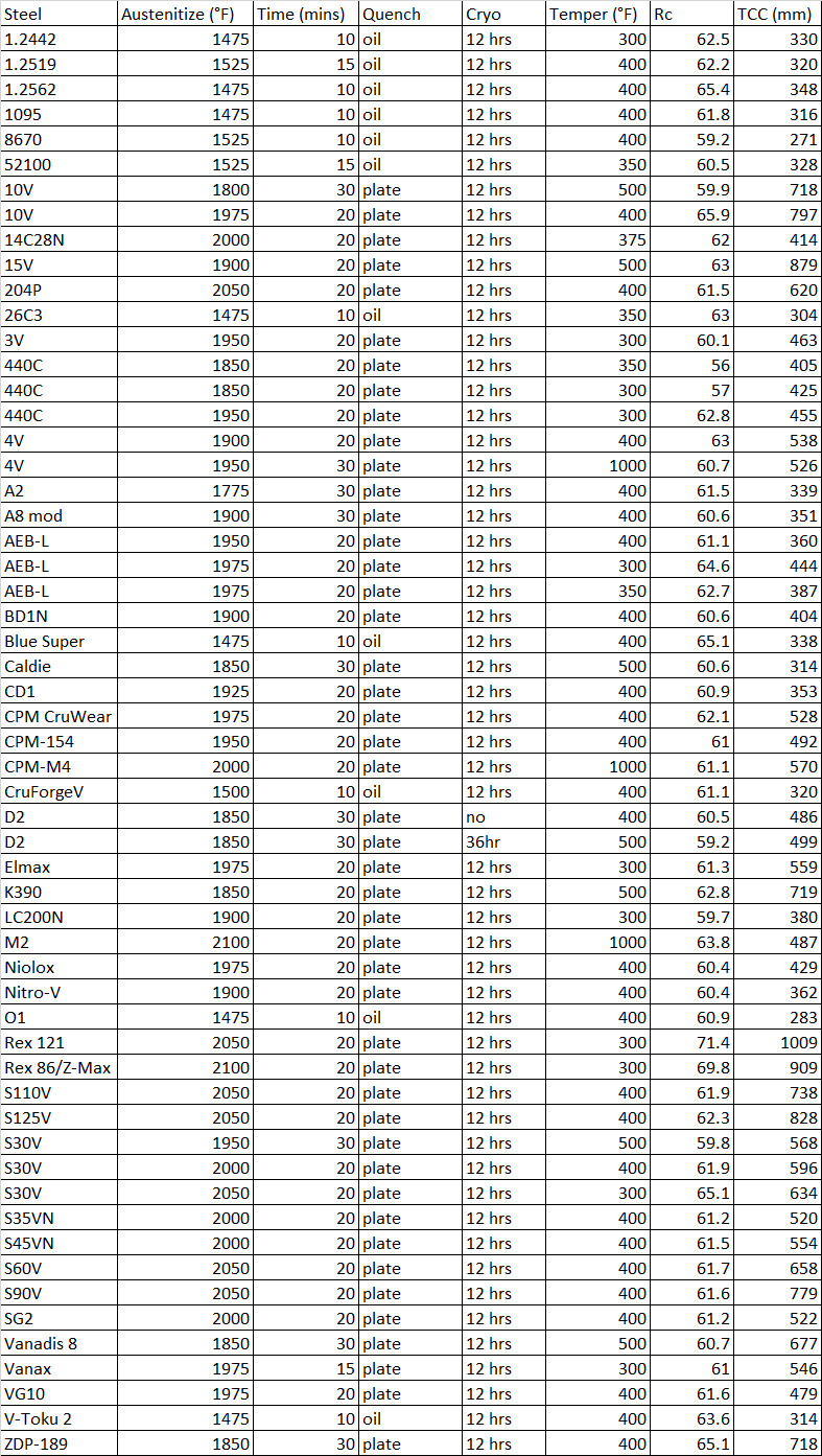

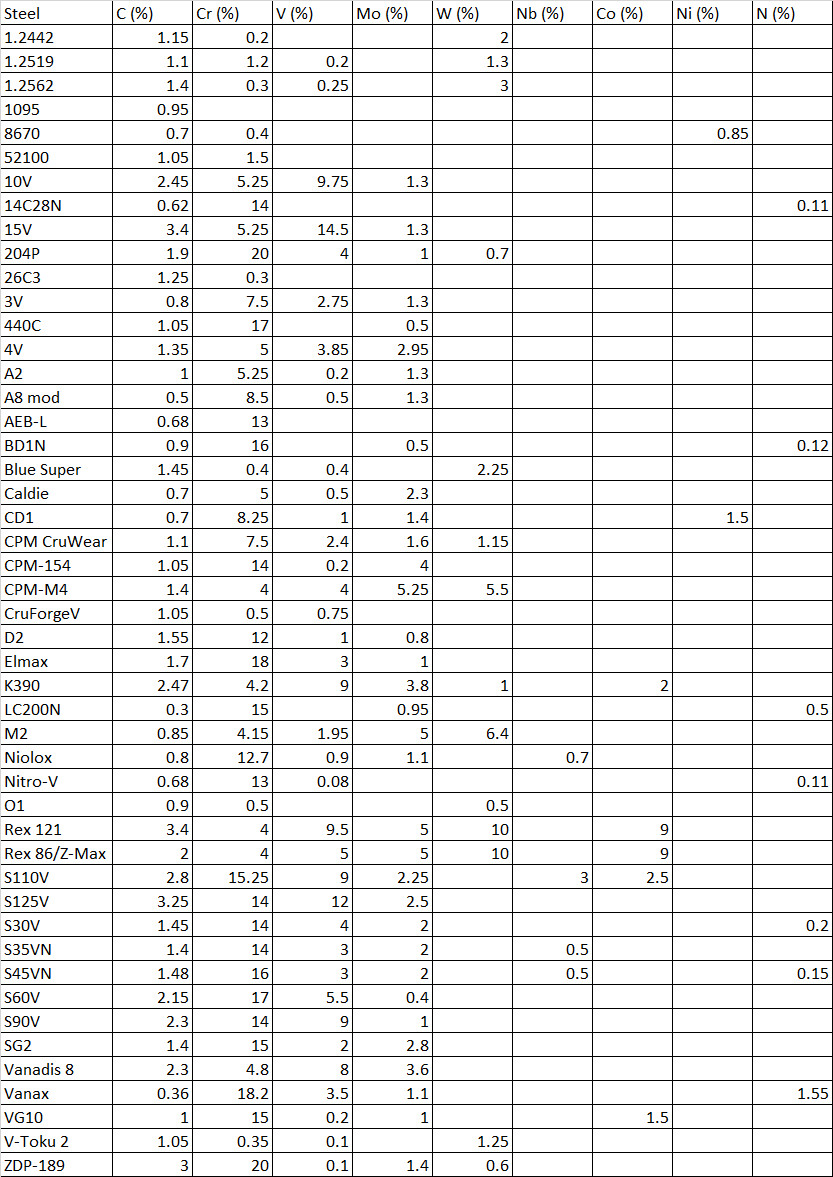

Below shows a chart summarizing all of the steels and heat treatments which were utilized, along with the measured edge retention on the CATRA tester in mm. All of the steels were given a cryo treatment after quenching except for one D2 knife which was made to compare the effect of cryo. All of the low alloy steels were quenched in Parks 50 oil and all of the high alloy steels were “plate quenched” between 1″ thick aluminum plates. A plate quench is a bit faster than cooling in air (despite the steels being “air hardening”) and the plates help keep the steel flat. I was targeting 61-62 Rc for most of the knives apart from a few that are basically never used at that hardness, such as ZDP-189, Rex 86, Rex 121, 1.2562, and Blue Super. Because my experience with heat treating each steel varies, and there is always some variation in hardness, the resulting hardness for most steels was between 60 and 63 Rc.
See the following chart with temperatures in Celsius instead here

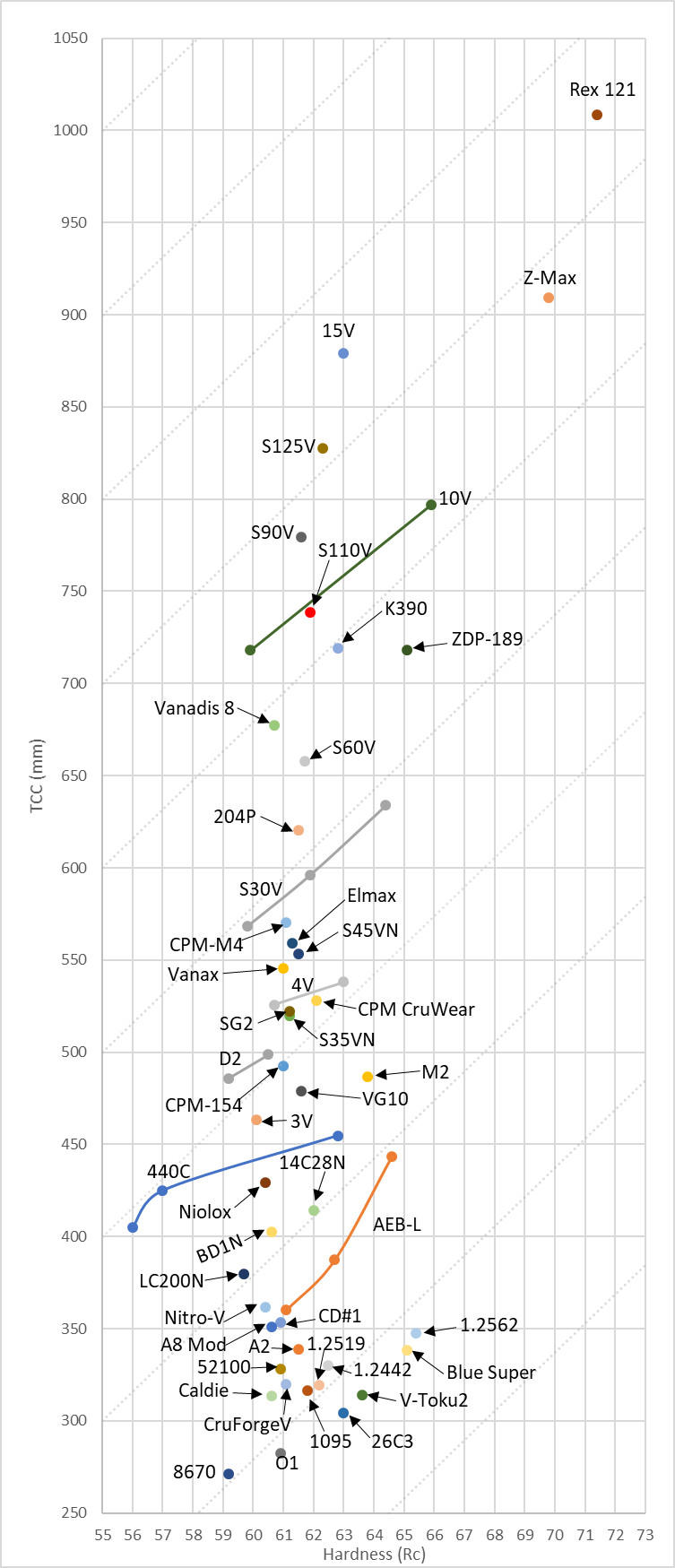

And for an easier view of the relative edge retention of each steel I have a chart below. For the steels which were tested at multiple hardness levels I have dots connected by lines. The chart also has dotted lines which represent the expected effect of hardness (higher hardness means better slicing edge retention), so that steels can be compared at different hardness levels. This value came from a previous article where an average difference of 15.8 mm paper cut per 1 Rc was found. Some steels deviated from that expected hardness contribution a bit which will be discussed in the effect of heat treatment section.
In general, I didn’t test steels which have identical composition, so 204P represents values of M390 and 20CV as well. Vanadis 4 Extra is slightly different than CPM-4V which may be a borderline case but I didn’t have any Vanadis 4 Extra so that made that decision easier. For many steels they may have multiple names despite being identical such as PD#1 and Z-Wear being the same as CPM CruWear. Rex 86 is the same as Z-Max. LC200N is the same as Z-Finit and Cronidur 30. CPM-154 is the same as RWL-34. AEB-L is the same as 13C26. CD#1 is the same as Z-Tuff. ZDP-189 and Cowry-X are very similar. There are probably others I’m forgetting but hopefully that’s enough for now.

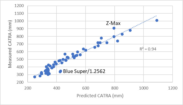

In previous articles I generated this regression equation based on the contribution of edge angle, steel hardness, and volume of each carbide type. I also included tables with carbide contents of a range of different steels in Part 1 and Part 2.
TCC (mm) = -157 + 15.8*Hardness (Rc) – 17.8*EdgeAngle(°) + 11.2*CrC(%) + 14.6*CrVC(%) + 26.2*MC(%) + 9.5*M6C(%) + 20.9*MN(%) + 19.4*CrN(%)
Based on the hardness of the carbides I also said that I expected iron carbide, called cementite (M3C or Fe3C), to have a contribution of about 5, ie 5*M3C. Here is the result of that prediction equation vs what was measured in this study:
The trend is very good, with the biggest deviations being Z-Max (high) and Blue Super and 1.2562 (low). I will address these along with other small deviations below.

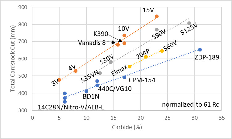

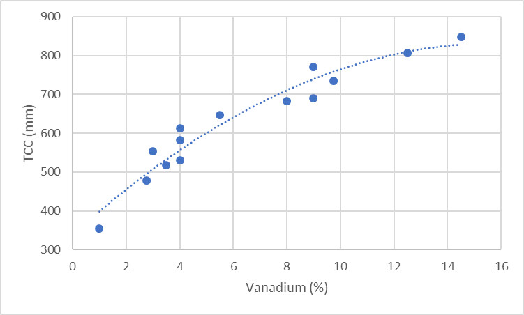

As I explained in the previous CATRA articles, the performance of each steel is highly dependent on the amount (volume) and hardness of the carbides. Here is a summary chart of different carbide types:
Measuring the hardness of carbides is difficult experimentally and some sources vary. For example, I have seen some papers report a hardness of 1800 Hv for M6C rather than 1400, which might be a better result as I will discuss below.
In general, steels with higher vanadium did better, as expected. Vanadium carbide is very hard so it contributes to wear resistance and edge retention very strongly. These values are normalized to 61 Rc by using the 15.8*Rc regression.
The above is for a range of vanadium-alloyed steels including stainless and non-stainless tool steels. It is somewhat surprising that they end up trending so well vs vanadium content because the overall carbide content in each steel can be pretty different. For example, the 17-20% chromium stainless steels need significantly more carbide for the same level of wear resistance as the 5% Cr steels. This is significant for toughness as is discussed in the toughness-edge retention balance section.
And again with the steel names listed for each datapoint:

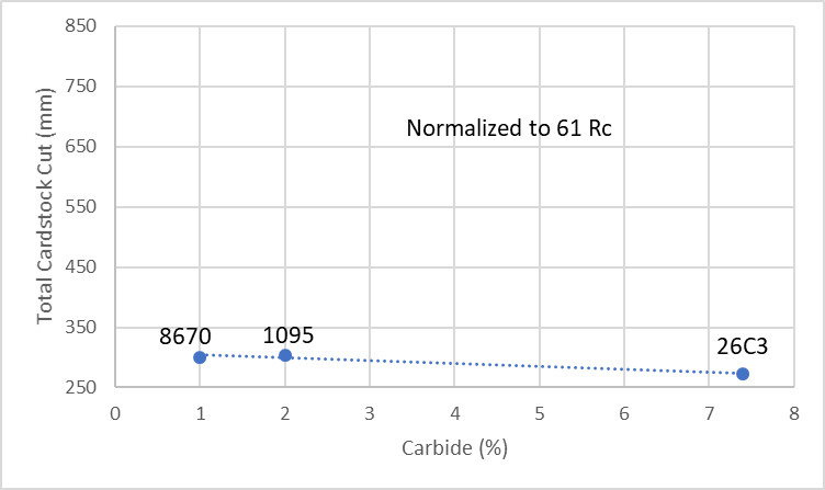

For low-alloy steels at the bottom of the chart, they have cementite (iron carbide) rather than chromium or vanadium carbides. In that case there was no trend with increasing carbide content. If anything it was slightly negative:
I don’t think the cementite is actually reducing edge retention. It is more likely that the negative trend is random within the variation inherent in the test. However, it is a bit puzzling that the cementite isn’t contributing to edge retention at all. Many sources show silica as being higher in hardness than cementite [5]. It could be that with the cementite being softer than silica that the cementite is not improving edge retention. With a different test media it may be that more differentiation would be found between the cementite-containing steels. The relative position of the low alloy steels wouldn’t change much vs other steels, however, as the softer carbide still contributes less to edge retention. Currently most of the low-alloy steels seem to be affected only by the bulk hardness of the steel rather than carbide content. This would be my guess as to why O1 tested a bit lower than 1095; the two steels probably perform similarly but due to experimental variability or some small unknown factors the O1 slightly underperformed.
Another point in favor of the hypothesis that cementite is softer than silica is the fact that 52100 performed a bit better than most of the other low alloy steels. The 1.5% chromium addition to 52100 does not lead to the formation of chromium carbide, but does lead to a hardness increase of the cementite by partially replacing the iron in cementite with chromium [6]. Perhaps it was enough to make the cementite harder than the silica in the paper. I may try to use rope or cardboard in the CATRA machine in the future to test this further. The sand abrasive in the paper is useful in that it speeds up tests by dulling edges faster, using a natural abrasive that is found in some materials people cut with some regularity (such as rope or animal hide). However, using different test media may lead to somewhat different results in certain scenarios; low alloy steels with cementite may be one of those, we will see. Evidence against this hypothesis includes the fact that 1.2519, with its 1.2% Cr did not perform as well as 52100. Perhaps the extra 0.3% Cr in 52100 was enough to make a difference. Or maybe the 1.2519 is a bit better than some of the others but happened to test on the low end in terms of statistical variation in testing.

1.2562 and Blue Super
While on the subject of low-alloy steels, 1.2562 and Blue Super with their relatively high tungsten content didn’t do quite as well as I expected. These steels form the high hardness WC tungsten carbide which isn’t found in other high alloy tungsten steels like high speed steels. I thought they would do closer to the 400-450 mm range based on reports of wear resistance of the similar F2 steel in the old Tool Steels book. There are a few possible reasons for this. 1) Tungsten is a very heavy element so even 3% tungsten only results in a little under 2% WC. 3V with its 2.75% vanadium instead has about 5% VC. 2) The tungsten carbides observed in the micrographs of Blue Super and 1.2562 were relatively large and widely apart from each other, so perhaps the carbides were so dispersed that they did not consistently contribute to the edge. 3) A significant amount of the carbide in these steels is cementite which didn’t seem to contribute at all to edge retention in this test as described above.

Z-Max did a bit better than predicted when looking at the edge retention predictions based on carbide content. The dataset used for those predictions had very few high speed steels which is also the case with this dataset. It could be that the M6C (tungsten/molydenum carbides) present in high speed steels contribute more to edge retention than previously found. This could indicate that M6C hardness measurements on the upper end are more accurate (1800 vs 1400 Hv).

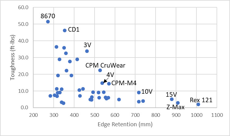

Steel Toughness
It is a mistake to look only at edge retention for steel choice. For one thing, steel is not even the greatest controlling factor for edge retention. After all, sharpening in terms of grit finish and edge angle have a greater effect on performance than steel choice. However, even when holding sharpening constant there are other important properties, such as toughness, ease in sharpening, corrosion resistance, etc. When comparing steels I like to look at the balance between toughness and edge retention, as those are two very important properties that are often opposed to each other. I have tested the toughness for all but 7 of the steels: Z-Max, BD1N, K390, S125V, S90V, S60V, and Vanadis 8. Below you can see a summary of previous toughness measurements.
Does Toughness Matter?
Some will argue that toughness is not important in folders or fine slicing knives and feel that only edge retention matters in that case because they don’t use their knives in aggressive ways which are likely to lead to chipping. However, broken tips are still common on small knives and kitchen knives. And with higher toughness, the knives are better able to handle thin, low angle edges without chipping. And they can be heat treated to higher hardness to help prevent edge rolling and deformation, while still maintaining good toughness. This means that, indirectly, higher toughness can lead to better cutting performance because of the possibility of thinner edges. You can read more about this concept in this article on edge stability.
I took the measured toughness for each steel and shifted the values slightly based on the hardness differences between the toughness and edge retention specimens. I also used the toughness value of Maxamet for Z-Max despite being different steels because they are in a similar class of steel and the very high hardness steels don’t vary much. If you think that is an invalid assumption then you can ignore anything labeled Z-Max.
Non-stainless vanadium-alloyed powder metallurgy tool steels often have the best balance of toughness and wear resistance because having vanadium carbide alone (rather than other carbide types) leads to superior properties. Greater amounts of carbide means lower toughness, while the hardness of carbide has little or no effect on toughness. However, harder carbides contribute more to edge retention for a given amount of carbide. Therefore, having only hard vanadium carbides leads to the best level of toughness for a given level of wear resistance/edge retention. This can be seen in the previous charts showing that the steels with only vanadium carbide have higher edge retention for a given amount of carbide. The following diagram shows the steels with the best balance of toughness and edge retention. The only steel which isn’t a low-chromium vanadium-alloyed powder metallurgy steel is 8670 which has very high toughness but relatively poor edge retention.
We don’t have any toughness testing of 4V in the 61-62 Rc range so I think the toughness could be a bit higher than what is shown here. However, you can see why steels like 3V, CPM-CruWear, and 10V have been so popular given the high level of toughness each has for their level of edge retention.

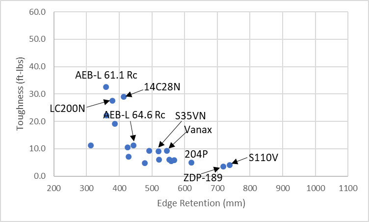

Stainless Steel
If we remove the non-stainless steels and look at stainless alone, the toughness-wear resistance balance is in general a bit lower. Stainless steels aren’t inherently worse but the high corrosion resistance requirement puts restrictions on steel design that are difficult to overcome. Unfortunately, we don’t have toughness values for S60V, S90V, or S125V, so the upper end of edge retention isn’t well represented in the chart.
AEB-L, 14C28N, and LC200N have a pretty decent edge retention-toughness balance though at relatively low levels of edge retention. There is then a big drop in toughness down to the rest of the stainless steels which seem to top out around 10 ft-lbs. There is a hole in available stainless steels in terms of steels with toughness in the 15-20 ft-lbs range with enhanced edge retention compared with AEB-L and LC200N.
The value of toughness listed for 204P/M390/20CV is a bit lower than has been shown in charts in previous articles, which is based on more recent toughness experiments. I will be writing about that more in a future article.
Vanax has a pretty good edge retention-toughness balance while also having excellent corrosion resistance, as does LC200N. The only disadvantage of those steels is it is difficult to heat treat them harder than 60-61 Rc and even getting that hardness can be challenging. It is also difficult to avoid high levels of retained austenite when heat treating them. S35VN, 14C28N, and AEB-L are easier to heat treat and can reach higher hardness levels (63+) if that is desired over the higher corrosion resistance. With the somewhat better edge retention of 14C28N compared with AEB-L, similar toughness, and better corrosion resistance, it may be my new favorite in that range of edge retention.

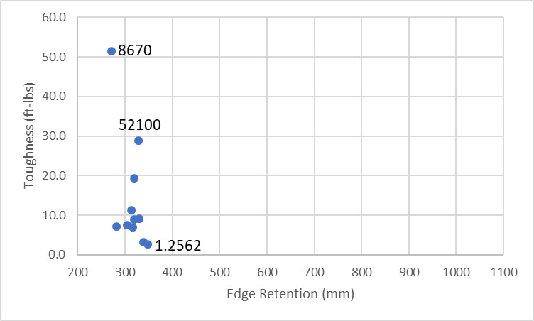

Low Alloy Steels
Low alloy steels typically used by forging bladesmiths can have good toughness but the wear resistance and edge retention is relatively low due to the lack of hard carbides. 8670 is a good choice for high toughness and 52100 has a decent balance of toughness and edge retention. At this point I haven’t measured enough of an improvement in edge retention with the vanadium/tungsten-alloyed steels like 1.2519, CruForgeV, 1.2562. Blue Super, 1.2442, etc. to recommend them over 52100. However, 1.2562 is the best that has been tested so far, with Blue Super being pretty similar.

In general I didn’t do anything too fancy with heat treating, I used pretty standard heat treatments to target the desired hardness. However, there were a couple heat treatment variables that we did look at.
Austenitizing Temperature
In general, a higher austenitizing temperature leads to more carbon in solution and higher hardness. You can read about that here. However, you can often use a lower tempering temperature to achieve the same hardness with a lower austenitizing temperature. So that austenitize-temper decision can affect the final properties in terms of toughness and edge retention even when at the same hardness. In general, I didn’t change the austenitizing temperature much when comparing the same steel at different hardness so the trend of hardness vs edge retention looks about right for steels like S30V and 10V. However, 440C shows lower than expected edge retention at the high hardness level. This may be because of the 100°F higher austenitizing temperature which leads to more carbide dissolution. Less carbide means lower edge retention as discussed ad nauseam in this article so far. In the case of 10V there was a 175°F difference between the two heat treatments, but vanadium carbide dissolves much more slowly over a wider temperature range than chromium carbides like in 440C. I may do more experiments on specific steels in the future looking at the effect of austenitizing temperature. You can read more about the austenitizing step in heat treating in these articles: Part 1, Part 2, and Part 3.
Tempering Temperature
We compared CPM-4V with a temper of 400°F and 1000°F. You can read about these two different tempering regimes in this article on tempering. Some have claimed that the alloy carbides that form in tempering at 1000°F lead to improved edge retention. However, those alloy carbides are extremely small and I have assumed they play little or no role in edge retention. With Uddeholm’s testing of the similar Vanadis 4 Extra with wear resistance testing, they found no difference between low and high tempering when compensated for hardness [7]:
In our case we had a bit higher hardness with the low temper of 4V but the edge retention was only slightly better, perhaps indicating that the 1000°F led to better edge retention for a given hardness. However, this was only one test, and looking at the scatter in the results above you could conclude either low or high tempering is superior based on which two points you choose. Another factor is that a significantly lower austenitizing temperature would be required for the 400°F condition to achieve the same hardness as the 1000°F, at which point the edge retention may be identical because less carbide would be dissolved at the lower austenitizing temperature. But based on this result it could be that slightly higher edge retention is possible if using a 1000°F temper. However, we have seen relatively large improvements in toughness by using 400°F tempers with CPM CruWear and CPM-4V which I think makes the low temper more desirable.
Cryogenic Processing
I have written extensively about cryogenic processing in these articles: Part 1, Part 2, and Part 3. Part 3 is the most relevant to this discussion as it covers differences in wear resistance from cryo. There are occasionally outlandish claims about the effects of cryo on wear resistance, like 6.5x the wear resistance just by using a cryo treatment. A cryo treatment can reduce retained austenite and increase hardness somewhat which can improve edge retention. But some claim other effects like an increase in carbides which are not likely given the cryogenic temperatures involved. Certainly nothing to the extent of 3x or 6.5x improvements in wear resistance. In the CPM-154/154CM CATRA article we compared cryo vs non-cryo and no difference was found, but that was with high temperature tempering (~1000°F) which some claim does not result in an improvement from cryo.
In this study I chose D2 steel because it has had more cryo research done on it than any other steel. And there is one particularly influential article that found that a 36 hour cryo treatment led to the best improvement in wear resistance [8]. This article has led some to claim that cryo is time-dependent and that there is an optimal time for different steels. So I compared a non-cryo D2 to a 36 hour cryo. I tempered the cryo steel a bit higher (500 vs 400°F) to try to get the hardness the same but ended up overshooting and the cryo knife was actually softer. But if the cryo led to a 3x increase in wear resistance a 1.3 Rc difference should be easily overcome. In this case the non-cryo knife had somewhat superior edge retention because it was somewhat harder. In my Part 3 article I concluded that those cryo articles “are not very convincing” when talking about wear resistance improvements and after doing a study myself I am even less convinced.
