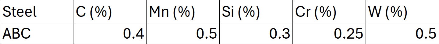

However, “non-tempering” steels actually go back even further than Atlantic 33. The earliest I found was the steel “ABC” made by Darwin and Milner starting in 1909 [3][4]. This steel company was run by Paul Kuehnrich who developed several tool steels including D3 and D5 (later slightly modified to be the common D2 in 1928). He was an early pioneer in tool steel who I wrote about in my book The Story of Knife Steel.

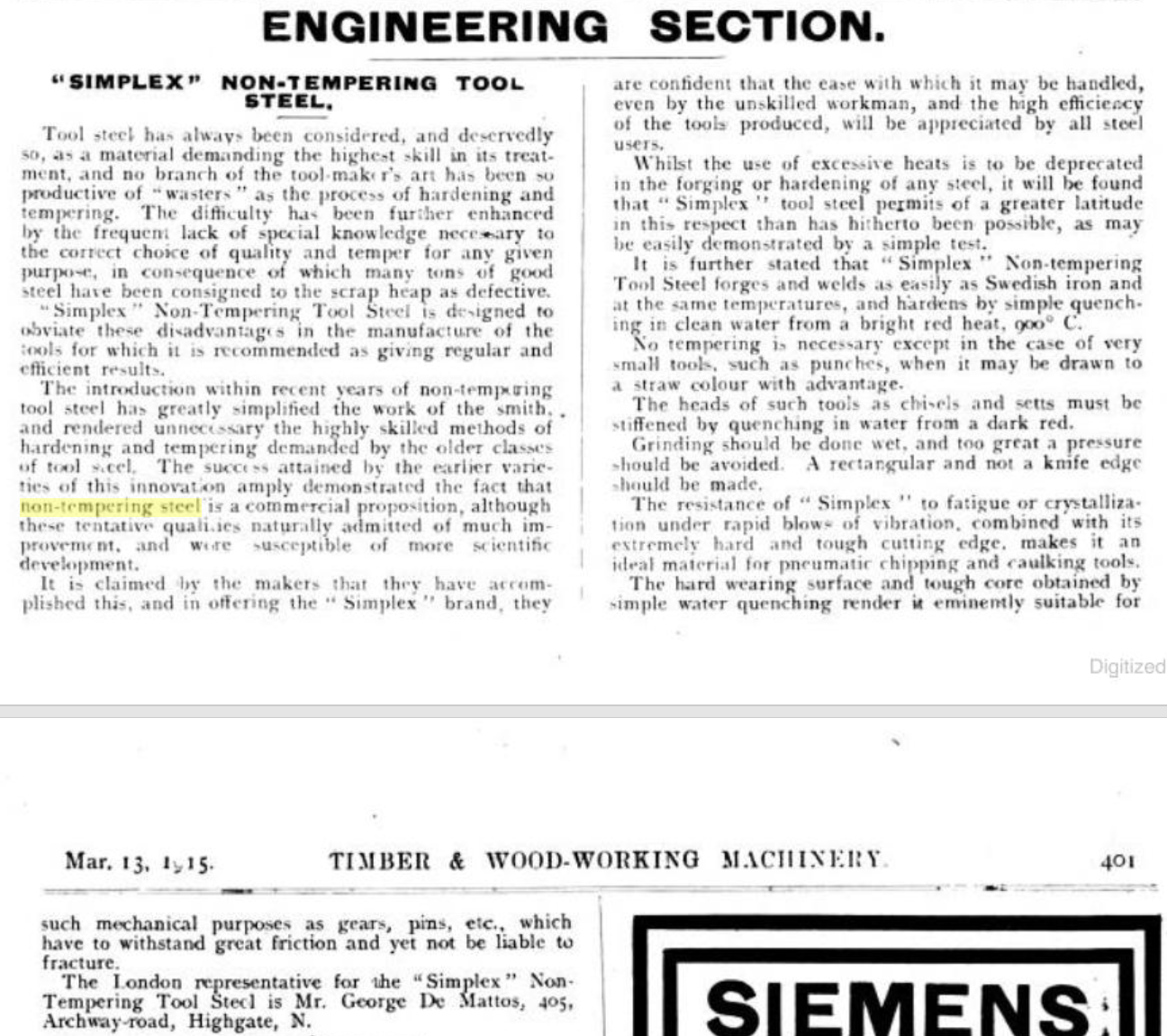

Another early non-tempering steel I found was called Simplex which in 1915 had some advertising which uses a lot of language similar to what we still see for Atlantic 33:

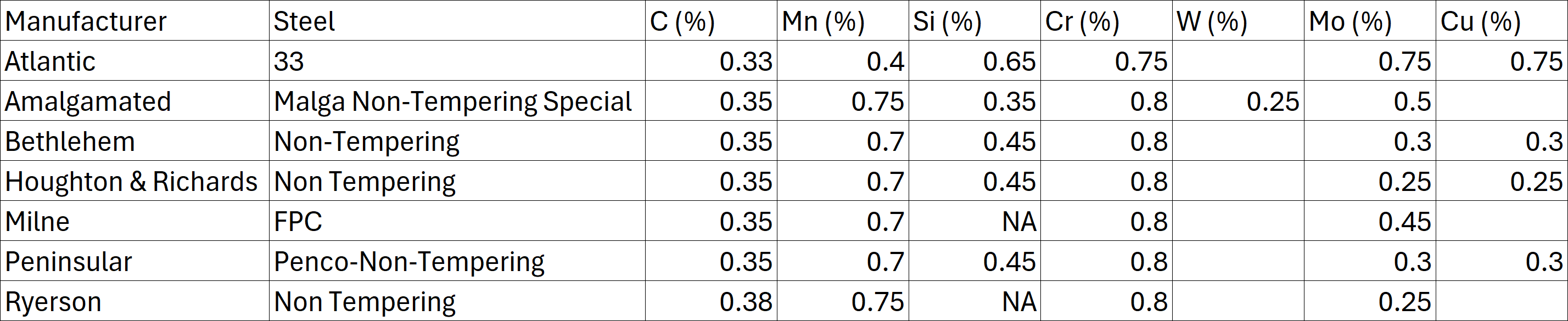

Composition of Atlantic 33 and Other Non-Tempering Steels
There were several other non-tempering steels that would be released over the following years though they never gained much prominence. Here are several that were available in 1954 [5]:
You can see that all are medium carbon, roughly 0.3-0.4%. Each has a chromium addition and either W or Mo (including the original ABC). There is also a Cu addition in some of them. The reason for the copper addition is somewhat of a mystery. Copper additions are not unheard of but are relatively uncommon in low alloy steels, especially back in the 1930s. Copper can help with grain size control from copper precipitates but I have no insight into the 1930s thought process by Atlantic Steel. In any case there were several non-tempering steels without any copper so it does not seem to have been necessary.

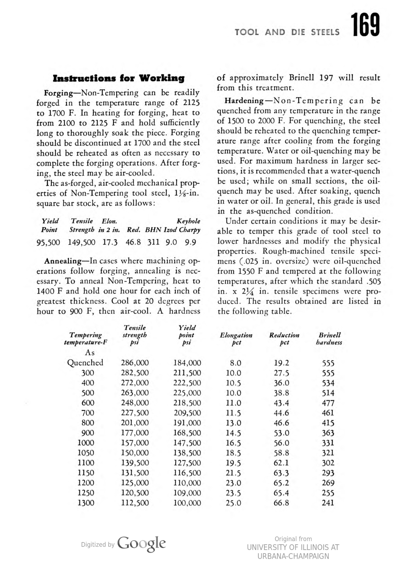

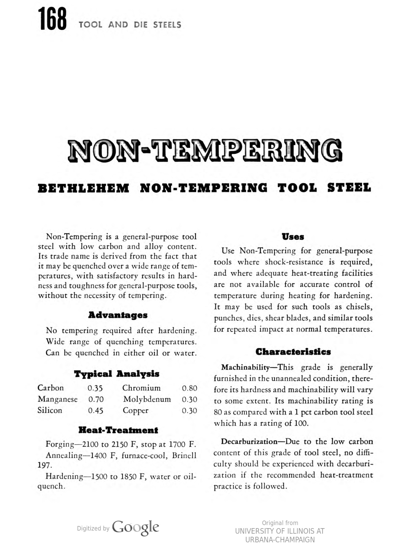

I did not find a datasheet for Atlantic 33 but I did find heat treating information for Bethlehem’s similar “Non-Tempering” steel from 1958 [8].
Forging and Annealing
The forging temperature range recommendation is pretty standard, 2100-2150°F (1150-1175°C) and finish at 1700°F (925°C).
The datasheet says annealing is recommended if machining will be performed after forging. It says to start at 1400°F (760°C) and cool at a very slow rate of 20°F/hr (11°C/hr) to 900°F (480°C). It is pretty standard for datasheets to recommend such low cooling rates.
It is somewhat strange they recommend such a specific procedure for annealing given the intention of the steel is simple heat treating setups. The steel could be annealed by heating to nonmagnetic and putting in slow cool media like vermiculite.
Normalizing?
There is no mention of normalizing in the Bethlehem datasheet. Perhaps with the low carbon content they were less concerned about it. If you do normalize, the similar 4135 steel has a pretty typical 1600°F (870°C) normalizing temperature.
Austenitizing Temperature
One of the selling points for the steel being viable for simple heat treating setups is that it can be quenched from a range of austenitizing temperatures and still have decent properties. The extra alloy added to the steel helps it resist grain growth, thus having decent toughness even with relatively high austenitizing temperatures. However, perhaps we shouldn’t over-exaggerate this point too much. There is a small drop in toughness and ductility, and a small increase in grain size by austenitizing hotter than the optimal range, which appears to be about 1500-1600°F (815-870°C), see page 170 above. 4135 is typically austenitized at 1600°F (870°C) which is consistent with those results. The steel is relatively insensitive to overheating but if using a furnace I would stick with that range.
Quenching
This is typically an oil hardening steel. Tool Steels by Roberts [6] recommends using water if the cross-section is larger than 2-1/2 inches in diameter.
Tempering Temperature

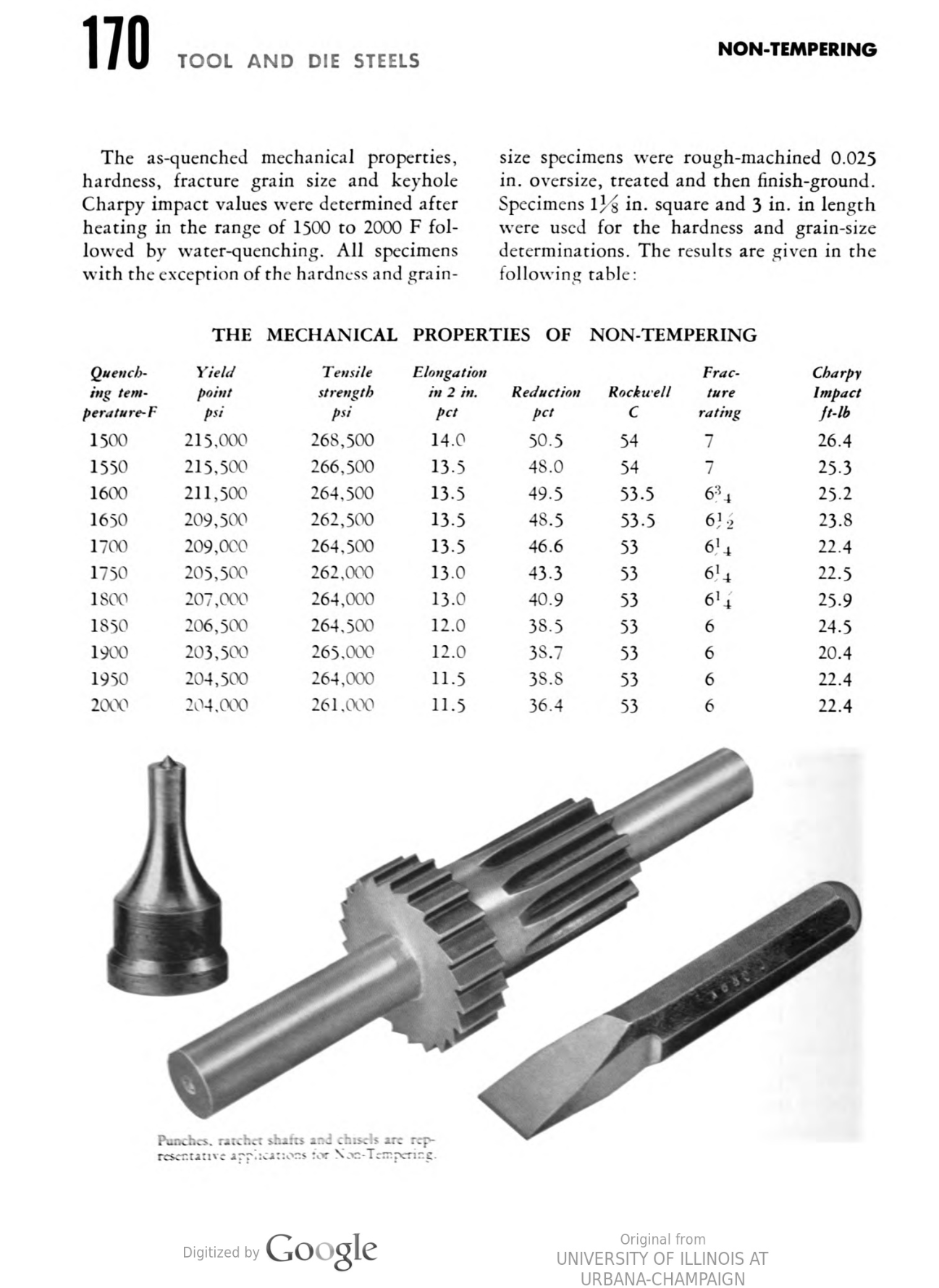

While the steel is advertised as “non-tempering,” you can see on the page 170 chart the effects of tempering. Comparing “As-quenched” (not tempered) to 300°F (150°C) you can see that the low temper leads to the same hardness (555 Brinell or about 54 Rc), but an increase in yield strength, as well as elongation and reduction in area (measures of ductility). Increasing the tempering temperature to 400°F provides a further increase in yield strength, elongation, and reduction in area at the cost of a little hardness (~1 Rc). So unless I was in a big hurry I would probably still temper these “non-tempering” steels in the range of 300-400°F.
