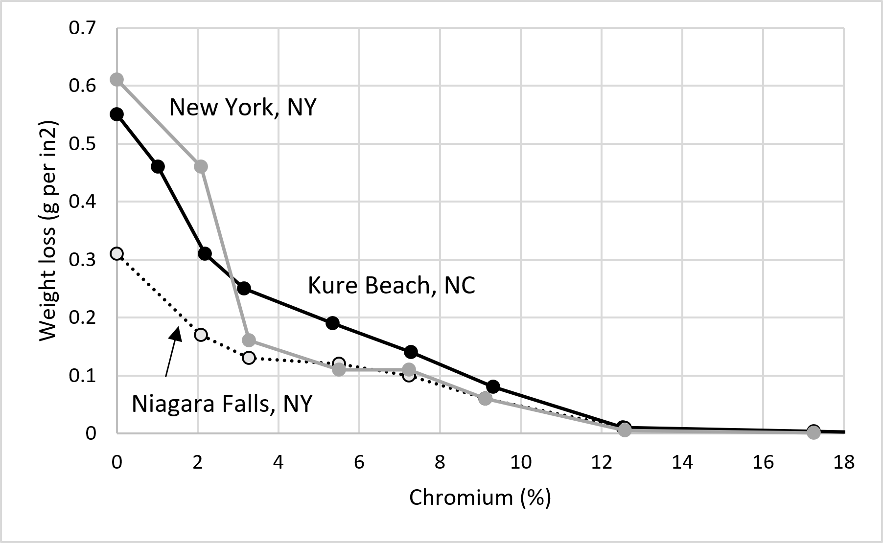

When iron is in a corrosive environment it forms rust – an iron oxide. If you add chromium to iron, the corrosion resistance is increased the more chromium you add. The chromium forms with oxygen to make a passive film at the surface which prevents rust from forming:
The following chart shows an old classic study [1] of corrosion rate of steel in high humidity environments. You will see that the corrosion rate went down with increasing chromium until about 12% Cr. Sometimes the cutoff for a steel being “stainless” is given as 10.5, 11, or 12% chromium. There isn’t any real agreement as far as I can tell. But corrosion resistance will increase with even greater amounts of chromium; it isn’t an on/off after some arbitrary cutoff.

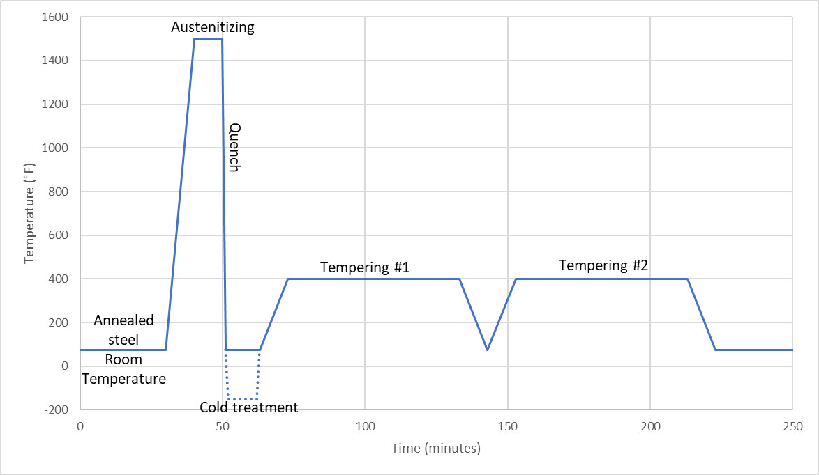

In the annealed (soft) state stainless steel is not yet stainless. When a knifemaker or manufacturer receives steel it is in this annealed condition so it is easy to drill, grind, machine, etc. Most of the chromium is in the form of carbides in the steel. When the chromium is tied up with carbon as a carbide it cannot form the chromium oxide layer at the surface.
There are three major steps to heat treating: austenitizing, quenching, and tempering.

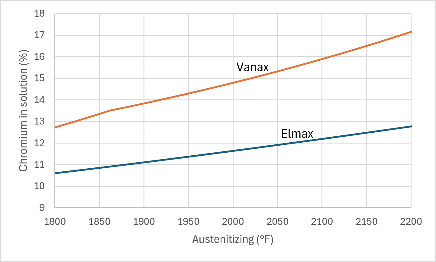

During austenitizing the steel is heated up to a high temperature and then held, allowing the chromium carbides to be dissolved (or partially dissolved) to put more chromium in solution so that the chromium oxide passive layer can be formed. Below shows the increase in chromium vs austenitizing temperature for Elmax and Vanax:
So one of the key variables for corrosion resistance is the austenitizing temperature because heating it hotter means more chromium in solution. However, the amount of chromium in solution is also controlled in part by the composition. The chromium in solution for Elmax at a very high temperature of 2200°F (the datasheet recommends no higher than 2010°F) is still below Vanax when it is austenitized at 1800°F (well below what the datasheet recommends). Austenitizing at a higher temperature also leads to increased hardness, so in that way higher hardness can sometimes mean improved corrosion resistance.

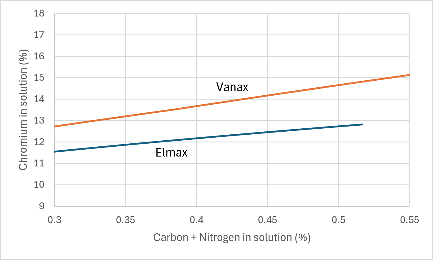

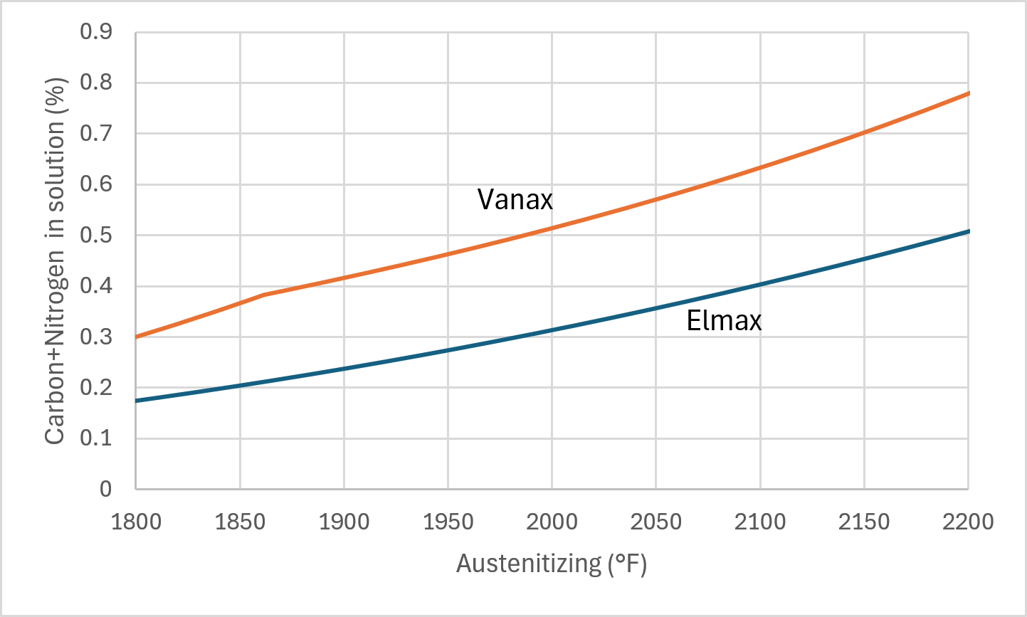

With higher austenitizing temperatures and more carbide being dissolved, this does not only put more chromium in solution but also more carbon, as seen in this chart of Vanax and Elmax. Or in the case of Vanax, I included the carbon and nitrogen, since nitrogen also contributes to hardness in a similar fashion to carbon.

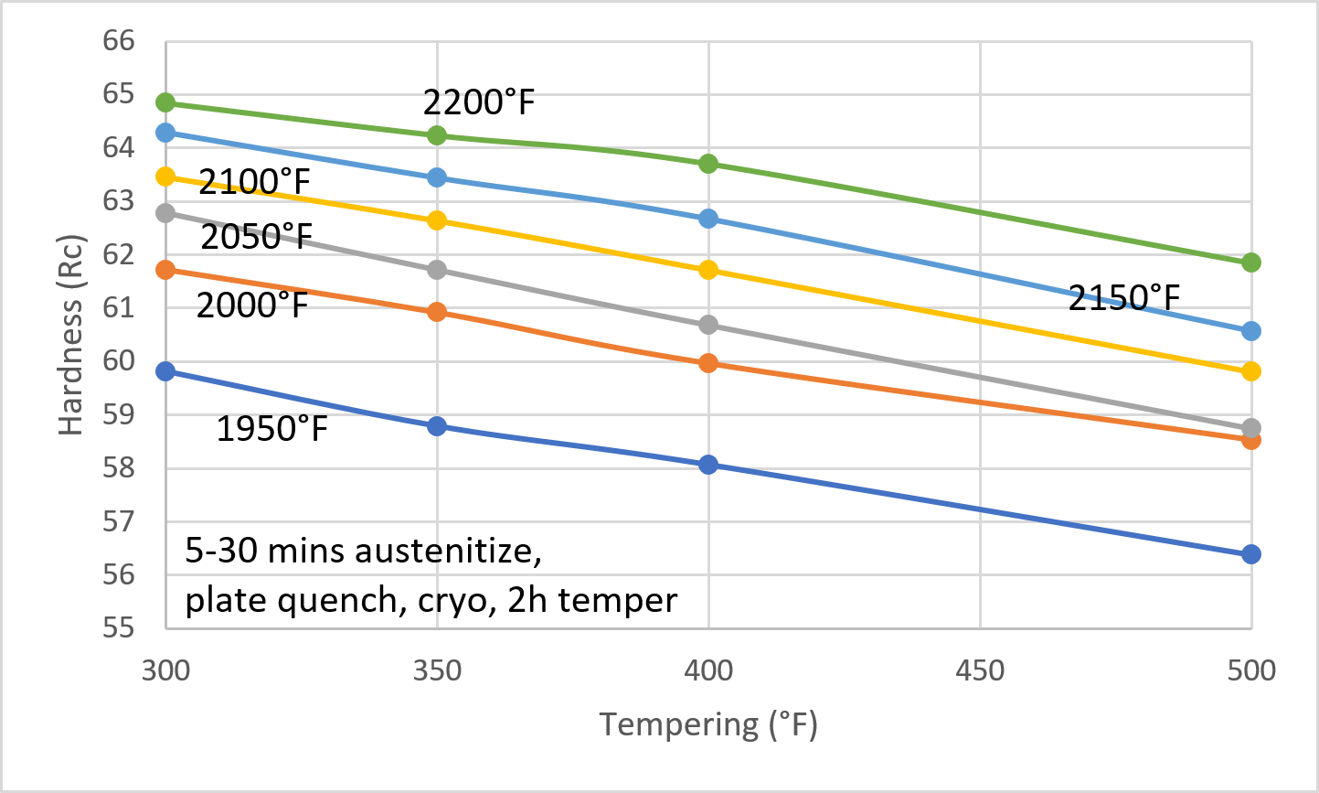

After quenching, steel is tempered to improve its toughness. The tradeoff is that hardness is also reduced through tempering. Below shows a tempering chart for MagnaCut with different austenitizing temperatures.
Different austenitizing-tempering combinations can be used to achieve the same level of hardness. For example, to achieve ~60 Rc, you could use 1950°F and 300°F, 2000°F and 400°F, or 2100°F and 500°F. Because the higher austenitizing temperature potentially means more chromium in solution we would expect the 2100°F and 500°F combination to achieve the best corrosion resistance for that hardness. A unique aspect of MagnaCut is that all of its chromium carbide is dissolved around 2050°F, as shown in the chart below. So if instead we were heat treating to ~63 Rc, 2050°F and 300°F, 2150°F and 400°F, and 2200°F and 450°F would all have approximately equal corrosion resistance. So austenitizing above 2050°F still leads to an increase in hardness for a fixed tempering temperature but the corrosion resistance would be unaffected.

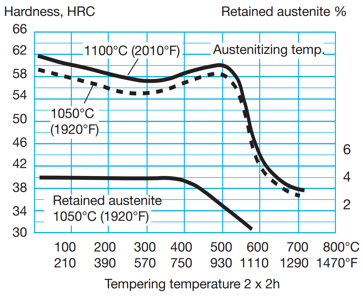

There is an important aspect to tempering and corrosion when it comes to a different regime of tempering, however. Stainless steels and other high alloy steels see a bump in hardness by tempering above about 750°F, as shown in the following chart for Elmax:
You can see that the hardness sees a peak with tempering around 500°C (930°F). This increase in hardness comes from precipitation of small chromium, molybdenum, tungsten, and vanadium carbides. Because chromium is coming out of solution as a chromium carbide this “secondary hardening” also leads to a decrease in corrosion resistance. Below shows Vanax steel that I tested with a 1% saltwater spray test for 24 hours where one was tempered at 400°F and the other was tempered at 1000°F. The 400°F temper Vanax showed no corrosion while the 1000°F temper led to significant rusting.

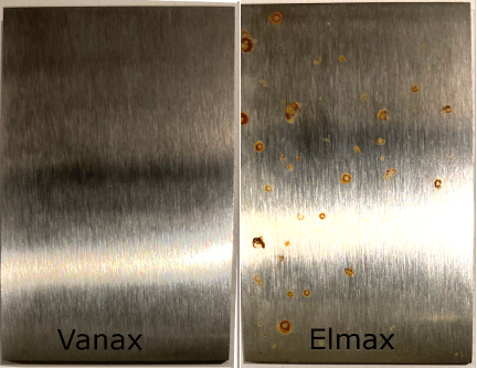

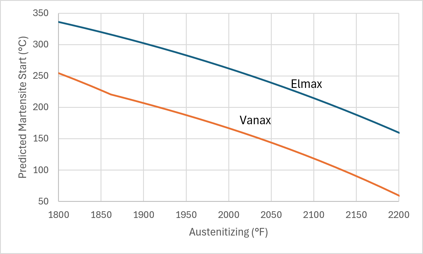

So after all of that we can return to our discussion of what makes one steel more corrosion resistant than another. Below shows Vanax and Elmax after a 1% saltwater spray test for 72 hours:
The Elmax rusted while the Vanax did not. Both were austenitized at 1975°F which is the recommended temperature for both steels according to their datasheets, and both were given a temper in the low range (400°F). As shown in the earlier chart, the difference in corrosion behavior is primarily due to higher chromium in solution for Vanax, which would roughly be 11.5% for Elmax and 14.5% for Vanax. As seen in the hardness chart, Vanax would actually be a bit harder than Elmax for this identical heat treatment. However, Elmax can be austenitized at higher temperature and achieve significantly higher hardness than Vanax which reaches its maximum around 61 Rc. The reason is because chromium also reduces martensite start and finish temperatures. Vanax has more chromium in solution for a given carbon/nitrogen in solution:
This means that for a given austenitizing temperature, Ms and Mf are lower in Vanax than in Elmax. So as seen below with an austenitizing temperature of 2025°F, the Ms was about 150°C. The Mf is sufficiently low that even with liquid nitrogen not all of the austenite is transforming to martensite, and thus hardness was lower with 2025 than 2000°F. Elmax, however, still has a predicted Ms above 150°C all the way to 2200°F, which is why its hardness increased all the way to 2150°F (the highest temperature I tried).
Thus an approximate relationship is created when comparing different steels to each other for their maximum hardness vs their corrosion resistance:

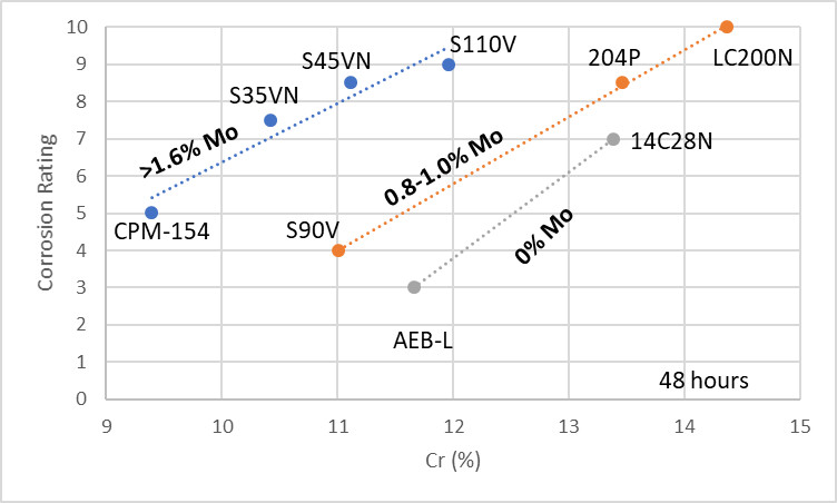

There are other complicating parts to this trendline, however. It does not always perfectly correlate with chromium in solution. Molybdenum, for example, is an element known to improve pitting resistance and to strengthen the chromium oxide passive film. In tests I did with 1% saltwater there was an improvement in corrosion resistance for a given chromium in solution if the Mo was increased:
CPM-154 with its high molybdenum content (4%) had acceptable corrosion resistance even with only 9.5% chromium in solution. (Note: the “corrosion ratings” in this chart are a rating of how much the samples rusted and not the same as the “corrosion rating” in the hardness trend plot which are from my knife steel ratings).

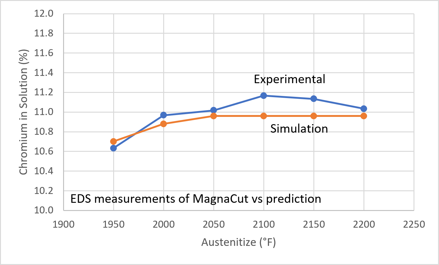

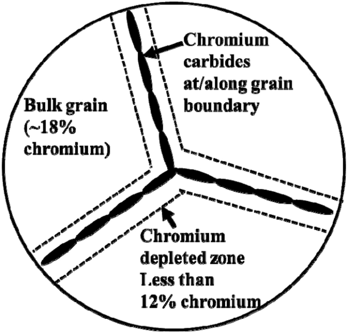

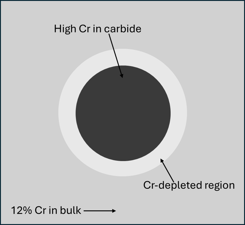

MagnaCut also does not have particularly high chromium in solution, around 11%. Instead, MagnaCut has superior corrosion resistance to those other steels because all of its chromium carbides are dissolved in heat treatment. With typical stainless steels they have many chromium carbides, and the chromium in solution is lower around each carbide:
Thus the chromium carbides act as corrosion initiation sites. This is somewhat similar to the phenomena called “sensitization” in low carbon stainless steels that are cooled too slowly.
Instead, all of the carbides in MagnaCut are vanadium or niobium carbides (after heat treating). Therefore those corrosion initiation sites are missing and so it has superior corrosion resistance for a given level of chromium in solution.
