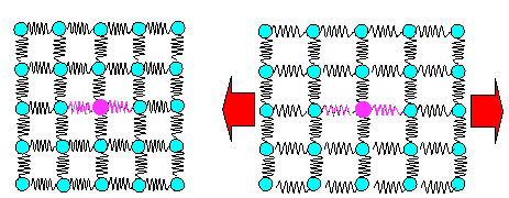

When we flex the steel, we are stretching or compressing the atomic bonds between atoms, as illustrated by springs in this image [2]:

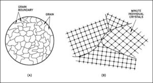

When you pull the set of atoms in tension then you stretch the bonds, and when compressing them you compress the bonds. Steel is polycrystalline, or made up of many grains of different crystallographic orientations, meaning that the planes of atoms are randomly oriented throughout, so there isn’t any real directionality in the bulk material in terms of modulus because of the orientation of the atoms, as illustrated by this simple schematic [3]:
So the end result in our bulk material is that the elastic modulus is controlled by the strength of these bonds. Since steel is primarily iron it is controlled by the strength of the iron-iron bonds. The strength of those bonds does not change with heat treatment, and changes by only small amounts when other elements are added (such as with chromium additions for a stainless steel).

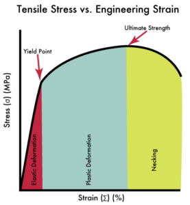

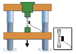

Since the top surface is in pure tension we can describe the behavior in that location with a tensile test, where a piece of steel is pulled in tension typically until it breaks, such as is illustrated here [5]:

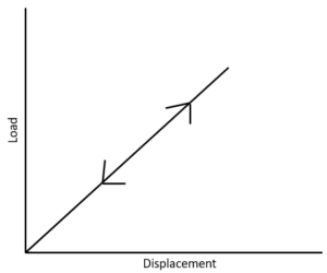

In a tensile test if you stay in the modulus region of the material, the behavior is completely linear, pulling the material causes it to elongate, and removing the load causes it to return to its original length. The slope of the line is equal to the Elastic Modulus. Applying more load leads to more elongation:
In the video he mentions that the two different samples bend the same amount because they have a similar cross section. The stress, σ, shown in the earlier figure demonstrates the importance of cross section. The load, width, thickness, and Modulus are all the same so the samples have the same degree of deflection despite the difference in hardness. Therefore, for a given material because its modulus is fixed, the greatest controlling factor for resistance to flexing is the cross section and particularly the thickness.
In the video he then bends the “soft” sample to the degree that it is permanently bent. Bending the “hard” sample to the same degree doesn’t permanently bend it but it springs back to its original position. As he mentions this is because of the difference in “yield point” between the two materials. The yield stress of the material is a measure of its strength and does typically change with hardness, though ultimate tensile stress typically best correlates with hardness. The yield point or yield stress can be seen in this stress-strain curve of a tensile test [6]:
There is a transition in behavior at the yield point where it is no longer controlled by the bonds between the atoms. What the transition in behavior is from I will cover in a future post. When materials have different strength levels the elastic modulus remains the same and but the yield stress can change greatly [7]:

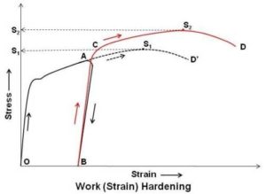

When the yield stress is exceeded then “plastic deformation” occurs where the steel will remain permanently bent. In terms of a stress-strain curve, unloading will not lead to a return to zero, but retains some amount of deformation, or displacement [8]:
Though as you can see, during unloading and reloading the material still follows the elastic modulus. When reloaded the yield stress is higher than it was originally, however, as the material has been strengthened somewhat during the initial plastic deformation, this is the same mechanism by which cold rolling strengthens steel.

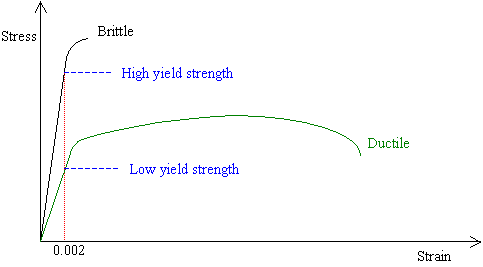

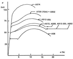

The fact that Young’s modulus of steel remains more or less unchanged is well known to me through my engineering education. That’s why I was very surprised to find that hardened steel has a very different ‘ping’ sound compared to soft steel as demonstrated by Kippington on KKF (can’t find his video of it now). I figure sound is a function of geometry, stiffness, density and hysteresis. Since stiffness and mass are more or less constant, and he kept the geometry the same as well I figure there may be some meaningful difference in the vibration energy absorbent (damping) properties of hardened versus unhardened steel. Not because the static behavior of two materials are identical it necessarily always follows the dynamic properties are as well. Which for me makes the question whether or not a trained person can feel a difference in feedback once again unanswered.
thanks for this interesting piece, BUT:
diagrams from [7] and [10] seem to directly contradict each other?
can you clarify why, at first, the elastic modulus is not affected by differences in hardness (commonly achieved through heat treatment), and then later it DOES change through heat treatment?
The second is a comparison between two different materials (ductile and brittle) which have two different modulus values.
