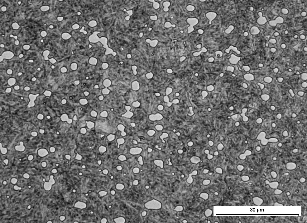

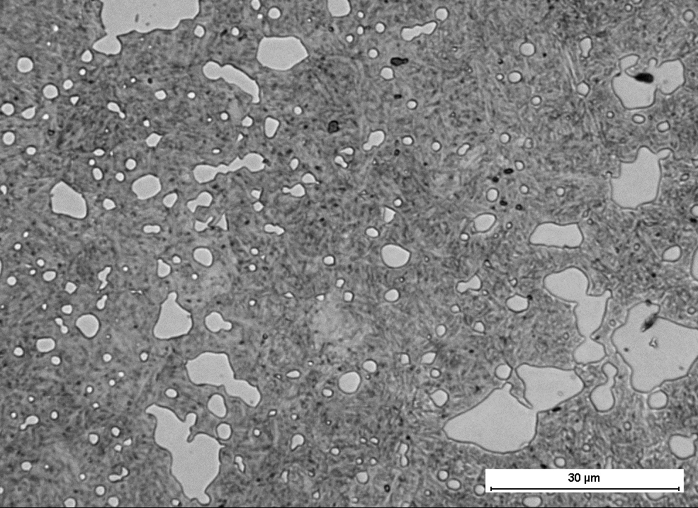

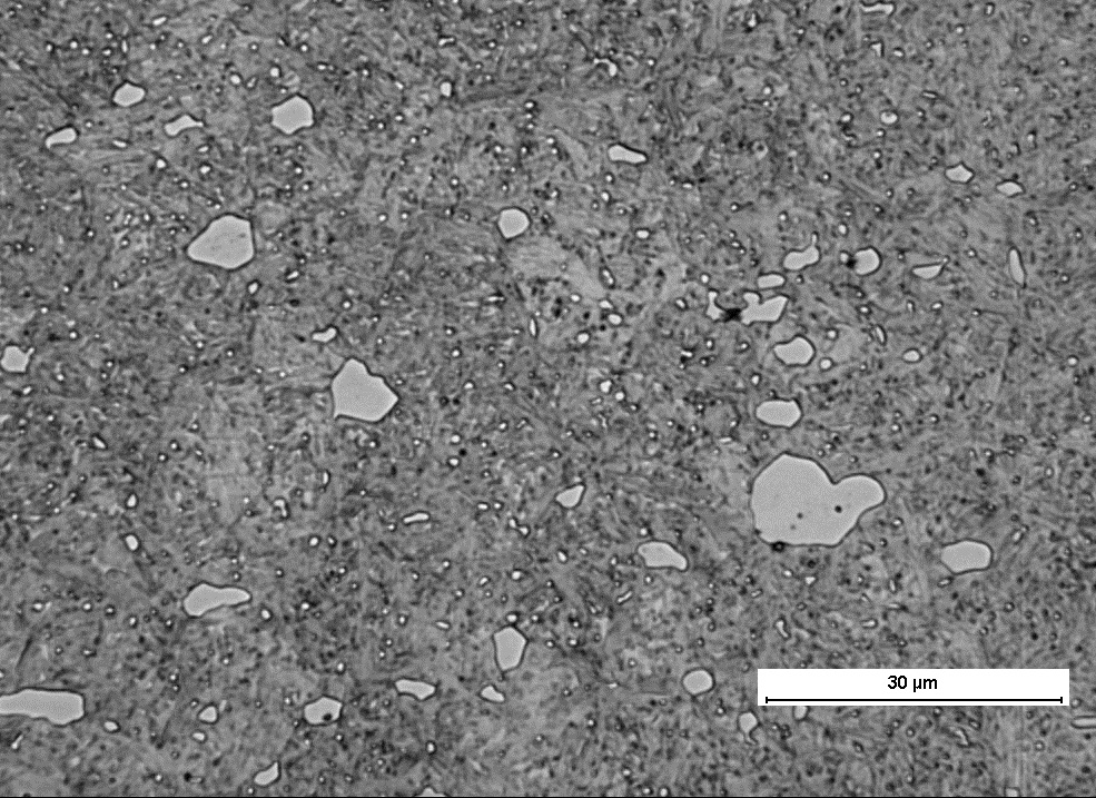

Recently I had samples of Niolox, CPM-154, and AEB-L analyzed with SEM. Vilella’s reagant was used which is common for tool steels and martensitic stainless steels because it etches the martensite matrix so it is dark and leaves the carbides bright. The compositions for the three steels:
| C | Cr | Mo | Nb | V | Mn | Si | |
| AEB-L | 0.68 | 13 | 0.6 | 0.4 | |||
| CPM-154 | 1.05 | 14 | 4 | Unlisted | Unlisted | ||
| Niolox | 0.8 | 12.7 | 1.1 | 0.7 | 0.9 | Unlisted | Unlisted |

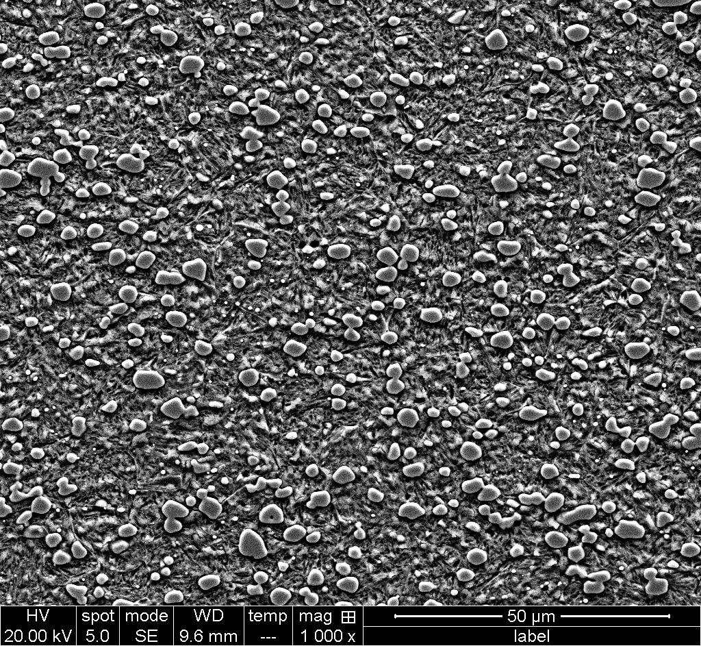

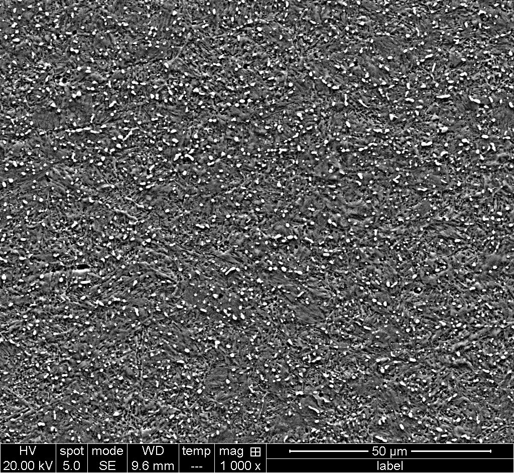

Each was austenitized for 15 minutes, oil quenched, dipped in liquid nitrogen for 30 minutes, and tempered twice for an hour each time. They were then imaged in the transverse direction (rolling direction is horizontal and normal direction is vertical). Here are secondary electron images of each at 1000x:
CPM-154
AEB-L
Niolox
The powder metallurgy process successfully refines the carbides of 154CM and the carbides are nicely spheroidized (round). However, the carbides of AEB-L are much smaller than CPM-154 which is part of why the toughness of AEB-L is significantly better. The carbides of AEB-L are smaller primarily because of the much smaller volume of carbide. As far as I know this is the first published micrograph of Niolox. The carbides in Niolox are generally small but there are some larger carbides mixed in. The micrographs of CPM-154 and AEB-L look very similar to micrographs previously given to me by Sandvik metallurgists of CPM-154 and 13C26, while conventional 154CM has significantly larger carbides:

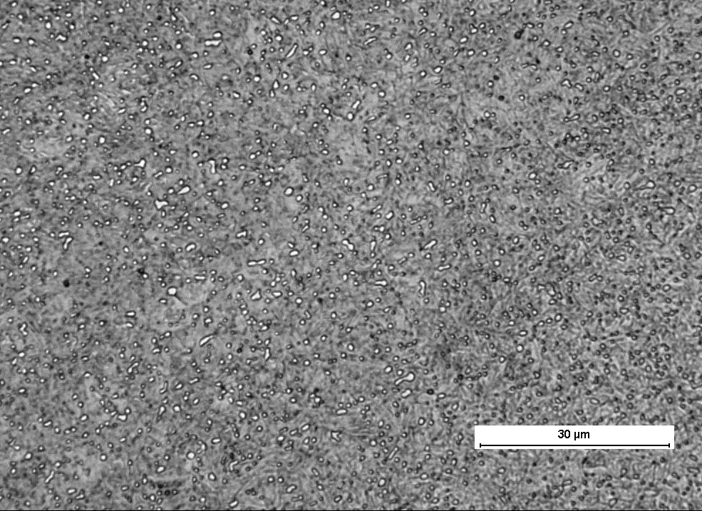

The Niolox microstructure looks relatively similar to 19C27, which is an “in-between” stainless that has lower carbide volume than steels like 154CM or 440C but significantly more than AEB-L, for a combination of moderate toughness and wear resistance. 19C27 also has many small carbides with some larger “primary” carbides mixed in. The primary carbides are those that form at very high temperatures; they are typically difficult to dissolve at high temperature and are usually larger than the secondary carbides which dissolve and re-precipitate during heat treating or forging.
19C27 imaged by Sandvik

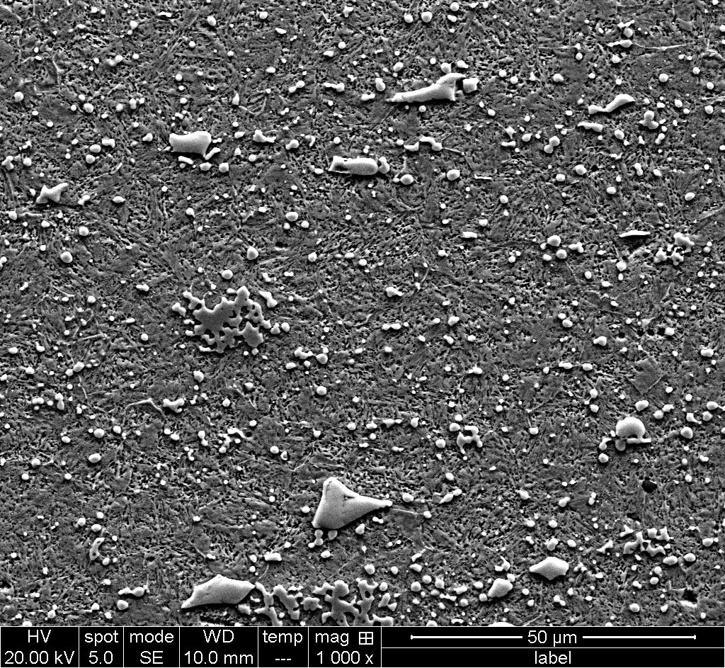

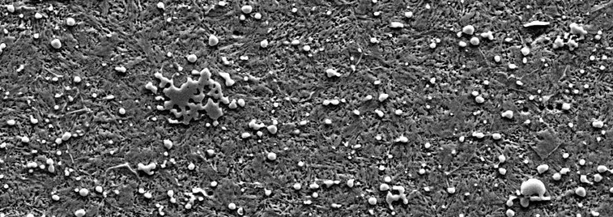

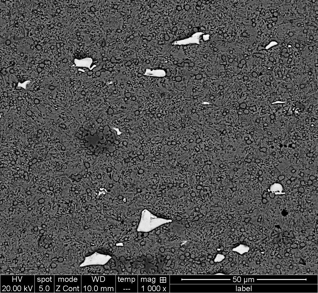

In the case of the new images I have them for a range of magnifications and also backscattered electron (BSE) images. With backscattered imaging heavy elements backscatter electrons more strongly than lighter elements and therefore appear brighter in the image, allowing the differentiation between different carbide types. Here is an example for Niolox where you can see the difference in type:
Niolox – Backscattered electron imaging

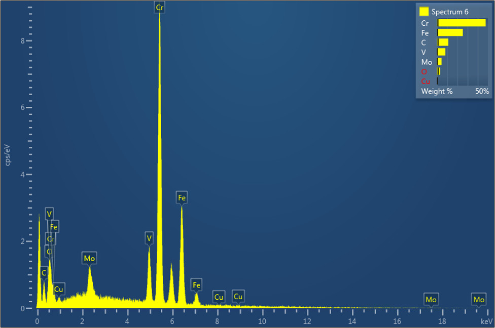

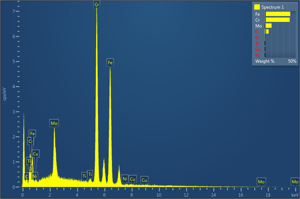

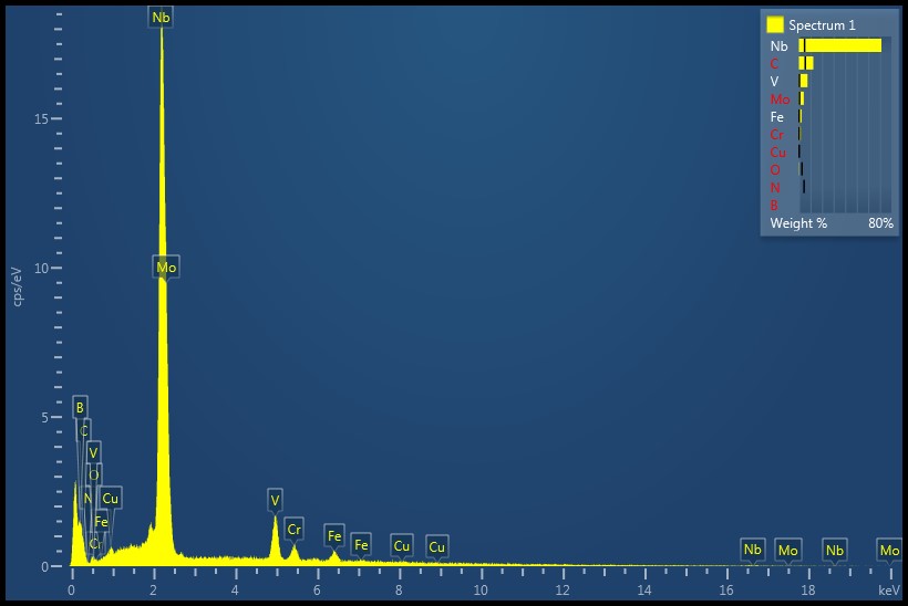

Energy-Dispersive X-ray Spectroscopy (EDS) was also used, which is a method to measure composition within SEM imaging. It is not a high precision method and is not perfect because the interaction volume of the electron beam is often larger than the area being analyzed, leading to interactions with nearby microconstituents. However, approximate compositions can be determined, as is seen when measuring EDS of the “white” carbides in the BSE images, which confirms that they are Nb-rich carbides:
No vanadium carbides were observed, though there was some vanadium enrichment of the chromium and niobium carbides, as can be seen in the Nb carbide spectra above as well as a chromium carbide:
No Mo-based carbides such as Mo2C or Mo6C were detected in CPM-154 but Mo-enrichment was present in the Cr-carbides:
