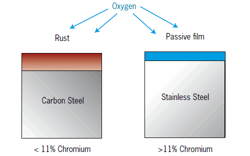

Some materials like aluminum form a passive oxide layer that prevents further corrosion. Steel is not one of those materials. Instead, steel forms iron oxide, or rust, that doesn’t protect the underlying iron and flakes off leading to further corrosion. However, when sufficient chromium is added then a chromium oxide passive layer forms which protects the steel from corrosion in a similar way to a metal like aluminum with its own aluminum oxide layer. A simple schematic diagram shows the passive film vs rust [1]:

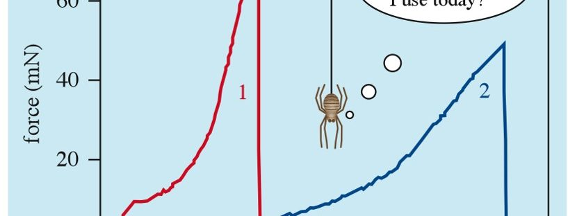

Is Spider Silk Stronger than Steel?

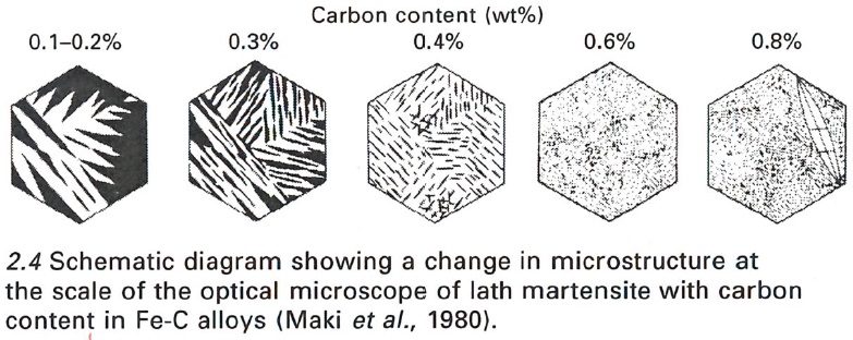

To harden steel you heat it up to high temperature to form a phase called austenite, followed by rapid quenching to make a very strong phase called martensite. Hardness is a measure of strength. I covered the process of austenite formation in the following post: Austenitizing Part 1. To summarize that post:

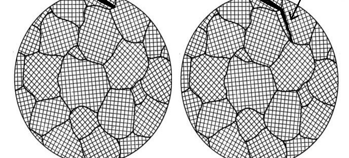

In my posts on austenitizing I described parameters of heat treating to keep grain size as small as possible and therefore improve strength and toughness [1-3]. It is very difficult to improve both strength and toughness at the same time, usually increasing one decreases the other. By what mechanism does grain refinement improve both?
