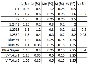

There are a variety of high carbon tungsten-alloyed steels, though many are difficult to obtain in the US. If we include O1 with its 0.5% W, here is a partial list:
Several of these steels are listed with chemistry ranges, so I selected mid-points to simplify further analysis.

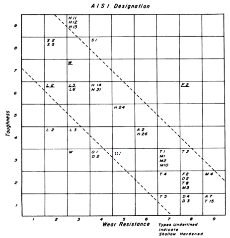

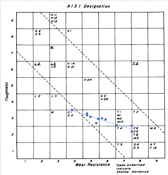

No wear resistance test results are provided in the book, though they do give a general rating for wear resistance and toughness of each steel on a scale of 1-9. They give a rating for O7 but do not show it on the convenient chart, so I added it:
So O1 gets a “4” for wear resistance and a “3” for toughness. Not too bad though not super exciting, as A2 is better in both categories. However, ease in forging and annealing, and a high working hardness are advantages that the tungsten steels have. O7 gets a bump up to “5” in wear resistance with little drop in toughness, and F2 gets a rating of “8” but a drop in toughness to “2” with its high tungsten content. A better understanding for where these properties come from can be seen in their micrographs; here are micrographs for O1 [3], O7 [3], and the similar to F2 though higher carbon 1.2562 [4]:

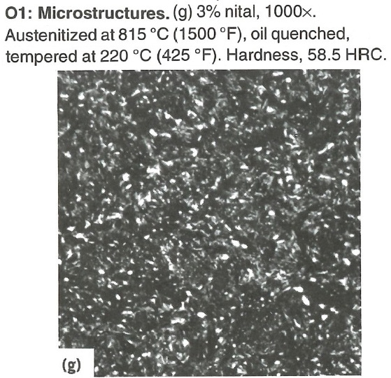

O1 Micrograph [3]

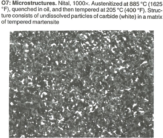

O7 Micrograph [3]

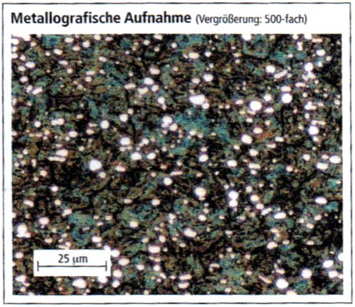

1.2562 Micrograph [4]
The first thing you notice is the vast different in carbide volume between 1.2562 and O1. O1 has a limited volume of very small carbides, while 1.2562 has a range of carbide size with some that are on the order of several microns. O7 is between the two but closer to O1 than to 1.2562, with generally small and evenly distributed carbides. Note also that while the O1 and O7 micrographs are at 1000x, the 1.2562 micrograph is at 500x, making the carbides look smaller than they are relatively. Another steel from Landes’ book with a micrograph at 500x is PM M3:2 (somewhat close to M4) where even it has a smaller carbide size and more even distribution of carbides [4]. Another example to show how much larger the carbides are than typical steels designed for forging is Cru Forge V, where its micrograph is also at 500x [5]:

Through point counting, I calculated the carbide volumes from the micrographs as the following:
The 16.5% carbide volume puts it in the range of many air hardening steels, which helps explain why it has greater wear resistance than most other common forging knife steels.

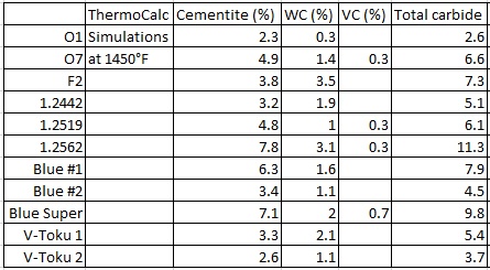

Those carbide volumes fit relatively well with ThermoCalc estimated carbide contents:

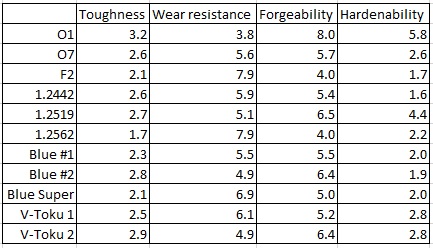

Using the estimated carbide volumes along with the relative wear resistance and toughness values, these steels can be assigned estimated properties. I also included scores for “forgeability” and “hardenability” which I will explain later:
These toughness and wear resistance estimates can also be overlaid on that plot I showed from the Tool Steels book earlier (blue circles):
That should give you some feel for the range of properties that are possible with the tungsten alloyed steels. So not stellar for toughness, as is common for low alloy high carbon steels, but a range of wear resistance can be found with the different options. The reduced toughness when compared with air hardening steels like A2 is likely due to the very high carbon in solution, which is known to reduce toughness, as I covered in an earlier article: Austenitizing Part 2. Grain size is not likely at work here because the tungsten alloying leads to a very fine grain size [2]. At equilibrium, these steels have very high carbon in solution, which is consistent with the very high hardness they achieve:

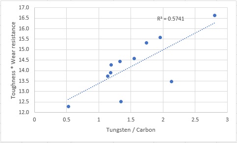

Balance Between Toughness and Wear Resistance
To maximize the toughness-wear resistance combination, there should be the highest tungsten carbide to cementite ratio possible, as tungsten carbide offers much more wear resistance than cementite, while cementite likely still reduces toughness by a similar amount as tungsten carbide [6]. Therefore, the steels with the highest combination of toughness and wear resistance will be those that primarily have tungsten carbide. Blue Super and 1.2562 have a high carbon content, which primarily acts to increase its cementite fraction, which again, decreases toughness with little contribution to wear resistance. A lower carbon content for a given level of tungsten generally gives a better balance of properties, such as V-Toku 2 (1.05C-1.25W) and V-Toku 1 (1.15C-2.25W). Plotting the ratio of tungsten to carbon vs the predicted (toughness * wear resistance) shows this effect:

I have seen F2 shows impressive performance in the general rating for wear resistance and toughness graph given by Bethlehem Steel. I’m talking about the shallow hardened F2. What do you think they can be referring with the term “shallow hardening” and how do you think it can be reproduced?
Thank you for your work Larrin
Sometimes steel companies would differentiate between the toughness of through-hardened vs case hardened steel and would represent an approximate toughness value for an unhardened core with hard case. Something similar is shown in the old Tool Steels book. This would be similar to differential hardening of a knife. But just giving a differentially hardened knife a toughness rating of 7-8 because the spine is soft I think is a bit misleading, since the edge would still have low toughness and be more susceptible to chipping.
