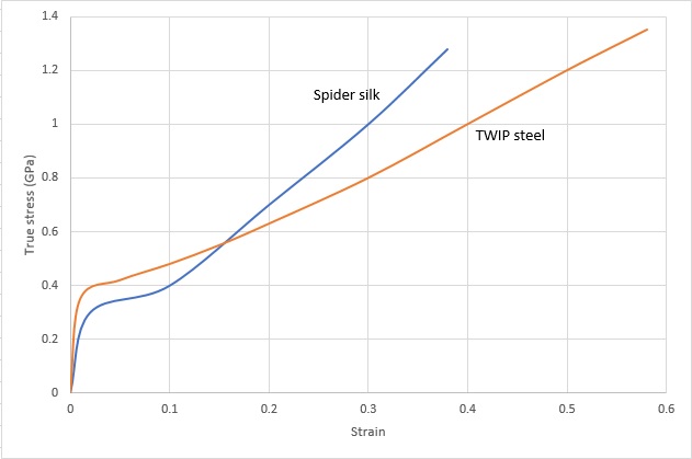

With a cursory search I came up with one reported value of 500 MJ/m^3 for a type of steel referred to as TWIP steel, or twinning-induced plasticity steel [5]. There are likely higher values reported for TWIP steels but this is the value I found on page one of a search, and I’m feeling lazy. They made no claims of this being the highest value ever recorded; the toughness value was incidental to the study. You can see a comparison between the tensile properties of spider silk and TWIP steel below [5][6]:
This is just one value from spider silk and TWIP steel, but it is enough to get the point. The strength of spider silk in the review ranged from only 20 MPa up to the aforementioned 1652 MPa, and it has also been reported that spider silk has high variability in properties, even from the same spider [1]. So I used a reported stress-strain curve from a good value of spider silk, along with the TWIP steel study that gave a value of 500 MJ/m^3 [5]. You can see that the TWIP steel has both higher strength and ductility than the comparison spider silk. TWIP steels can have a range of strength and ductility values depending on the design. And that is the beauty of steel: it is produced in a variety of shapes, sizes, strength levels, costs, and made for a variety of applications including corrosive environments, high temperature environments, and more. TWIP steels have been around for decades, and are currently commercially available [7]. And they are available in sheets, not just thin strands, but they are not as exciting as spider silk, apparently.

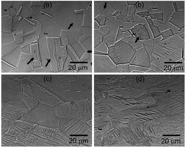

How do TWIP steels gain their high combination of strength and ductility? As is described by their name, it occurs through a process called twinning. First, the steels are designed to have high amounts of carbon and manganese so that a phase called austenite is stable at room temperature. Normally steel transforms to austenite at high temperature, such as above 912°C in pure iron. This phase is nonmagnetic and has different properties than the normal room temperature phase called ferrite. The composition of the steel is also carefully controlled to have a low “stacking fault energy” which causes it to twin during deformation. Mechanical twinning is a shift of a portion of atoms within the crystal structure of a material, as is illustrated here:
These twins form in the material continuously as it is deformed, which modifies the microstructure, as can be seen in these micrographs of TWIP steel at different levels of deformation [8]:

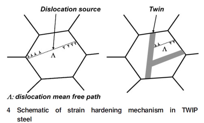

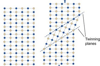

It works in a similar manner with TWIP steel; the stress increases and the dislocations pileup at grain boundaries, but then twins form, as shown in this schematic [9]:
Twins also act as boundaries to dislocation movement. So as the twins continuously form during deformation, the effective grain size is also going down. In a normal material, the dislocation density gradually increases during deformation until the material can no longer accommodate any strain and it fractures. But with a TWIP steel, there is a combination of typical hardening through dislocation generation and also through twin formation. Once the effective grain size is reduced then the stress must be further increased for dislocations to overcome barriers. It’s almost like every time a twin forms it is a new material in a new tensile test. So this behavior leads to very high combinations of strength and ductility.

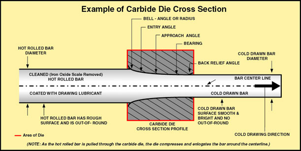

Previously in this article I referenced the strongest recorded steel at 6350 MPa ultimate tensile strength. My subheading for this section helps to illustrate the ridiculous headlines of “stronger than steel” since comparing steel to itself is, of course, impossible without stating what two steels you are referring to. The study in question is on a type of steel wire sometimes called piano wire, which has been around for decades. It is produced through heavy cold-drawing of steel wire. The wire is brought through progressively smaller dies, elongating the wire, decreasing its diameter, and increasing its strength [11]:

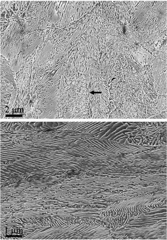

The high strength of the wire is obtained through interesting modifications to the microstructure of the steel. The wire starts out as a pearlitic microstructure, which is made up of alternating bands of cementite and ferrite. Pearlite forms in steel through slow cooling from high temperature. Ferrite is the typical room temperature phase of steel and is generally soft and low in carbon. Cementite is a hard phase made up of carbon and iron. However, the composite strength of cementite and ferrite is still typically low. An image of pearlite with increasing deformation can be seen below, with alternating white cementite bands and grey ferrite bands. Deformation is in the x-axis, so the pearlite becomes elongated horizontally [2]:

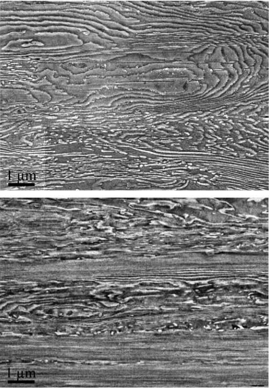

Once the pearlite is highly strained the cementite begins to decompose, so that carbon is diffusing into the surrounding ferrite. Carbon greatly increases the strength of ferrite, but ferrite has a low solubility for carbon, so generally it isn’t possible to add very much. Typically to produce the highest strength steel a phase called martensite is formed, as it can have a much higher carbon content, as described in this article: What Makes Quenched Steel so Hard? The effect of carbon on steel strength can be seen here [12]:
The decomposition of pearlite and the resulting high carbon content of the ferrite gives the heavily drawn wire a very high tensile strength, much higher than spider silk, and even, in fact, higher than many materials known for their high tensile strength like kevlar. Ultra high tensile strength material is difficult to develop, in part, because strength and ductility are opposed to each other. Many very strong materials like ceramics have low measured tensile strength because they are brittle and therefore fracture before their peak strength can be reached. Those types of materials are often tested in compression instead since that test is not as affected by low ductility. So the very high tensile strength possible with steel wire is impressive.
