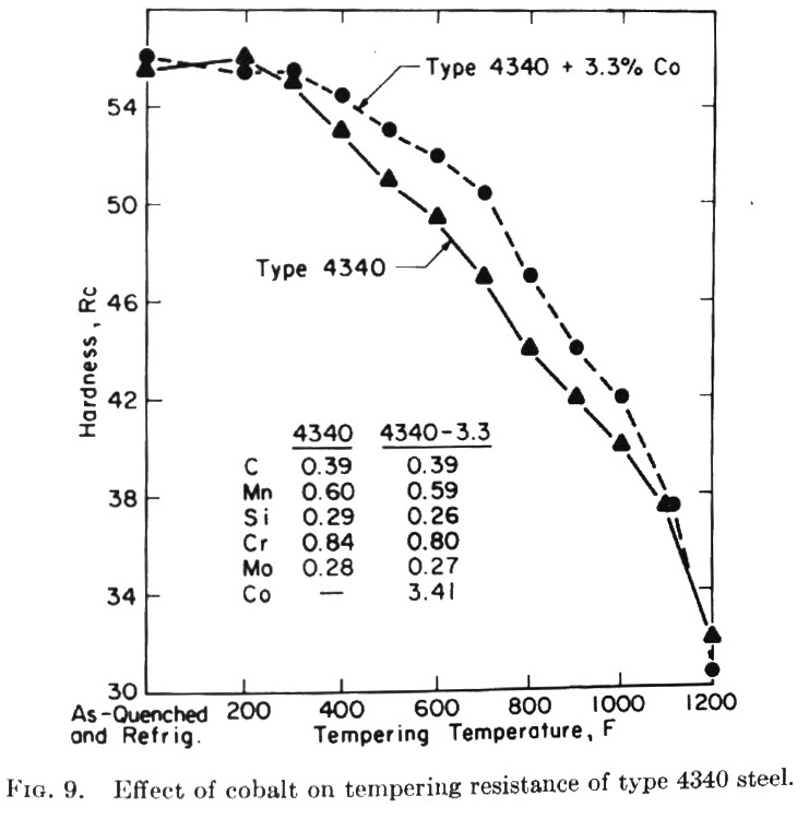

Cobalt contributes to tempering resistance by slowing the recovery of martensite and therefore there are more dislocations present to act as the sites for nucleation of precipitates. With more sites for precipitation there is a greater density of precipitates for precipitation strengthening and also stronger martensite even without precipitates, as can be seen with a low-alloy 4340 steel that doesn’t have sufficient Mo or W for significant sencondary hardening [2]:
So when the cobalt has a significant effect on tempering even with the low-alloy 4340, I think it shows that the dominant effect is to slow down recovery of martensite. There are some other theories involving accelerating diffusion of molybdenum or tungsten, or suppressing growth of carbides by cobalt diffusing out of carbides into ferrite [2], etc. but I think in general things can be understood in terms of recovery. In the plots for both M2 and 4340 above, however, the hardness is the same without tempering and therefore I think we can rule out “solid solution strengthening,” in other words, cobalt doesn’t increase hardness directly, but through tempering resistance.

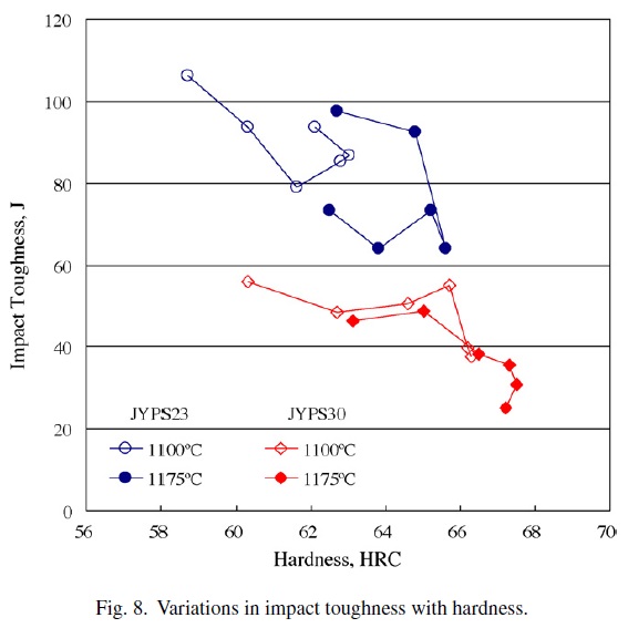

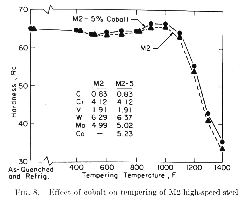

There are some claims I have seen that cobalt increases toughness, so I spent some time investigating this effect. In high speed steels a cobalt addition does not increase toughness, even when tested at the same hardness, as can be seen in this plot where JYPS30 is nearly identical to JYPS23 but JYPS30 had 8.5% Co [4]:
But that is with high speed steels and in this case a relatively high cobalt addition. So I had to find other sources for using low temperature tempering and with lower alloy steels. Luckily someone already did a review of the literature on this for me [5]. Unfortunately he found that cobalt decreased toughness in almost all studies he investigated, and it seems to act in the opposite way that nickel increases toughness. In fact, the only reason that the high cobalt maraging steels have high toughness properties is because they have sufficient nickel to overcome the negative effects of cobalt.

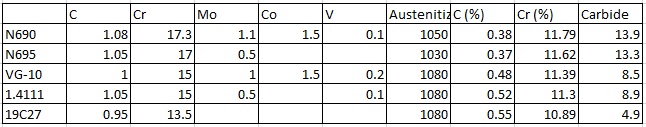

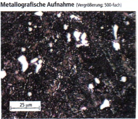

So I think we’ve gotten enough background on cobalt to talk about N690 and VG-10, now. Here are the compositions of the steels I will be covering, along with some JMatPro calculations:

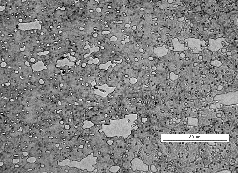

N690 has a similar composition to 440C/N695 but with an addition of Co and a small bump of Mo. It is a similar story with VG-10 and 1.4111, but they both have 15% Cr instead of the 17% Cr steel in the 440C grades. 19C27 is yet another ~1.0% carbon steel but with 13.5% Cr and no Mo or Co. In the chart above I also included JMatPro estimated carbon in solution (controls hardness), chromium in solution (controls corrosion resistance), and carbide volume (more means higher wear resistance but lower toughness). These estimates align well with reported hardness of 440C, VG-10, and 19C27 (in order of increasing hardness) and also their carbide volumes as seen in micrographs (440C, N690, and 19C27 from Sandvik and 1.4111 from Roman Landes [11]):
N690
440C
1.4111 [11]
19C27
You can see that with decreasing chromium content the amount of carbides (light grey or white particles) is less and the largest carbides are smaller. You can also see that the cobalt addition to N690 had little effect on the carbide structure when comparing with 440C, as we would expect based on everything you learned about cobalt in this article. Therefore, because these steels all have approximately the same carbon content, their properties are greatly controlled by their chromium content. Higher chromium means higher corrosion resistance and wear resistance, but also lower toughness and peak hardness.

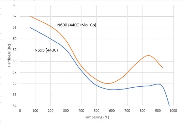

Effect on Tempering
The addition of cobalt and the small bump in molybdenum means that that N690 has greater tempering resistance than N695/440C [12][13]:
N690 has a higher recommended austenitizing temperature than N695 which is the likely explanation for the higher initial hardness of N695; however, there is a clear secondary hardening bump with N690 that isn’t present with N695. That is due to the higher cobalt and molybdenum for the reasons that I covered before. Cobalt suppressed the recovery of martensite for higher hardness with tempering, and also increased the effect of molybdenum with secondary hardening. This is what the Spyderco article means by saying that cobalt increases the effect of other elements. The suppression of recovery leads to enhanced secondary hardening which is an effect that occurs due to other elements, especially Mo or W.
