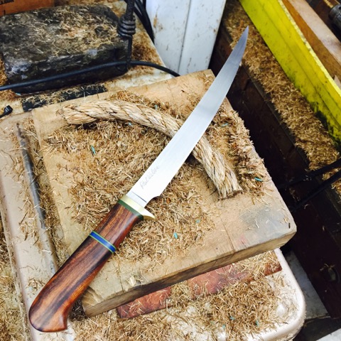

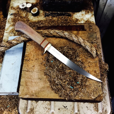

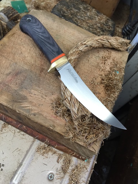

Knife testing is a matter of trying to come up with a process that can be used in the shop to predict the actual field performance. That means you have to cut something be it rope or cardboard or carpet or??  I have found over time and with the help of Wayne Goddard the best test medium is manila rope. This material comes very close to what is encountered in the field both hunting and fishing and everyday use.  I am updating my web site to include the latest test method so will not go into detail here. It is very difficult to do a test that just measures the performance of steels. All the variables come into play when cutting. Edge geometry, blade thickness, sharpening, blade finish, rope differences, ergonomics, push cut or slice.  I have concluded that one can test and put blade materials in categories but without a precise measuring machine like a CATRA and exactly configured blade samples it is not possible to cut by hand and rate one material over another with scientific precision. I cut with each knife I make and expect it to fall with in parameters based on past experience and a whole lot of feel. I think when we are testing we are really testing the performance of the overall knife that day under those test conditions and the steel grade is just part of the package.
