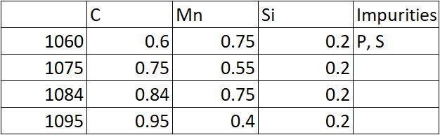

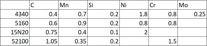

Steel is defined as iron with carbon added (we will ignore carbon-free steel for now). So of course stainless steels used in knives also have carbon. They wouldn’t achieve sufficient hardness otherwise. The term “carbon steel” refers to steels that are primarily alloyed with carbon but manganese and silicon are generally added. The most common types of the 10XX series of steels such as 1060, 1075, 1084, 1095, etc.
The amount of each element is given in “weight percent,” so in 1095, 0.95% of the steel is carbon based on weight. Impurities such as phosphorous (P) and sulfur (S) are inevitable in all steels so I won’t be including those in any of the other tables. When some more elements are added the steels are referred to as “alloy steels” because alloy has been added to them. Typical alloy additions include higher manganese, nickel, molybdenum, or chromium additions. Common grades include 4340, 5160, 15N20, and 52100:

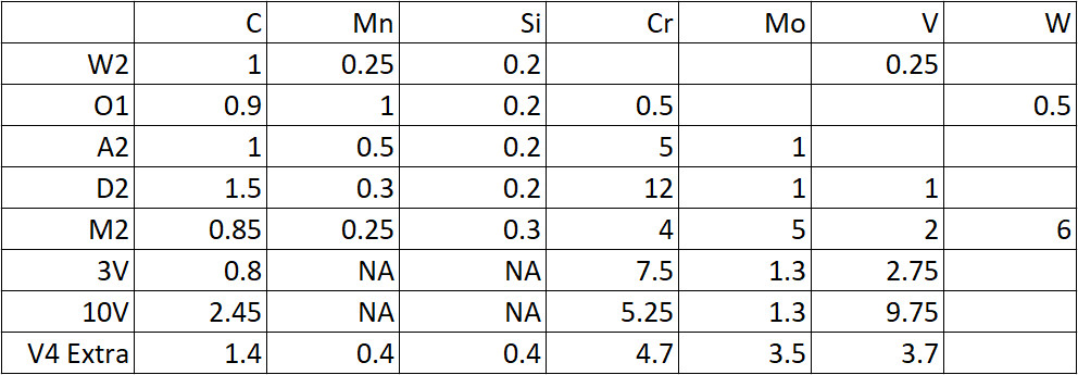

Another category is called “tool steels” which is somewhat more difficult to define. Any steel used for tools, dies, etc. can be defined as a tool steel. They vary in composition from W2 which is essentially a simple carbon steel to high speed steels with high contents of molybdenum, tungsten, and vanadium. Sometimes I use another made up category called “high alloy” steels. Common tool steels include W2, O1, D2, A2, and M2 though also includes more recent steels such as 10V, 3V, or Vanadis 4 Extra:

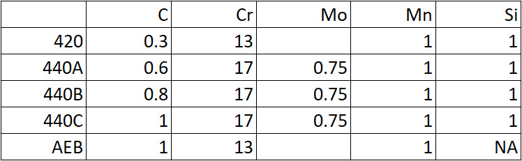

Stainless steels are those that have sufficient chromium to have high corrosion resistance relative to carbon steels. This is also a somewhat fuzzy line, sometimes given as a cutoff such as 10.5, 11, or 12% minimum chromium to be stainless. However, that must be balanced against other elements such as carbon. The most common example is D2 which has ~12% chromium but is not classified as stainless and indeed has much lower chromium in solution to contribute to corrosion resistance than a stainless steel. I wrote about that in this article on corrosion resistance of D2. I previously wrote about the development/invention of stainless steels in the early 20th century and how the early stainless steels were in fact developed specifically for knives: you can read about that here. By the early 1930’s, the basic common stainless steels 420, 440A, and 440C had already been invented and 420 and 440A were being used frequently in knives:
However sometimes the term “carbon steel” is used simply as the opposite of stainless; in other words, carbon steel means non-stainless. That is often the way the term “carbon steel” is used when debating the merits of carbon steel and stainless steel. In this article I will try to be consistent in the way that I use these terms, and use “carbon steel” when referring to simple carbon steels, and “non-stainless” when referring to the broad group of steels that are not considered to be stainless steels.
Early Stainless Steel Knives
In the approximate timeframe of 1920-1960 stainless steel was used in many production knives but did not have a good reputation. Most of these knives were produced with 420 steel and later with 440A and were typically low in hardness. Being low in hardness means that the edge easily rolls and wears quickly. To avoid edge rolls a heavier edge geometry is required, which also reduces cutting ability and edge retention. Those factors mean that the knives in stainless steel often had a poor reputation relative to carbon steel. There was of course also a perception issue as carbon steel was “traditional” while stainless steel was new and less known. A.G. Russell reports [1] that he bought a beautiful Case drop point sailor’s knife in stainless steel in 1957 and liked the look of it so much he put elephant ivory handles on it. However, after cutting with it he learned that the edge wouldn’t last more than 5 minutes during cutting and threw it away. Bill Bagwell says that none of his WWII-veteran uncles liked stainless steel knives and thought they wouldn’t hold an edge [2]. A.G. did say that in the 1960’s Victorinox and Schrade began making some higher quality knives in stainless steel.

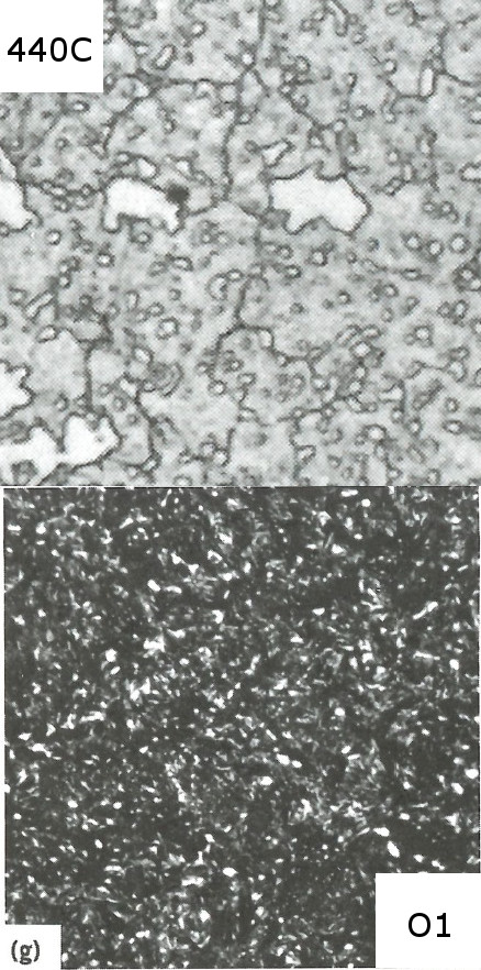

While perceptions of stainless steel were often based on 420 or 440A knives heat treated to relatively low hardness, the 440C and 154CM used in stock removal knives in the 70’s were a different breed. They were capable of high hardness (>58 Rc) and had high wear resistance. Due to the high carbon and chromium content, 440C and 154CM had large amounts of chromium carbides, whereas carbon steels like 1095 had a small amount of iron carbides. Here are micrographs comparing 440C (stainless) and O1 (low alloy tool steel):
You can see the stark difference in carbide structure by comparing the white particles between 440C and O1. 440C and 154CM have relatively large carbides, often greater than 10 microns across, while carbides in steels like O1, 52100, and 1095, are usually less than 2 microns. Chromium carbides are also harder than the iron carbides in carbon and low-alloy steels. That means that the common stainless steels 440C and 154CM used with stock removal in the 1970’s had much higher wear resistance than the common carbon and alloy steels used in forging. Higher wear resistance means better slicing edge retention but more difficulty in sharpening. It also meant more difficulty in finishing which was particularly an issue with mirror polished blades. The large volume fraction of large carbides also means that the toughness of 440C and 154CM is somewhat less than 1095, O1, and 52100, and significantly less than high toughness steels like 5160. Therefore those that promote carbon steels often talk about ease in sharpening and superior toughness. There are low alloy steels with higher wear resistance, notably the tungsten-alloyed steels such as Blue Super, 1.2562, and F2, but those steels have had poor availability in the USA, and have seen little use by American bladesmiths. You can read more about tungsten-alloyed steels in this article.

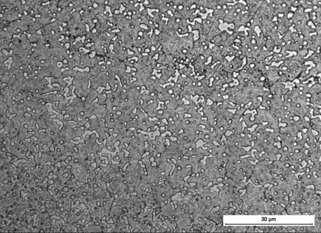

There were a few steels that were promoted as having some properties of both steel types, most notably D2, which is sometimes called a “semi-stainless” steel. D2 has a high chromium content (~12%) so it is often claimed that it is nearly stainless. And while it does have much higher stain resistance than a simple carbon steel there are other non-stainless steels with more chromium in solution for better corrosion resistance, such as Vasco Wear which is a steel that has also been around a long time. However, even though D2 is not a stainless steel, its carbide structure is actually very similar to 440C and 154CM, if anything the carbides in D2 are even bigger:
D2 steel micrograph
154CM steel micrograph
D2 is also an “air hardening” steel and has high tempering resistance meaning it is just as difficult to achieve a differentially hardened blade as it is with stainless steels. D2 shares many characteristics in common with stainless steels like 440C and 154CM in terms of carbide structure and mechanical properties and is a good example of how there isn’t always much difference between stainless and non-stainless steels when it comes to mechanical properties. And while D2 is perhaps an obvious example with its high chromium content, there are other non-stainless steels with similar characteristics.

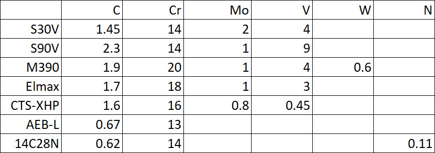

Since the 1970’s and 1980’s there has been the rise of many more stainless steels and non-stainless tool steels. This has perhaps not changed the debate as much as one might suppose. The forging bladesmiths continue to primarily use carbon and alloy steels which have good toughness, great ease in sharpening, and low wear resistance. Knife companies and stock removal makers primarily use stainless steel with some use of high alloy tool steels such as 3V or 10V. The new powder metallurgy stainless steels such as Crucible S30V have smaller carbides than the conventional steels but still have a large volume fraction of carbides which limits the potential toughness:
S30V steel micrograph
These powder metallurgy stainless steels have even higher wear resistance than 440C and 154CM which gives them even greater slicing edge retention, and even more difficulty in finishing and sharpening. So in some ways the divide in the carbon vs stainless debate has gotten even bigger. There are now many powder metallurgy knife steels available from companies like Crucible, Carpenter, Bohler, and Uddeholm. The primary exception has been the increase in popularity of low carbide stainless steels like AEB-L, 13C26, and 14C28N which have a small volume of carbides that are just as small as those found in carbon steels:
13C26 micrograph
Therefore these stainless steels have the same advantages of carbon steels when it comes to a fine carbide distribution, ease in finishing, and high toughness, though reduced slicing edge retention compared to the higher carbide stainless steels and high alloy tool steels. They still have the same difficulties in forging as other air hardening steels, however, and therefore have seen little or no use among the forging bladesmiths. Here is a table summarizing the composition of some of these more recent stainless steels:
