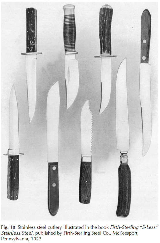

Owen Parmiter, a metallurgist for Firth-Sterling Steel Company, wrote a paper on stainless steel in 1924, and updated it for 1935. He said in those papers that the original 420-type composition developed by Brearley continued to be the most popular version. However, in the updated 1935 paper he mentioned that a stainless steel with 0.7% carbon and 16.5% chromium had been developed [4]. The higher carbon gives it higher hardness, with correspondingly higher chromium to maintain similar corrosion resistance to 420. That composition looks essentially like modern 440A steel, another common knife steel. I can’t find much information on when 440C was developed though it likely grew out of the existing 440A steel for applications requiring even higher hardness. I did find a patent for a bearing steel filed in 1940 with 0.9-1.1% carbon and 17-19% chromium; basically identical to 440C, though it’s not clear if the steel existed prior to the patent, as the patent focused on the production of bearings though the composition of the steel is a significant part of the patent [5]. It was named 440C by at least 1944 [6] and by 1949 it was called one of “the three most important grades of hardenable stainless steel in use today” [7].

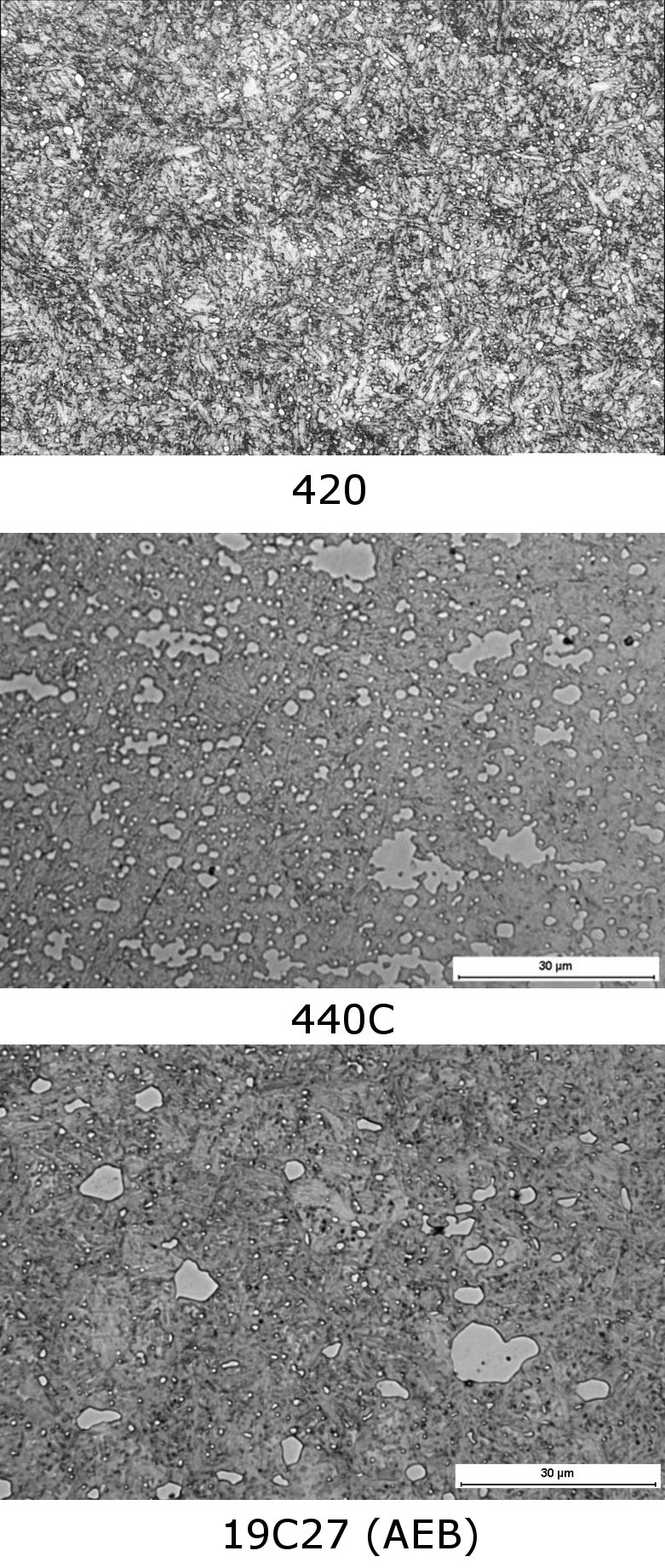

Photo micrographs of 420, 440C, and 19C27 can be seen below. The carbide volume (white/grey particles) is much lower in 420 and the carbides are much smaller, which is because of its low carbon-chromium combination. Because of the low carbide volume and small carbides it has high toughness and ease in sharpening but lower wear resistance than 440 grades or AEB. 440C has a large volume of large carbides giving it high wear resistance but the lowest toughness of the three. AEB is an intermediate grade in terms of carbide volume, toughness, and wear resistance:
