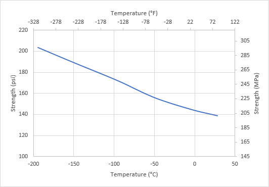

Effect of Temperature on Strength
Steels become stronger at lower temperatures. This can be measured with the “yield strength” which is the load to permanently deform the steel. This deformation is in the form of a shape change, ie. if you are bending steel it stays bent, when hammering hot steel it dents, when flexing an edge it rolls. This is perhaps easier to visualize for those that have forged steel because hot steel is easier to forge, and is progressively more difficult to forge as it cools down. This increase in strength at lower temperatures continues below room temperature, so steel at cryogenic temperatures is stronger than at room temperature. Here are values for yield stress for 410 stainless steel heat treated to 39 Rc [1]:

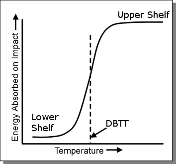

Low Temperature Toughness
In general, higher strength and higher hardness means lower toughness. Therefore we would expect steel at low temperatures to have lower toughness than room temperature steel. This may be concerning if knives are to be used outdoors in the winter, particularly in northern climates. However, this is not always a gradual reduction in toughness with lower temperature, with martensitic steels like knife steel there is often a sharp reduction in toughness below a certain temperature. Here is a plot showing the change in toughness with temperature for steels with different carbon content [2]:
The temperature at which this drop in toughness occurs is called the “Ductile to Brittle Transition Temperature” (DBTT) which is about -75°C for the 0.01% carbon steel above. Each steel has an “upper shelf” toughness at higher temperatures and a “lower shelf” toughness at low temperatures. The upper shelf toughness goes down with more carbon. The higher carbon steel is harder/stronger and therefore has lower toughness. The drop in toughness with temperature is more gradual with higher carbon. Because the drop in toughness can be gradual it can be difficult to identify a single transition temperature. One convenient definition is the temperature at which the toughness is an average of the upper and lower shelf.
You can also see that for high carbon steels the DBTT is actually above room temperature. This is somewhat misleading as the toughness test is performed with notched charpy specimens; the notch promotes brittle fracture of steel and reduces toughness:
This image taken from [3]

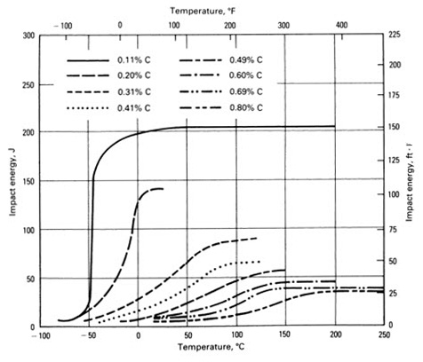

Austenite vs Martensite

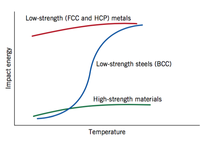

Not all materials show the DBTT with the sharp drop in toughness. Steels with a ferrite or martensite microstructure show this behavior. Ferrite is the steel phase in the annealed condition and martensite is the steel phase in the quenched and tempered (hardened) condition. Steels with an austenite microstructure (ie austenitic stainless steel like 302, 304, etc.) do not show this behavior. See the chart below and compare the FCC material (austenite) with the BCC material (ferrite and martensite):
This image taken from [4]
With high strength materials like knife steels the gradual drop in toughness is in part because the relative toughness is so low already. I don’t know if the decrease in toughness is more sharp with unnotched specimens that start out with higher toughness. A literature search has not revealed anything either. However, we can talk about the mechanisms being measured by this toughness testing and what we might conclude.

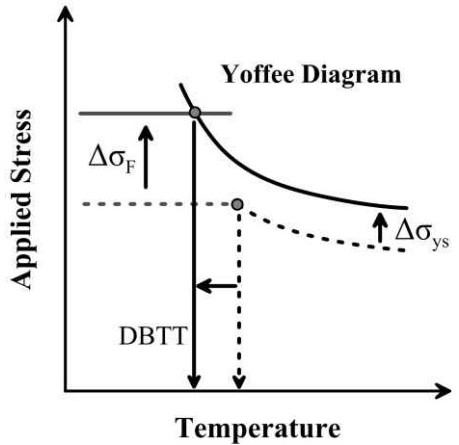

Factors that Change DBTT
There are many factors that can change the DBT temperature. We want the temperature to be as low as possible to both maximize room temperature toughness but also to increase cold temperature toughness. Carbon is a major factor as described, but there are many other variables to keep in mind.

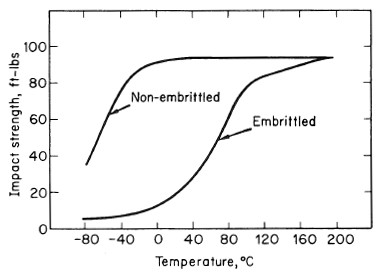

Common impurities sulfur and phosphorous reduce the fracture strength of steel and reduce its toughness. This also increases the DBTT:
This image from [8]
Image from [8]

A finer grain size also means a higher yield strength, for reasons described in the linked article. Therefore, with both an increase in yield strength and fracture strength, the DBTT is reduced:

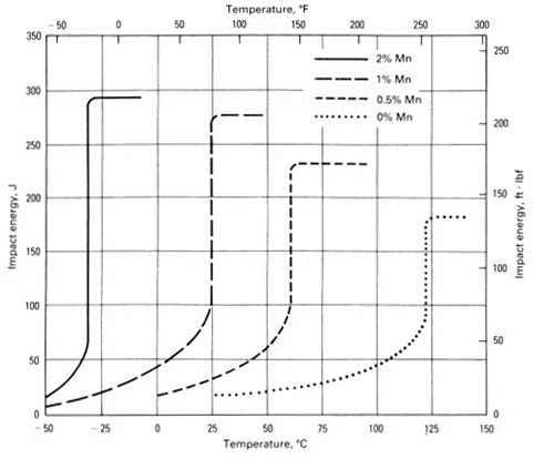

Nickel and Manganese Additions
Some alloy additions can make the steel’s yield strength less sensitive to reduction in temperature. Therefore the temperature where the yield strength crosses over with the fracture strength is reduced. One common one is manganese:

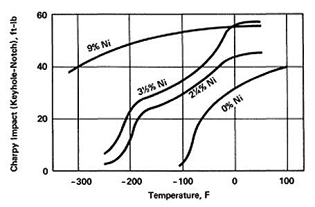

One alloy addition perhaps more familiar to knife steel nerds is nickel, which can improve room temperature toughness but is best known among metallurgists for improving low temperature toughness:
This image from [10]
While the studies shown above are for relatively low carbon steels, nickel also improves toughness in knife steels, such as with L6 tool steel which has a 1.5-2% nickel addition:
This data adapted from [11]
Perhaps it is the decrease in DBTT closer to room temperature that is what provides the improvement in toughness from nickel in knife steels like L6, since high carbon steels used in knives can have DBTT above room temperature.

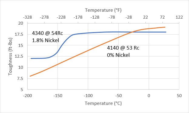

Finding toughness vs temperature data for higher carbon steels is very difficult. One good comparison is 4340 and 4140 steel, which are similar except 4340 has a significant nickel addition. The nickel addition gives 4340 quite a low DBTT, well below the temperature at which anyone would be using a knife. The 4140 steel has dropped very little in toughness down to quite low temperatures of -40° or so, meaning 4140 would also be ok for any temperature a knife would likely see.  However, in higher carbon steels the DBTT is already significantly higher, meaning the nickel addition to L6 is quite likely to help with toughness in cold temperature use.
This data adapted from [12]
Knife steels, with their high hardness and many brittle carbides, frequently have a yield strength that is already higher than the fracture strength at room temperature. Perhaps this is why the reduction in toughness at low temperatures is more gradual, because the yield strength is already higher than the fracture strength at room temperature. As mentioned before, low temperature toughness testing of tool steels and martensitic stainless steels is pretty limited.

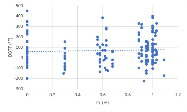

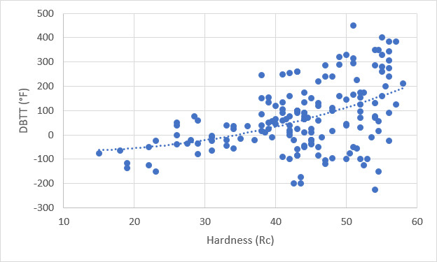

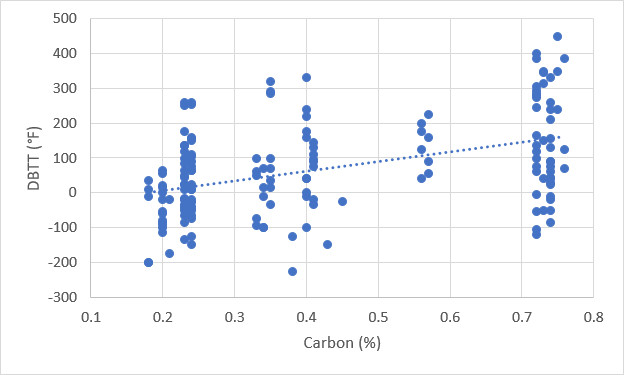

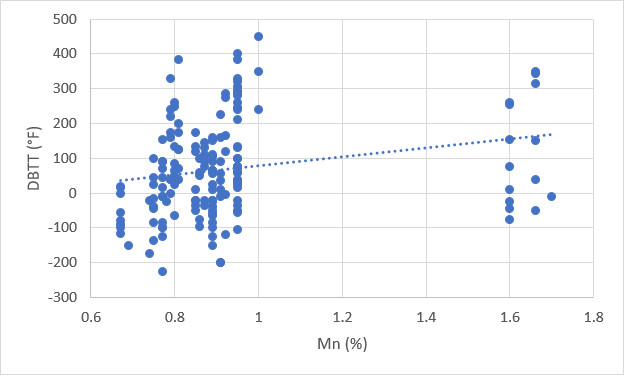

I found only one study [12] that looked at the effect of alloying and tempering on steels with more than 0.60% carbon. They looked at a range of carbon contents from 0.2-0.76C, but unfortunately they tempered no lower than 500°F with the higher carbon steels which is in the tempered martensite embrittlement range. With lower carbon steels they measured a lower DBTT at 300 or 400°F tempering. Here is the effect of tempering on DBTT with steels between 0.33 and 0.41% carbon showing that lower tempering temperatures are better:
Analyzing the full dataset [12] may be useful because they looked at so many variables, despite the use of non-ideal tempering temperatures with higher carbon steels. The studies cited above are a little idealized to show larger trends and effects but this relatively large study can give some feel for how different variables affect DBTT. Carbon and hardness show the strongest effect on the transition temperature. Those two factors are linked, of course. Phosphorous was the next strongest effect after carbon and hardness. Manganese was not found to be a positive unlike the study cited previously. Additions of Cr didn’t seem to change things one way or the other. Molybdenum had what looks like a stronger effect than nickel, at least in the range that was studied. However, there are some high DBTT values for the 3.5% nickel steels which are shifting up the nickel trend line.

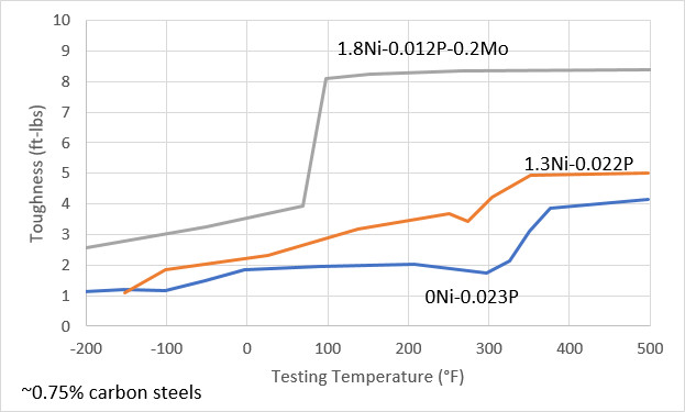

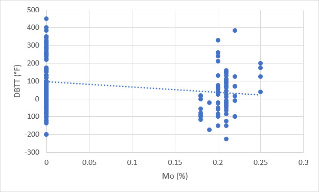

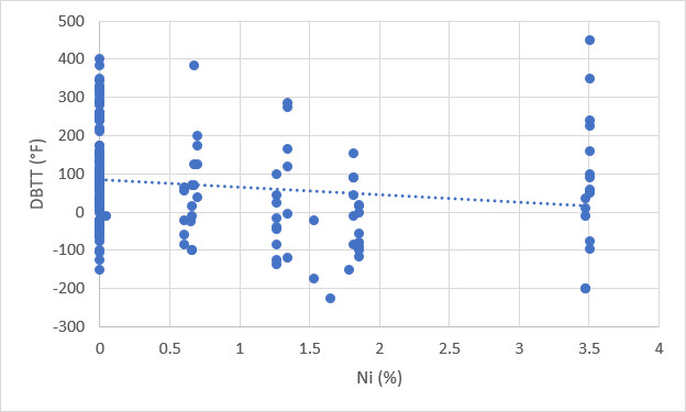

Phosphorous, Nickel, and Molybdenum in High Carbon Steel
Looking at only the 500°F tempering condition does reveal an effect of composition with steels above 0.70% carbon, despite the high likelihood of TME. An addition of nickel improves toughness and lowers the DBTT. Reducing the phosphorous in combination with a molybdenum addition helps toughness even more. The use of lower tempering temperatures and unnotched toughness specimens would lead to even better low temperature toughness.
Update 1/7/2019: I didn’t provide an explanation for why molybdenum helps with low temperature toughness. Molybdenum limits the negative effects of phosphorous by restricting the degree to which phosphorous segregates to grain boundaries [13].
Therefore, even though knife steels are inherently brittle to start with, there are ways to improve low temperature toughness. One way is minimizing the carbon content, especially for a given hardness. Rather than tempering down to a lower hardness, use a lower carbon steel. Using a steel that is at a higher toughness to begin with (higher fracture strength) will also lead to higher low temperature toughness. Buying steel with minimal impurities and nickel additions also help with improving low temperature toughness.

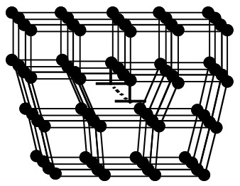

I more thoroughly introduced what dislocations are in the grain refinement article. While dislocations are called “defects” this is somewhat of a misnomer as these are not cracks or imperfections of the macroscopic steel. Any steel is filled with dislocations, it is essentially impossible to avoid them, and if somehow they were not present the steel would act much differently. When deformation of steel happens it occurs through the movement of these dislocations. Here is a video of of high resolution microscopy where you can see the dislocations moving throughout a metal:
Since deformation occurs through the movement of dislocations, to strengthen a metal you do it be limiting the movement of dislocations. One way to limit their movement is to introduce more dislocations, because they cannot move through each other. Quenching to form martensite massively increases the number of dislocations which is part of why martensite is so hard. Grain refinement means many more boundaries to impede dislocation motion. Tiny tempering carbides impede dislocation motion which is why high temperature tempering leads to an increase in hardness with high speed steels.

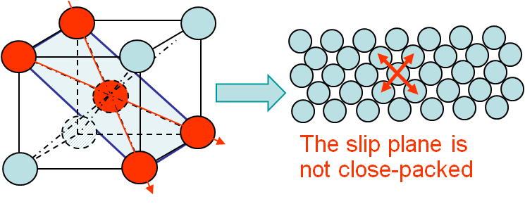

Dislocations travel along “close packed planes” of atoms which are the planes of atoms which are most tightly packed together. FCC has many close packed planes while BCC and BCT have no “true” close packed planes:
Close Packed Planes in FCC (austenite)
BCC (ferrite) and BCT (martensite) have no true close packed planes
Because martensite doesn’t have a true close packed plane, there is a thermal component to dislocation motion. Some temperature is necessary to feed energy into atomic movement to allow the movement of dislocations. With the close packed planes in austenite the dislocation movement is much less reliant on a thermal contribution. Therefore, as the temperature is reduced the dislocations are less able to move, making deformation more difficult which increases the yield strength of the material. This leads to the high sensitivity of yield strength to temperature.

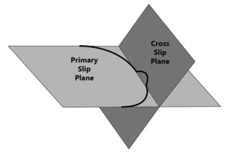

Nickel and manganese additions lead to the promotion of another type of dislocation movement called “cross slip.” Cross slip is the movement of dislocations from one plane to another. This is often observed experimentally with microscopy:
The promotion of cross slip by manganese and nickel means that yield strength is less sensitive to temperature which is what improves toughness and reduces DBTT.
