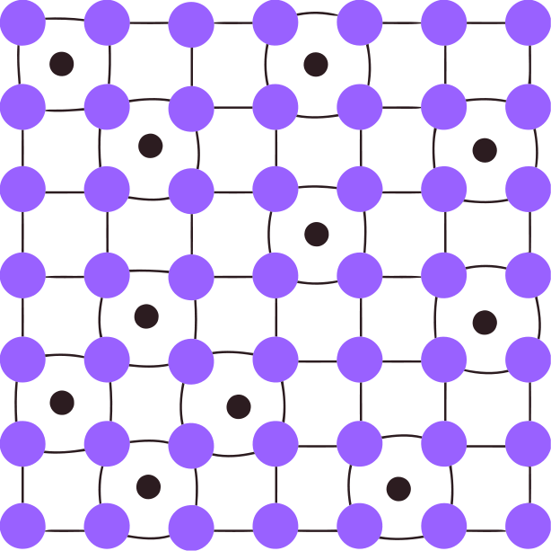

The carbon atoms are much smaller than the iron atoms so they are present in between the iron atoms, which is called an “interstitial” atom. These carbon atoms strain the bonds of the iron atoms which strengthens the material. Here is a handy schematic to better understand the strain on the atomic lattice (thanks Wikipedia) [2]:
The change in strength through the presence of other (non-iron) atoms is called “solid solution strengthening.” Carbon has a strong contribution to solid solution strengthening of ferrite and martensite behaves somewhat similarly [3]:
The strain in the lattice increases strength by affecting the movement of dislocations, which are line defects in the crystal structure that control strength of materials. I introduced them and described how they affect strength in the following article: How Does Grain Refinement Lead to Improved Properties? A couple important things to keep in mind from that article are the following:

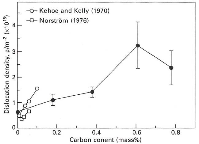

Dislocation Strengthening
When the shear transformation occurs a large density of dislocations is created to accommodate the strain created by the shift in atoms. As described earlier, a high density of dislocations leads to higher strength/hardness. Increased carbon in the martensite leads to a higher dislocation density which is in part where the higher strength of martensite comes from [8]:
You can also see that there is a drop in dislocation density from 0.6 to 0.8% which is the transition between “lath” and “plate” martensite. Plate martensite forms by a twinning mechanism instead which I won’t be getting into in this article. For simplicity’s sake, we will stick with the general conclusion that higher carbon leads to higher dislocation density which means the dislocations do not move as readily leading to higher strength/hardness.

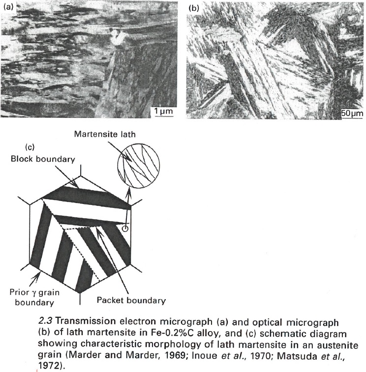

Boundary Strengthening

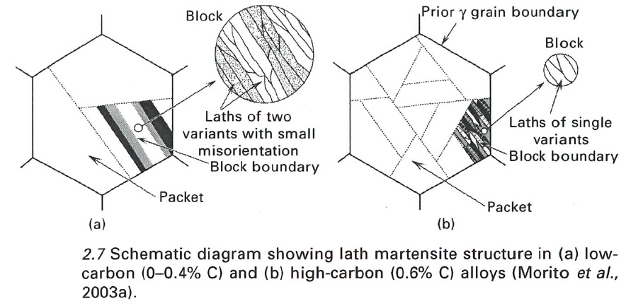

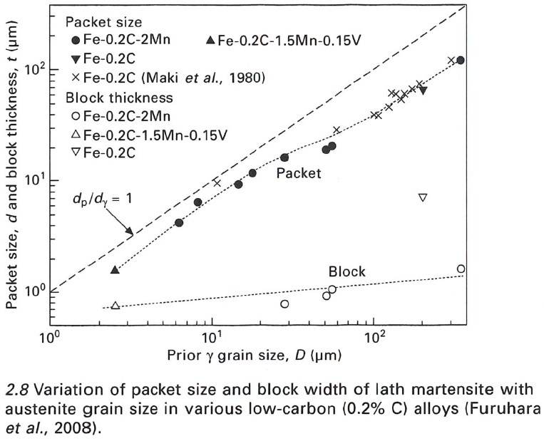

Grain boundaries are not the only boundaries that impede dislocation motion thereby increasing strength. Within martensite there are “packet” and “block” boundaries that also act to impede the movement of dislocations [9][10][11]:
If you watch the Youtube video I linked earlier in this article you may also be able to see the packets and blocks. A packet or block is a group of parallel laths, and the distinction between the two requires too much writing to cover here (same habit plane for packets and same orientation for blocks). Because the low-angle boundaries of packets and blocks also act to impede the motion of dislocations, the size of the packets or blocks is sometimes called the “effective” grain size of martensite. The size of the packets/blocks is reduced by decreasing the grain size, as is illustrated in this schematic [12]:

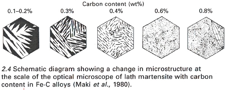

The size of the packets and blocks controls strength in a similar manner to grain size, which is why it is sometimes called the “effective” grain size. It makes a very similar plot to grain size vs strength, as was described in the grain refinement article that I will keep linking to until you actually click on it and read it. Here is a plot showing the correlation between grain size and packet and block size [12]:
Another important factor that controls the size of the packets and blocks in carbon content; the higher the carbon content the smaller the packets and blocks. This is another mechanism by which higher carbon leads to stronger martensite [13][14]:

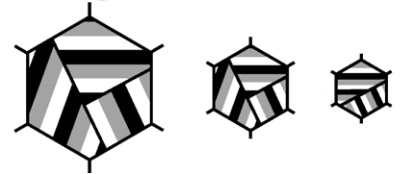

You can see in the schematic how the packets, blocks, and laths are decreased in size with increasing carbon content. You can also see in the 0.8%C steel that a “plate” of martensite was formed, which I described in the dislocation density section. Higher carbon leads to a shift between laths and plates [15]:
Martensite plates are generally not desirable because the toughness of plate martensite is lower than lath martensite, in part because of “microcracks” that are formed in plate martensite [16]:

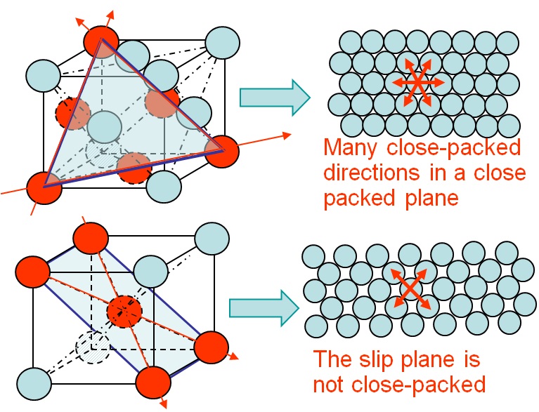

The type of crystal structure a material has controls the number of “slip planes” along which dislocation slip occurs. You might remember from the Effect of Grain Size article that you have definitely read by now that dislocation motion preferentially occurs along close-packed planes of atoms [17]:
The Body Centered Tetragonal (BCT) has a low number of slip planes available for dislocation motion so the microstructure itself makes dislocation movement more difficult. Higher carbon leads to more “tetragonality” of the microstructure.

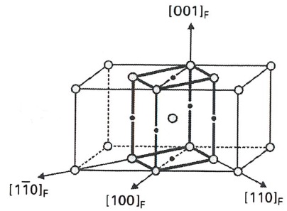

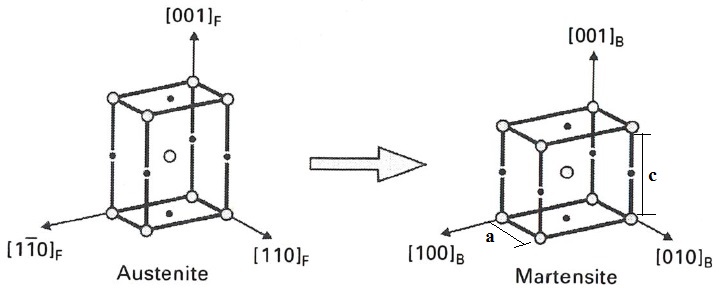

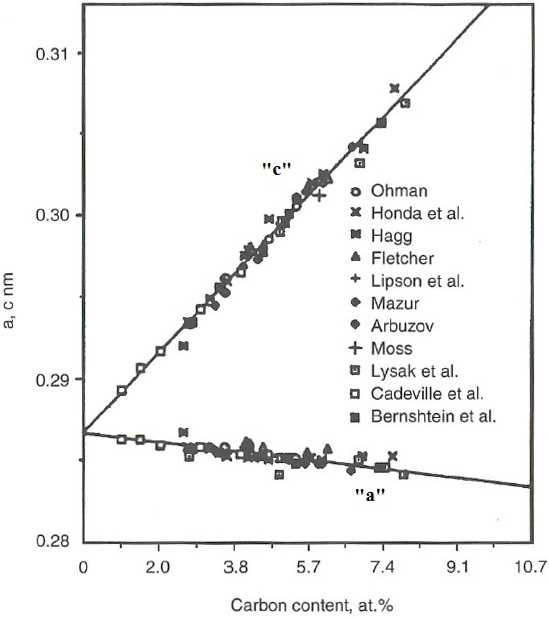

Bonus! Why is Martensite Tetragonal?

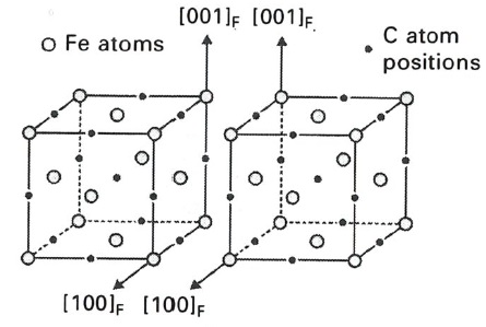

A question you may have asked yourself is this: why is martensite body centered tetragonal (elongated cube) rather than just a bigger cube? Why is the carbon preferentially located in one direction? Well I’m glad you asked, dear reader. We have to go back to the face centered cubic microstructure of the high temperature austenite, which has interstitial carbon atoms between its iron-iron bonds [19]:
There are two unit cells of austenite shown for a reason, because when you stick two of them together, you can find a unit cell that looks very much like body centered cubic ferrite, as is shown by the dark lines in this schematic [19]:
You can see that there are carbon atoms located on the “vertical” lines between iron atoms, but none located between the iron atoms in the sides of the square on top and bottom. This leads to a preferential increase in the vertical, or “c” direction, with a shrinking in the horizontal, or “a” direction, and therefore the degree of “tetragonality” is increased with higher carbon content [19][20]:

So hardness increases with carbon dissolved in BCC tetragonal iron, not the amount of carbon in the steel? Or does it once again harden more once you get to plate martensite only? And if so do we just get more easily hardening steels when the carbon content is above 0.6% because there is more carbon around to make sure the bcc iron is filled and the carbide formers are not too bare… so if we compare similar alloys one with 0.63% and the other with 0.73% carbon it will just be easier to get the higher carbon up to say 65rc as quenched… provided you dont overdo carbon in solution?
The carbon has to be present within the martensite to increase its hardness. If the carbon is present as cementite or other carbides then it will not increase the hardness of the martensite. “Overdoing” carbon in solution does not reduced hardness unless large amounts of retained austenite are formed. Plate martensite is not softer than lath martensite.
So why the decrease in hardness noted by the experiment? And why is 0.67% C often touted as the max amount of elemental c dissolved in iron? And how does this relate to the comment that plate martensite is weaker than lath martensite and the combo between lath and plate martensite is also considered weaker because ithe boundary between lath and plate often thought to be weaker?
There was a drop in dislocation density but not in hardness. See the figure near the bottom of the article that shows hardness vs carbon content. Hardness does start to plateau around 0.6%C or so. I’m not sure what the 0.67%C number is that you are referring to. You might mean 0.77%C which is the approximate eutectoid carbon content. But you can have more carbon in austenite than that, as I described in Austenitizing Part 1: http://knifesteelnerds.com/2018/02/28/austenitizing-part-1-what-it-is/
