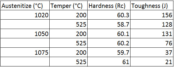

Also results are lacking when it comes to comparing low and high tempering temperatures when retained austenite is maintained at the same level. The reason is that using the upper temper converts the retained austenite to martensite but the lower temper converts very little in high alloy steels (see my tempering article). So generally higher toughness is found by using a low temper but that is attributed to the difference in retained austenite. For one example you can see these toughness numbers from Uddeholm Caldie [3]:
I am aware of one fracture toughness study of M2 high speed steel where they compared both cryo and non-cryo heat treatments which you can see here [4]:
There is a big drop in toughness around 540°C (1000°F) and then it increases above that. It’s a bit hard to tell in the figure but it appears that even with higher tempering (>540°C) to bring down the hardness the lower temper with cryo is still superior. In our study it also appears that toughness was higher when using 400°F temper rather than 1000°F:

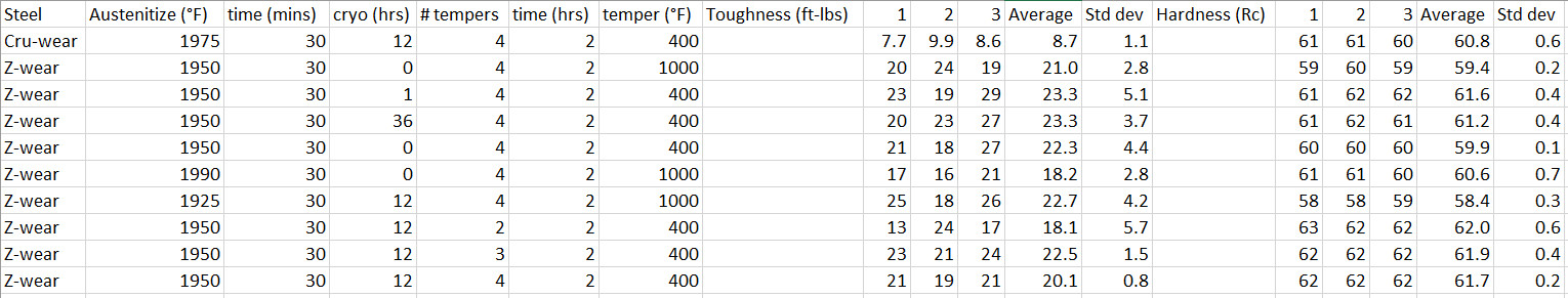

Somewhat surprisingly there is little change in toughness by using cryo, regardless of length of time. Due to variability, however, if there is any “real” difference in toughness the resolution of the test may not be high enough to tell without more repeated specimens. However, there was an increase in hardness with cryo so using the liquid nitrogen treatment led to a higher balance of hardness and toughness. Because of the overwhelming amount of research showing that cryo tends to somewhat lower toughness means that we probably can’t take this result as a hard and fast rule. Perhaps the retained austenite in the non-cryo version of Z-Wear didn’t have the right level of stability to improve toughness or there was too little of it to make much difference.
Warren uses 4 tempers with his Z-wear and he wondered if he needed all of those tempers. Usually there is an improvement in toughness by using 2 tempers instead of 1 one because any retained austenite that transforms to martensite during the first temper needs to be tempered in the second step (see the tempering article). An example of the improvement can be seen in this chart with Caldie [6]:
Warren used a minimum of 2 tempers:
There was less variability in toughness with more tempers but it is hard to tell if that is due to random chance or because of a real improvement. All other tests used 4 tempers and some of those showed higher variability than the heat treatment showed on the chart. So 2 tempers is probably enough, though if we go off just that chart then we might say that 3 tempers has a chance of a slight improvement in toughness.

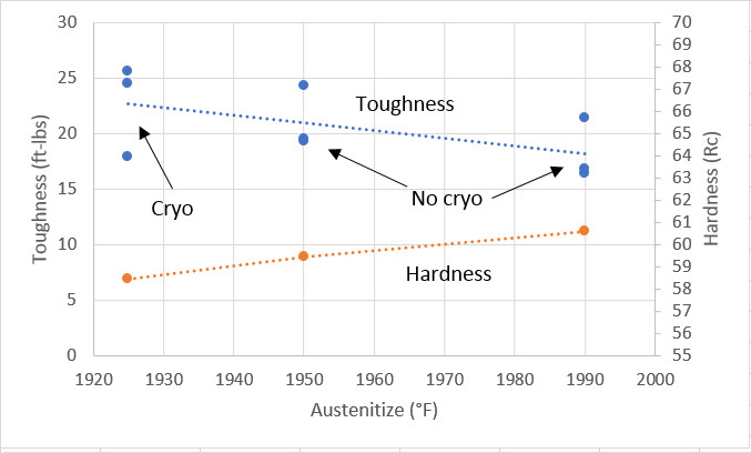

Warren also used a small range of austenitizing temperatures in an attempt to keep the hardness consistent with different cryo/temper combinations. In our previous CruForgeV toughness testing it was found that austenitizing temperature was very important for toughness, and this aligns with the literature which was described in Austenitizing Part 2. In the Z-Wear testing we performed, the lowest average toughness value of all conditions was found for the highest austenitizing temperature used, so again austenitizing temperature is a very important parameter for toughness:

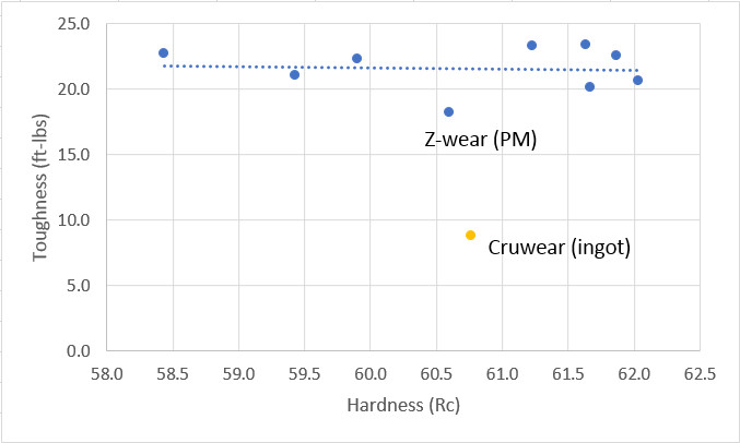

To see where Z-wear and Cru-Wear fit in with the other steels tested so far here is the big summary:
Z-wear was very flat for toughness relative to hardness. Perhaps some more variation in austenitizing temperature and tempering temperature would lead to higher values at lower hardness. However, the toughness at 62 Rc appears to be quite good. I’m looking forward to more steels and heat treatments being added in the future.
A low temperature temper (400°F) led to higher toughness than a high temperature temper (1000°F), even when using cryo so that each heat treatment has a similar level of retained austenite. Extended time in cryo had no effect on toughness, and in fact adding a cryo step did not affect toughness despite an increase in hardness with Z-Wear. Conventional CruWear had lower toughness than Z-Wear/CPM CruWear as expected due to larger carbides. An increase in austenitizing temperature led to higher hardness and reduced toughness. More than 2 tempers did not lead to improved toughness though 1 temper was not tested to see if there was a difference.
A summary of the raw data described in this article is shown here:

Am I right in thinking that the Cru-Wear datapoint in the toughness vs. hardness graphs corresponds to cast Cru-Wear, and that CPM Cru-Wear (e.g. as used by Spyderco) would have toughness properties more comparable with PM Z-wear?
Thanks again!
That is correct
