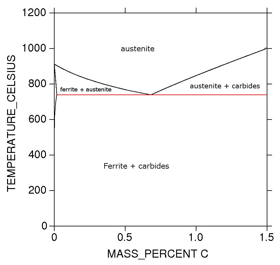

Losing Carbon
If you look at your iron-carbon phase diagram at room temperature, you don’t see martensite on it, but instead you see ferrite + carbides:

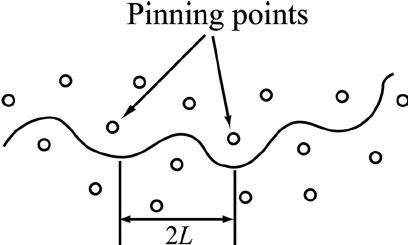

Precipitation Strengthening

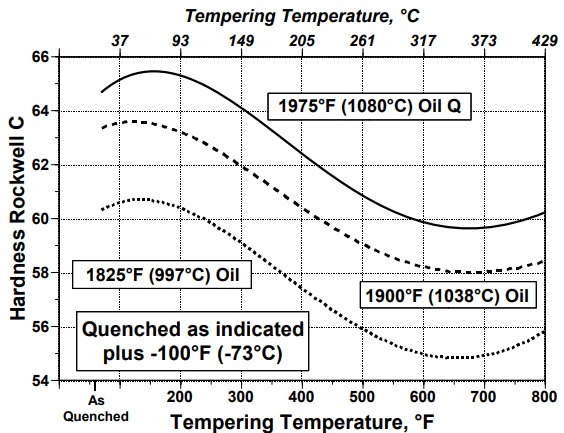

If you recall the tempering curve for 14-4CrMo you might remember that there was a small increase in hardness at very low temperatures:

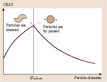

This small increase in hardness/strength comes from something called “precipitation strengthening.” In other words, the precipitates, or in this case carbides, are increasing the hardness of the steel. As I covered in an earlier post, strengthening comes from limiting the motion of dislocations: How Does Grain Refinement Lead to Improved Properties? Carbides can limit the motion of dislocations, as the dislocations cannot easily pass through them. With very small carbides, the dislocations cut, or shear, through the carbides, and with larger carbides the dislocations must loop around them [5]:
So when there is an array of carbides the dislocations must pass through or around many of the carbides [6]:
The movement of dislocations among a field of fine precipitates can be seen in this Youtube video [7]:
There is an optimum size of carbides for strengthening of steel. When the carbides are extremely small, the dislocations easily shear through them. When the carbides are too large, the dislocations can easily move around them. The result is an optimum size of carbides for peak strengthening [8]:

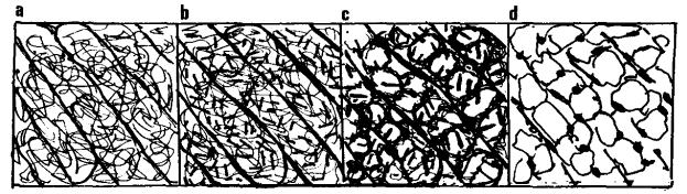

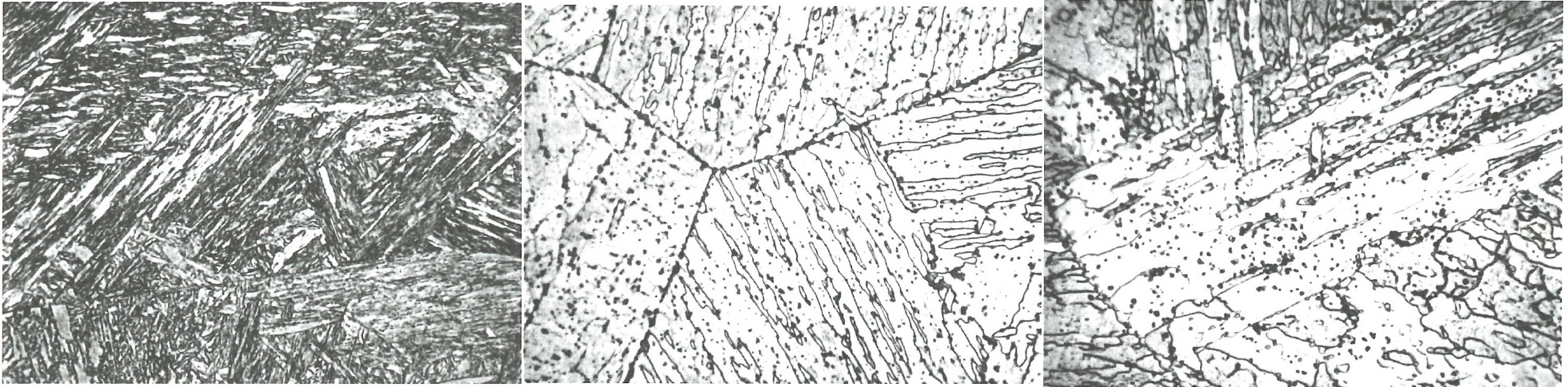

Changes in Martensite Structure

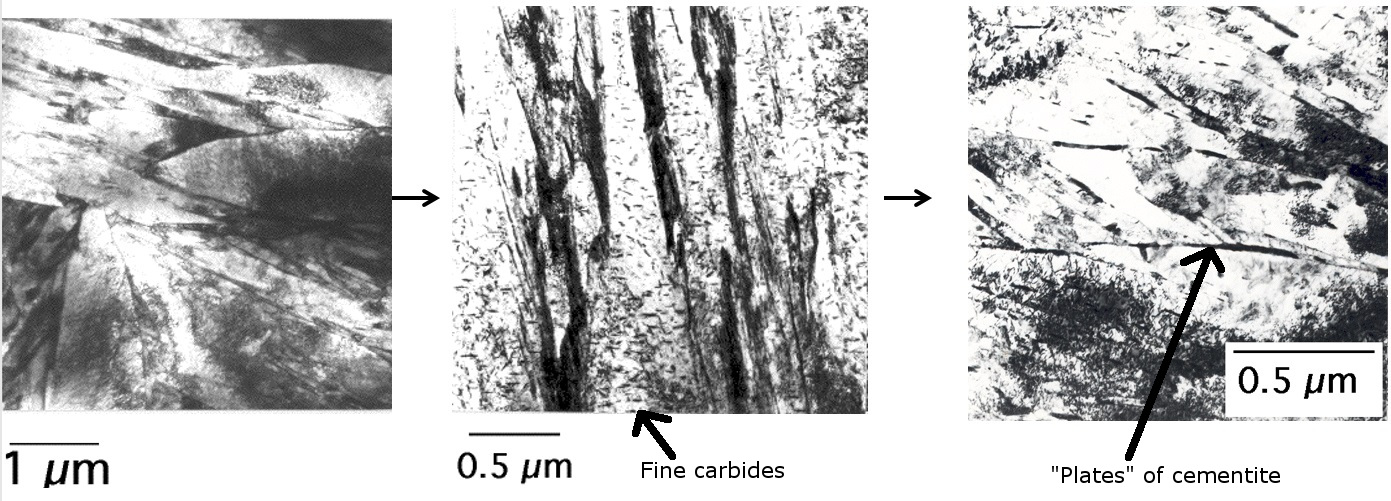

The martensite itself also changes during tempering. One change that occurs is that the “tetragonality” of the martensite is reduced as the martensite becomes more and more like cubic ferrite as the carbon leaves the martensite. Another change is that the dislocation density is reduced through tempering, as is shown in this schematic [9]:
In (a) the looping lines represent the dislocations within the laths (the thicker straight lines) which represents the quenched, untempered martensite. Then (b) shows the small black linear cementite within the laths surrounded by dislocations which represents martensite tempered around 500°F. The image in (c) shows that the dislocations have become recovered “cells” of dislocations that are low-angle boundaries, which represents martensite that has been tempered at 1000°F. And finally (d) shows recrystallized martensite that has transformed completely to round ferrite grains which also contains larger carbides.
These changes can also be seen in the following micrographs [10]:
The left-most image shows lightly tempered martensite where laths are “dark” due to their high dislocation density. The middle image shows a recovered martensite microstructure after tempering at 1290°F for 2 hours, where the martensite is “clean” and white showing low dislocation density but the lath boundaries are still visible. The right image shows the steel tempered at 1290°F for 12 hours where the beginning of martensite recrystallization is visible, where the round grains of ferrite have begun replacing the martensite laths.

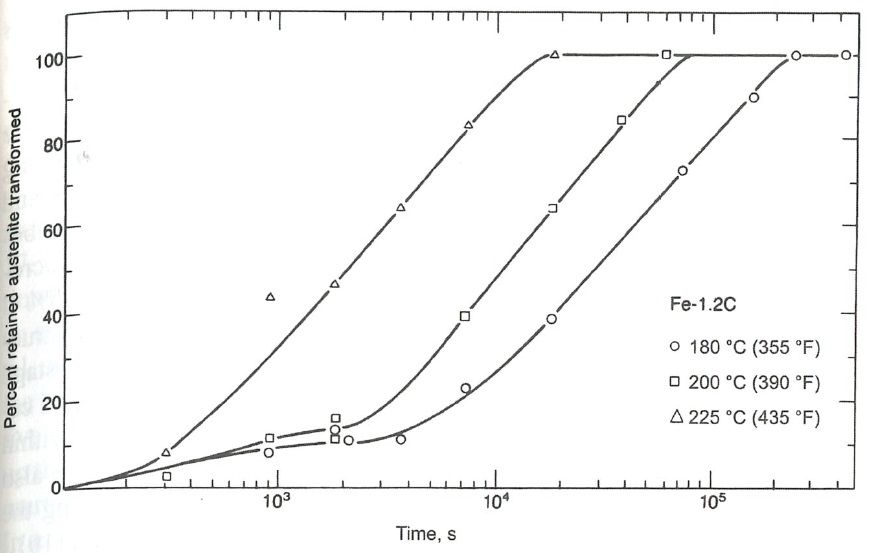

Retained Austenite
Several things can happen to retained austenite during tempering [12]:
  1. Stabilization of retained austenite so that it does not easily transform with further tempering or cold treatments
  2. Decomposition to bainite or other “ferrite plus carbide” phases
  3. Destabilization leading to the formation of untempered martensite after cooling from the tempering temperature
Stabilization of retained austenite can occur through the diffusion of carbon from martensite to the austenite, rather than by precipitating as carbides. Higher carbon in austenite stabilizes it by reducing the martensite start temperature [13]. Stabilization occurs most often when tempering at relatively low temperatures where austenite decomposition does not occur.
Decomposition to ferrite plus carbides or bainite occurs similarly to austempering, where steel is rapidly cooled to an intermediate temperature and held to form bainite rather than cooling to room temperature to form martensite. Bainite is an intermediate phase which can look somewhat similar to tempered martensite as it is a lath-like phase with carbides within it and between the laths. So even though the steel has been cooled to room temperature, the remaining austenite still behaves similarly as it would during austempering if the steel is reheated to a temperature at which bainite forms. This transformation occurs with low-alloy steels but can be suppressed with sufficient additions of certain alloying elements [12]. Here is a graph showing the decomposition of austenite with time at three different tempering temperatures in a 1.2C simple steel [14]:
With the majority of highly alloyed tool steels, high speed steels, and stainless steels, bainite formation is very sluggish due to the high levels of alloying. The steel loses its austenite to destabilization instead where the austenite transforms to martensite upon cooling from the tempering temperature. This works through the precipitation of carbides out of the austenite; the loss of carbon from the austenite raises the Ms temperature above that of room temperature so that martensite forms on cooling. This is the reason that multiple tempers are recommended, as this newly formed martensite is brittle and should be tempered.
Higher amounts of alloying such as chromium additions raise the temperature at which the austenite decomposes or destabilizes, such as when comparing a 1.25% Cr steel with a 5.0% Cr, 2.3% Mo steel [12][15]:
Even with the 1.25% Cr steel, however, there is still some retained austenite when the steel was tempered at 400°F, therefore tempering is not guaranteed to transform all of the retained austenite, depending on the steel in question, the chosen tempering temperature, etc.

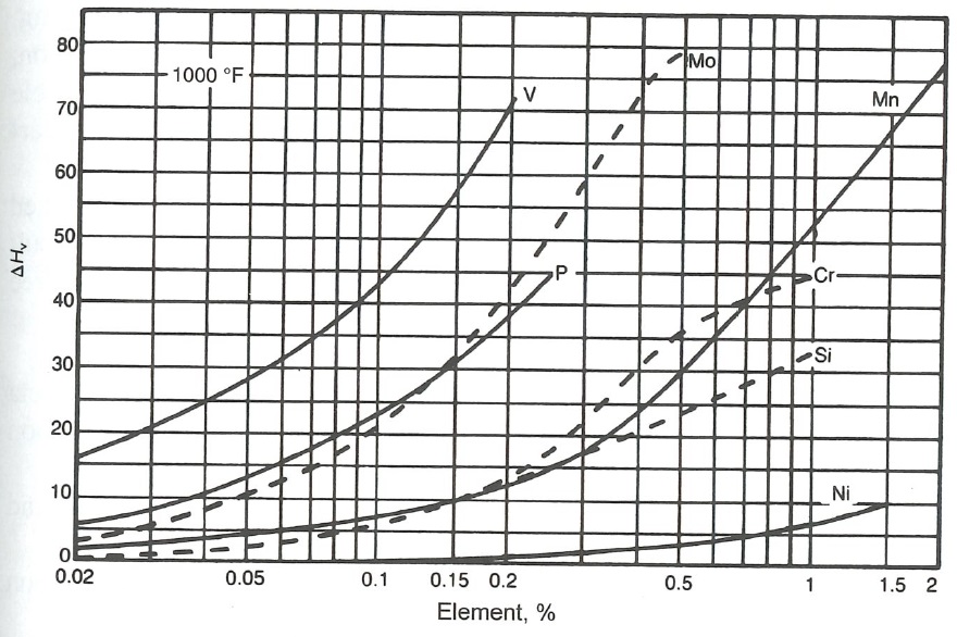

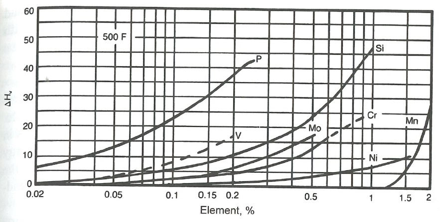

Effect of Alloying Additions on Strength of Martensite
Different alloying elements can affect the tempering behavior of steel, such as described above with carbide formation for secondary hardening, or shifting the decomposition of retained austenite to higher temperatures. Another effect comes from “tempering resistance” where the softening of steel is reduced for a given temperature. To summarize the effects, alloy additions work through a few major mechanisms:
  1. Suppress the formation and coarsening of transition carbides or cementite so that carbon remains in the martensite
  2. Suppress the recovery of martensite
  3. Solid solution strengthening
  4. Formation of carbides that lead to precipitation strengthening
The result is that some steels can be tempered at relatively high temperatures with little loss of strength, such as is illustrated here [12]:
Class 1 shows the loss of strength with tempering for a typical high carbon steel, where the class 2-4 steels have different alloying elements added that lead to different tempering behavior. Class 2 shows high alloy tool steels like D2, but without significant additions of Mo, W, or V for secondary hardening. Class 3 shows high speed steels with significant secondary hardening from Mo and/or W additions. And Class 4 is a medium carbon tool steel with significant Mo or W additions that has initially lower hardness due to lower carbon, with both tempering resistance and some secondary hardening.
The general effect of alloying elements on as-tempered hardness can be seen with these two figures with tempering temperatures of 500°F or 1000°F [16]:

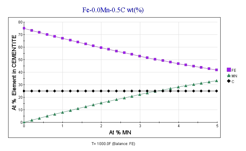

Phosphorous increases strength primarily through solid solution strengthening (see this article for more information). With 500°F tempering there is no major contribution from precipitation strengthening, so most of the elements are contributing to higher martensite strength through solid solution strengthening, suppression of carbide formation, or martensite recovery. Silicon contributes to solid solution strengthening and tempering resistance. At 1000°F the contribution of secondary hardening becomes dominant where V and Mo have very strong contributions to strengthening of martensite.
The suppression of carbide formation or carbide coarsening occurs with alloy additions like Mo, Cr, or Mn because a more complex cementite carbide is formed [16]. In other words, instead of Fe3C cementite, there is a complex M3C carbide where M can refer to Fe, Mo, Cr, Mn, etc. When other alloying elements are forming along with the iron, then the diffusion rates of those elements factor in to the rate of tempering, because they all diffuse more slowly than the small interstitial carbon. Therefore the rate of carbide formation (kinetics) is slowed by the formation of complex carbides. This can be seen with JMatPro calculations of the composition of cementite with increasing manganese, where carbon remains at 25% atomic weight, but iron decreases and is replaced with manganese:
The rate of recovery of the martensite is also controlled in part by the effect of these alloying elements on the formation and coarsening of carbides [16]. When the carbides are smaller and more evenly distributed, then the carbides act to “pin” the dislocations and low-angle boundaries so they are not able to move as easily and therefore recovery and recrystallization of martensite is suppressed.

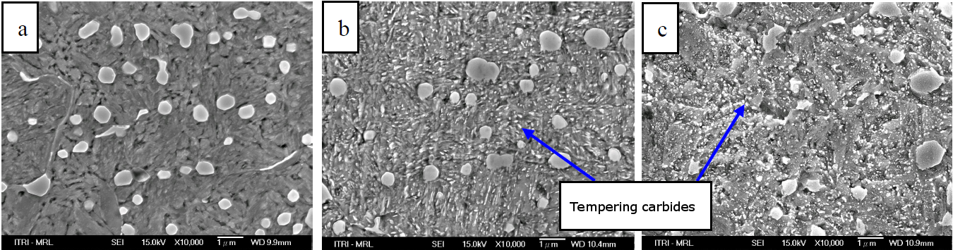

However the carbides that form during tempering are much smaller than even those small carbides. Micrographs below are for 440M [17], a similar steel to AEB-L and 13C26, where you can see the as-quenched microstructure at higher magnification with the relatively large 1 micron carbides (a), after tempering at 300°C (b) and 500°C (c):
The carbides after tempering here are relatively large in terms of tempering carbides; at 300°C the carbides are well past the point of significantly contributing to precipitation strengthening. They are certainly much larger than the 2-4 nm transition carbides. However, it is evident that the carbides formed during tempering are still much smaller than the larger carbides formed at higher temperatures in high carbon steels, tool steels, and stainless steels.

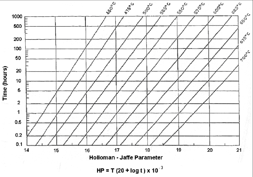

Because tempering is a diffusion-controlled process, the degree of tempering is controlled both by temperature and time. The higher the temperature, the faster the diffusion of elements and therefore more rapid tempering. However, lower temperatures with longer holding time can also lead to the same degree of tempering. Hollomon and Jaffe studied this way back in the 1940’s [18], and found behavior that looks like this:
They found that tempering worked with following relationship: H = T(C + log t) where H is the Holloman-Jaffe parameter, T is the temperature and t is the time. C is a constant which they found varied with composition and they determined that it was 19.5 for low carbon steels and 15 for high carbon steels and tool steels. Therefore hardness is controlled more strongly by temperature because time is on a log scale. Looking at the figure above, reaching a point labeled as “16” takes over 100 hours at 450°C and less than 15 minutes at 550°C.

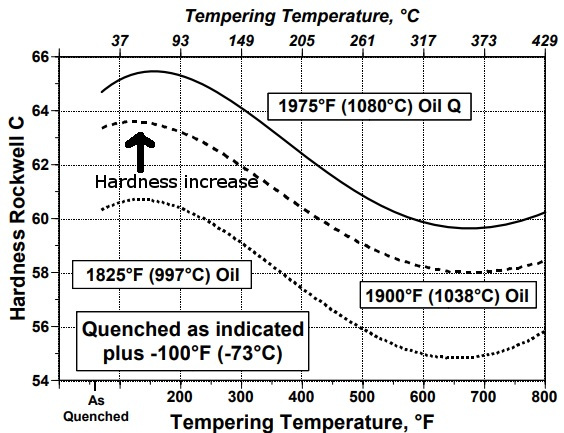

  1. mmm… so would a soak at 170F make more carbides that stay put, than what the steel would make passing through 170f on its way to 300-350f?
      1. In general longer time at higher temperatures makes the carbides more stable as they become coarser and therefore more stable. However, in either case if the steel was heated to a yet higher temperature they would continue to coarsen.
