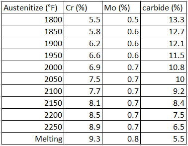

With increasing austenitizing temperature (the high temperature steel is heated to prior to quenching) there is more dissolution of carbides and therefore more chromium in solution for improving corrosion resistance. This can be calculated with Thermodynamic software that estimates the amount of carbide and composition of the matrix at different temperatures. Here are calculations for D2:

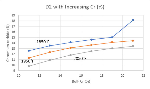

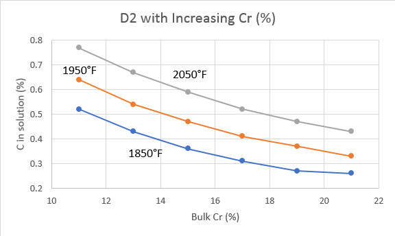

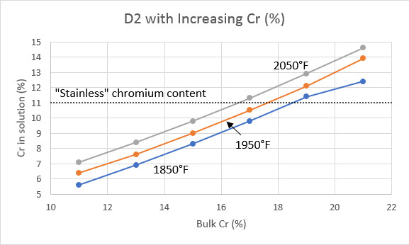

Because of the high carbon and chromium content of D2, a certain fraction of chromium carbide is stable all the way up to the melting temperature. Therefore the chromium in solution maxes out at 9.3%, though that is at an unrealistically high austenitizing temperature where grain growth and poor toughness are likely. With an increase in chromium content, however, the chromium in solution can be increased. The higher chromium content also shifts the optimum austenitizing temperature, so I showed 1850°F (common temperature for D2) along with higher 1950 and 2050 °F temperatures which are in the range for stainless steels:

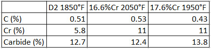

So to reach the somewhat arbitrary 11% chromium in solution, at least 16.6% Cr is required for 2050°F, and 17.5% Cr is required for 1950°F. The higher value of 17.6% Cr or so may be somewhat more realistic because 2050°F is a relatively high austenitizing temperature, higher than some furnaces can reach. Increasing Cr also decreases the carbon content in solution (which controls final hardness) and also increases the carbide content (higher wear resistance and poorer toughness). D2 with 16.6% Cr at 2050°F has similar carbon and carbide content but with the higher chromium in solution we are looking for. D2 with 17.6% Cr at 1950°F has somewhat higher carbide volume and lower carbon in solution, which would likely mean a reduction in hardness by 2-3 Rc:

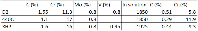

A higher chromium stainless version of D2 is essentially Carpenter’s XHP steel which has 1.6%C and 16.0%Cr. The datasheet for XHP [3] says, “It can be considered either a high hardness 440C stainless steel or a corrosion-resistant D2 tool steel.” The compositions are shown below:
The chromium content is a little lower than the minimum 16.6% we calculated with Thermodynamic software, though the datasheet claims that XHP has “equivalent” corrosion resistance to 440C. They may be using a generous definition of “equivalent.” They also have data on toughness which appears to be similar to D2 [3][4], where izod unnotched impact toughness is approximately 27 ft-lbs at 60.5 Rc for both D2 and XHP. Abrasion resistance is also similar as shown below [3]:
