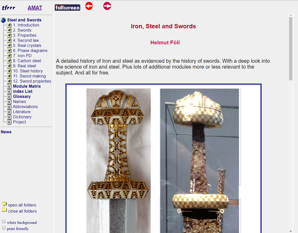

Iron, Steel, and Swords
This book is freely available on the website of the author, Helmut Föll: https://www.tf.uni-kiel.de/matwis/amat/iss/index.html This book was also written by an emeritus Materials Engineering professor, only Dr. Föll is German. These retired professors are working too hard! It looks like the book came out in 2015 though he mentions in another part of the site that there is an unfinished chapter. As you can tell by the title the author does cover a significant amount of material on the history and properties of swords. Dr. Föll has a very personable style where he frequently lets his personality out, rather than hiding it behind technical language. As he says in his introduction: “If you have ever tried to get some information about swords and steel, the Internet provided you with plenty of stuff. You have found hardcore science articles, more or less incomprehensible, and straight balderdash, to use a polite word that starts with ‘b’.” He uses few references, many photos, and uses repetition or emphasized phrases to illustrate certain points. The combination of his personality and use of imagery and metaphors makes it very entertaining reading. Despite his rejection of academic styling, he often gets more technical than Verhoeven with the use of fundamental principles such as thermodynamics and dislocations. However, he does a very good job of explaining all of these principles to the reader who is willing to try to understand. He didn’t stop at fundamental metallurgy, there are sections on the history of steel, the history of swords, effects of alloying elements, and how the metallurgy applies to specific sword and edge properties.
