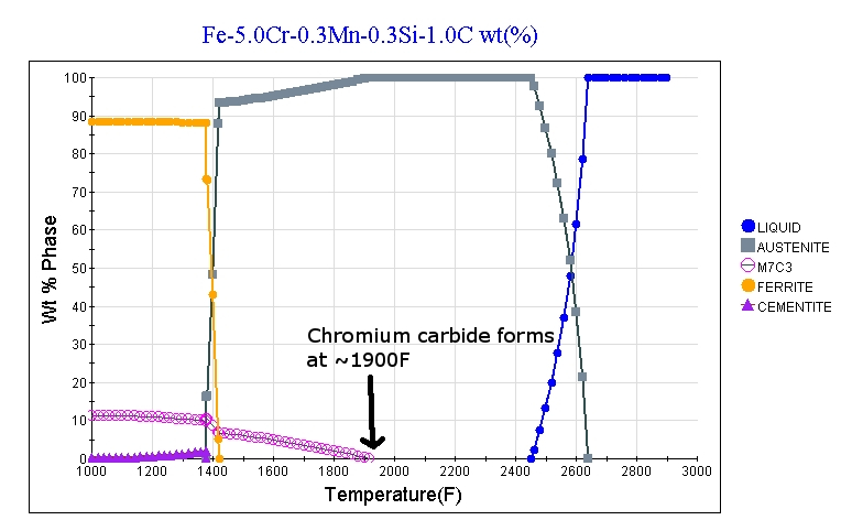

High Temperature Carbide Formation
The chromium carbides are referred to as either “primary” or “secondary” carbides. Primary carbides are those that are formed during the slow cooling of the casting process from liquid. Secondary carbides are those that have dissolved and then re-formed, or precipitated, during thermal processing. Typically secondary carbides are smaller than primary carbides. Therefore we would like to eliminate primary carbides if possible. At 5% or 10% chromium the chromium carbide (M7C3) forms after the steel has completely solidified as the high temperature phase austenite (read about austenite here). The carbides also form at temperatures close to or below typical forging temperatures (~2100°F) so with well-designed processing the carbides are dissolved and re-precipitated during forging so that they are reduced in size. However with the 15% or 20% chromium conditions shown above the chromium carbides are first forming in the liquid. The chromium carbides form concurrently with austenite and form a structure sometimes called “ledeburite.” Because the transformation of austenite and carbide is concurrent the temperature that the carbides form doesn’t continue to increase with further chromium addition but the amount of carbide increases with higher levels of chromium. Therefore the 20% chromium condition sees carbide formation at a similar temperature to 15% chromium but the amount of ledeburite is greater. Ledeburite contains both austenite and carbide in an interesting structure [2]:

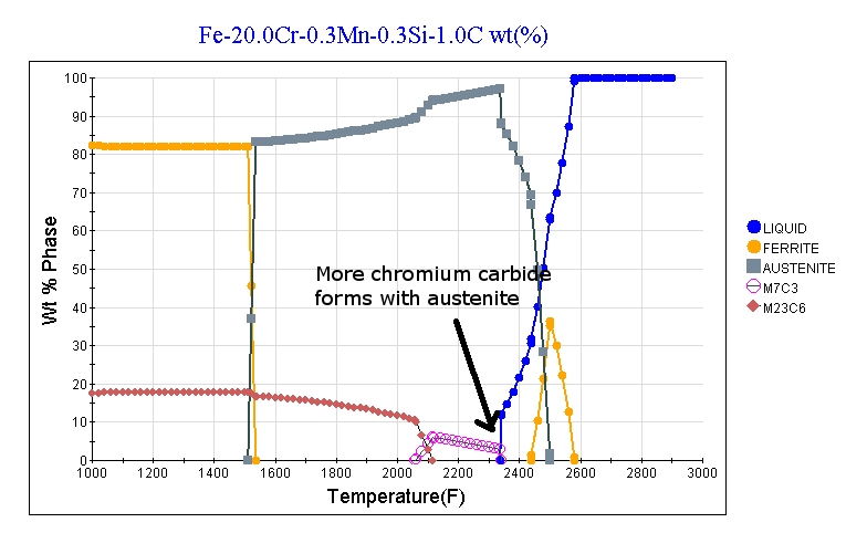

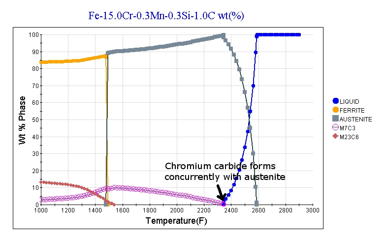

With the ledeburite structure the carbides form in the liquid where they are even larger than when formed in the solid and are difficult to break up in forging. Furthermore, because they are stable in a partially melted steel it is impossible to dissolve them by high temperature processing and/or forging. Larger carbides are more stable than small carbides so extended time at high temperature is more likely to lead to an increase in carbide size rather than the reverse. Forging does help to reduce the amount of segregation in the cast steel and to reduce the carbide size, however [3]:
Despite the improvement in structure, however, the primary carbides can only be reduced in size so much for the reasons described above, and steels like 440C, D2, and 154CM with conventional casting and processing still have carbides that are greater than 10 microns, and those large carbides lead to reduced toughness. Here is an example of D2 where the large grey particles are the primary chromium carbides, compared with 13C26 below it with much finer secondary carbides:

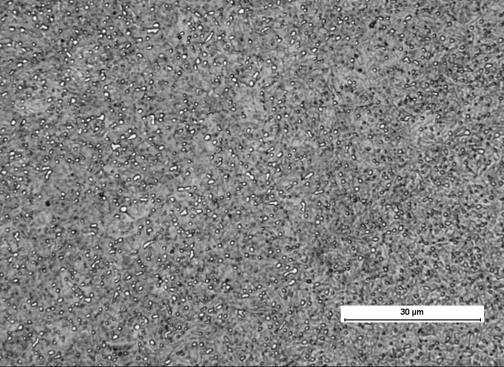

13C26 with fine secondary carbides

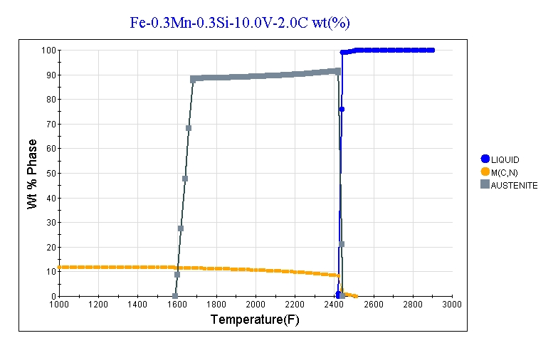

Other carbide types can cause even bigger problems, as instead of the ledeburitic structure (carbide+austenite) they form independently in the melt. One good example is vanadium where the vanadium carbides form at higher and higher temperatures in the liquid steel with further increases in vanadium. The high temperature and rapid diffusion in liquid steel means that the carbides can grow to very large sizes. Their stability in the liquid also leads to the same problems described above where the carbides cannot be eliminated through thermal processing or forging. Here are JMatPro calculations of 1%, 2%, and 10% vanadium showing the high temperatures at which the carbides form, see the yellow dots labeled M(C,N) for 1%, 2%, and 10% vanadium:
It had previously been discovered that with higher carbon contents that vanadium could be increased to high levels for better wear resistance (see this article on development of high vanadium steels). However, there there was somewhat of a limit of viable vanadium additions in steel of approximately 4% vanadium where the steels would be too brittle to be practical and the carbides would simply be too large.

When all that process is complete you end up with a steel that has a much finer and more uniform carbide structure than in a conventionally cast steel, such as can be seen in a comparison with 154CM and CPM-154 below:
Conventionally Cast 154CM
Powder Metallurgy CPM-154

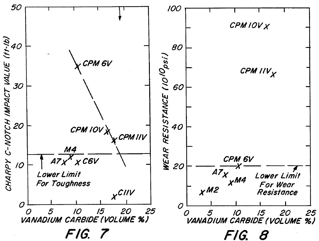

Crucible metallurgists recognized early on that the powder metallurgy process would allow them to develop steels with higher vanadium contents. This is desirable because of the very high hardness of the vanadium carbides. Because of the large size of the vanadium carbides it was not possible to design steels with sufficient toughness as well as a high vanadium carbide content with conventional casting of steel. When the vanadium carbides are small then it is possible to have a very high combination of wear resistance and toughness because toughness is primarily controlled by carbide volume fraction (higher means less toughness) but wear resistance is higher for given amount of carbide if the carbides are harder. This use of vanadium carbides for better toughness/wear resistance combinations was described as early as 1972 by Crucible in a patent on high speed steel [12]. These early Crucible powder metallurgy process and steel patents were all filed by Gary Steven but I have been unable to find much more information on him. He was a metallurgist at Crucible and based on his patents appears to have been a fundamental part of Crucible’s powder metallurgy development. He also worked on bearing steels, the development of which is described in the 154CM article.
Crucible metallurgists next took this vanadium-alloying concept to its logical conclusion in the development of 10V steel with its 10% vanadium content [13]. The USA patent was filed in 1978 but an earlier British patent was first filed in 1973 [14]. The final American patent was filed by Walter Haswell and August Kasak [13]. They developed a steel which formed primarily vanadium carbides and therefore had higher wear resistance than other steels available at the time. The steels were also able to have sufficient toughness by the use of powder metallurgy:
