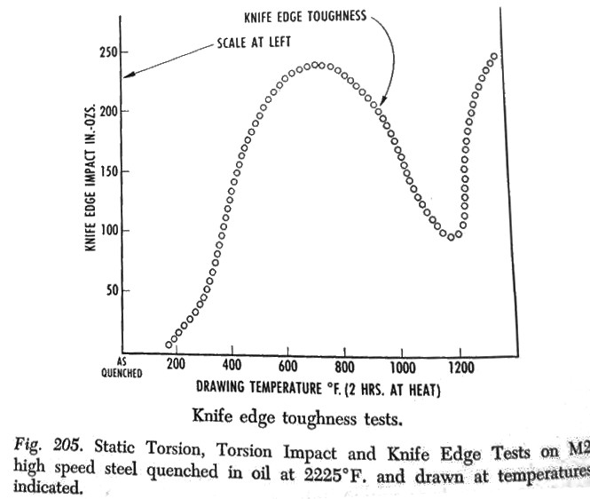

They then produced a plot comparing edge toughness against tempering tempreature for the M2 steel austenitized at 2225°F:

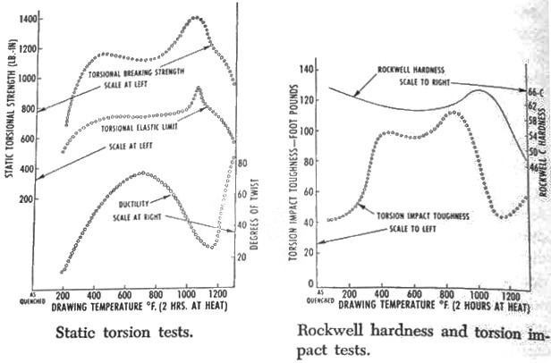

Highest toughness correlated with the lowest hardness, and showed a great decrease in the initial secondary hardening range (800-1200°F) due to increase in hardness and the transformation of retained austenite (see my article on tempering). They compared the knife edge toughness against several other measures of mechanical properties:

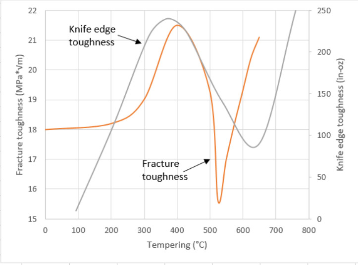

The comparisons were made with torsion tests which are simply twisting a bar of steel until it fractures. The strength required to break is the torsional strength. The strength required to yield, or begin plastic deformation, is the elastic limit. Torsion impact toughness is a rapid twist of the steel so that toughness is measured. Poor correlation was found between the edge toughness test and torsional strength, torsional elastic limit, and torsional impact toughness, with a strong correlation with torsional ductility. Torsional ductility is the amount of twist a bar undergoes prior to fracture, and is similar to strain in a tensile test. However, there are other tests that they did not compare with, such as pendulum impact tests or fracture toughness. Fracture toughness, for example, shows a peak in toughness at a similar tempering temperature [3]:

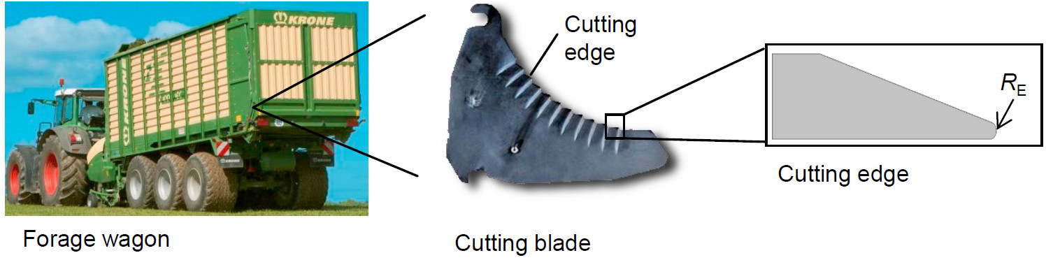

Impact tests have also been reported for agricultural blades [4][5] which are single bevel as well:

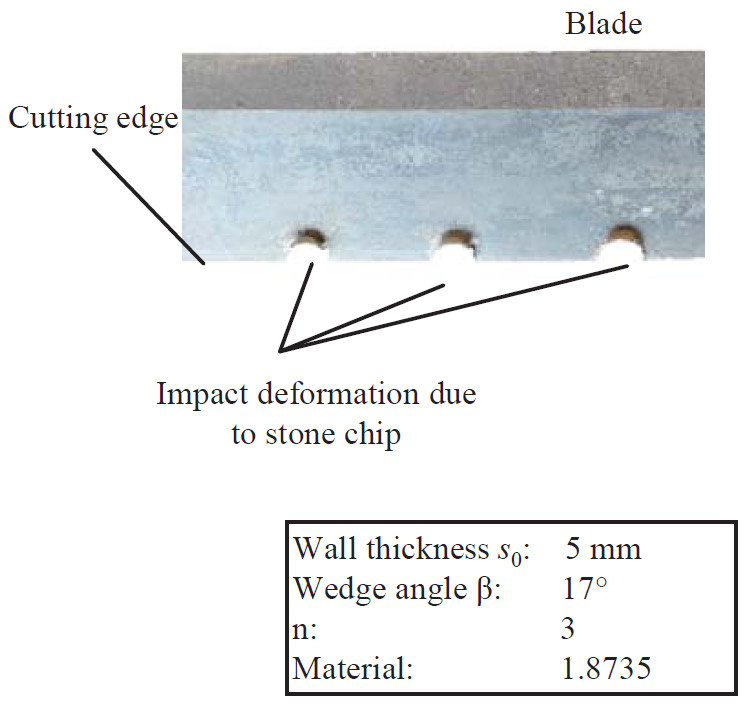

A test was performed with a pendulum impact tester using simple single bevel blades to mimic the cutting edges of the agriculture blades. The test overall is very similar to that described in Tool Steel Simplified. The hammer was dropped from an unspecified height and the degree of deformation was measured. I emailed the primary author of the study for more information such as the energy used of the impact tester, what type of impact hammer was used, orientation of the sample relative to the hammer, etc. but he wouldn’t tell me anything. However, it appears that the amount of deformation and/or chipping of the edges was relatively significant:

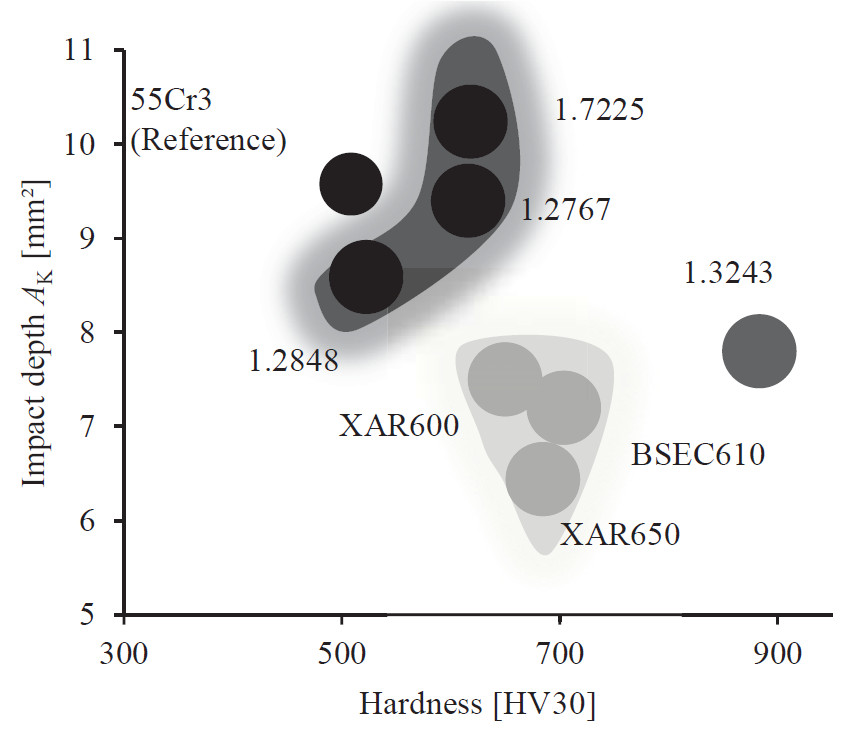

When comparing different steels it is apparent that hardness is an important parameter, presumably because higher strength would reduce the amount of deformation that occurs in the edge. However, there are still differences between steels independent of hardness:
Almost all of the steels that were tested are medium carbon steels meaning they are unlikely to have much in terms of carbides while 1.3243 is a high speed steel which does have some primary carbide making fracture initiation easier. Perhaps that is why XAR650 showed superior behavior to 1.3243 despite its lower hardness; the high speed steel fractures more easily due to carbides. However, none of that is confirmed or described in the referenced paper.

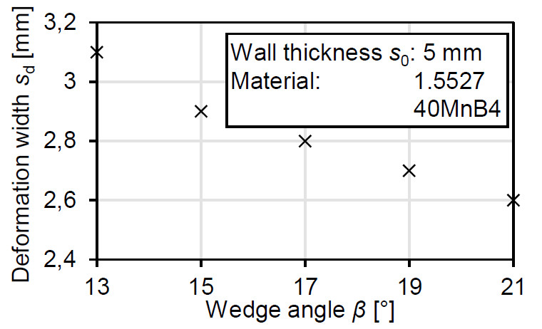

The researchers also tested a range of different edge angles where, as expected, a more acute edge led to more deformation during the impact testing.
