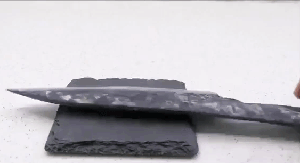

The next shift in topic that he made is the one that brings us to this article, and that is using his waterstones to produce knives out of various odd materials, the first of which with “the World’s hardest food.” This was a video of making a knife out of dried bonito, which he states “holds the Guinness record for world’s hardest food.” I haven’t checked him on that but I will take his word for it. He used a food slicer and a file to make the knife followed by waterstones to sharpen it. He demonstrated its sharpness by cutting paper and its durability by puncturing a can:
A somewhat similar pattern is shown in the rest of his videos, using hand tools like files, hand operated drills, and sharpening stones to produce the knives. He often demonstrates extreme patience in producing the knives. Much more patience than I have. I asked him why he doesn’t use any power tools and he said, “The material I make is very weak. Power tools can destroy materials.” He began producing many of these videos with making knives out of different materials. He usually names them with “sharpest ____ kitchen knife in the world” hence the title of this article. Starting with the chocolate knife, the majority of them use the same design as the $1 kitchen knife that he sharpened with the expensive water stones.

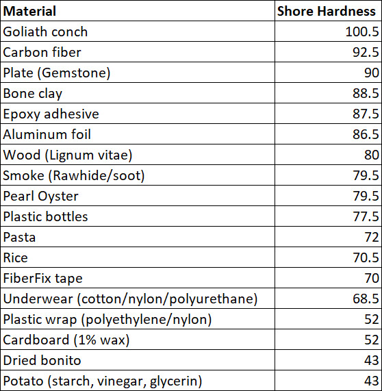

After he started using the hardness tester he stopped providing a sharpness ranking and started providing the hardness value of each material instead.

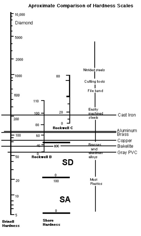

The Shore D scale doesn’t overlap with the Rockwell C scale (see “SD” below), though there may be less reliable readings at the top end of the Shore scale (~100). Therefore in general these materials are much less hard than the steels we generally use in knives:
Hardness correlates with strength, which means that higher hardness material will resist deformation of the edges better than low hardness materials. This is easy to visualize by thinking about using a knife made of cardboard or chocolate. It is easy to imagine such a knife bending or the edge rolling. When the material is less likely to deform that also makes it more feasible to sharpen it to a fine edge, which is why I think hardness correlates strongly with his previous “sharpness” scale.

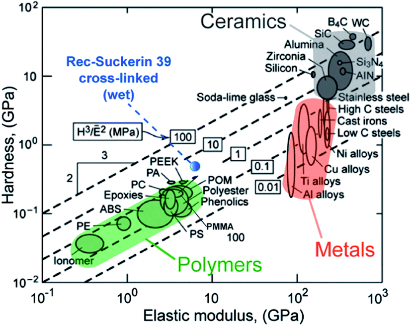

A similar though somewhat different property is “elasticity” or “elastic modulus” of the material. Cardboard, for example, will flex some before it stays permanently deformed. The resistance to flexing prior to permanent deformation is the elasticity, and elasticity does not necessarily correlate with hardness. You can read more about elasticity in this article about flexing and bending. The hardness of steel can be changed to a wide range of values but the elasticity does not change as it is controlled by the strength of the bonds between iron atoms. However, when looking at a wide range of materials elasticity does tend to correlate with hardness [1]:

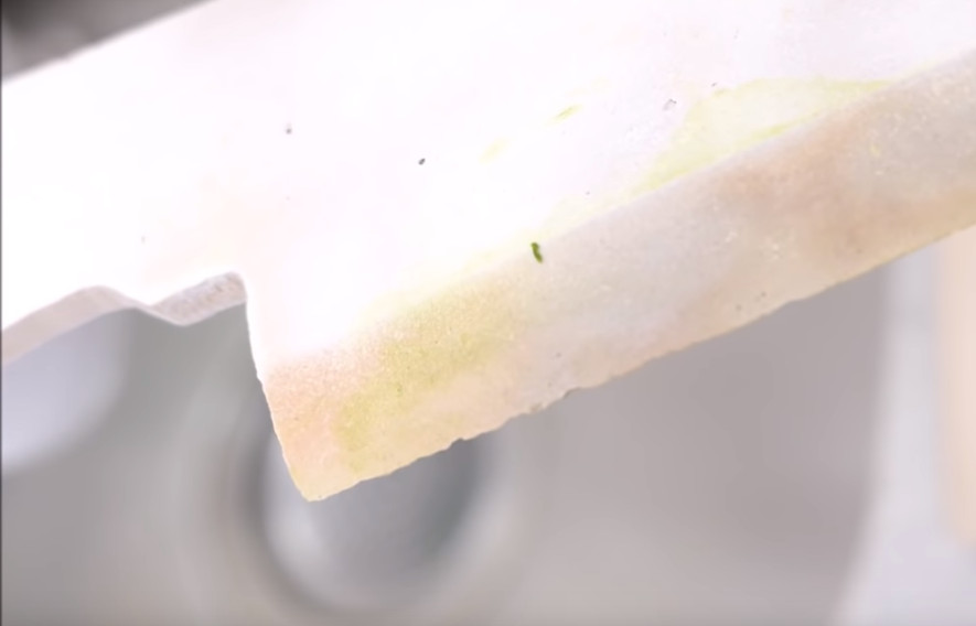

Another important material property is toughness. With better toughness the knives are less likely to chip at the edge during use. Toughness often correlates with ductility, or the extent that something can be deformed before it fractures. The materials being soft relative to steel does not necessarily mean that they are also ductile. For example, styrofoam is both soft and brittle, easy to both deform and to break apart. This problem was evident in the knife made out of KFC chicken bones, as even with delicately cutting a cucumber, chips in the edge were seen:
