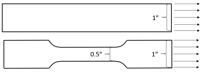

In an ideal world when a force is applied to a knife, that stress is distributed evenly across the piece. There can be certain features to a design, however, that leads to a stress “concentration” where the stress is locally higher than the rest of the piece. Stress is load divided by cross section, so a very simple way stress is concentrated is by having a locally smaller area of a part.
If above we are pulling on those bars of steel with a load of 10 lbs, with a 1″ cross section, the stress is 10 psi. However, with a reduced cross section of 0.25″ (0.5 x 0.5) then the stress has increased to 40 psi. In other words, the bar of steel is going to break in the reduced section because it experiences a greater stress. Stress concentrations can be in a much smaller area. A common one is a 90° angle in a part.

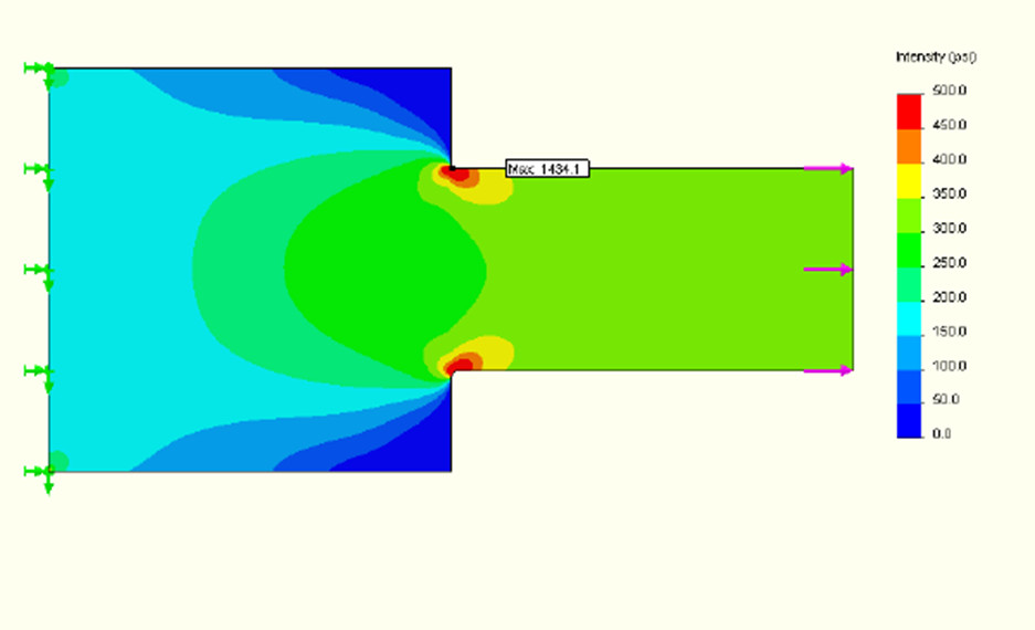

The image above is a computer simulation of a part with sharp corners. The colors represent the level of stress the part observes at any given location, where red is high stress and dark blue is very low stress. You can see that the thinner portion to the right sees a lower stress (green) than the thicker portion to the left (blue). However, the corners where the transition is sees very stress as is seen by the small red areas. That means that the part will break at those corners, and if the corners were more “rounded” then the stress would be much lower there and would be more evenly distributed.

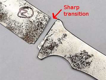

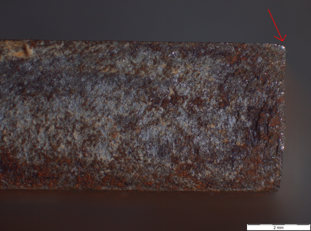

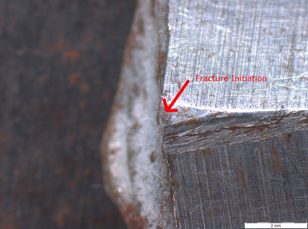

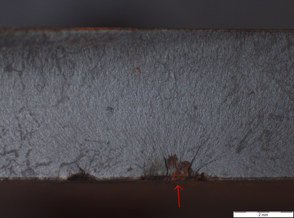

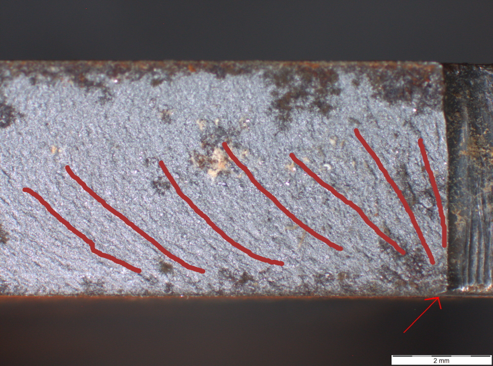

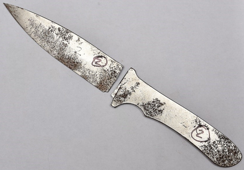

Patrick Brewster of Flying Steel makes throwing knives. He contacted me for help in analyzing broken blades that have been returned by customers over the years. Some he had a pretty good idea about what the problem was, at least in retrospect, and some were more mysterious. As in all such cases, it is difficult to assign a pure “cause” of a broken blade because it is unknown exactly what the customer did to it and if that would be considered typical, or acceptable, use. However, we can learn some things by analyzing them regardless. One knife he sent me had a good example of a sharp corner:

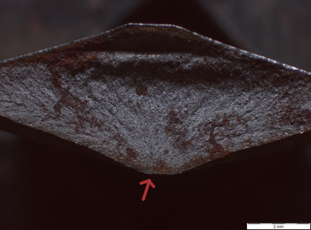

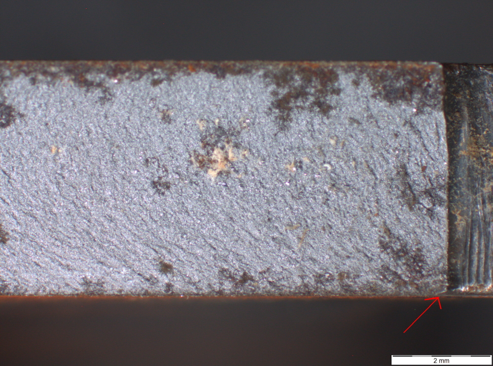

However, the fact that the sharp corner is there doesn’t necessarily confirm that is where the fracture occurred. It is a locally reduced cross section there with the sharpening choil. And perhaps the fracture occurred at the choil, for example. To know for sure we have to analyze the fracture surface of the cross section:
In both images above I have a red arrow which points to the point where the fracture “initiated,” which happens to be at the sharp corner of the knife, not the choil. You may be wondering how I can tell where the fracture initiated. There are often telltale signs in the fracture surface that tell us. There are characteristic lines called “radial marks” that point back to the initiation point, which I have shown below:

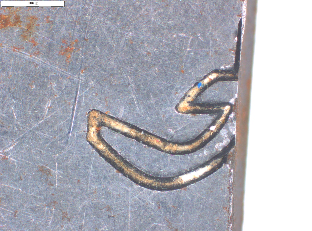

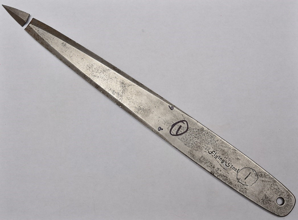

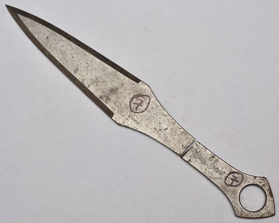

There were other knives that broke at the stamped logo on the knives (he has since changed his stamp):

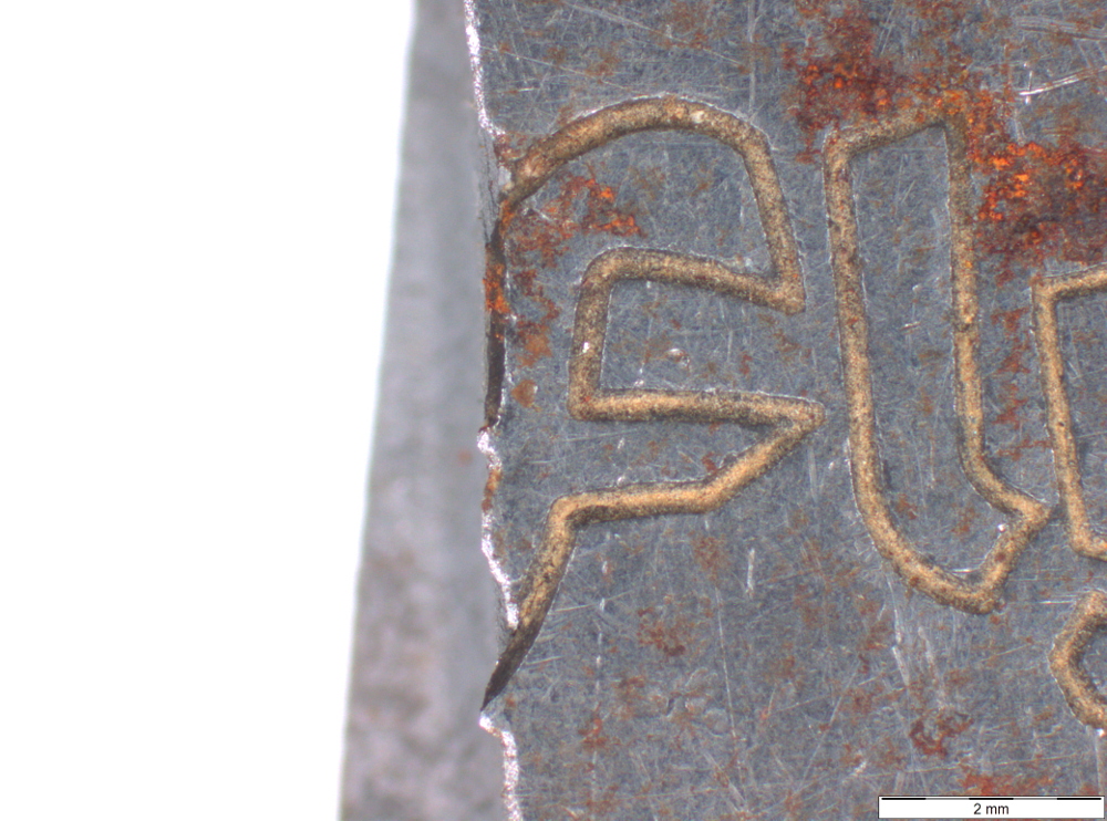

The fracture occurred along the left edge of the “F” in Flying Steel:
And analysis of the fracture surface confirms that the fracture initiated at the stamp:
The three broken blades at that same location appear to confirm the potential danger in a makers stamp, depending on the type of knife, the depth and shape of the logo, and the location of the stamp. Knives that are used for pure cutting operations are likely not in danger with a stamp. However, heavy choppers or other knives that see large shocks like these throwing knives may be susceptible.

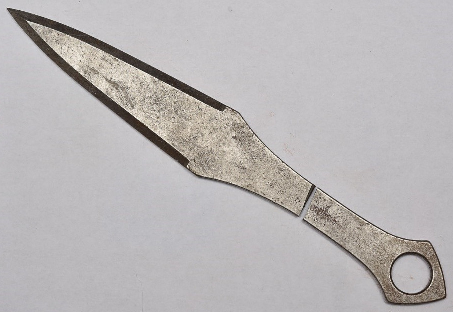

Holes in Blades

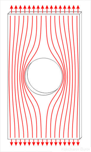

Holes in blades also act as stress concentrations for the reasons described above. The volume of material is smaller around the hole. This leads to the “internal forces” being locally higher around the hole, such as illustrated here:

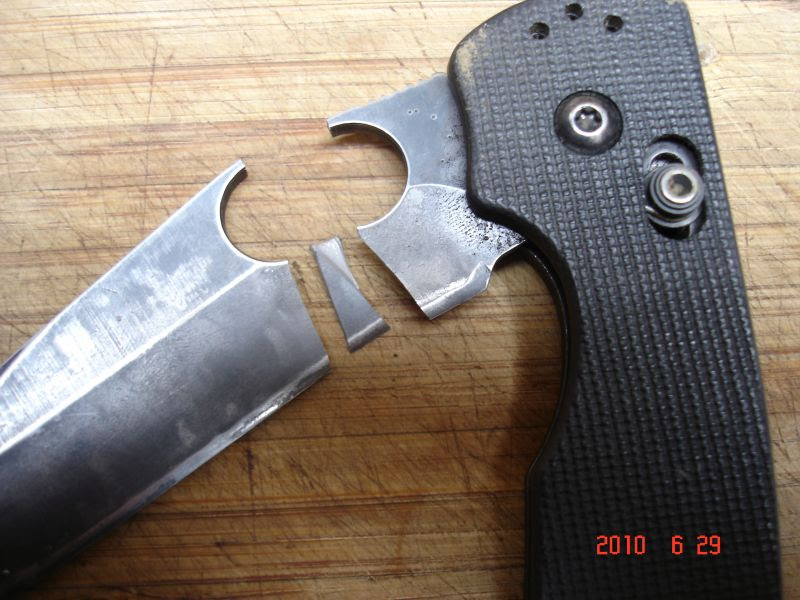

This means that if a blade with a hole in it is broken, the chances are very high the fracture will occur at the hole. A knife user had his M4 knife re-heat treated to a higher hardness (64 Rc) and it broke with relatively little lateral force. The “cause” for this fracture is not really known as the hole is only one of the symptoms of the blade breaking. Perhaps the heat treatment was poor, such as a small crack forming at the hole, the knife was insufficiently tempered, overheated during austenitizing, etc. However, the knife broke at the hole because of a stress concentration which was exacerbated by the heat treatment.

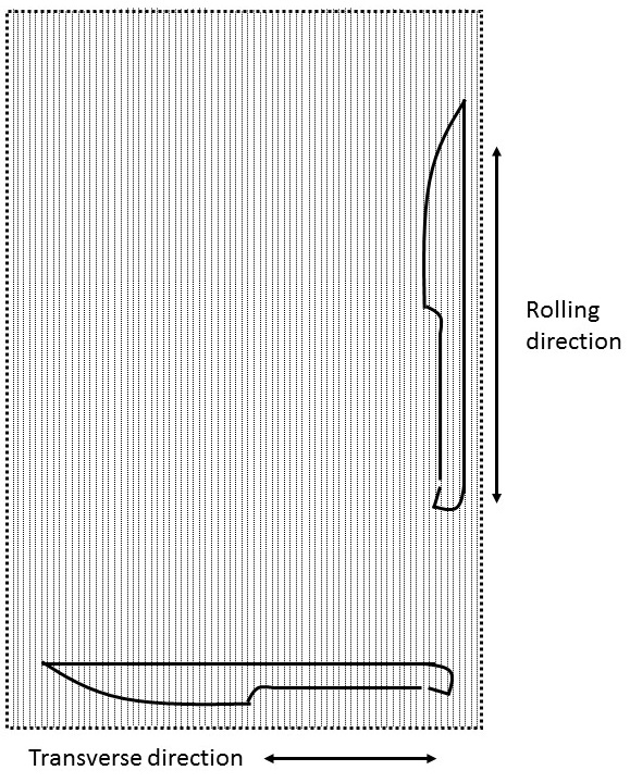

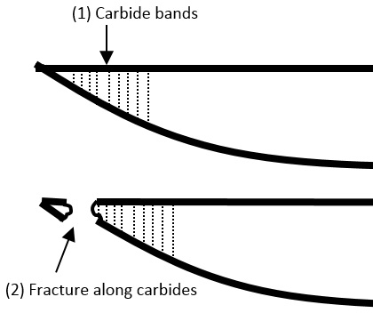

Using steel with high toughness does reduce the possibility of a broken blade, independent of knife design. High toughness steels are generally those with a low volume of carbides and impurities. You can read about what controls toughness in this article. The orientation of the knife relative to the rolling direction of the steel also matters, as that leads to the carbide stringers and impurities being preferentially oriented along a certain direction. When stress risers are oriented along these carbide stringers and/or impurities, fracture can be particularly likely.

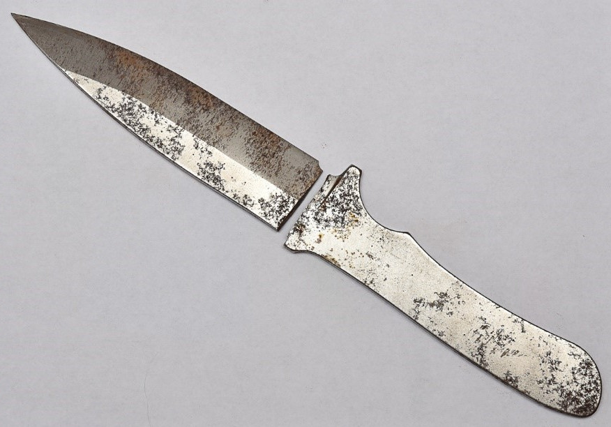

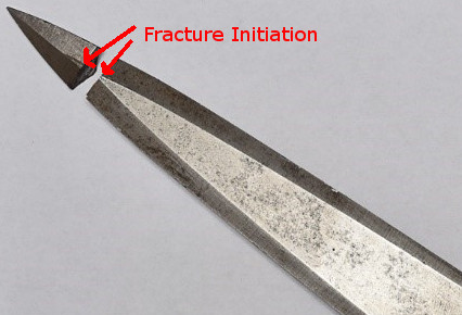

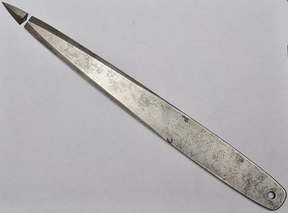

Sometimes stress risers are unknown or difficult to predict without testing a knife first. One of the throwing knives sent to me broke at a somewhat unusual location:
Upon analysis of the fracture surface, it is apparent that the fracture began at the “flat” that ends near the tip:
The fact that the fracture occurred there doesn’t necessarily mean there is a problem with the design. Perhaps the user stuck the knife into something and pushed on it laterally at that point. However, it may be worth testing a couple modifications of the tip design and seeing if the position where the tip breaks, or the difficulty of doing so, changes.
