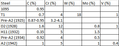

History
A2 steel is quite old, though determining the exact year it was released is a bit difficult. A2 steel was developed in the early 20th century during the explosion of tool steels that occurred after the discovery of high speed steel which was first presented in 1900. You can read about that history in this article: The History of the First Tool Steel. During the development of the first high speed steel included the switch from manganese to chromium as the primary hardenability element, and most high speed steels had about 4% Cr. That high chromium content was primarily for “hardenability” which is the degree of cooling required to achieve full hardness. A “water quenching” steel has low hardenability and must be quenched very rapidly from high temperature, and an “air hardening” steel can be left in air and it will fully harden. You can read more about hardenability in this article on quenching. The first high speed steel came to be known as T1, which had 4% Cr and 18% W (tungsten). The earliest record I have found of a precursor A2-type steel is in a summary of tool steels in 1925 [1], while summaries of tool steels from 1910 [2] and 1915 [3] do not have any similar steels. Therefore these types of steels probably arose sometime between 1915 and 1925.
Update 7/22/20: I found these precursor A2 steels available in 1916 in Machinery journal volume 22, no. 6 in a list of brand names of current tool steels. The steel was available as CYW Choice from Firth-Sterling and Vasco Choice from Vanadium Alloys Steel Company (Vasco). I couldn’t find anything earlier so I’m not sure which came first.
(Note: none of the above steels were known by these names until later)
A2 likely came out of the high speed steels like T1 since those steels generally had ~4% Cr steels. The tungsten was removed because “hot hardness” is not a requirement of these steels. High speed steels are used for cutting operations at high speed that build up heat, while die steels are made for stamping operations that do not. The carbon was increased to the level of other simple die steels like 1095 or O1, for high hardness and wear resistance. The high chromium content relative to 1095 and O1 means that the steel could be hardened in air for less distortion and cracking of dies.
Sometime between 1925 and 1934 [4] a version of these steels was produced with a molybdenum addition. Molybdenum was being found to greatly improve hardening response in air with high chromium steels. In other words, to improve hardenability. Chromium in such high amounts contributes greatly to hardenability, but for very thick parts hardenability was still insufficient. It was found that the addition of molybdenum to these steels made even larger parts possible with full hardness. One example was with D2 which was patented in 1928 with a 0.8% Mo addition, read more in my article on D2. However, it’s not clear if Comstock, the inventor of D2, knew that the molybdenum contributed to air hardening. In the patent he says that the molybdenum allows the use of lower carbon for hardness, and that tungsten could be used instead except that the tungsten would make the steel more difficult to anneal. Tungsten does not contribute to hardenability so if he viewed it as a replacement then the molybdenum was likely not used for that purpose. It’s not that molybdenum was unknown as an element that contributes to hardenability at that time, but it was not yet known that adding molybdenum to a steel with greater than 3% Cr would lead to excellent air hardening properties.
In 1932, hot work die steels were patented by James Gill which had 5% Cr and 1.5% Mo [5], and the molybdenum was specifically added because of its contribution to air hardening leading to low distortion in heat treatment. Those steels have relatively low carbon (~0.35%) but that discovery was likely the reason Mo was added to A2, and perhaps the popularity of those hot work die steels led to the increase in Cr to 5% with A2. James Gill was a very influential metallurgist who I wrote about in this article.
The earliest record of A2 I have found is from 1939 in an advertisement from Universal-Cyclops steel who claim to have developed it, named Sparta steel [6]. By 1944 [7][8], the modern version of A2 was being sold by most of the major tool steel companies. This version had a further increase to Cr (~5.0%) and Mo (~1.0%) as well as a small vanadium addition for grain size control. The increased amounts of Cr and Mo were likely for increased hardenability and wear resistance. The extra Cr would lead to the formation of more chromium carbides. Another reason for higher Mo is probably for secondary hardening (high temperature tempering) which can provide some hot hardness for applications where that is required. Also, high temperature tempering leads to the transformation of retained austenite. Retained austenite is sometimes undesirable because if the austenite transforms during operation of the part that can lead to small dimensional changes.

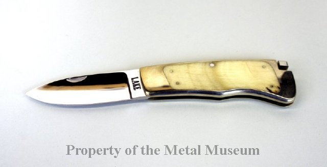

I called Ron Lake and asked him when he started using A2 because he is known for having used it early on. He told me that he started using it with his first knives in 1965. He had used A2 and D2 as die steels in “model making” (prototyping) work he did for his profession. At the first Knifemaker’s Guild show in 1971, he said that he didn’t find any other makers using it at the time, and in fact almost no one else had heard of it apart from Bob Loveless. Most makers at the time were using recycled steel and commonly the maker did not know which steel(s) they were using. Ron also told me that George Herron started using A2 at a similar time and he doesn’t know if that was due to Ron’s influence or if he began using it independently.
Ron Lake folder from the early 1970’s. Image from [12]
It is possible that someone else used A2 in knives earlier than Ron Lake because it was a common die steel at that time. However, it is likely that the popularity of A2 was built in part from the influence of knifemakers like Lake and Herron. By the 1970’s other knifemakers like Vernon Hicks [13] and Bill Davis [14] were using A2. The steel is available in many knives today such as those produced by Bark River Knives.

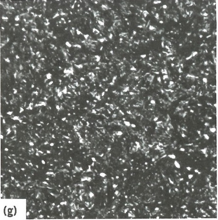

The microstructure of A2 is somewhat coarser than simple steels like 1095 and O1, but finer than a steel like D2. D2 has a large amount of large chromium carbides that gives it very good wear resistance but somewhat poor toughness. Therefore A2 is typically used in applications where D2 has insufficient toughness. Below you can see the relative carbide size (all at 1000x) where the carbides are the white particles.
O1 micrograph [15]
A2 micrograph [15]

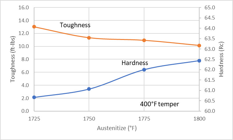

I have quite a bit of toughness data to share on A2. First of all, we did a recent set of toughness experiments with different heat treatment parameters. Thanks to Michael Drinkwine for heat treating and machining the specimens for these experiments. A surprise with our earlier 5160 experiments was that it was very sensitive to heat treatment parameters, unlike previous results with CruForgeV, AEB-L, and Z-Wear. So I was interested to see how A2 behaves. We used austenitizing temperatures from 1725-1800°F and tempering temperatures from 300-500°F. Each was soaked for 20 minutes at the austenitizing temperature, plate quenched, held in liquid nitrogen for 6 hours, and then tempered twice for two hours each time. We tested using a subsize unnotched charpy specimen, the specifications of which are shown on this page.
Unlike with 5160, in no case was there a big dropoff in toughness by overaustenitizing, undertempering, or from tempered martensite embrittlement:
There are a few reasons why A2 is less sensitive to austenitizing and tempering compared with a simple steel like 5160. For one, even with an austenitizing temperature of 1800°F, there are still chromium carbides present which keeps the grains to a reasonable size. The carbides “pin” the grain boundaries. If the grains grow then toughness goes down. 5160 has very little carbide and so overaustenitizing leads to no more carbide for pinning grains, the grain size grows, and toughness decreases. In terms of tempering, the toughness of 5160 went down between a tempering temperature of 400 and 500°F, which is known as “tempered martensite embrittlement.” This embrittlement occurs because large carbides form within the martensite which are detrimental to toughness. Different elements can delay the formation of these carbides, most famously silicon. However, in large enough amounts chromium will have the same effect which is why A2 does not see this phenomena with a 500°F temper. You can read more about tempered martensite embrittlement in this article. Because we did not see any major embrittlement mechanisms, there is a good correlation between toughness and hardness. In other words, higher hardness means lower toughness:

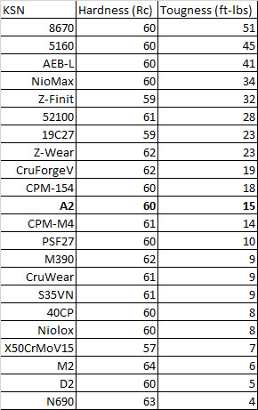

A2 has good toughness, which is why it has seen so much use as a die steel over the years. It compares favorably with higher wear resistance steels like D2. However, there are low alloy, low wear resistance steels like 8670 and 5160 with better toughness, and there are more expensive powder metallurgy steels which also have superior toughness:
These results for A2 compared with other steels line up favorably with reported toughness from Carpenter (Unnotched izod) [16] and Crucible (C-notch charpy) [17]. You can read about the different types of toughness testing in this article.
In the charts above, 10V and PM A11 are the same, and 420CW and S90V are the same. CPM-M4 and PM M4 are also the same of course. Below is the Knife Steel Nerds toughness data in table format for a better comparison with the above tables. Z-Wear is the same as CPM CruWear, PSF27 is a “sprayform” D2, 40CP is a powder metallurgy 440C.

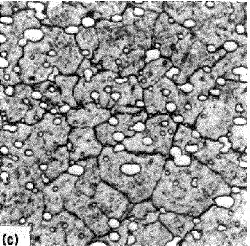

The toughness of A2 relative to other steels may be somewhat surprising, in that we might expect it to be higher with its relatively low volume of carbide (~6-8%). And the carbides are relatively fine as shown in the micrographs previously. However, lower magnifications micrographs of commercially produced A2 steel sometimes show larger primary carbides on the order of 8-15 microns which were not removed through prior processing. These large carbides act as crack initiation points which can reduce toughness. I do not know if there is commercial A2 available which is processed in such a way to avoid these larger carbides. Steels like AEB-L and 13C26 are famously given special processing to eliminate these large carbides for use in razors.
A2 micrograph showing some larger primary carbides. Image from [18].

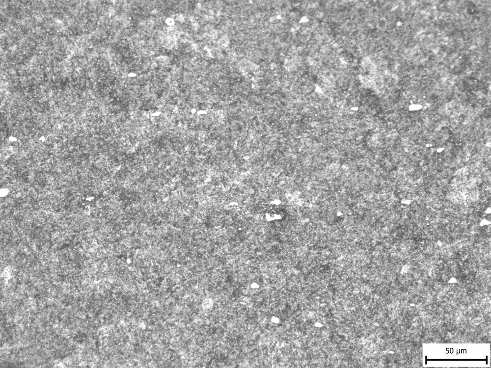

Edit 10/15/2019: Micrographs of the A2 that we tested confirmed larger carbides present in the microstructure. There is not a high density of them but they are scattered throughout the microstructure. I have micrographs at two different magnifications below to see them:
