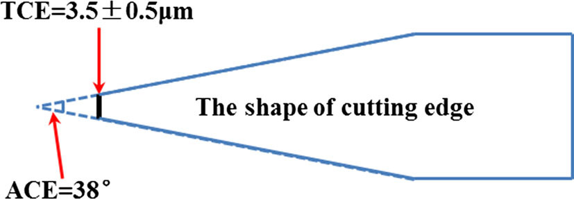

I was definitely interested in how they ensured the sharpening was consistent and eliminated human variables. This is how they described the sharpening process: “The shape of cutting edge is straight, and the minimum thickness of cutting edge (TCE) is 3.5 ± 0.5 µm. The angle of cutting edge (ACE) was 38°, and the relevant parameters are shown in Fig. 1. The test knives were sharpened by sandstone which mainly contained SiO2 and some sticky material, such as clay and carbon. The cooling agent was saline water which contained 15 wt.% salt.”
OK, so they had a fixed edge angle of 19° per side, and an average edge tip thickness of 3.5 microns. However, they did not state how the angle was set or what type of sharpening apparatus was used. Just that it was sharpened on sandstone which contained silica and some “sticky material.” No information on grit of the sharpening media, deburring, almost nothing. Was it sharpened by hand? A robot? With CATRA sharpening equipment? I have no idea how they sharpened the knives.

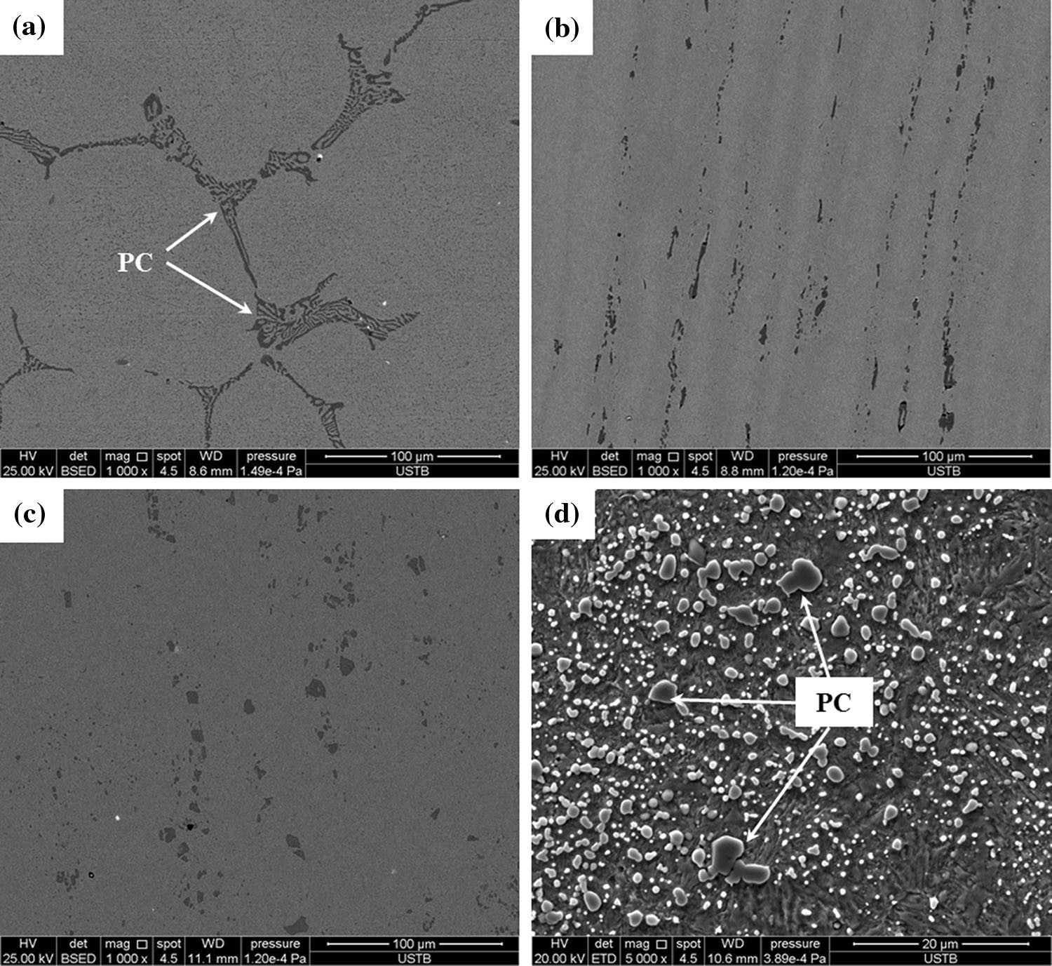

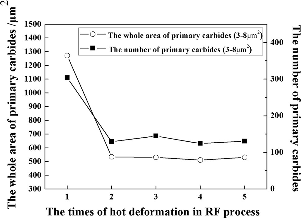

This processing was performed in an attempt to reduce the amount of primary carbides. Primary carbides are those that form during solidification of the steel and they are typically large. Large carbides reduce toughness and other properties. They found that the “diffusion annealing” process at 1180°C was effective at reducing the amount of primary carbide:

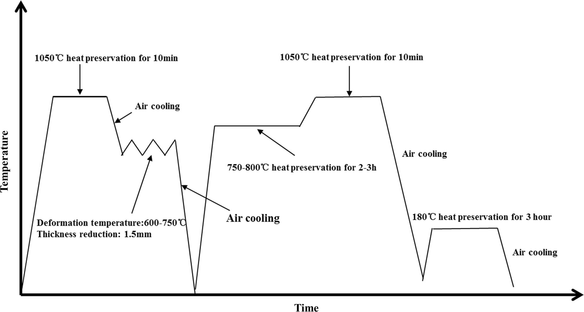

All of the steel was austenitized at 1050°C (1925°F) for 10 minutes, air cooled, and tempered at 180°C (350°F). However, they also tested a process they called “roll forging” where they austenitized the steel at 1050°C for 10 minutes, then air cooled the steel to 750°C (1375°F) and rolled the steel down from 2.5 mm to 1 mm. The steel was then given the final austenitize, quench and temper. That process is shown below:
They have some microstructures shown in the article at different stages including (a) after electroslag remelting, (b) hot-rolled plate, (c) after spheroidize annealing, and (d) cutting edge of a knife. I don’t know what they mean by cutting edge. Does that mean after the final heat treatment? Is this literally at the very edge on the surface? Also these are clearly etched samples to show the carbides but no etchant or etching procedure is described in the article.

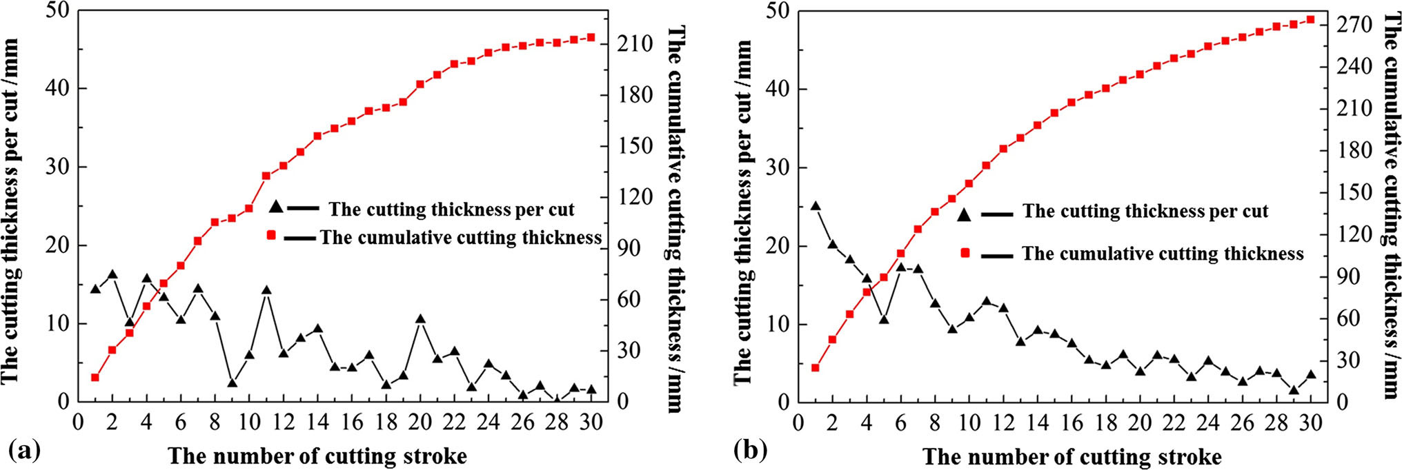

Results of “Roll Forging” Comparison
The researchers performed 4 tests of each condition to get a good average. They found that the CATRA edge retention was increased from 218 mm to 279.4 mm by employing the “roll forging” process, an increase of 28%. They attributed this improvement to differences in the primary carbide structure. Their reasoning for this was something I have not seen before, and requires some explanation and discussion. See the example curves below for (a) tranditional process and (b) RF process:
In CATRA testing there are often variations in each “cut” where one cut will be lower than another as the edge wears throughout the test. These variations are difficult or impossible to avoid. However, they claim that the the roll forging process led to less variation between cuts and this is what provided the benefit. They then provided a hypothesis that the on one cut the carbides are pulled out leaving “pits” in the edge, increasing the frction of the edge and that the sharpness would drop because of it. In the next cut the pits would be worn off so that in the next cut would have lower friction, and then the cycle would repeat. They provided these micrographs as evidence, with (a) being after one cut and (b) being after the second:

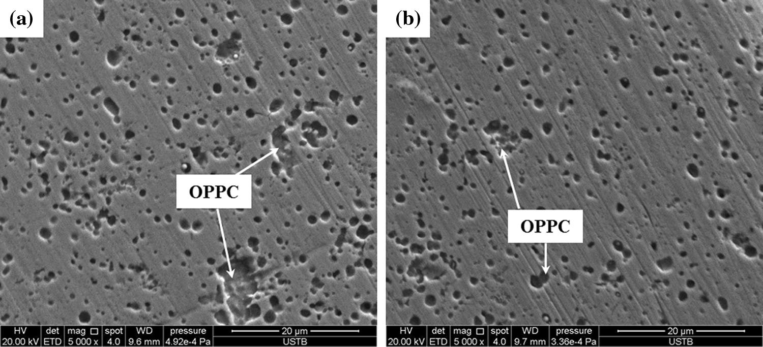

They stated that these images were taken from “the cutting edge” but with not further information at what position in the edge this means. I don’t really see a clear difference between the two images. There are a couple larger pits in the first image but that could just be because of the location that was chosen. There are pits in both images so this does not provide evidence that the pits are being ground away in alternating cuts. The researchers also seem to be unaware that in the CATRA test each “cut” is actually both a forward and backward stroke, which would throw a wrench in their theory about the alternating cuts leading to wearing away the pits. In my CATRA articles I wrote about how the total edge retention can actually be predicted by the result of the very first “cut” (two strokes) because the wear of the edge is actually significant enough that even cut number 1 is a significant amount of wear. That difference was seen in their two conditions as well. The roll forging process reduced the thickness of the steel by a large amount, from 2.5 to 1 mm. This effectively reduced the “thickness behind the edge” which was found to affect the wear behavior of CATRA in a previous study:
The researchers made no comment on the thickness effect. The difference could have been eliminated if all of the material had been ground down to the same thickness. I have never seen these “pitted” edges which they claim are from the carbides being removed during the edge retention test. No evidence of significant carbide removal were observed either in the 154CM study I wrote about or in Verhoeven’s CATRA testing [2]. The edge below is after a round of CATRA testing where everything looks pretty smooth, apart from perhaps a few protruding carbides:
Furthermore, if carbides fell out so easily during abrasion it would make metallography of steel very difficult. No special procedure is used to keep the carbides from falling out. You just grind it on sandpaper in progressively finer grits until it is polished. No significant “pits” from large carbides to be seen, even before etching.
They researchers also reported that the roll forging process effectively reduced the amount of carbide present in the steel. We would expect a reduction in carbides to lead to changes in hardness, because as more carbide is dissolved there is more carbon in solution for higher hardness. However, not a single hardness value is reported anywhere in the journal article. They even stated in their introduction that hardness is an important variable and yet they did not measure it.

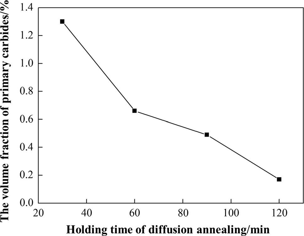

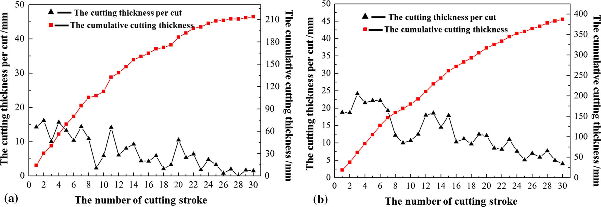

Results of “Diffusion Annealing” Comparison
The researchers found that the 1180°C high temperature process was effective at improving the edge retention from 218 mm to 378.8 mm, an improvement of 74%. They proposed a similar mechanism to above, stating that the vacillating edge loss curves in CATRA were less extreme with diffusion annealing due to a reduction in primary carbides. They also stated that there was “more martensite in the knives treated by diffusion annealing” which would certainly have affected the hardness. But again, no hardness values were reported.

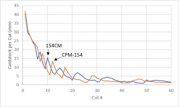

Effect of Primary Carbides in Previous Studies
In the previously linked study comparing CPM-154 and 154CM, we have a good comparison between different carbide sizes. The CPM process greatly reduces the carbide size relative to the conventional 154CM.
CPM-154 with fine carbides
154CM with large primary carbides
Comparing the wear curves of CPM-154 and 154CM I see no noticeable difference in the size of the fluctuations of the test between the two:
