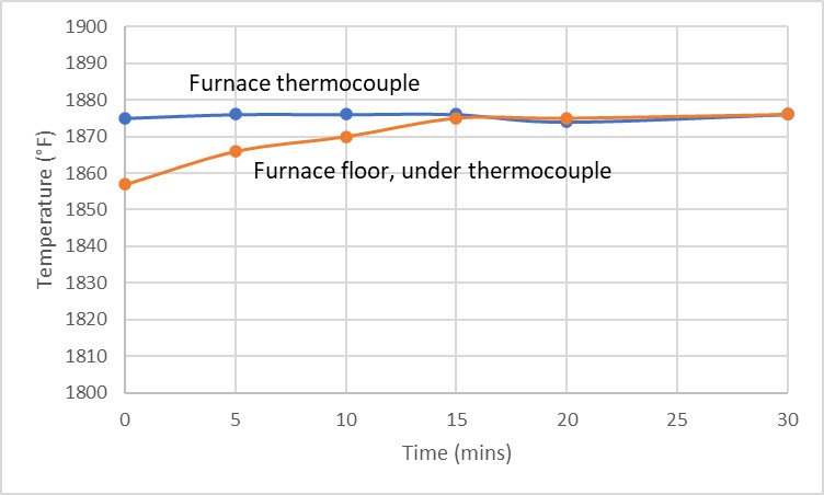

Temperature at the Bottom of the Furnace

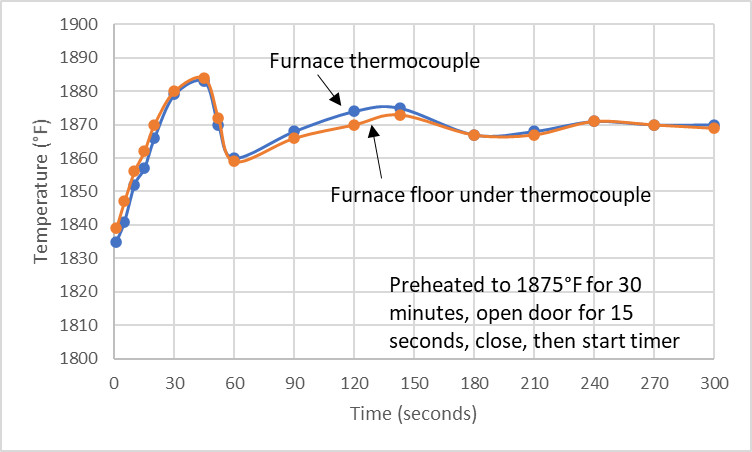

The thermocouple is located near the ceiling of the furnace, while knives are typically placed at the bottom. So the first thing to test was a thermocouple at the bottom of the furnace to compare with the ceiling. This was also a test of how long it takes for the furnace to “equalize” as different positions of the furnace will be somewhat different than the ceiling thermocouple. After the furnace thermocouple reached the target temperature, it took about 15 minutes for the ceiling and floor thermocouples to reach the same temperature:
I next checked to see what happens when you open the door and close it such as when placing a knife inside. I opened the door for 15 seconds, closed it, and then recorded the temperature of the furnace thermocouple as well as my secondary floor thermocouple:
The floor and ceiling remained surprisingly close even after the temperature drop. So if the furnace has equalized before opening the door the floor remained at the temperature the furnace was reading.

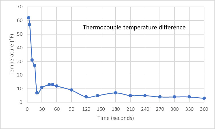

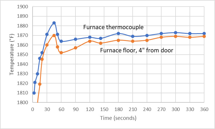

Temperature Close to the Door
Another concern is the temperature difference near the door where heat loss can occur. Also when you open the door the front of the furnace loses heat more quickly, which is readily apparent just by looking at the color changes. So I was curious if the temperature differential between the floor of the furnace would be acceptable further away from where the furnace thermocouple reads. I moved the secondary thermocouple to 4″ away from the door, about 10″ from the furnace thermocouple. I kept the thermocouple at the floor, so this is a combination of the difference from being at the furnace floor in combination with being near the door.
The secondary and furnace thermocouples maintain a relatively similar delta of about 4-6 degrees by 2 minutes of the furnace door being closed, and continued to decrease to three degrees by 6 minutes. You can see a bit more clearly the difference between the two thermocouples by plotting it out vs time:
Having a difference of less than five degrees is very good, especially when so close to the furnace door. I think the temperature gradient is reasonable. Of course, keeping the knife as close to the furnace thermocouple as possible leads to a temperature as close as possible to the setpoint. So placing the center of the knife at the thermocouple is advised, or perhaps the center of the blade since the blade is probably more important than the handle. If it’s a folder blade the decision is easier. A furnace that is longer than necessary is desirable because the temperature gradient is not as extreme and the area near the door can be avoided.

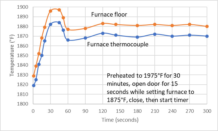

Creative Furnace Uses
I have seen a few people recommend changing how the furnace is used to compensate for the heat loss when opening the door. I am not 100% sure why they are recommending this, something about wanting to avoid the furnace elements being on when the blade is in the furnace, though maybe different people have different reasons. I placed the secondary thermocouple at the furnace floor again underneath the furnace thermocouple. I preheated the furnace to 1975°F, opened the furnace door for 15 seconds, closed it, and then recorded the temperatures:
The furnace overshoots more significantly as would likely be expected by equalizing at a temperature higher than our final setpoint. The goal of keeping the elements off is not really met as the furnace turns on to come back up to temp, and then will cycle on and off to maintain the temperature. There is a greater delta in temperature between the floor and the the furnace thermocouple than when we equalized at the target temperature of 1875°F. You can also see that the floor is too hot now from equalizing at the higher temperature.

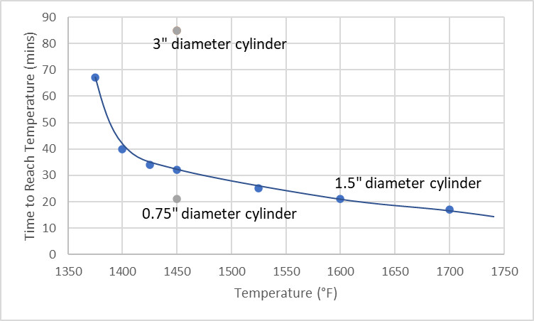

When using a separate furnace for preheating, or skipping the preheat altogether, there can be concerns about when to start the timer for the austenitize. The datasheet usually recommends some minimum hold time such as 15 minutes, but this is usually assumed to be the time required after the steel has reached the target temperature. One way to know is simply to look at the knife. This is especially easy when the furnace has a window. When the steel is the same color as the furnace it has reached the temperature. Steel is very conductive so once the surface has reached the furnace temperature so has the center of the blade. Even with steel that is a couple inches thick the delay between the surface and the center is very small. For those without a window you can open the door and check to get a feel for how long it takes. The time is longer for larger blades, especially those with thicker cross section.
However, there is an even simpler way recommended by some metallurgists, which is to start the timer after the furnace has rebounded to the target austenitizing temperature. You may need to add on a couple minutes to ensure the temperature was reached. If the austenitizing temperature is chosen correctly there is little danger of grain growth.
Somewhat counterintuitively, at low temperature the steel reaches the target temperature more slowly than at high temperature, as shown below. So just because you are austenitizing simple carbon steels don’t assume they are heating through more quickly. Note these measurements are for cylinders of a cross section that is greater than a knife, but the principles are the same.
Data adapted from [1]

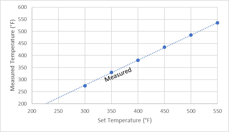

Tempering in a Heat Treating Furnace
Heat treating furnaces for knives are often calibrated at relatively high temperatures to ensure good austenitization. Sometimes the temperature may be somewhat off at low temperatures used for tempering. I used a thermocouple and an oven thermometer to compare the temperature between 300 and 550°F and found a difference of 15-25°F, with the difference decreasing as the temperature is raised. I recommend using a high quality oven thermometer to ensure that your tempering temperatures are in line with the setpoint. If there is some difference it is easy enough to compensate.

The temperature distribution is relatively small in an EvenHeat LB 22.5 if the furnace is equalized for at least 15 minutes. Though the furnace cools significantly when opening the door, the furnace rebounds to an even temperature distribution again after a relatively short amount of time. It is advisable to keep the knife close to the thermocouple to limit the temperature gradient within the knife. Preheating the furnace to a temperature above the target is not advised as it leads to an uneven temperature distribution. Because heat treating furnaces are calibrated to high temperature, the temperature should be checked at low temperatures if used as a tempering oven.
